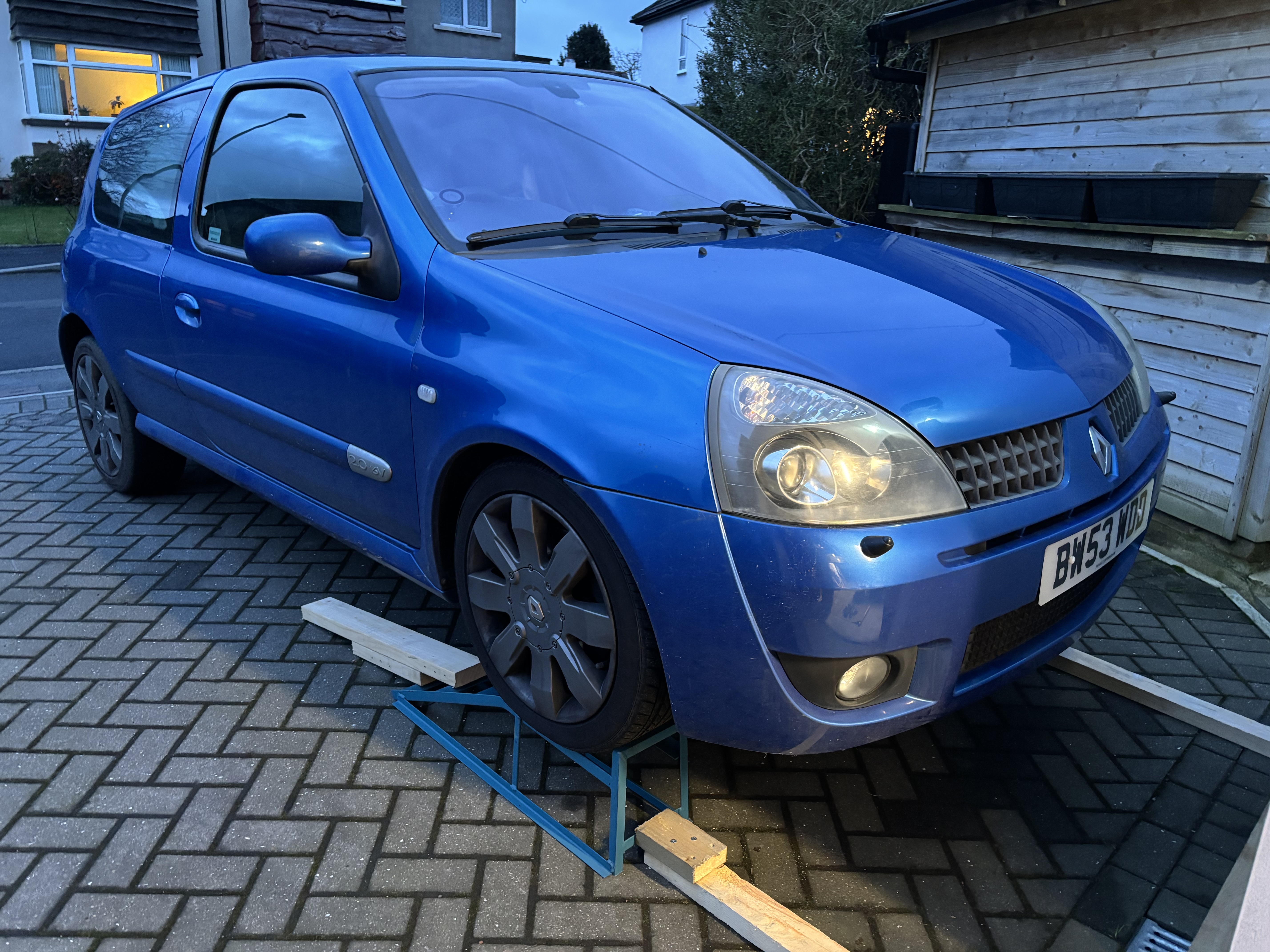

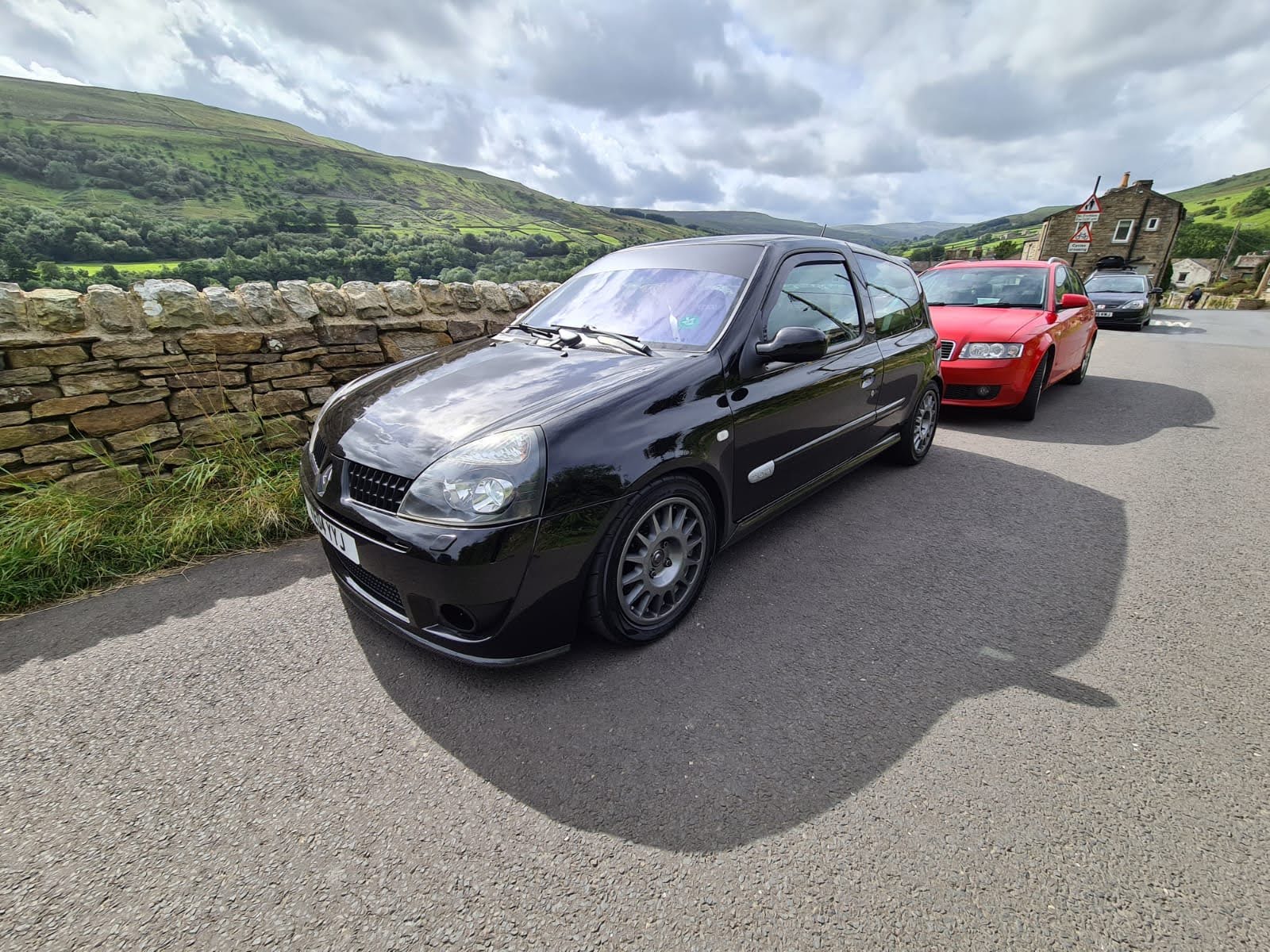

Hi all,
This is my new toy: a Clio 182
66k miles, 2 owners before me
So far in 6 weeks ownership I’ve spent £325 on an auto electrician, £50 on getting the UCH sent off and fixed, £700 on bodywork, £200 or so on bits and pieces like wipers, a refurbished seatbelt, new gearstick insert for the top, window crack repair kit, seat colour restorer etc
Just done the extremely fiddly job of finding and zip tieing the heater control sprocket thing, now getting to taking the horrible soft touch coating off the interior plastics.

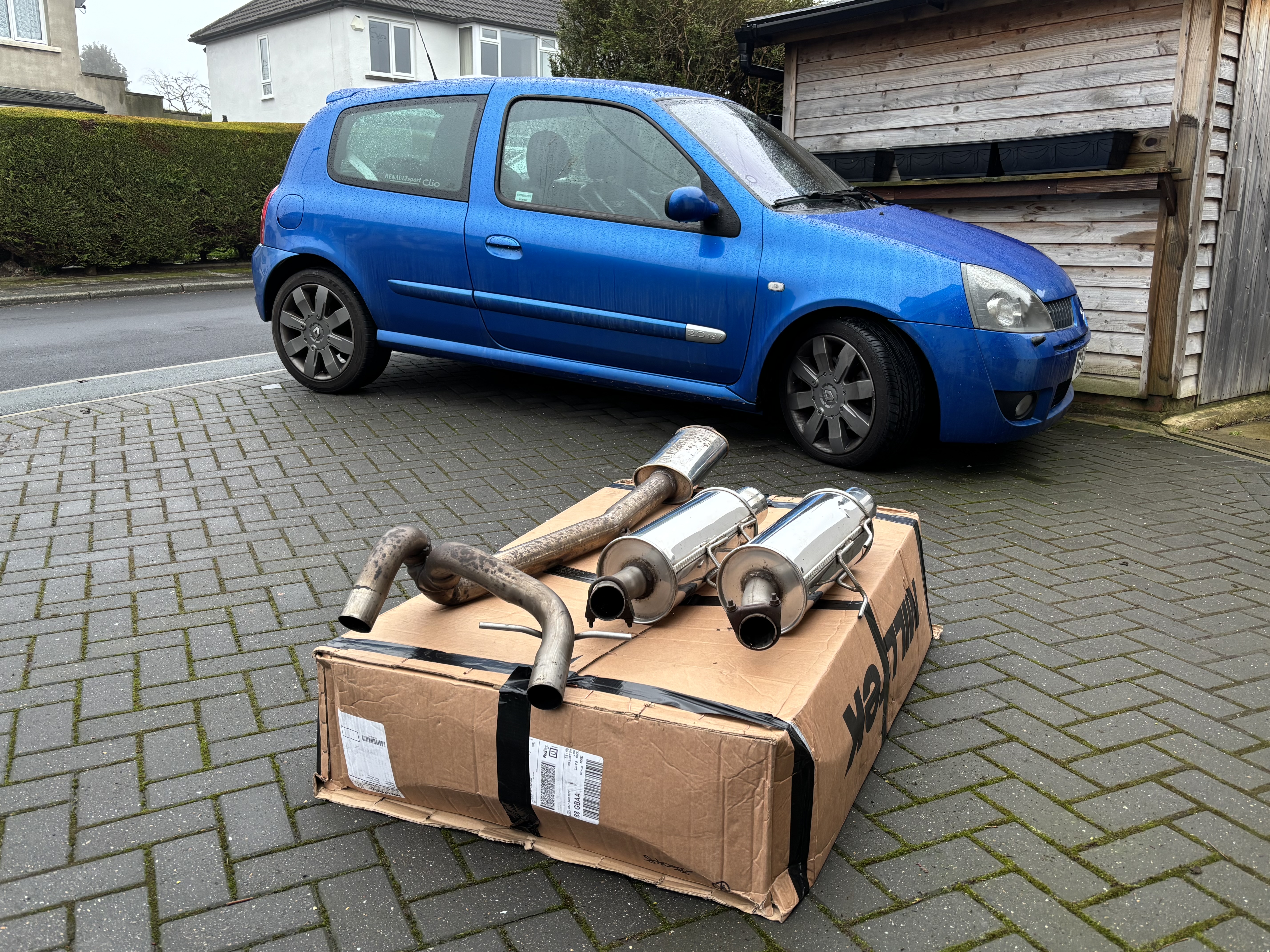

Have just had a Milltek resonated cat back exhaust delivered (today) as they were on sale at £550 and the currently fitted one is ridiculous (it has recently set a parked up vans alarm off as I pulled out of a junction).
Next is some expensive garage work as it needs the dephaser/cam job doing. Going to get them to service it at the same time so preparing for a big bill, maybe £800-900?
All in all it’s costing me a fortune and makes no rational sense whatsoever. I know this but every time I put my foot down it makes me smile, it’s got bundles of character and there won’t be many 182’s around soon so hopefully it won’t lose too much money over time.
This forum has been great for advice and step by step guides. Thanks for everyone who has posted stuff 👍🏻

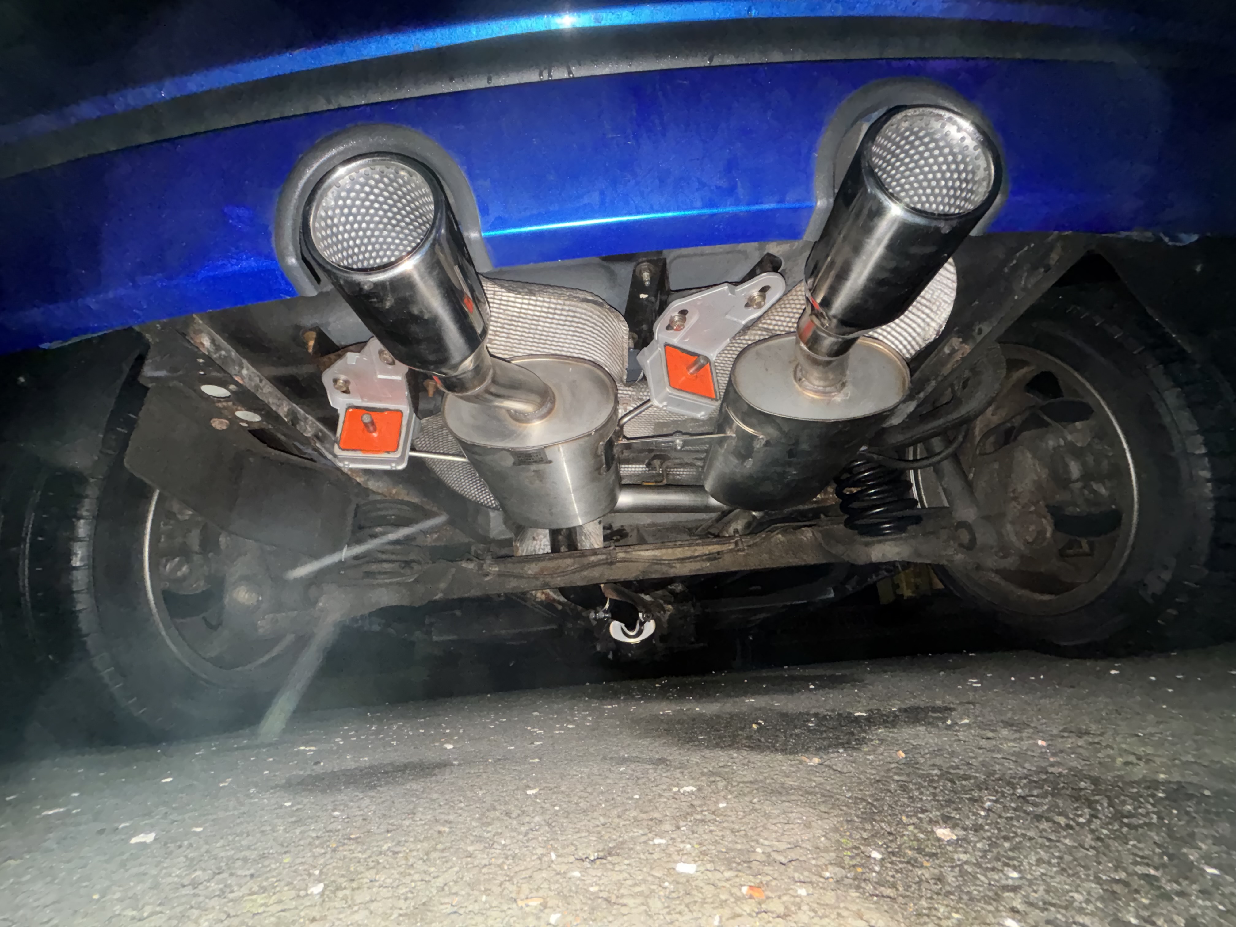

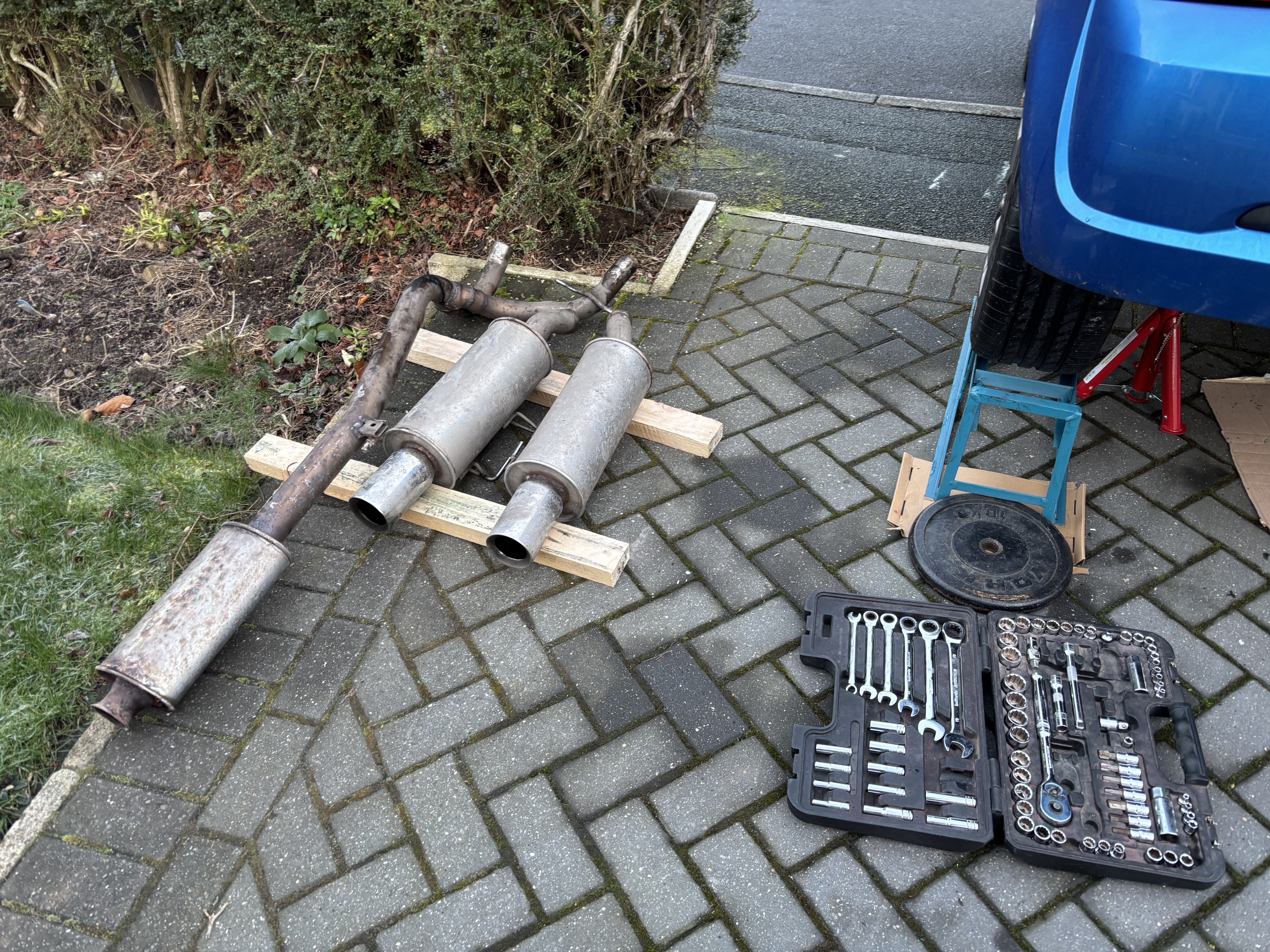

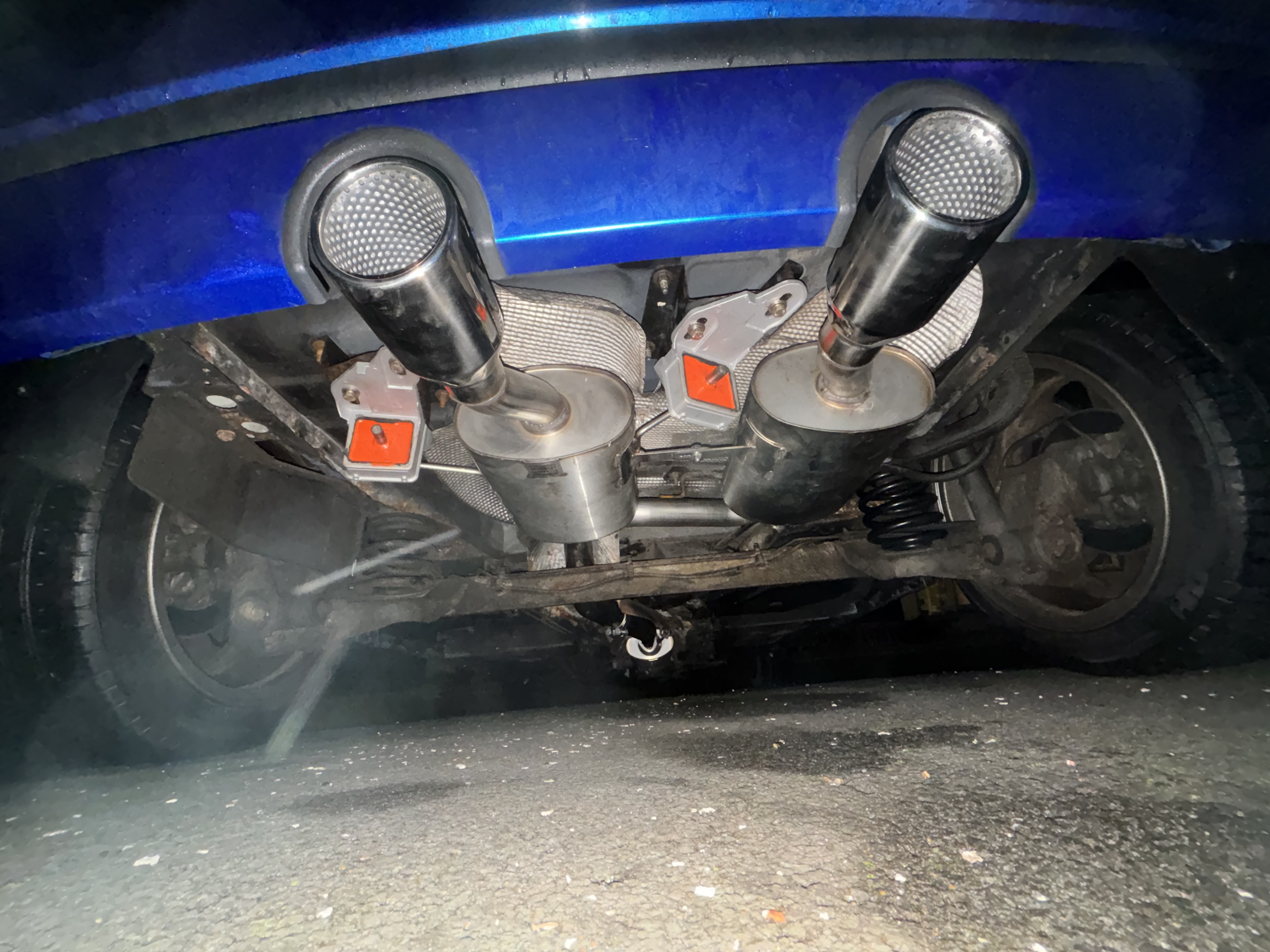

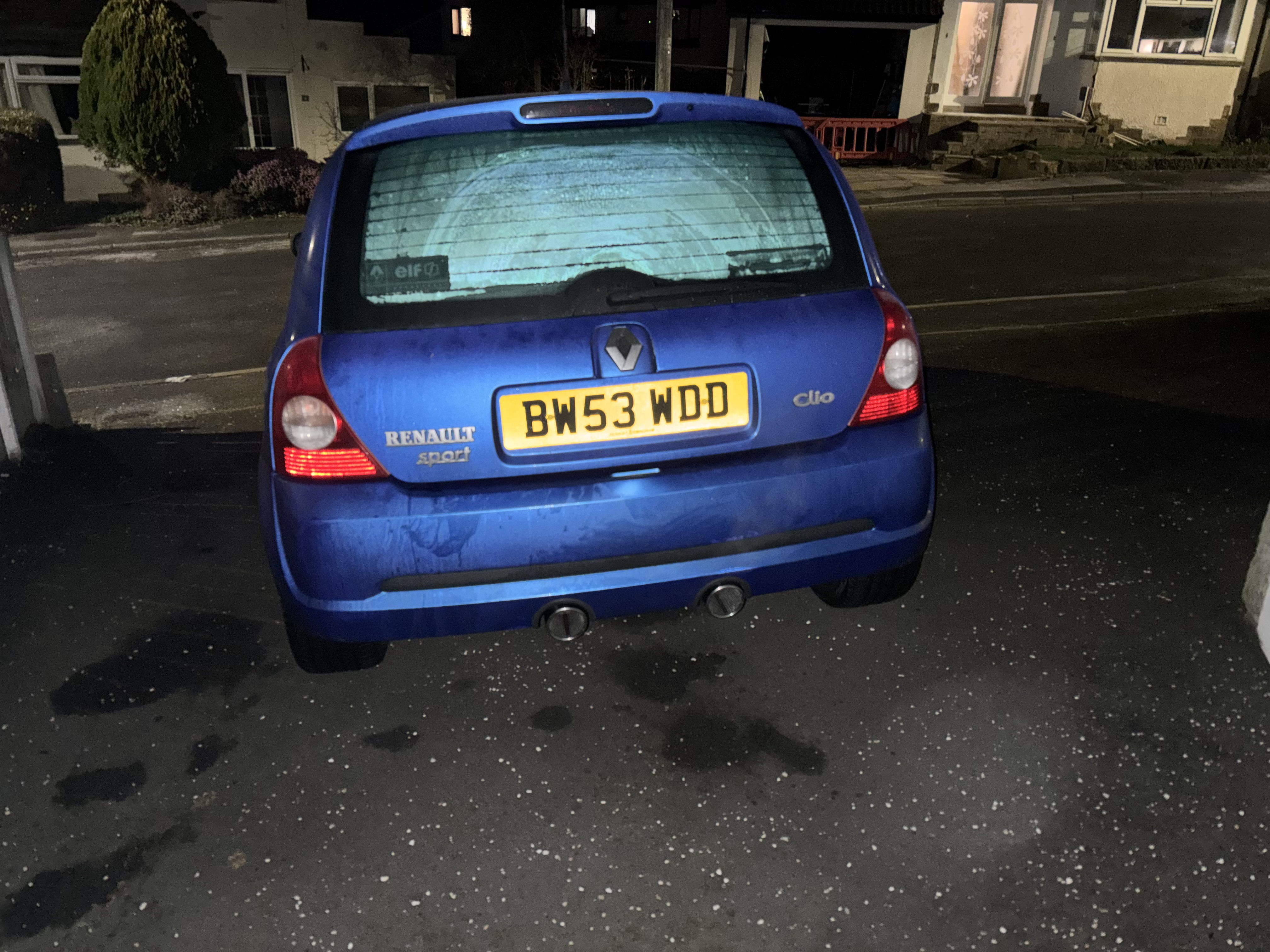

Tried to fit the Milltek exhaust today. Failed! The standard mounts seem to be in the wrong place and are a bit cracked/fatigued, so I’ve ordered a couple of BTT “Renault Clio Mk2 172 182 CUP Uprated Exhaust Mount POLY Polyurethane Bush Hanger” which come on a mounting plate and should be a lot better. Annoying to have taken the old one off to get the new one on only to take that off and put the old one back, but hey ho

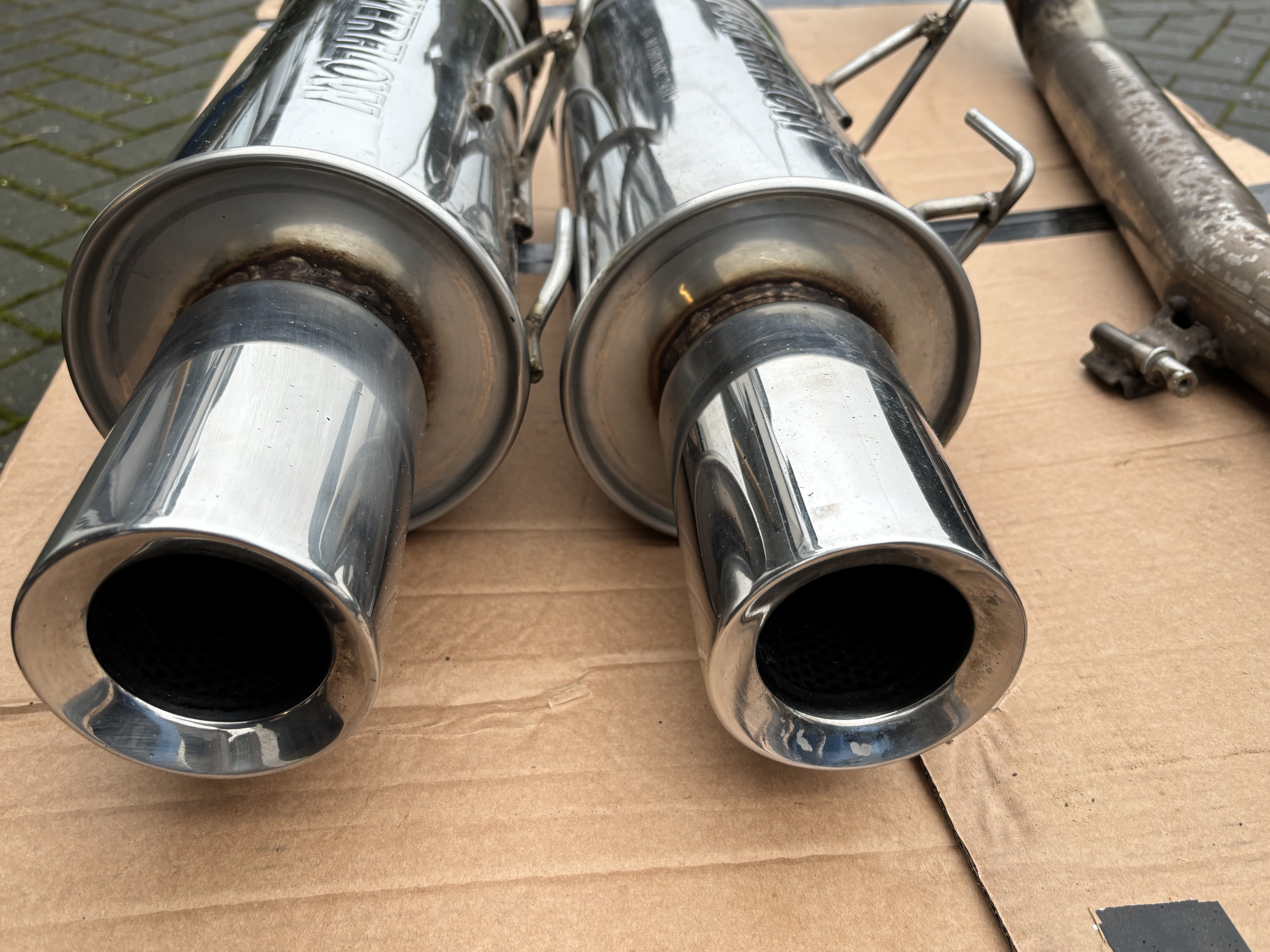

Finally got the new exhaust on yesterday on my driveway. Sounds a lot better, the old power sport one was too loud for me. It’s for sale if anyone wants to make me an offer 👍🏻

As promised the old Powerflow exhaust is now for sale on Facebook Marketplace if anyone is interested

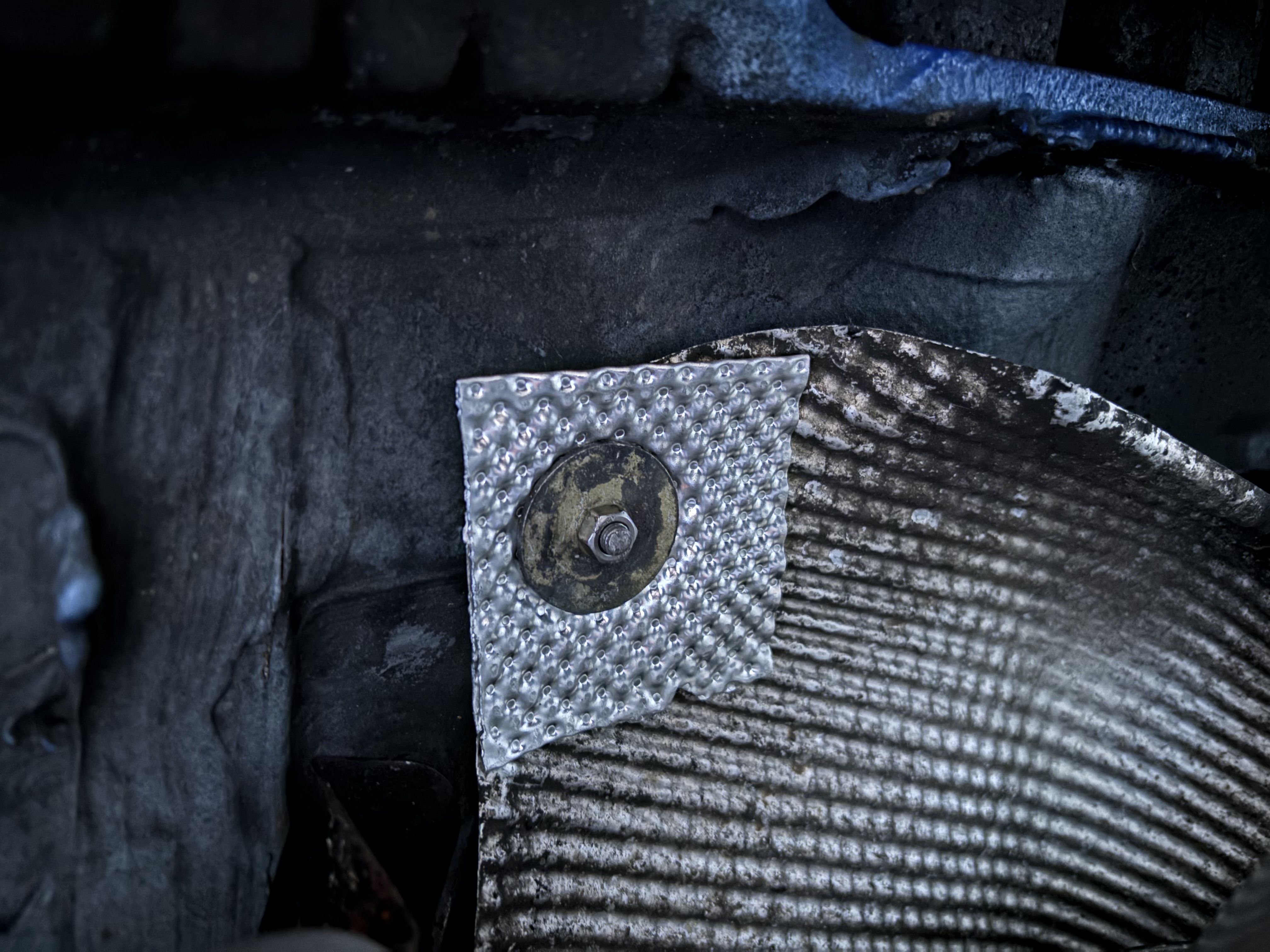

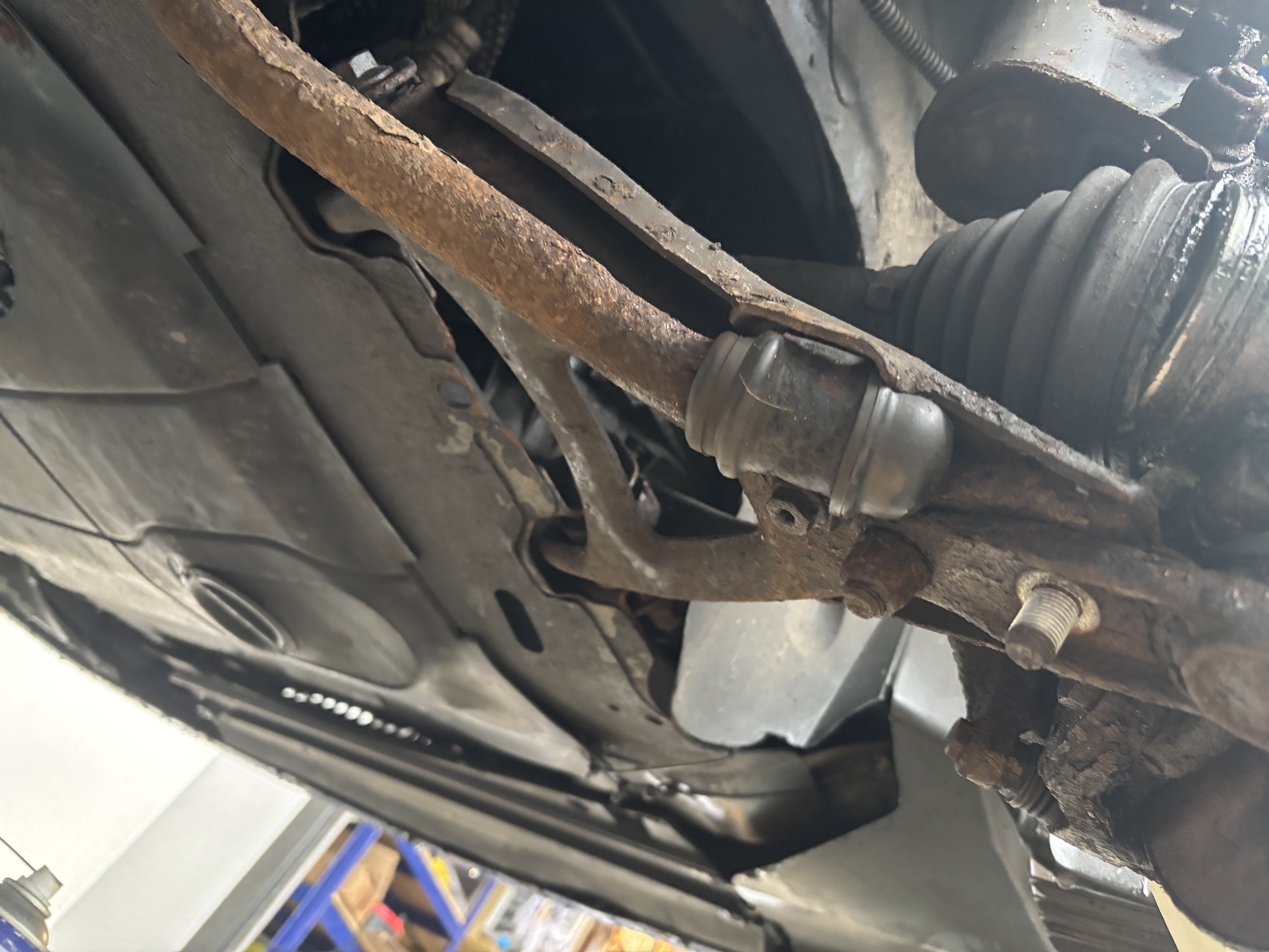

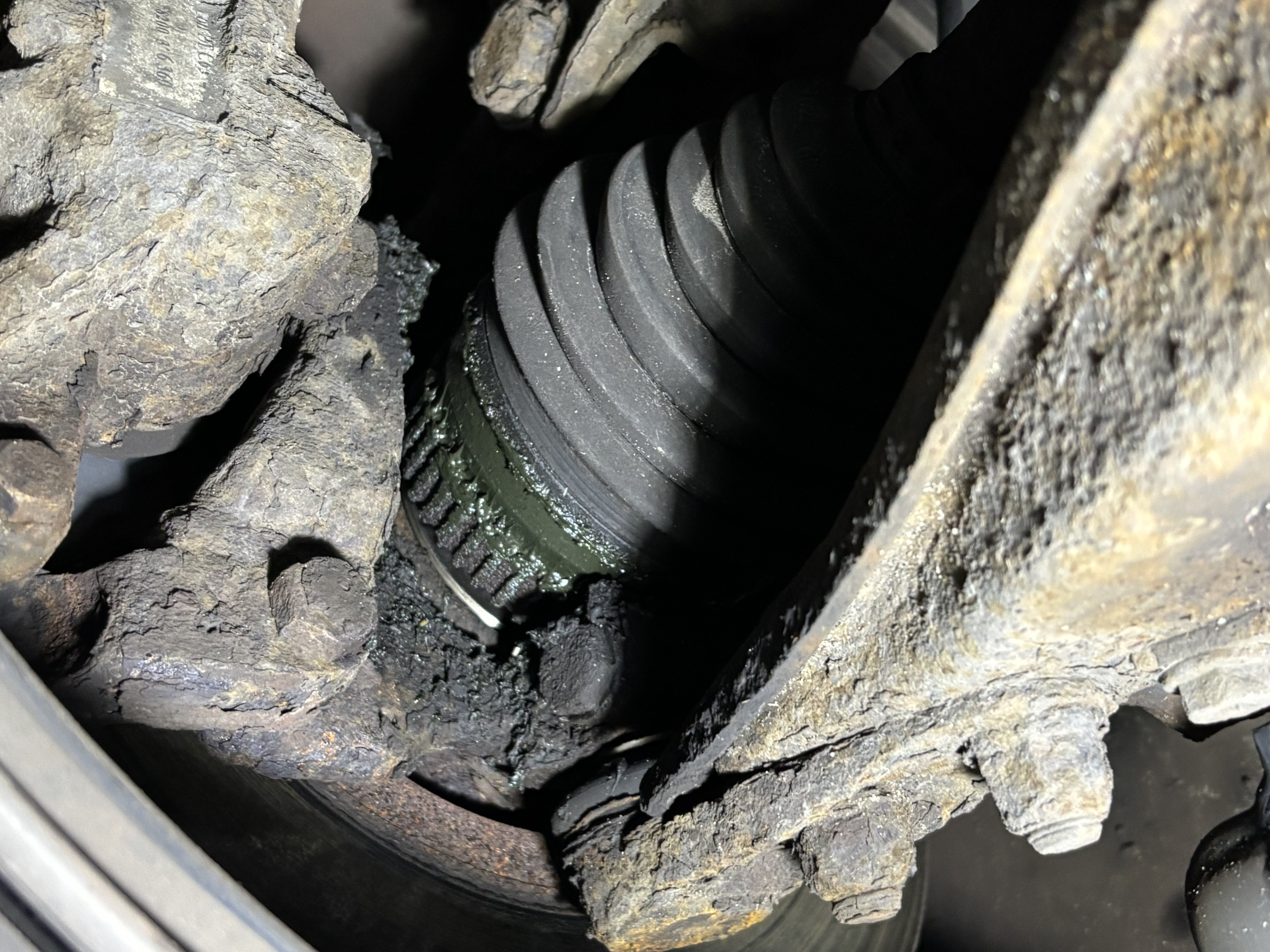

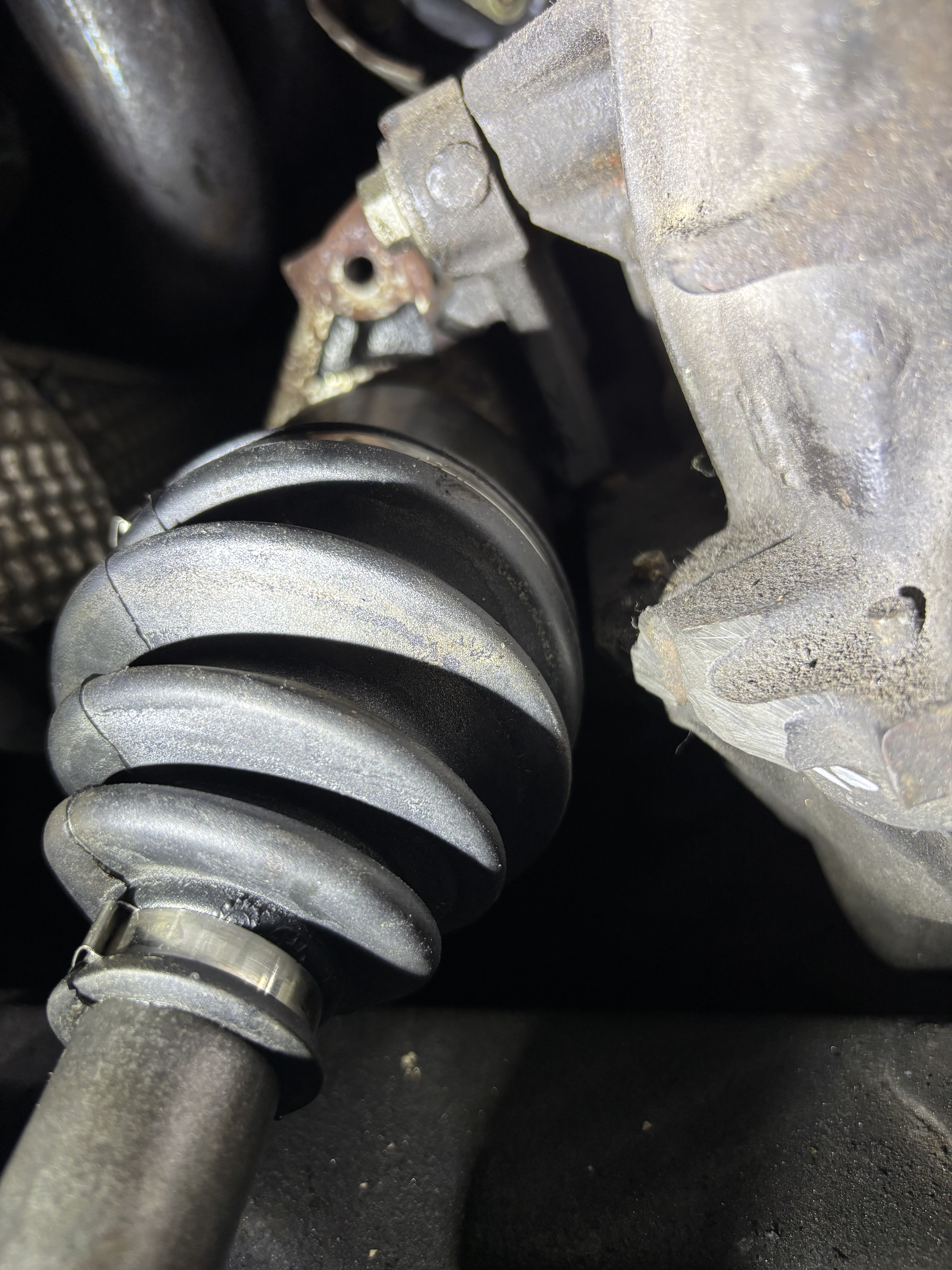

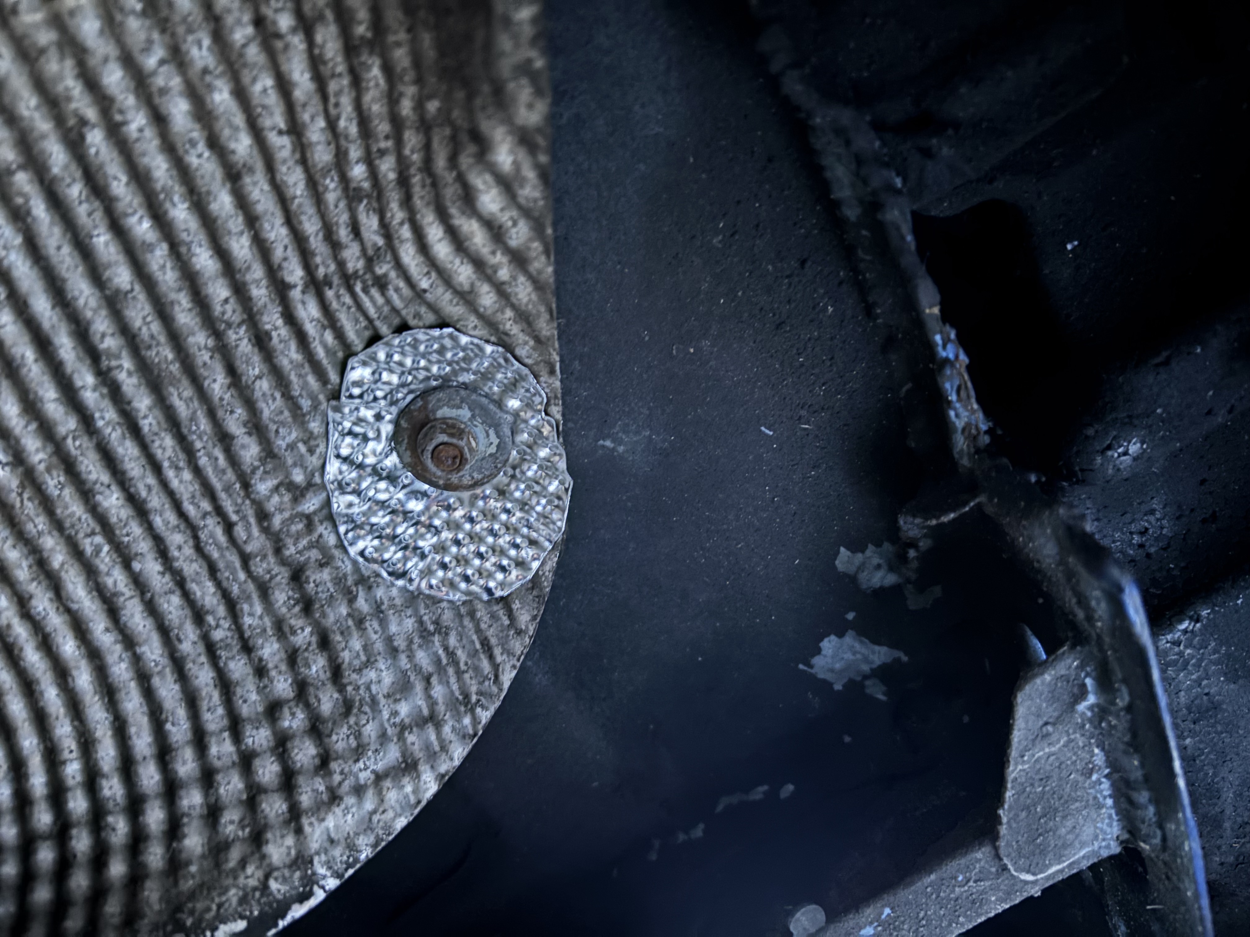

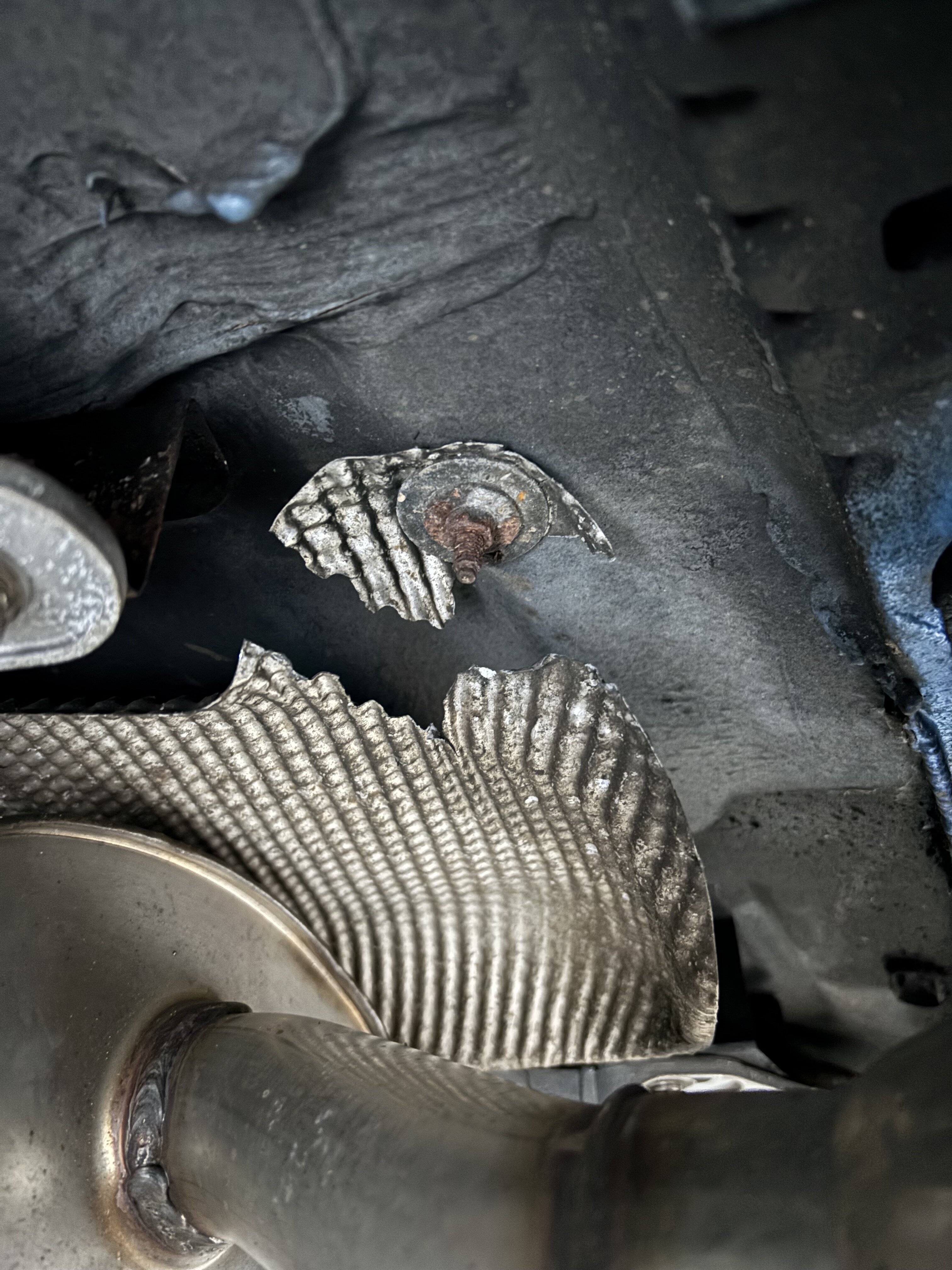

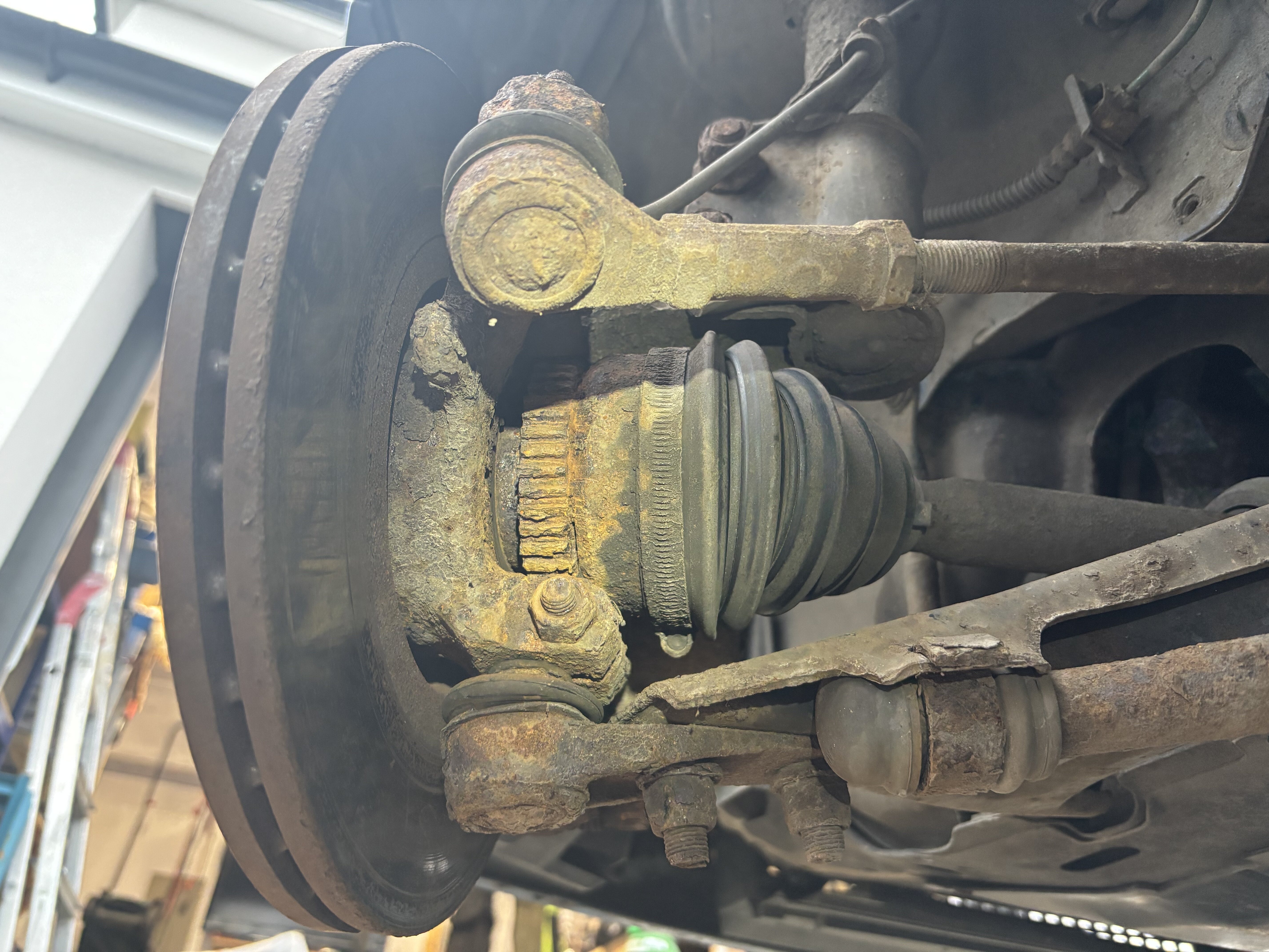

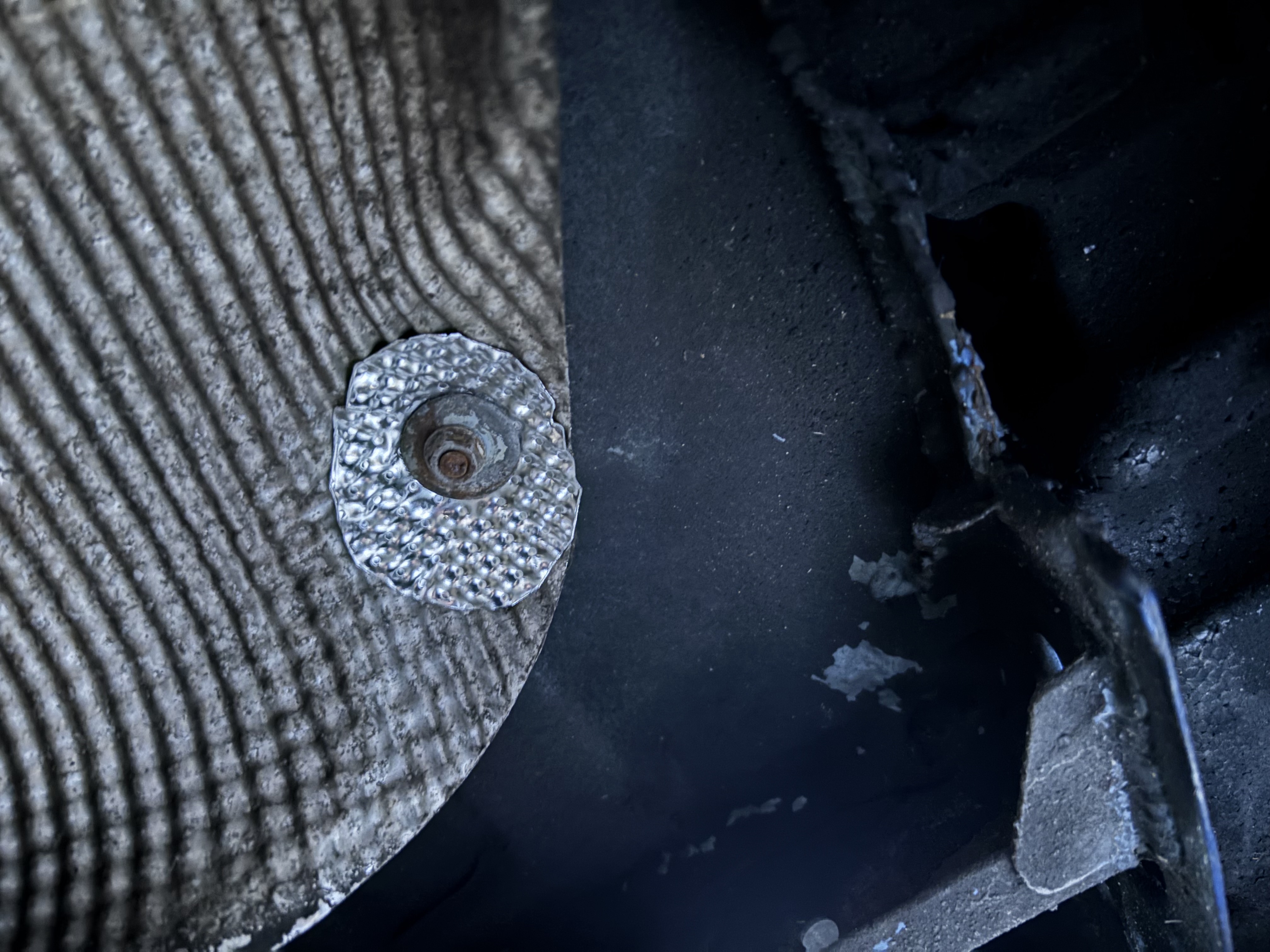

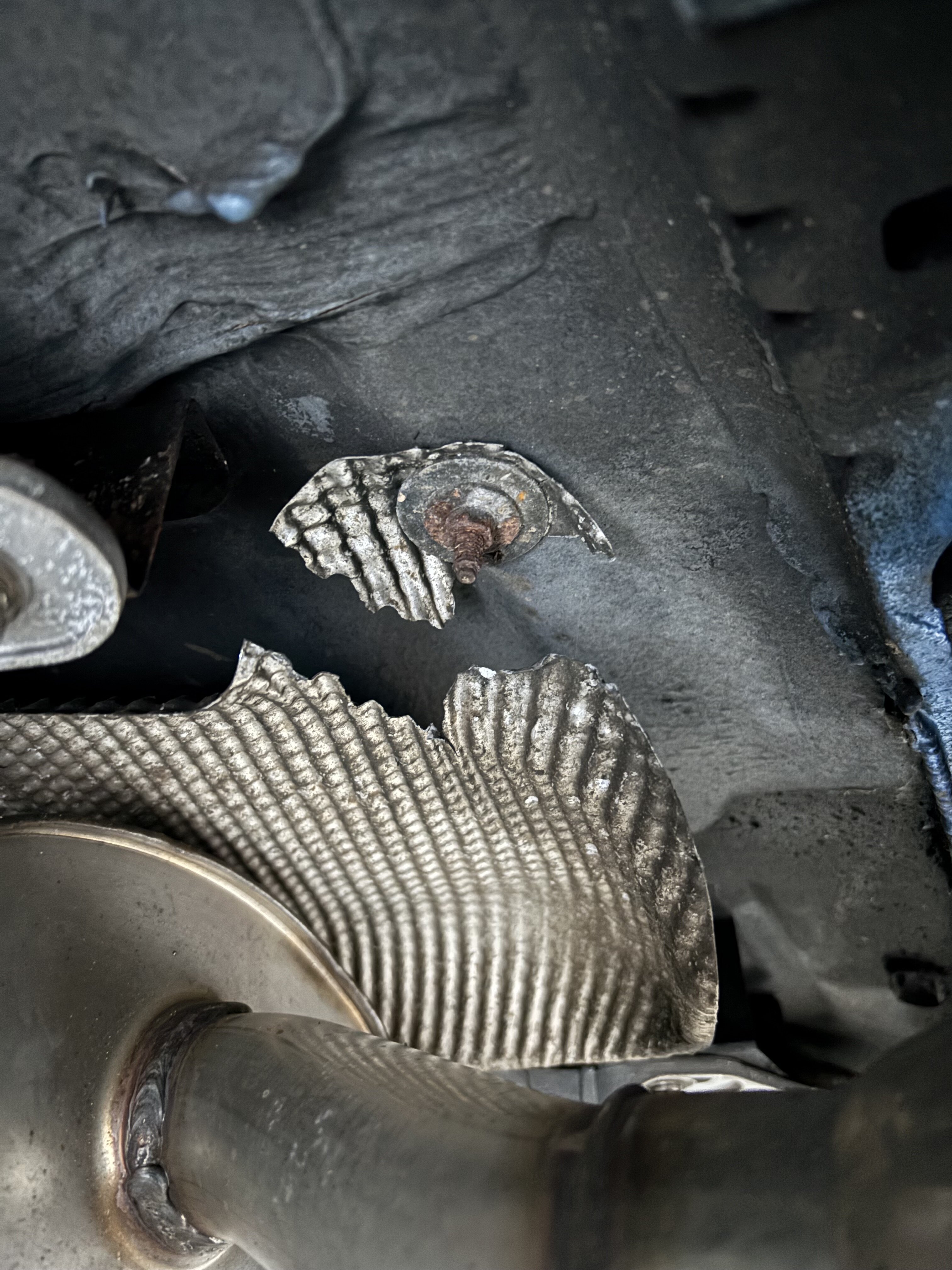

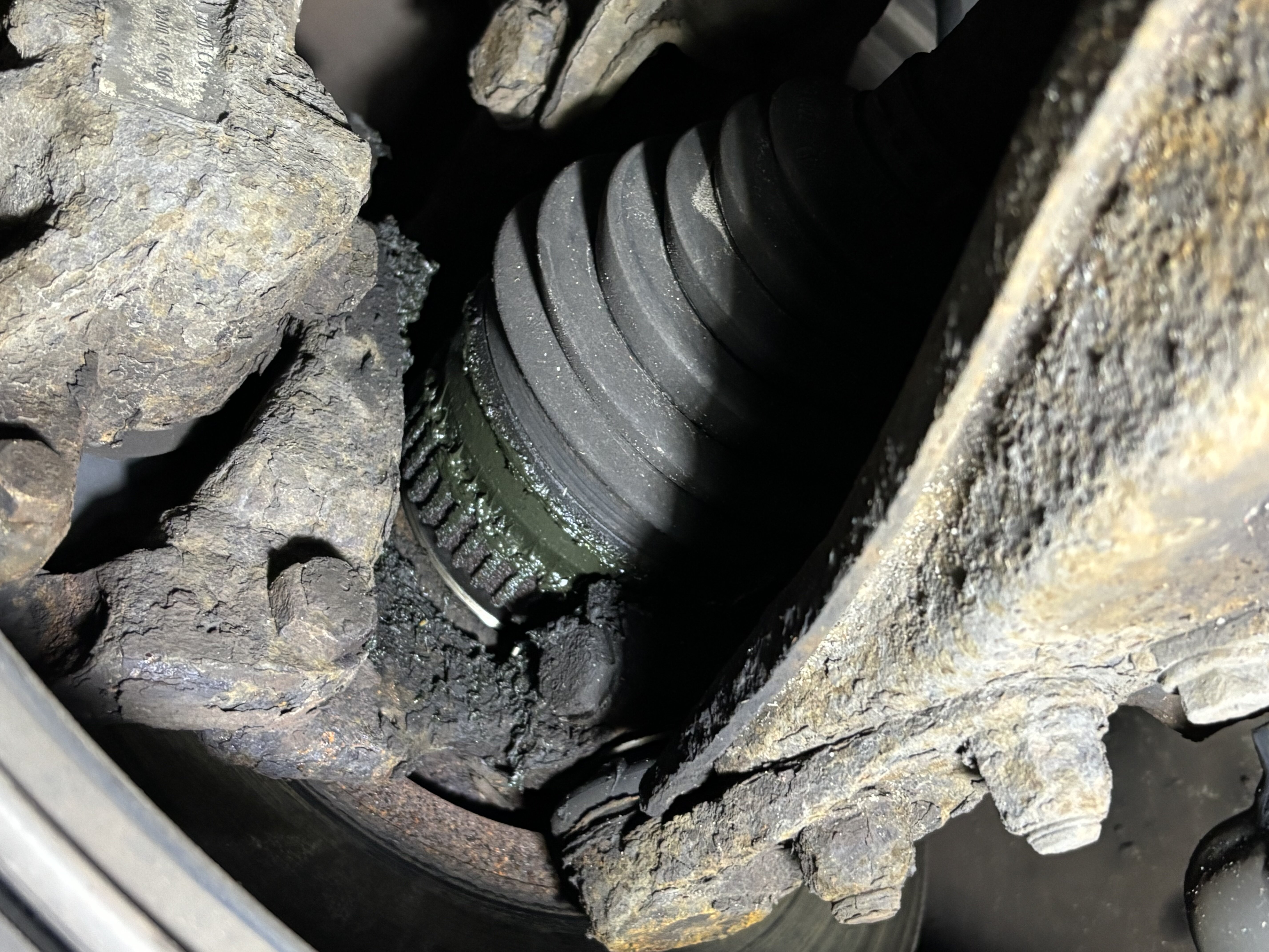

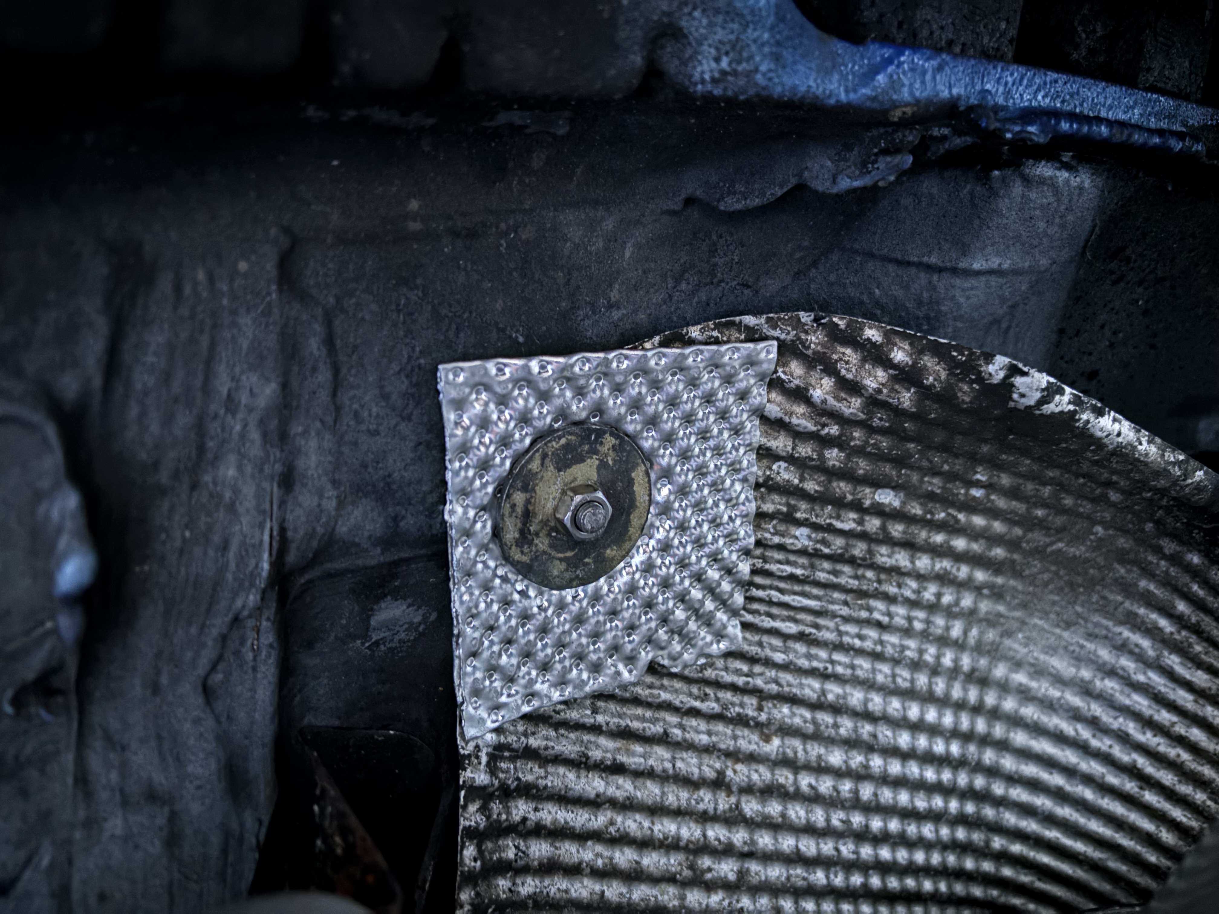

Sorted the heatshield out this afternoon, it had pulled through on one side and torn on the other. Sorted now. Whilst I was under I noticed that the intermittent ABS light will be because I’ve got a CV boot clip off and probably a bad CV now. Anyone else done one on their driveway?!

I doubt it's bad, if there's grease around it it still has some in. Id pull it back as much as you can, fill it up and shove a jubilee on it.

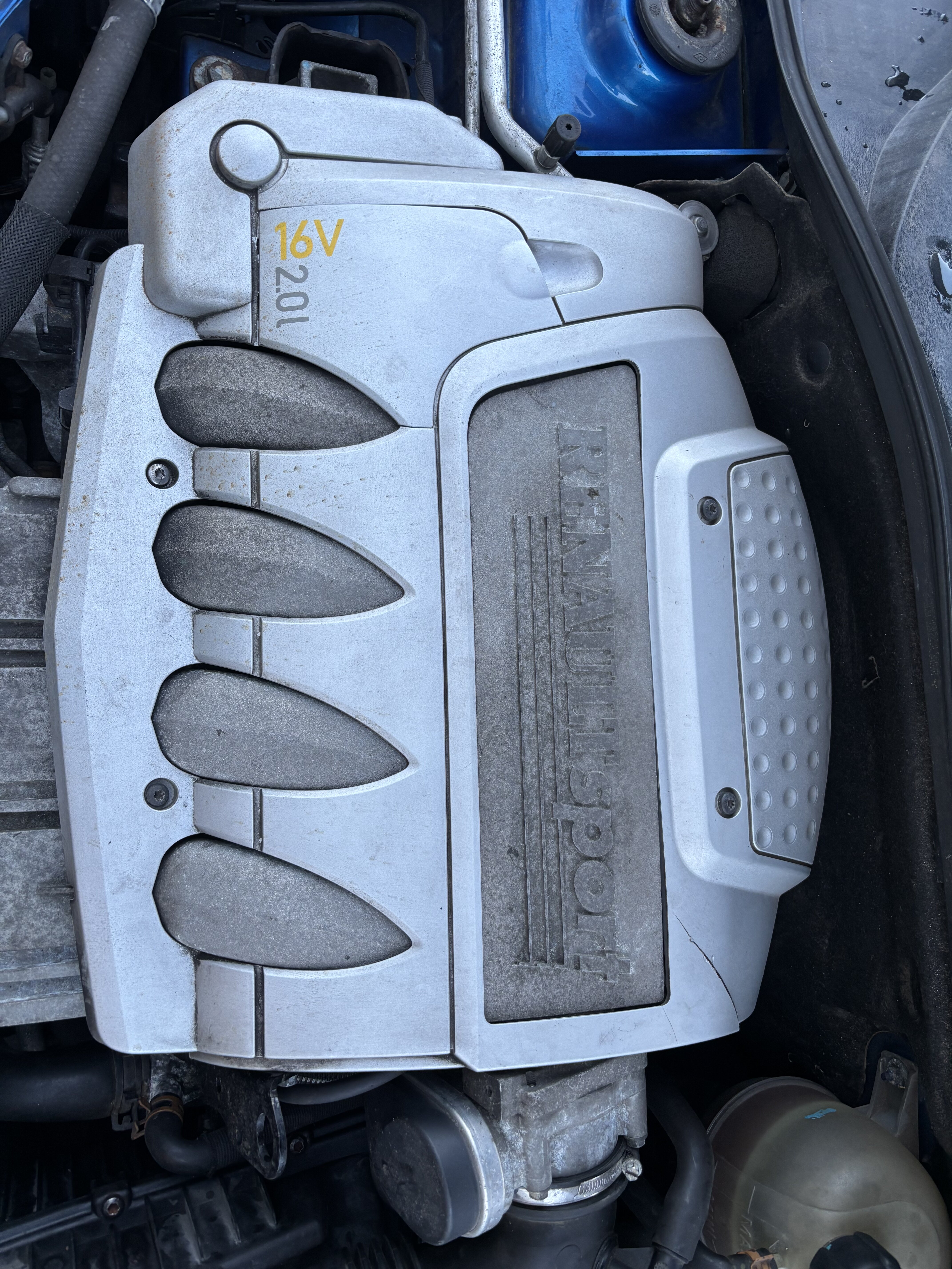

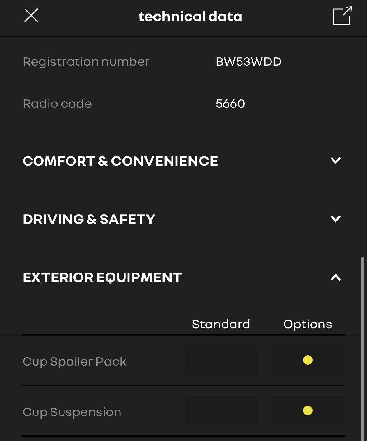

Great to see Paul today at The Motorist, horrible weather but a lovely chat! So kind of him to give me his old engine cover and airbox; thanks again pal. Downloaded the Renault App after he said he thought mine WAS a FF (which I’d discounted as it doesn’t have the chin spoiler), turns out he’s right of course and it is! Happy days, particularly as now I know which cv joint kit to get
Nice to meet you too mate and it's good to see those parts going onto a nice standard'ish 182. Ktec used to do the front lip but it's mega money so most fitted a Skoda fabia splitter. Search on here for the part number although the fabia part may be nla now too.

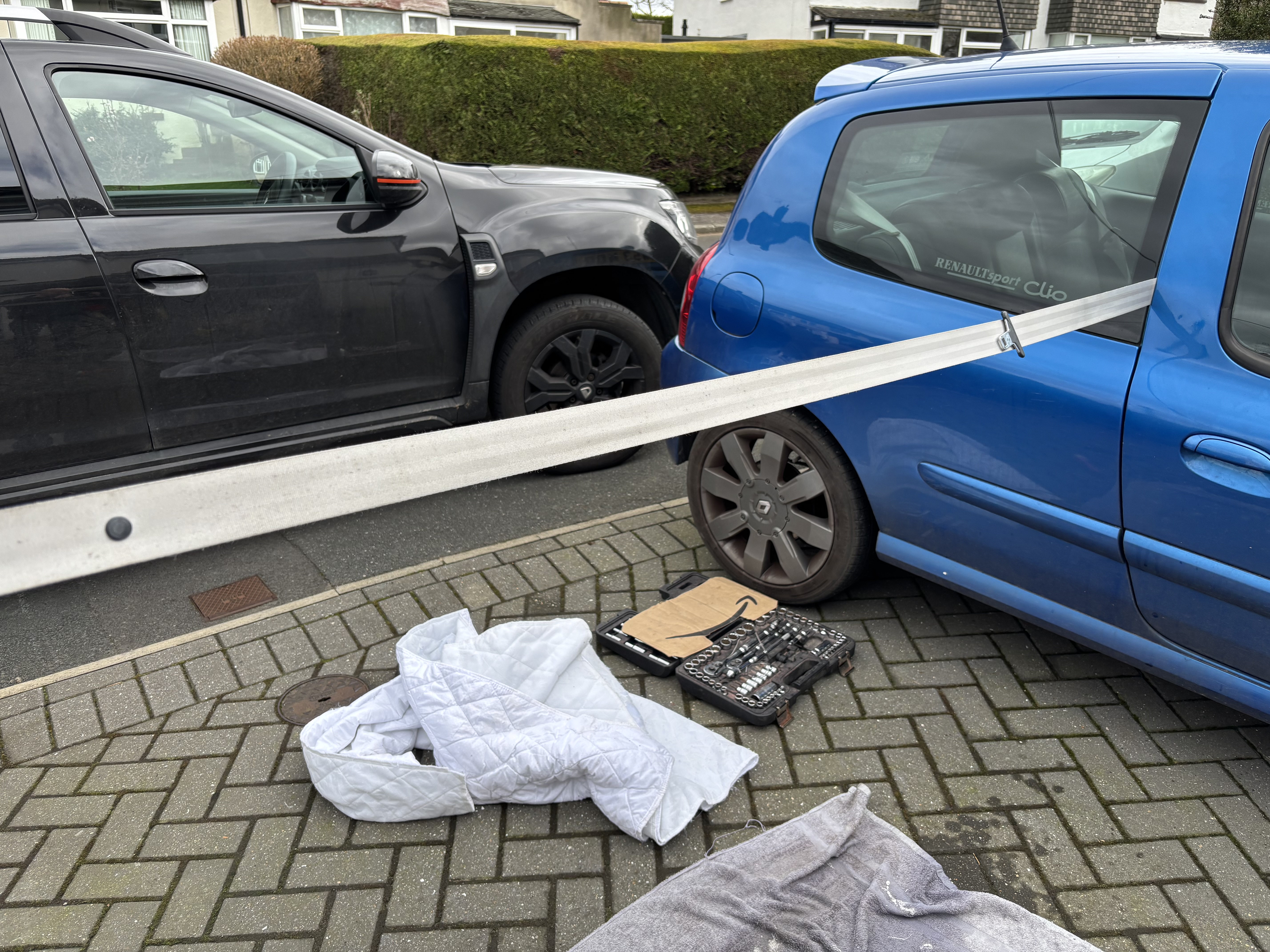

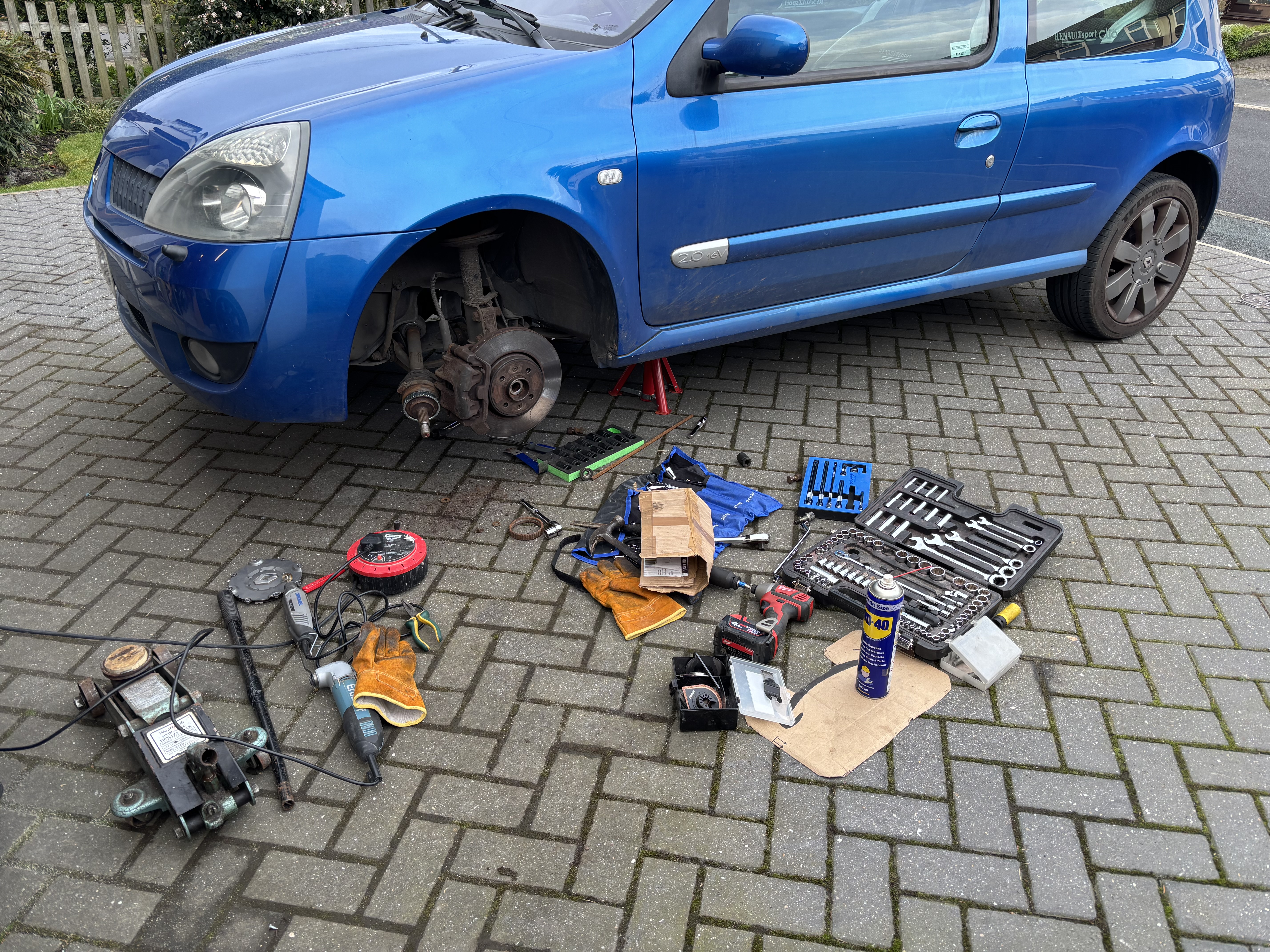

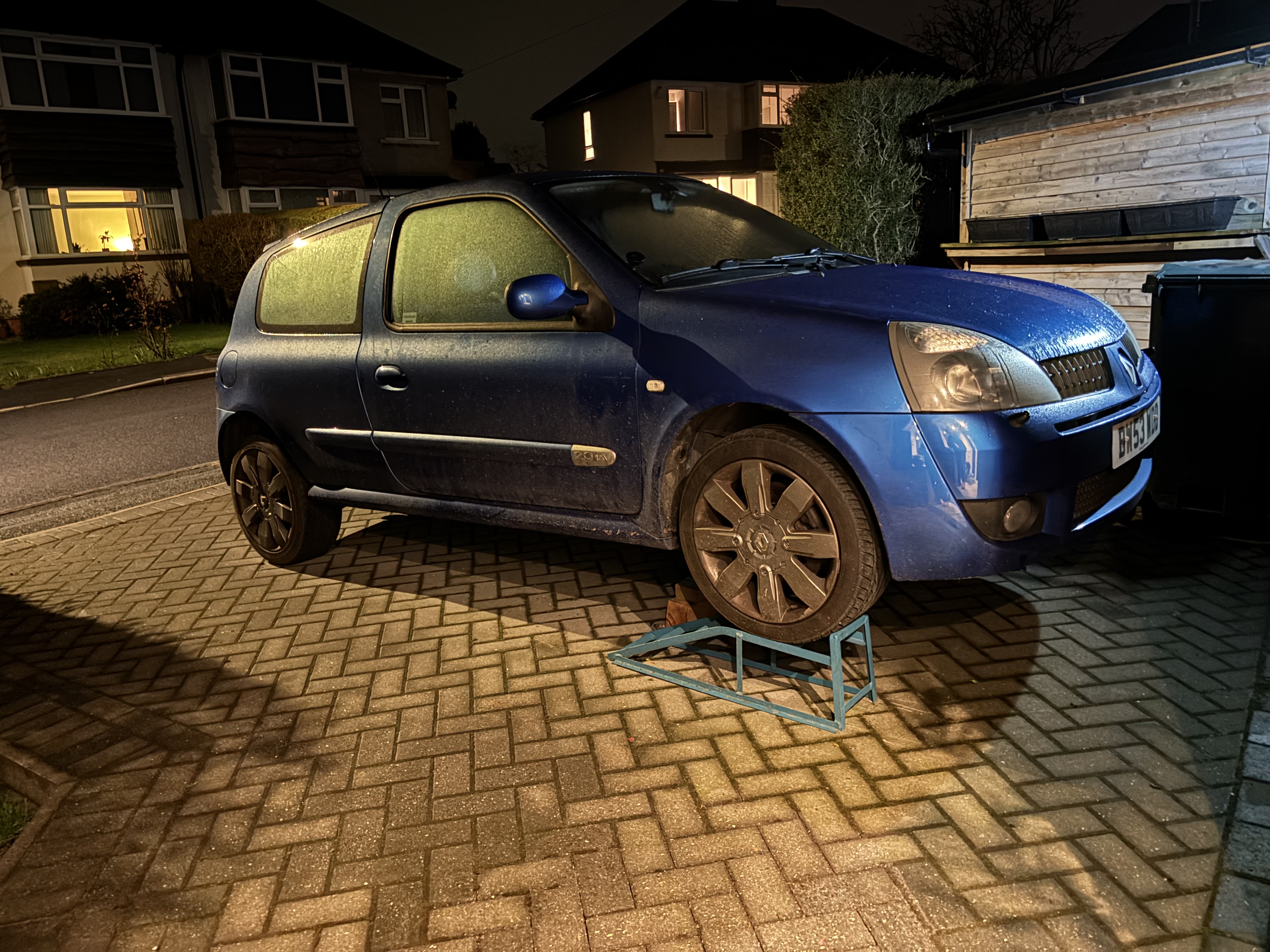

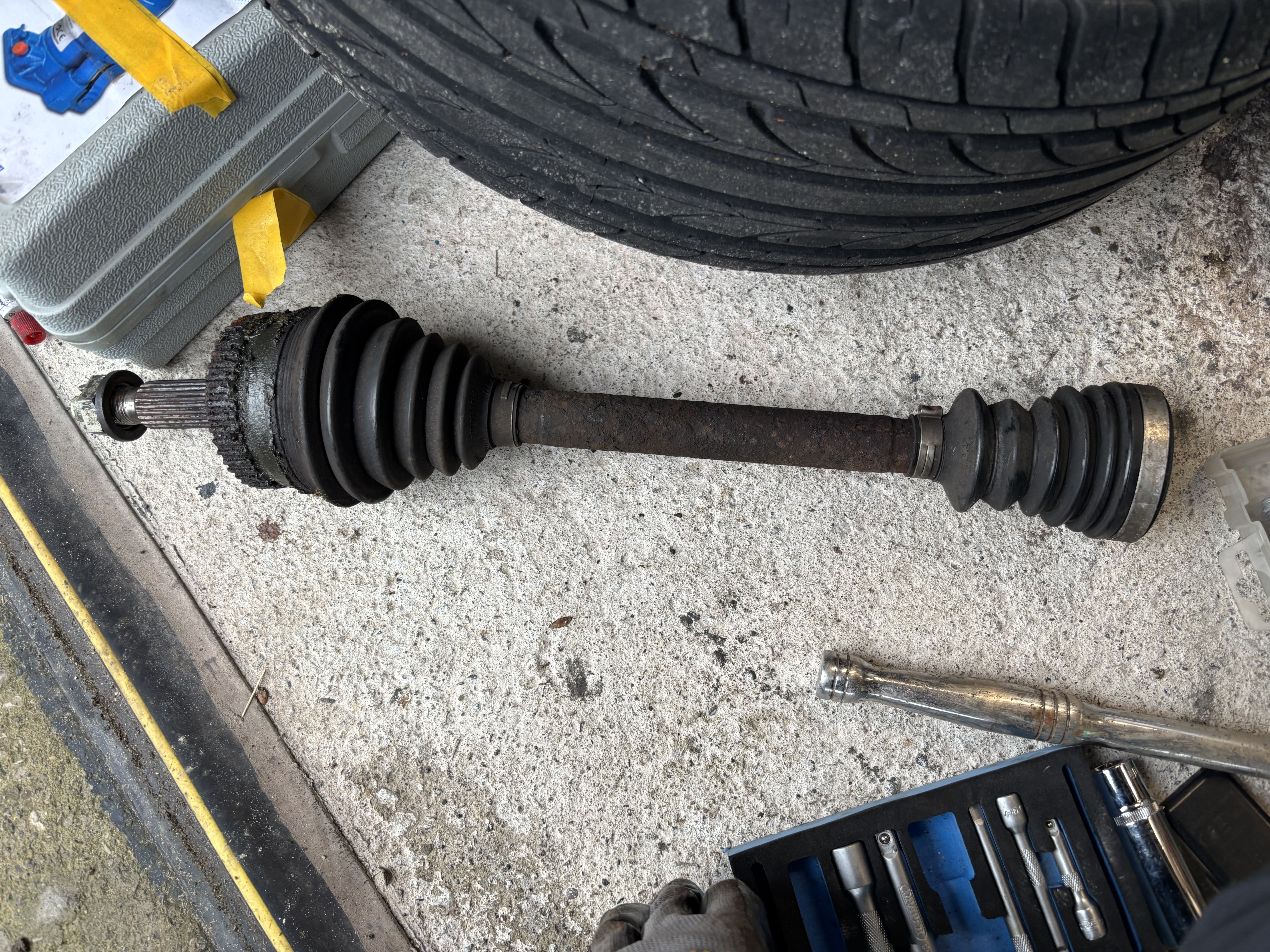

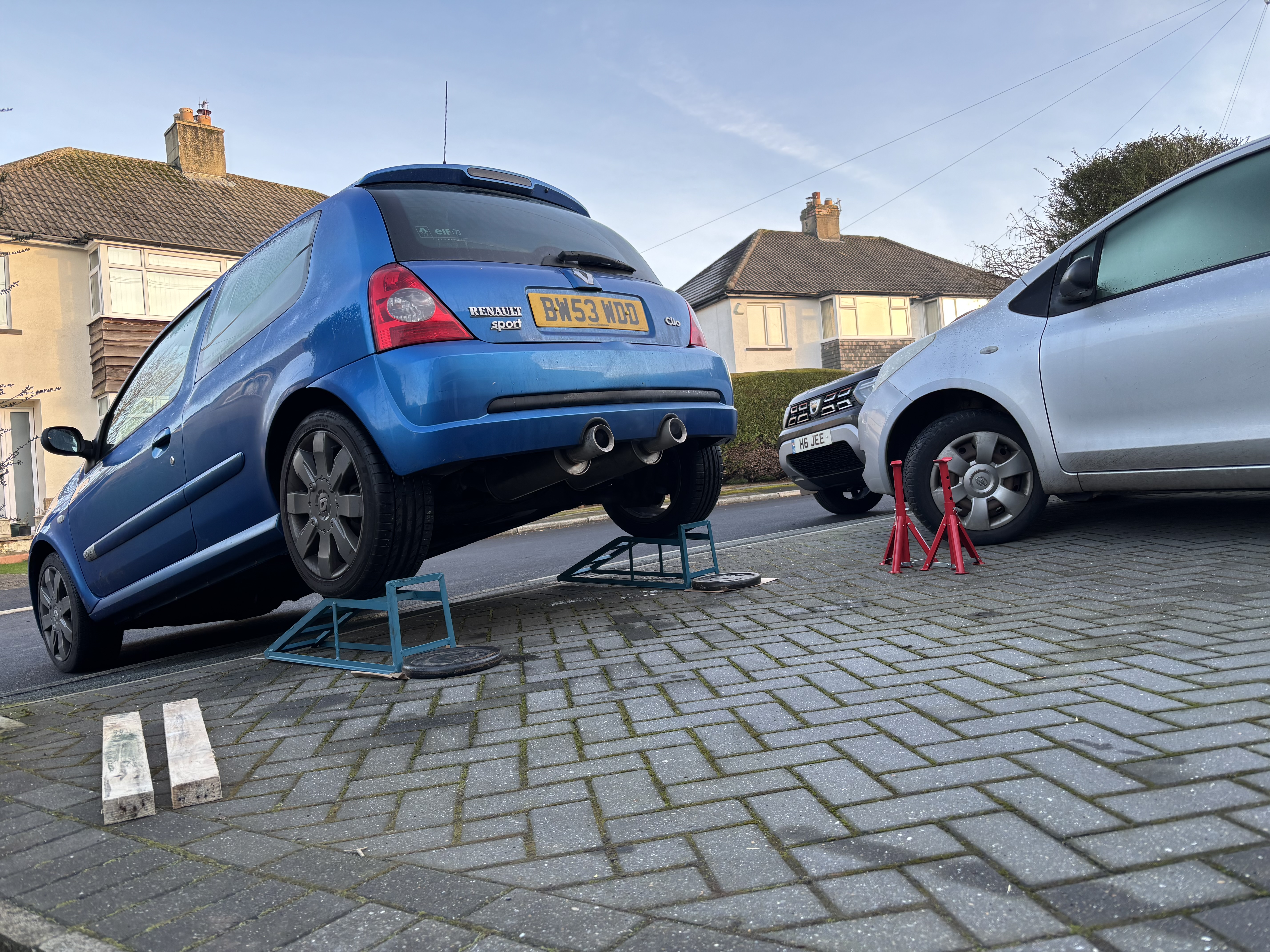

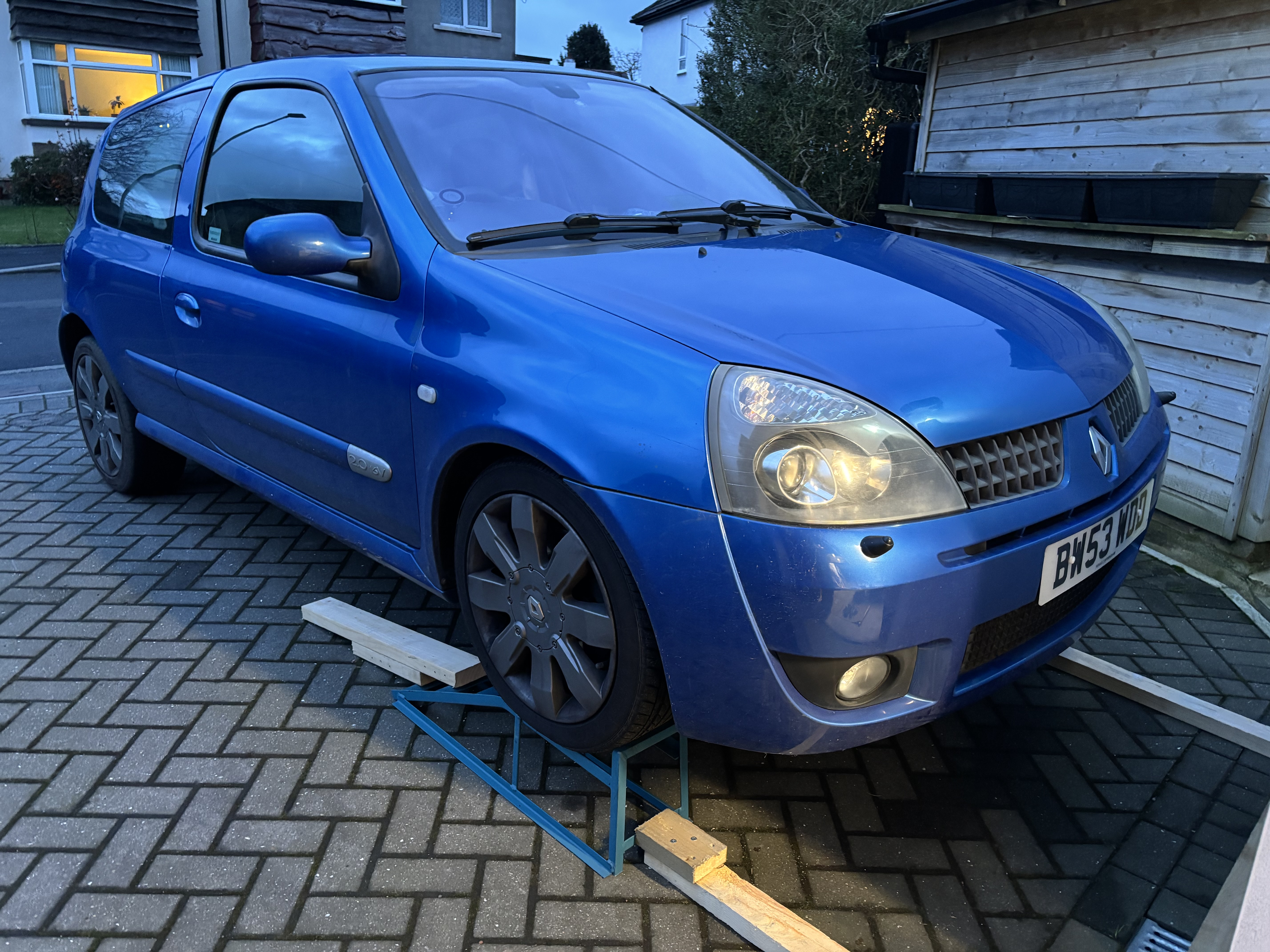

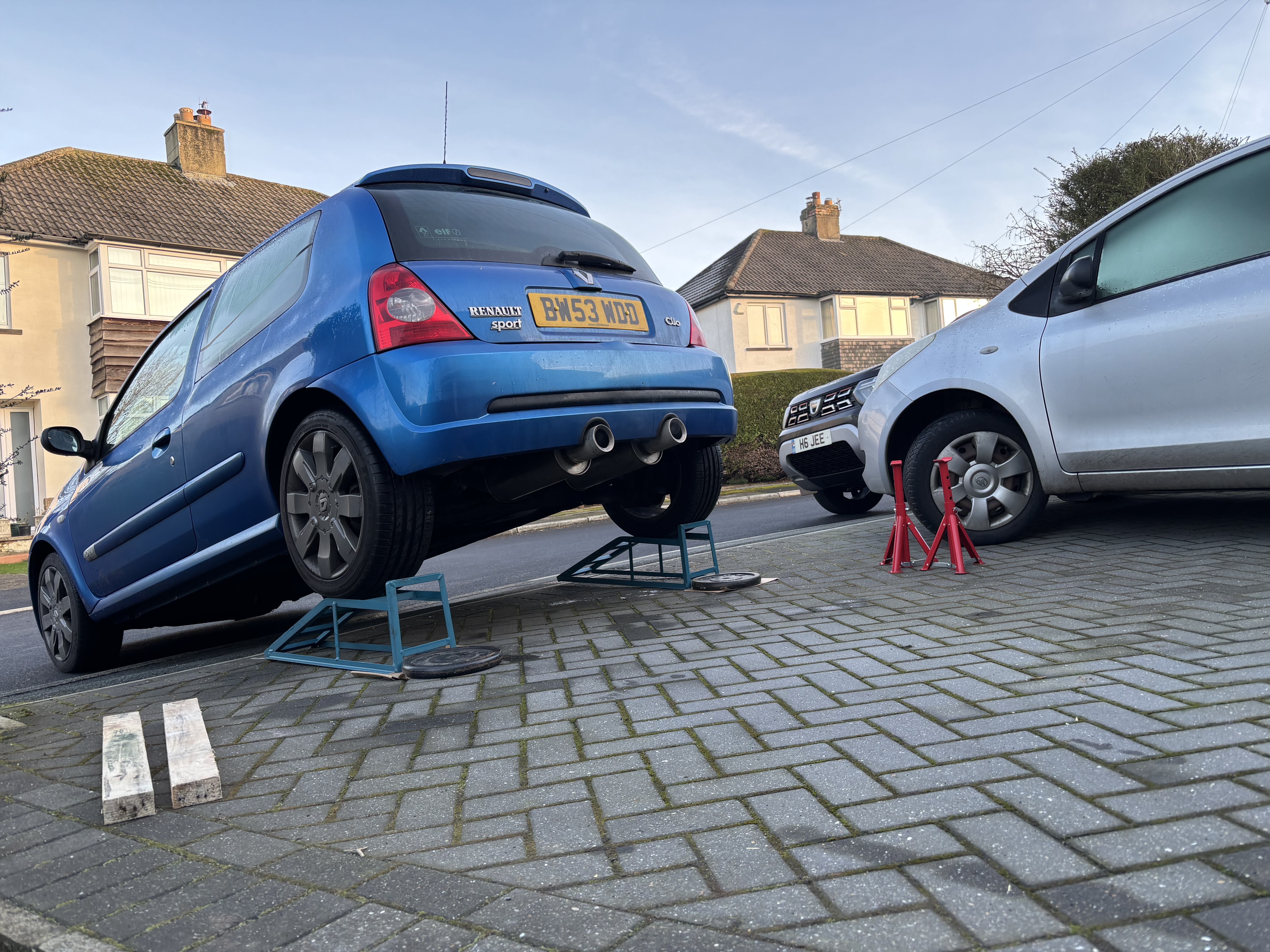

Have had my Borg and Beck driveshaft delivered and put a wider ABS ring on (which was a struggle, needed to heat it up before I would tap on). Got as far as getting the Clio on ramps to do it (I need a trolley jack) which I then lift it off on to axle stands nice and high to work off. Has been like that for a week after I got gastroenteritis and have been out of action since. Some grim times believe me. Anyway with the wife complaining ever louder I plan to brave the bad weather and get it finished this weekend
s**t that’s not nice, can’t imagine working on a Clio in this weather and feeling unwell on top of it! Good luck with the work. Hope it’s dry this weekend (for all of us driveway technicians!)

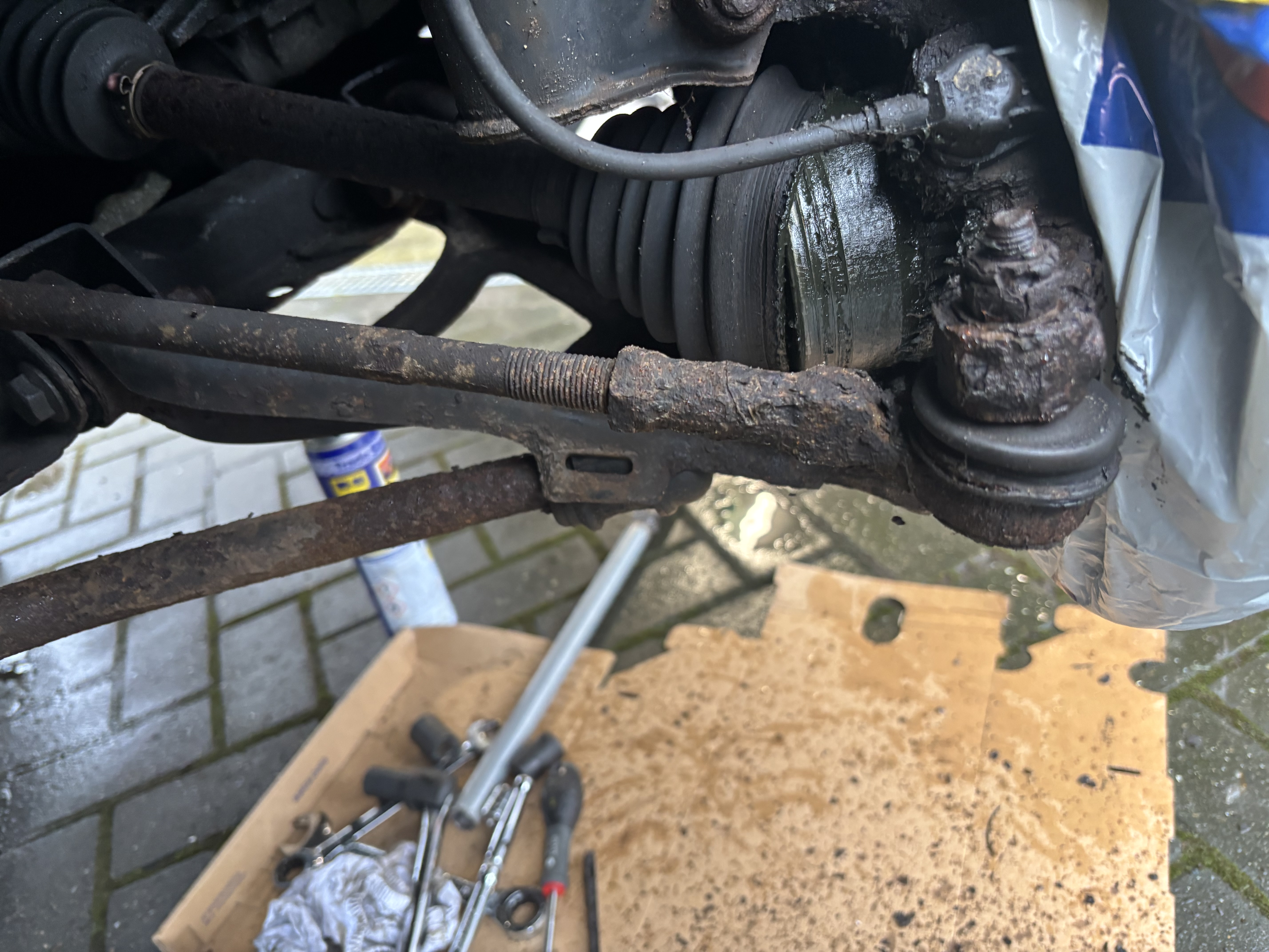

Struggling with some pretty rusty bolts and still feeling rough so taking it slowly, but progress is slowly being made. Filthy wet cold weather to be rolling around under the car, not pleasant. Found out there’s an anti roll bar bush outer bracket missing as well…

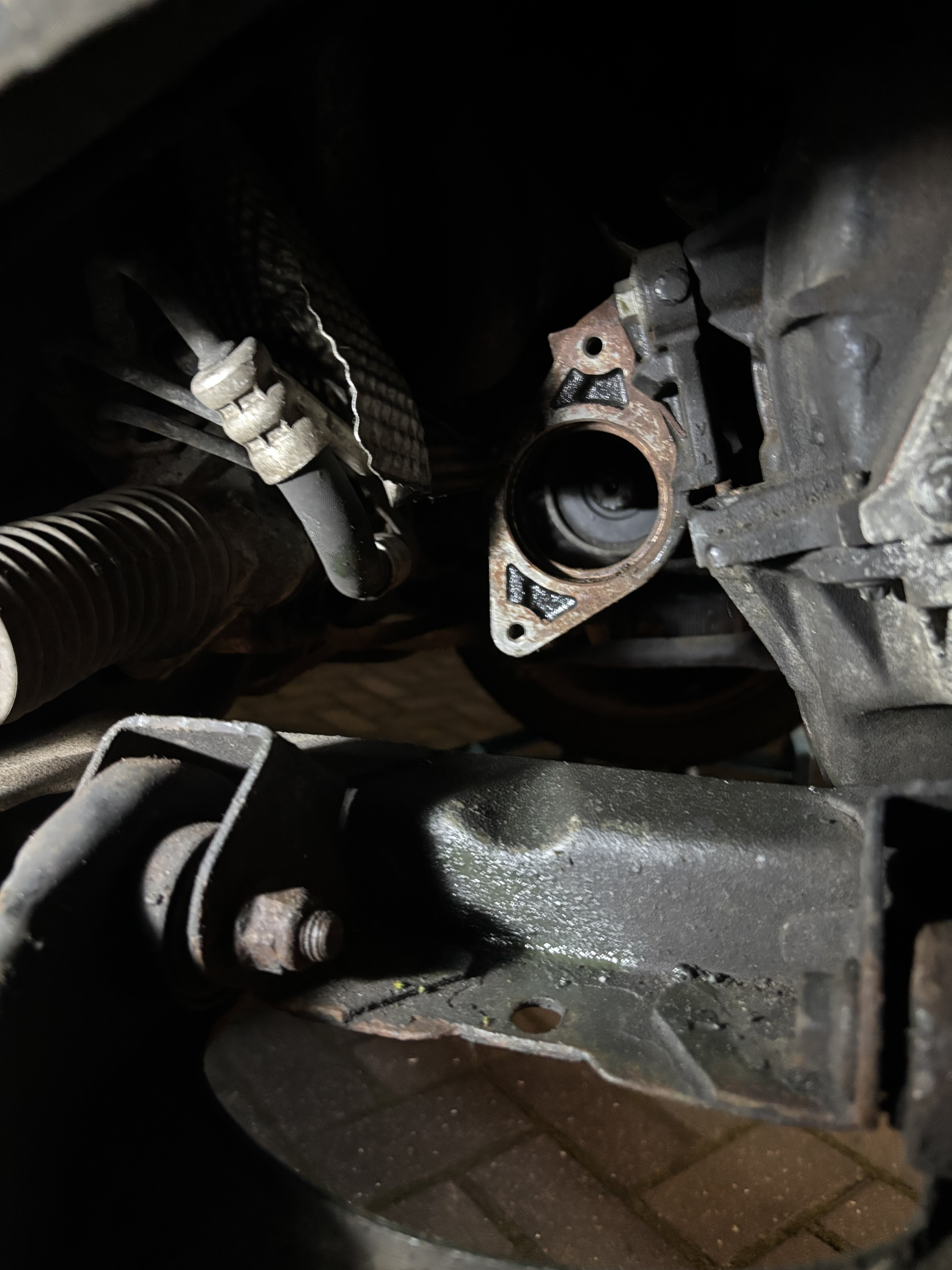

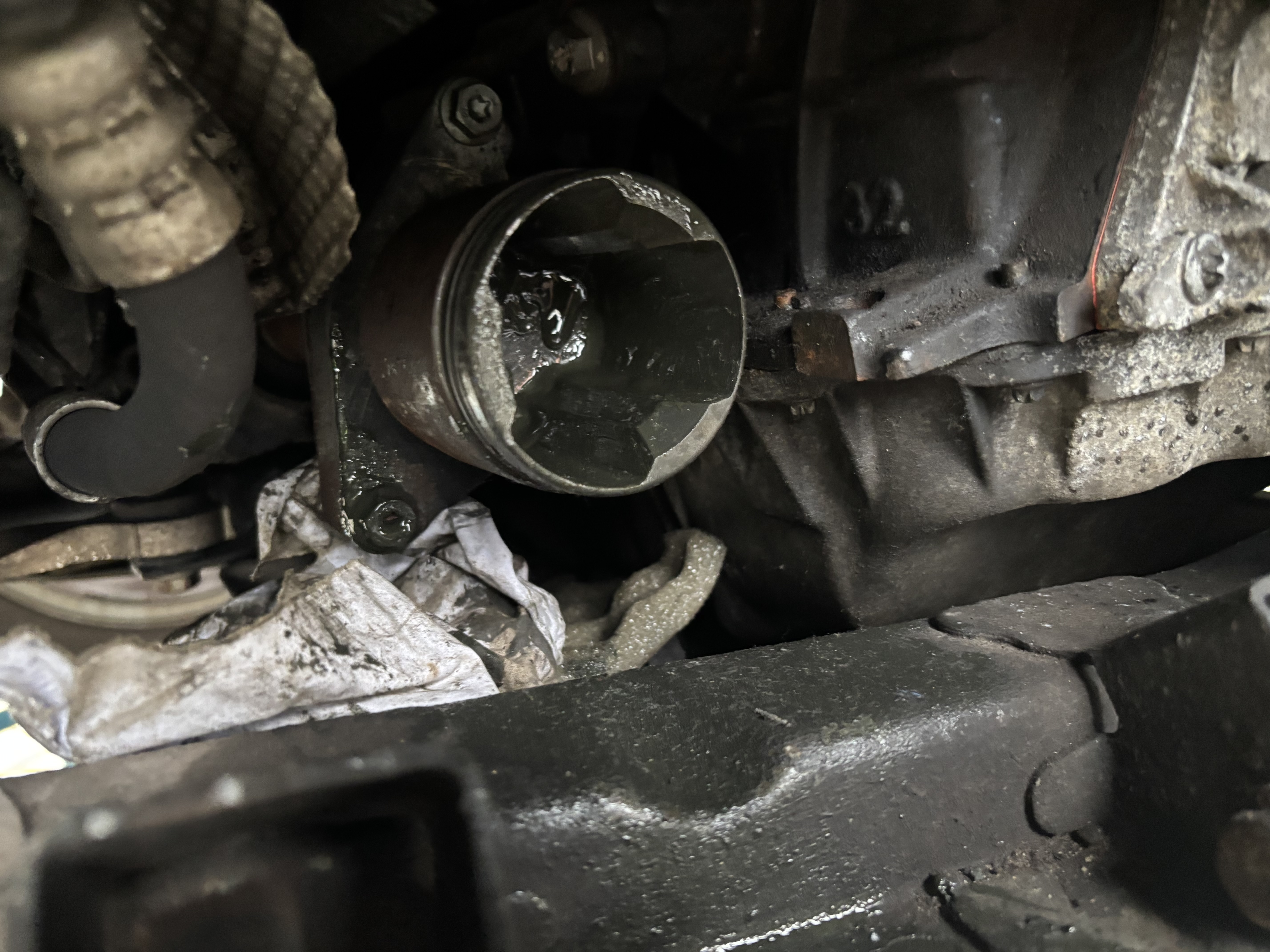

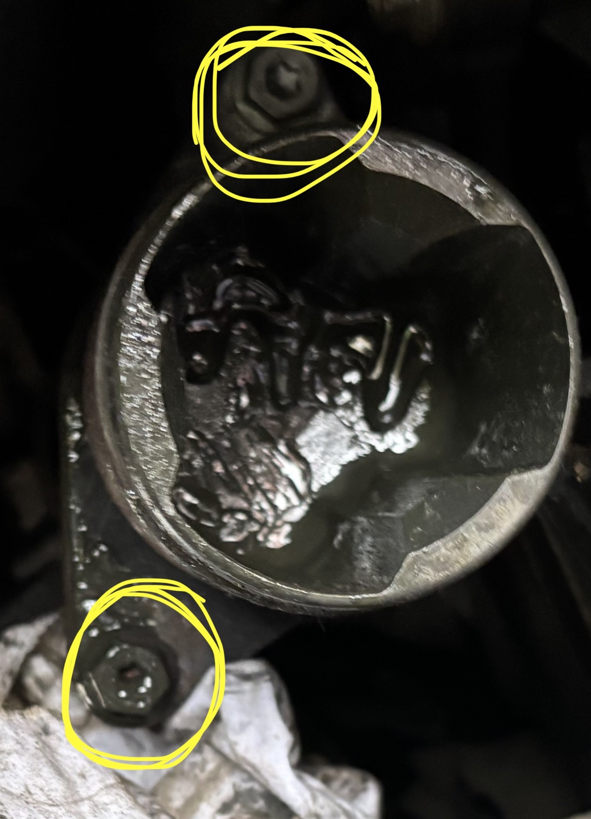

Having a nightmare with this. The old driveshaft has come apart and I can’t get the bit that’s still in the engine out. Suggestions welcome!
Wish I could offer some advice.
I’m in a similar position to you, rust, snapping bolts and occasional bits that are beyond me. You did make something click for me though- the mystery brackets I painted and prepped last year are arb brackets. Checked my PMS invoices and sure enough, I bought brackets and protected them ready to put in the car when I do the power flex bushes. Just forgot what they were 🤣.
Get better and good luck with the driveshaft part.

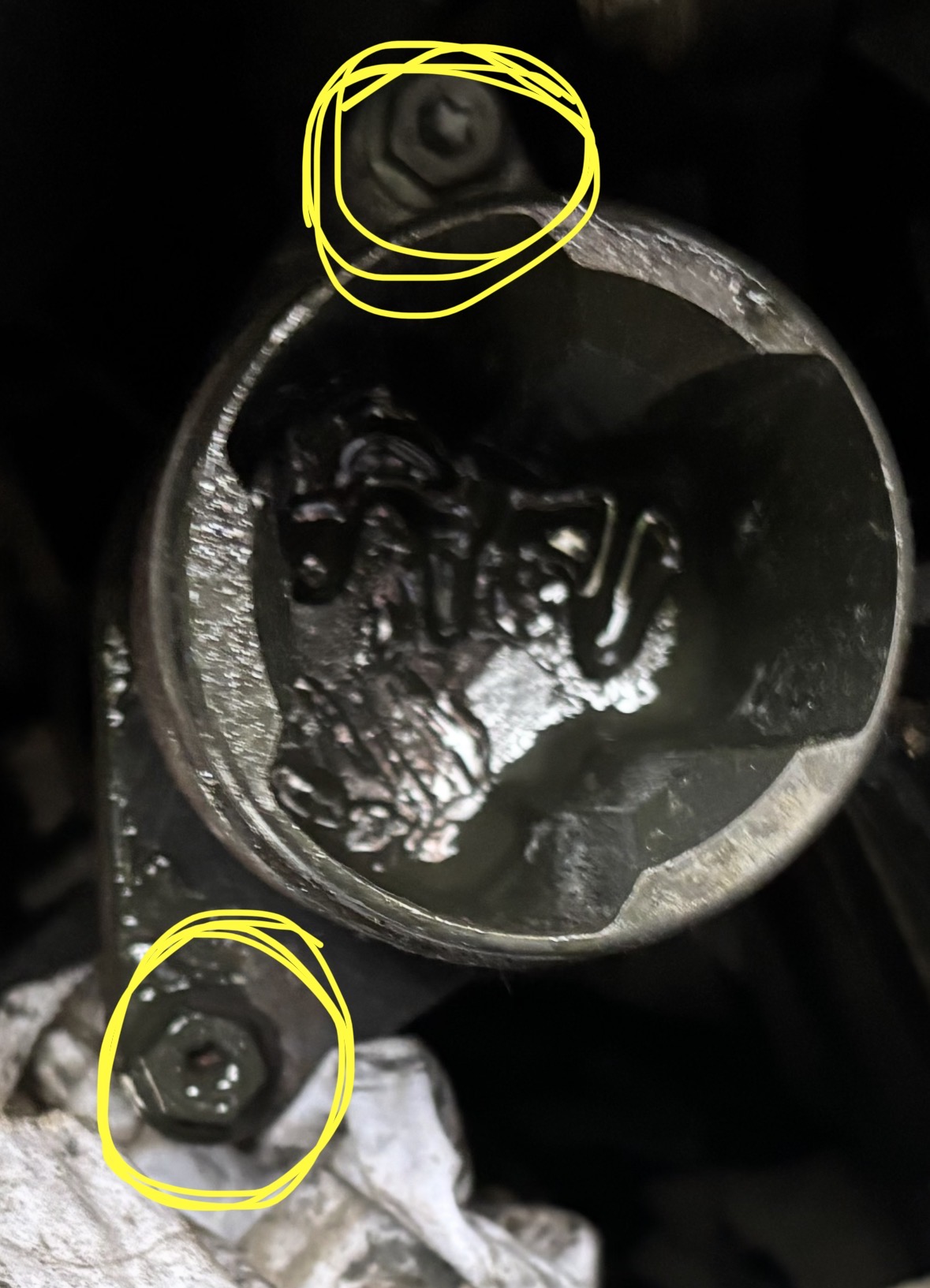

Undo the 2x 13mm bolts on the intermediate carrier and take the plate off that retains the bearing. Knock the bearing out with a punch if its tight
Not sure but I might have been being stupid here… have I got to take these bolts off too?
It’s out! Thanks everyone for helping, I think I was a bit dim and missed the two 13mm bolts and retainer plate when I was looking at the instructions first time round.
Got it off this evening and actually put the new one in but decided that it was a bit close to that bit of the engine that sticks out, so I got the angle grinder out and took it off. It looks to have a lot more clearance now.
I couldn’t see that the bit sticking out was functional and don’t fancy doing all this again because of a torn boot!
Just got to put all the bolts back in tomorrow and clean the disc up before the wheel goes on then I should be ready to rock and roll. Famous last words?!

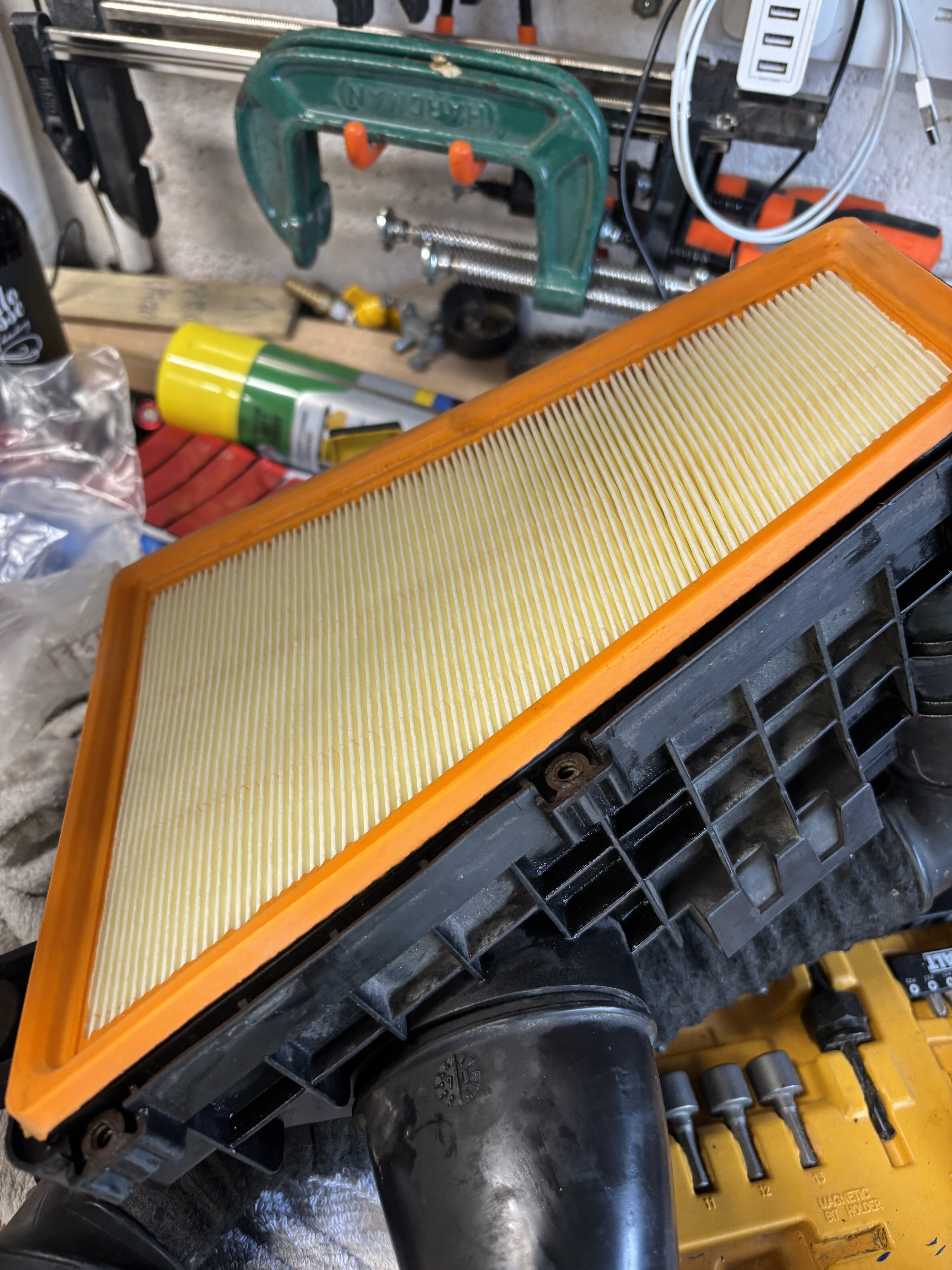

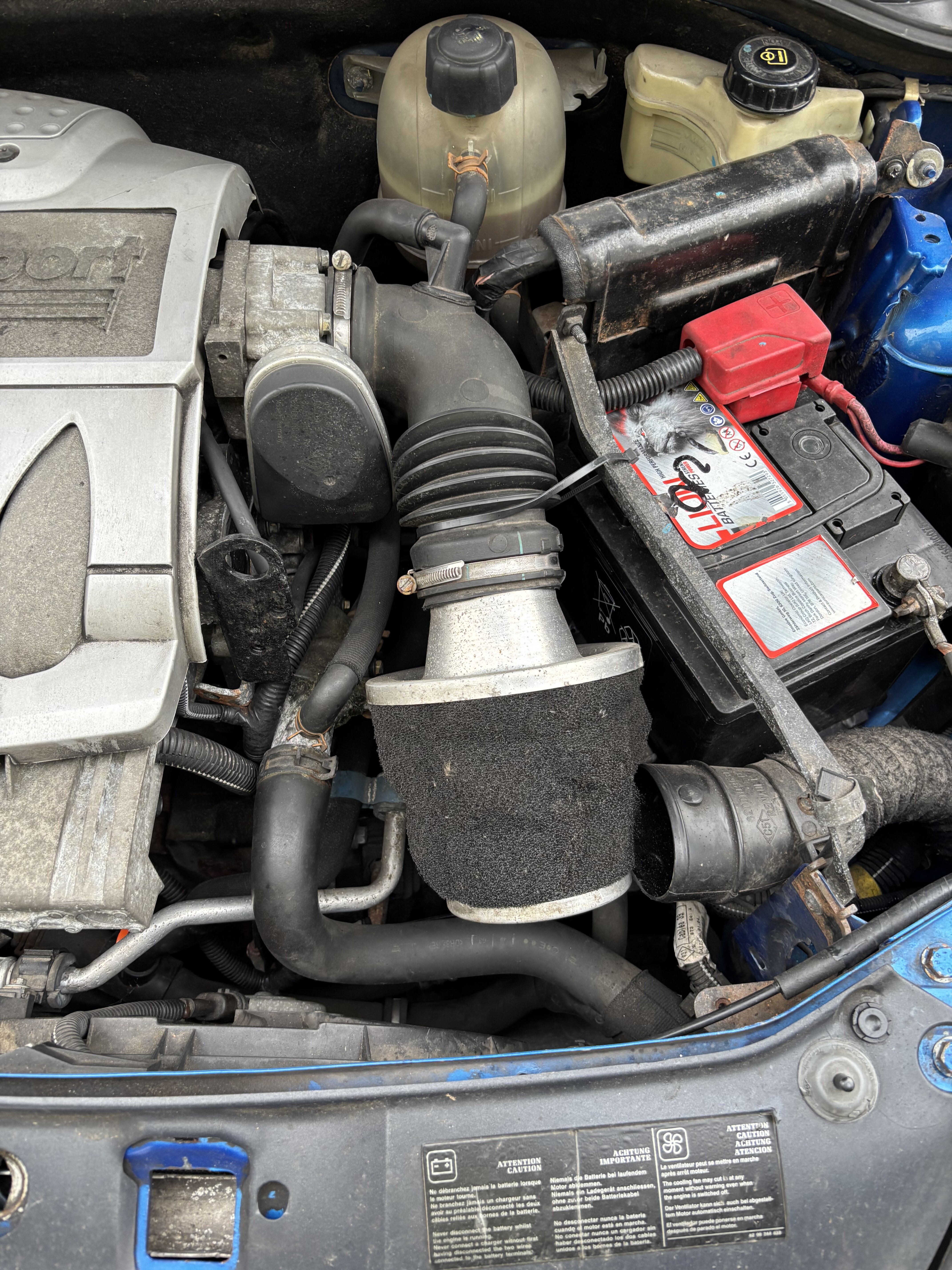

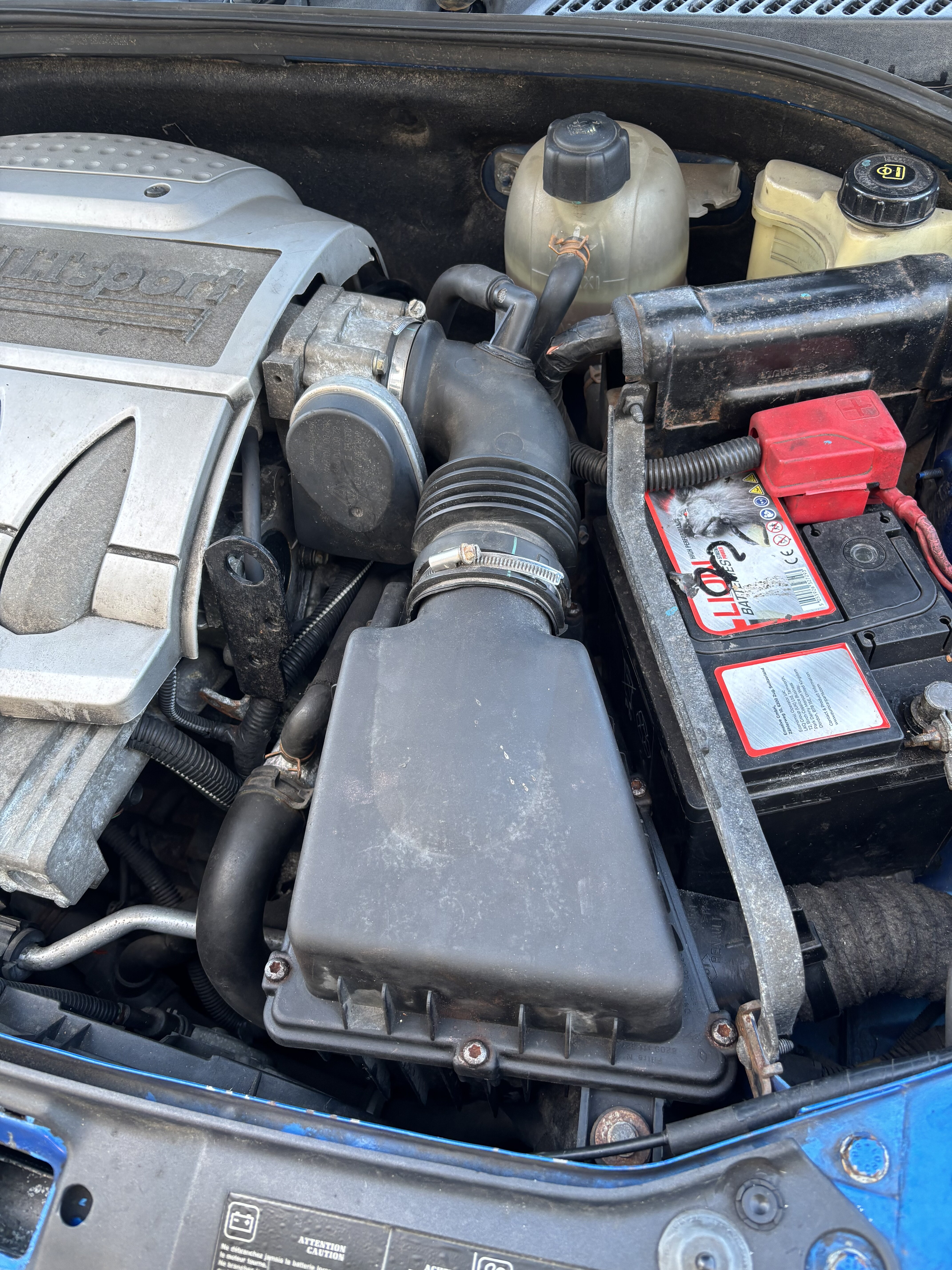

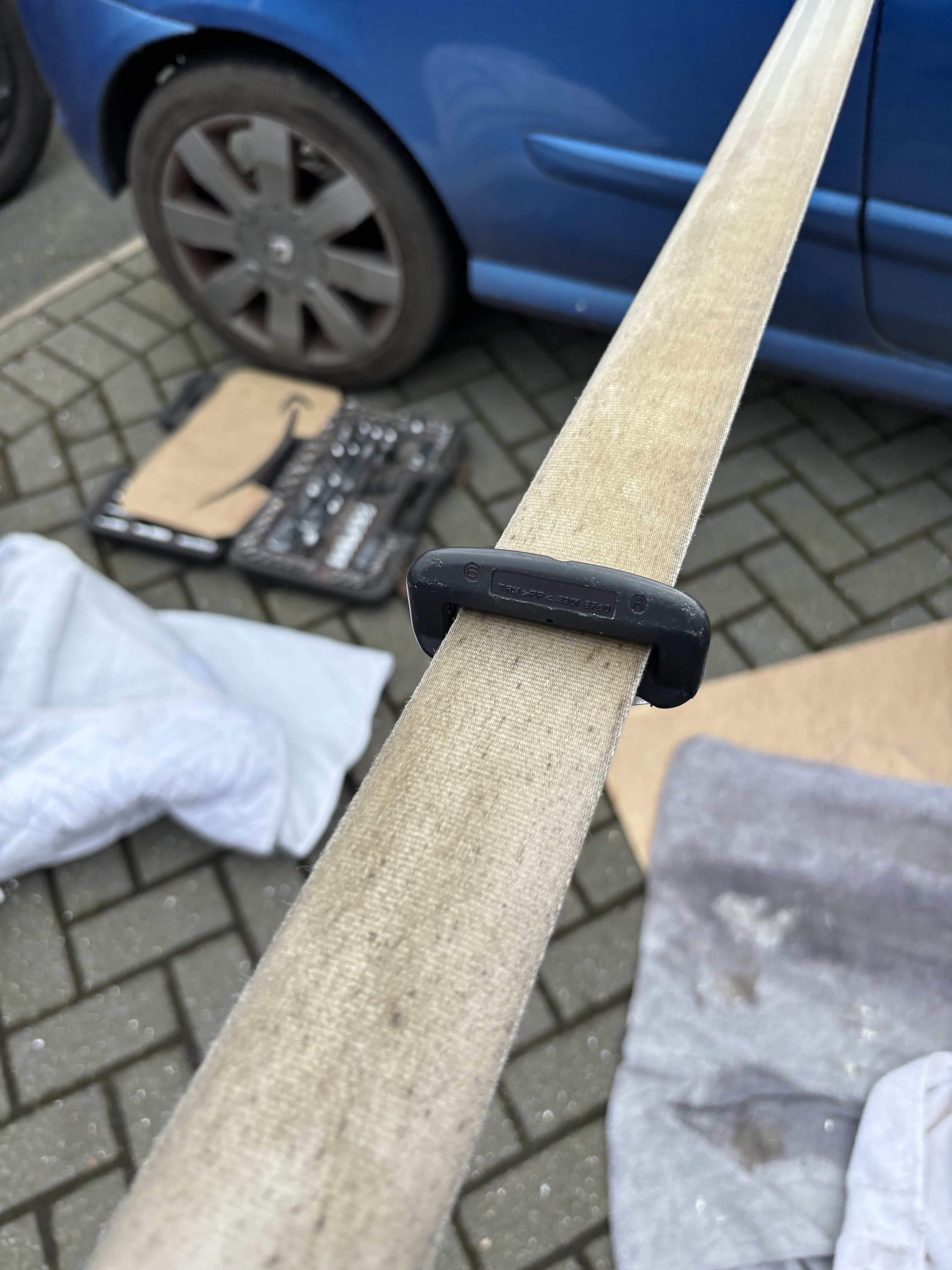

Done a few bits today. Started off cleaning the pretty grim seatbelts which are now significantly less manky. Steam cleaner and some Halfords auto fabric cleaner spray. Replaced the rubbish (and old/knackered) cone filter with an original airbox complete with new panel filter in it. Had to wire brush the bolts, they were very rusty.

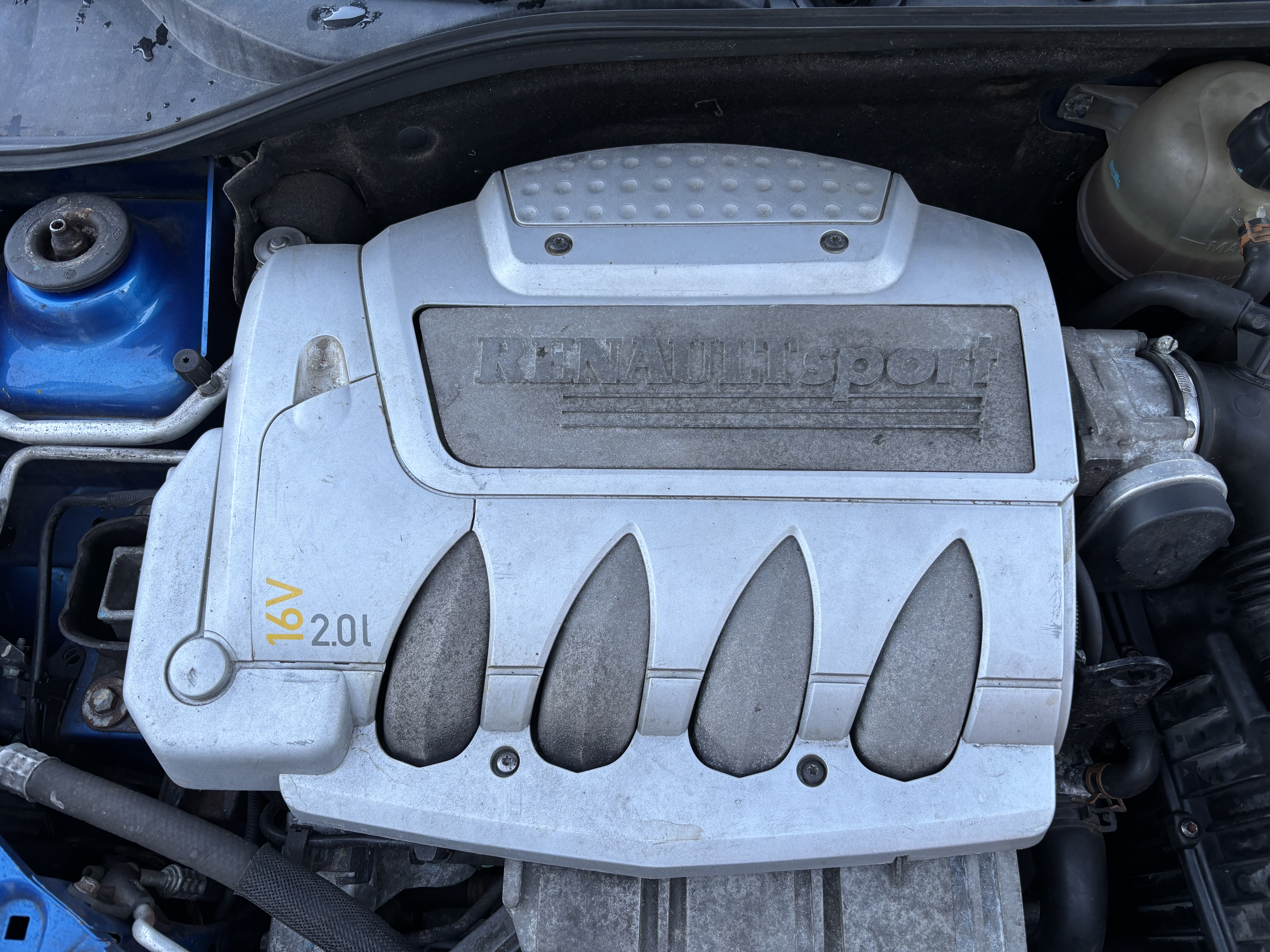

Took it for a driver and it’s a lot better! Picks up at low revs noticeably quicker and sounds a bit more grown up too. Also replaced the cracked engine cover with an uncracked one. Thanks again to ClioFool for the airbox and engine cover 👍🏻

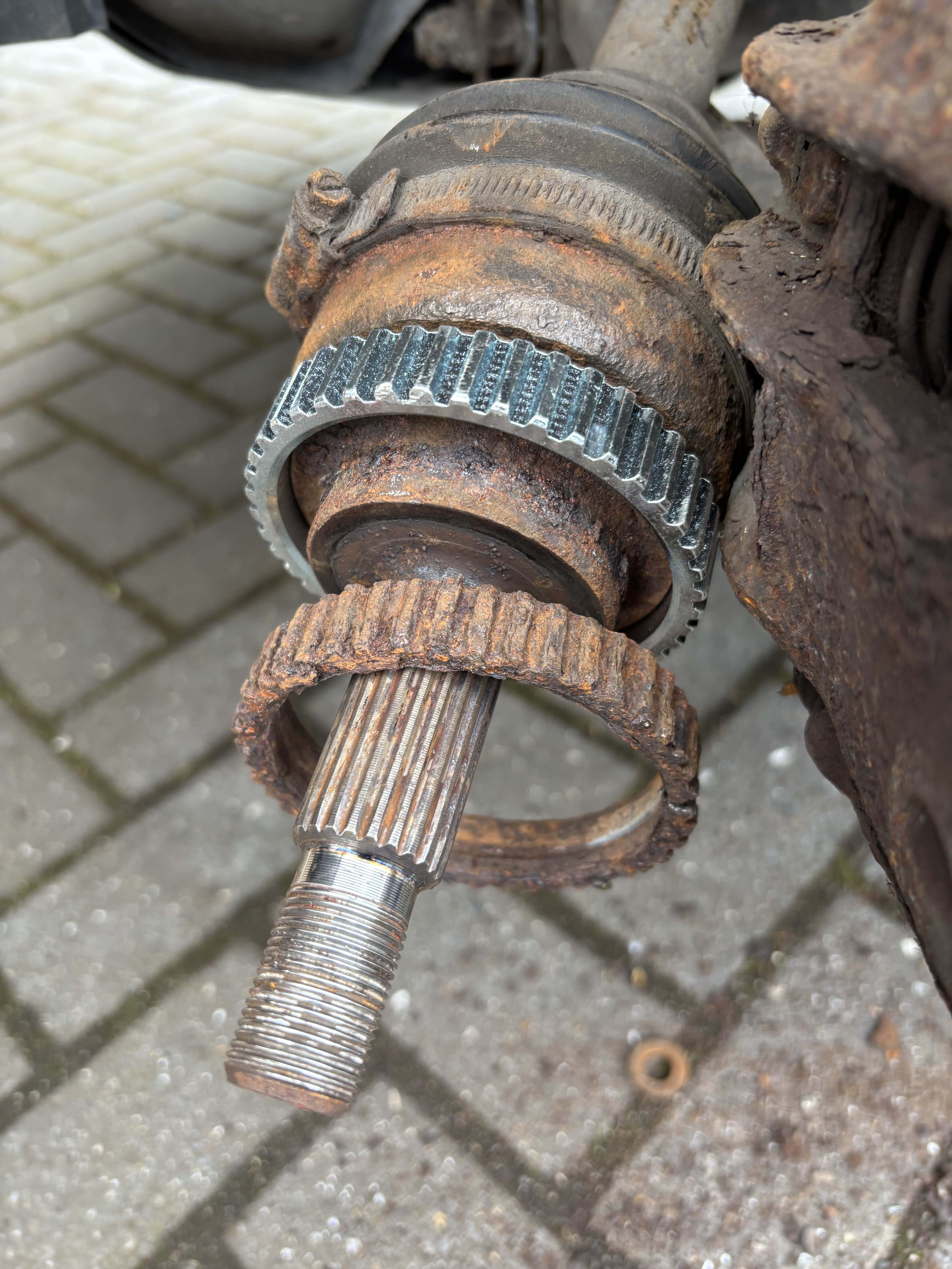

The intermittent ABS light is back, probably (hopefully) because of the left side sensor ring being utterly goosed.
Can’t find a left driveshaft anywhere, slightly worryingly, as I can’t get the knackered ring off and thought it would be better to do the driveshaft than faff around with a new sensor ring.

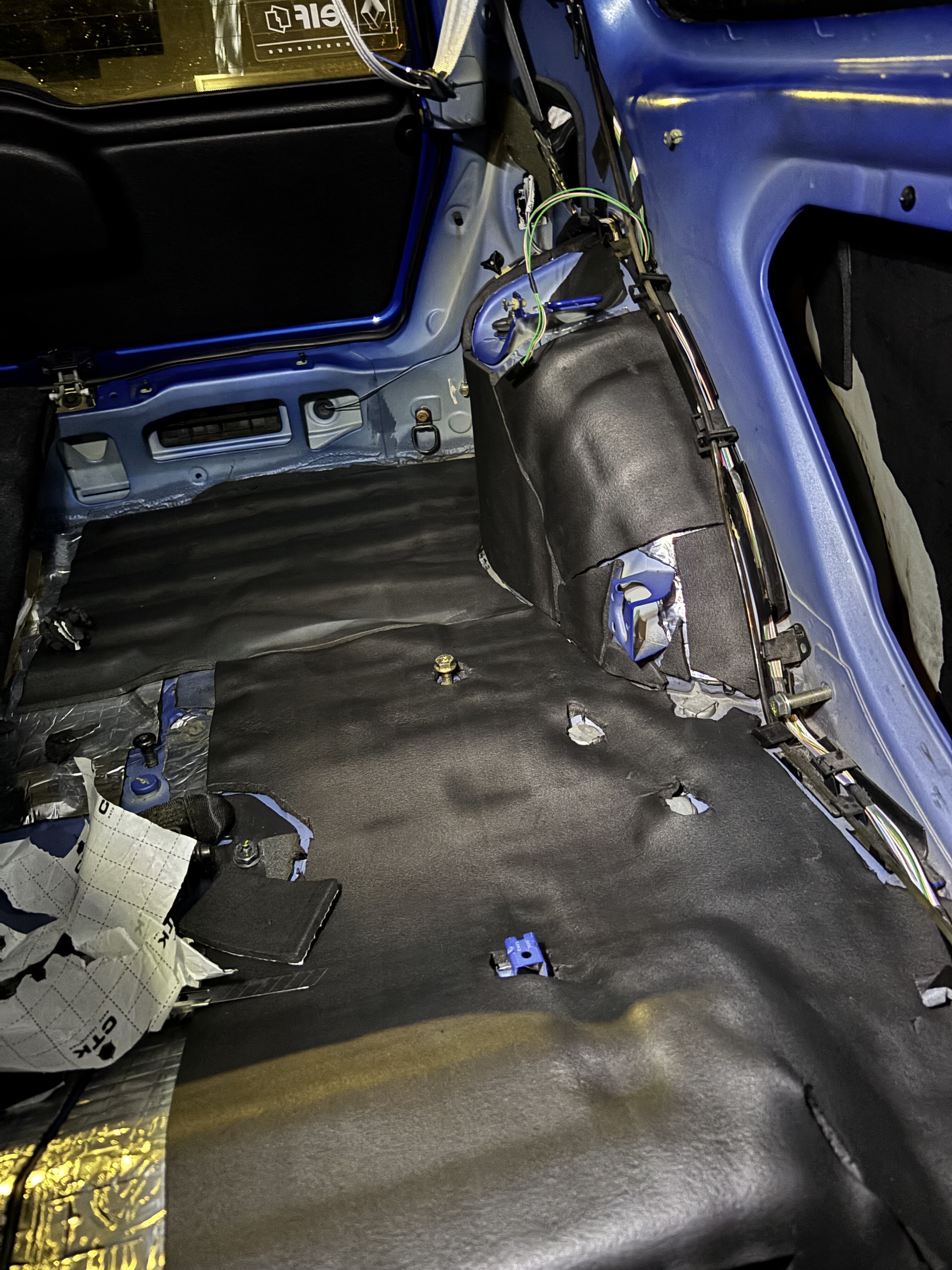

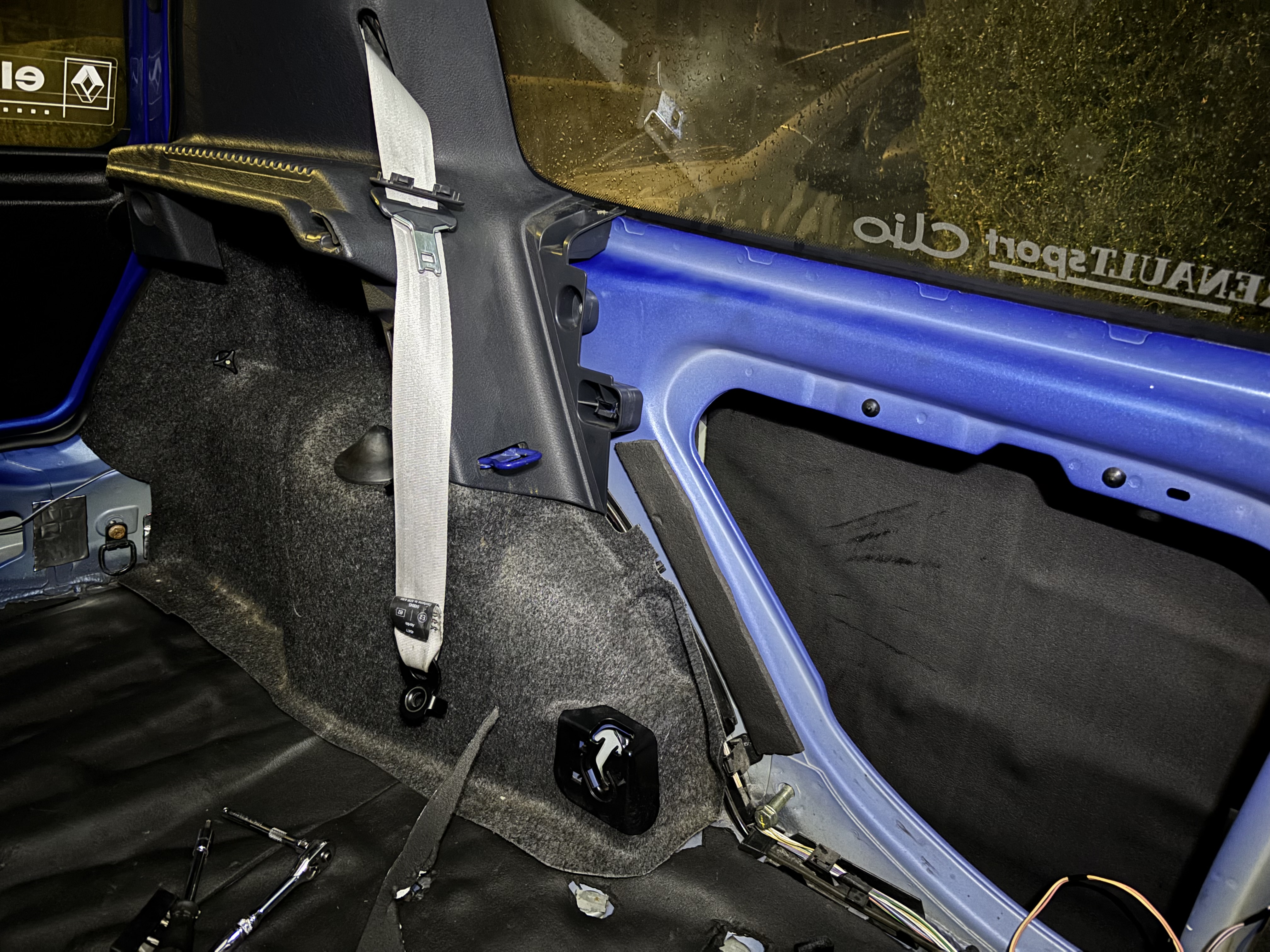

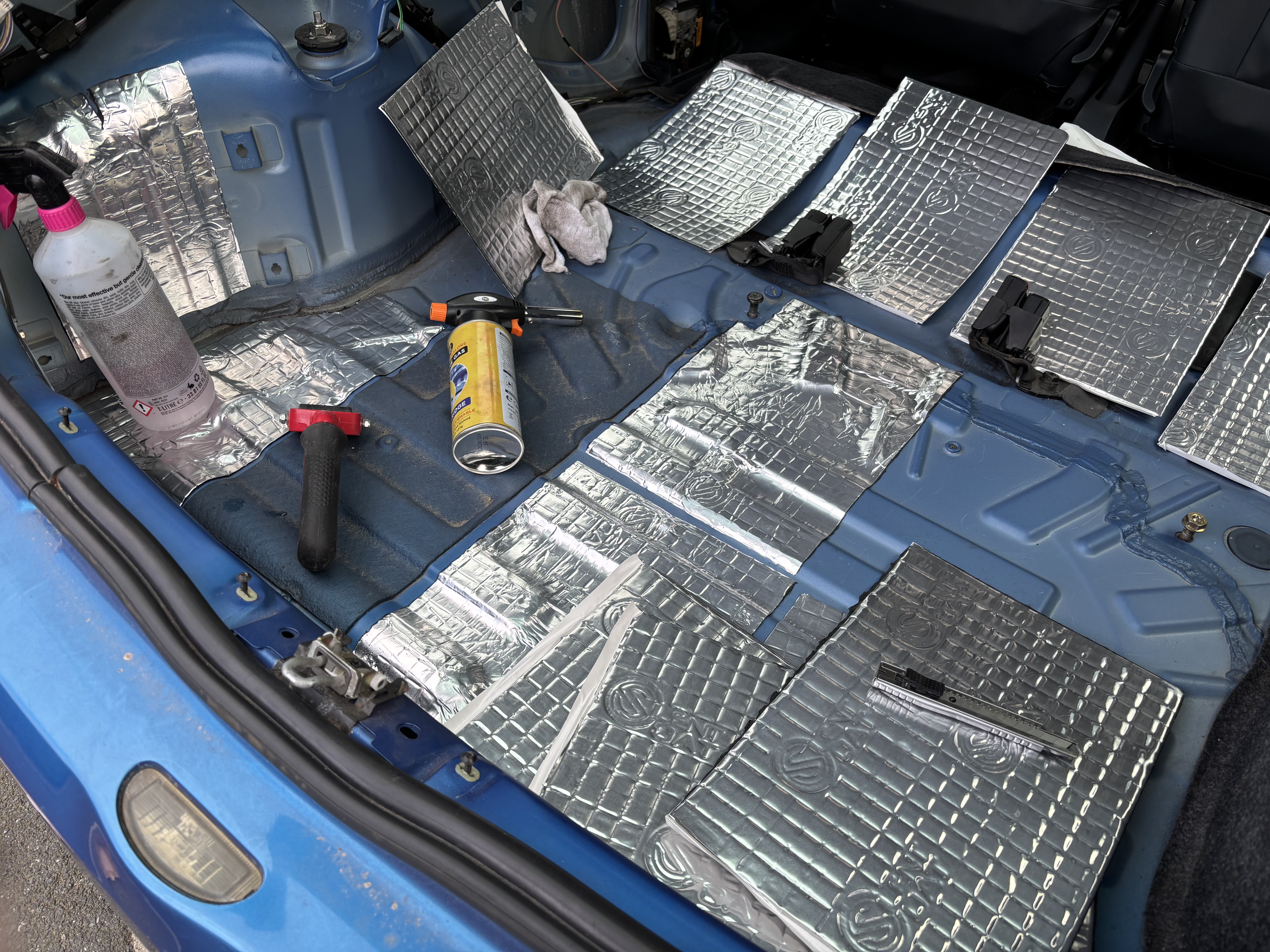

Also started sound deadening, had the stuff for a while but had a good go at it today. Think I’ll need another pack as I’m going to do the from doors and boot lid which there isn’t enough for in the set I bought.
It takes forever but as always I keep getting useful advice from the forum, there is a great thread about doing it to an unbelievable standard and there were some useful photos on that. Also general advice on taking the seats out etc; this site is great for general help 👍🏻

Got the left front ABS ring replaced and annoyingly the light is still intermittently coming on…
The welding gauntlets were because I heated the ring up to get it on the driveshaft, not because they are my normal mechanic gloves!
Seems to come back on over bumps or on full ok so now thinking might be a cable. Are they easy enough to check? Any ideas/tips? Thanks in advance
