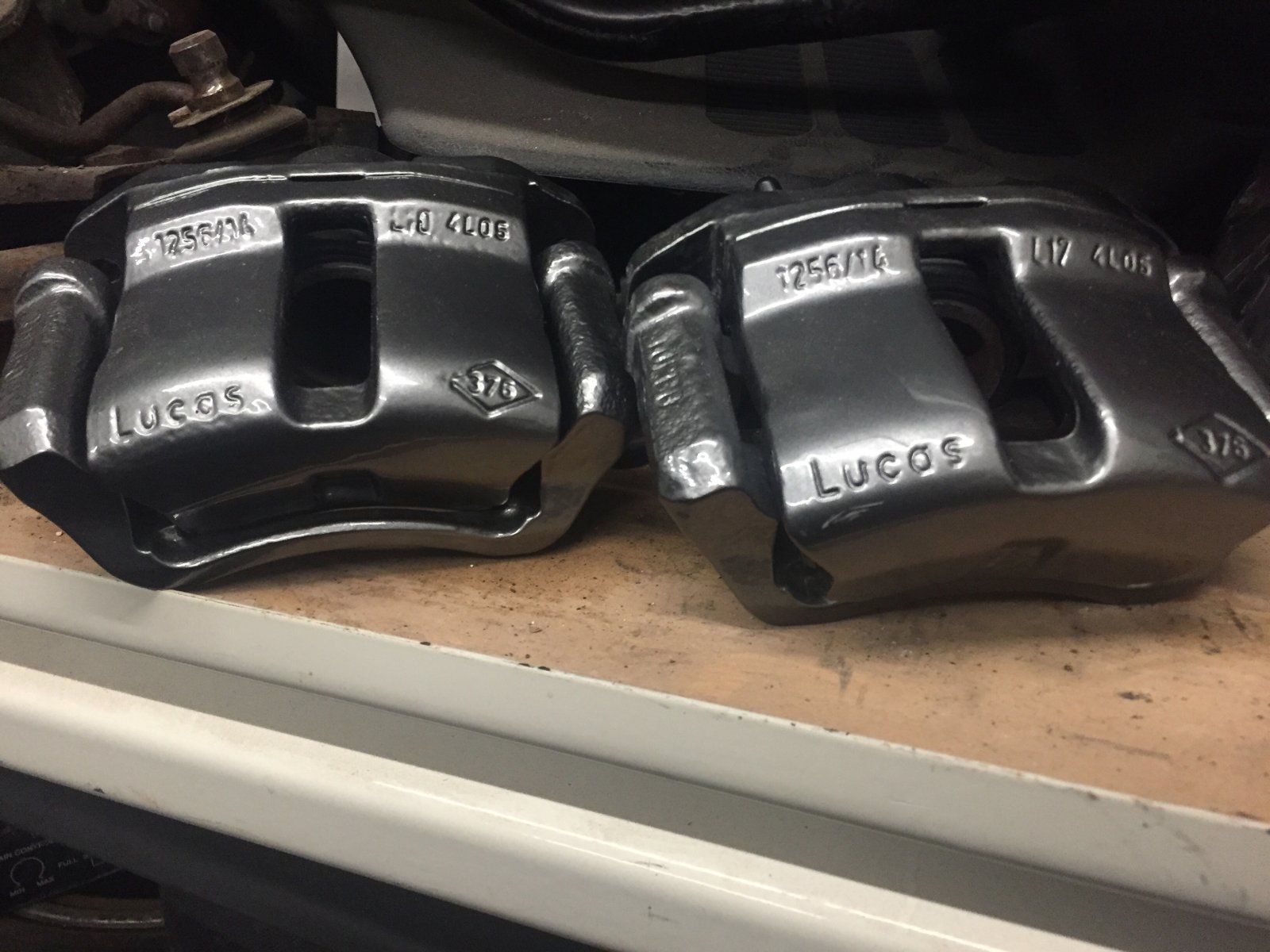

- engine out, interior out, stripped everything back to shell
- subrame refurbished and powdercoated at Kent Powdercoating
- driveshafts refurbished by Bailey Morris
- Front brake calipers refurbished and painted by BCS

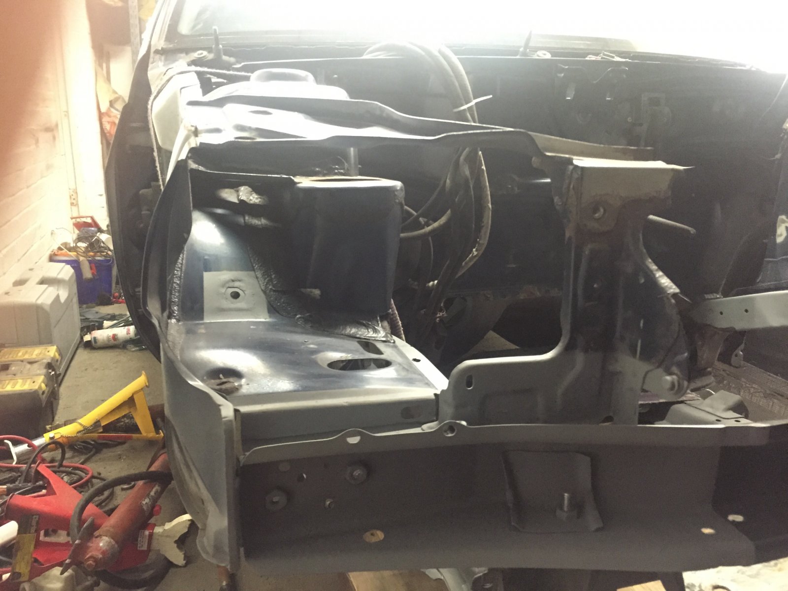

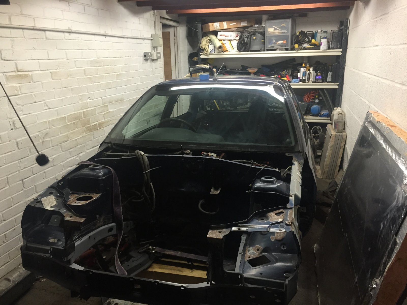

Stripping everything out allowed me to have a good look around the car and last month after finally finding a welder I felt I could trust, the car went away for 2 weeks to his workshop for a good look round the car and doing any repairs neccessary.
  Williams 2
  Williams 2

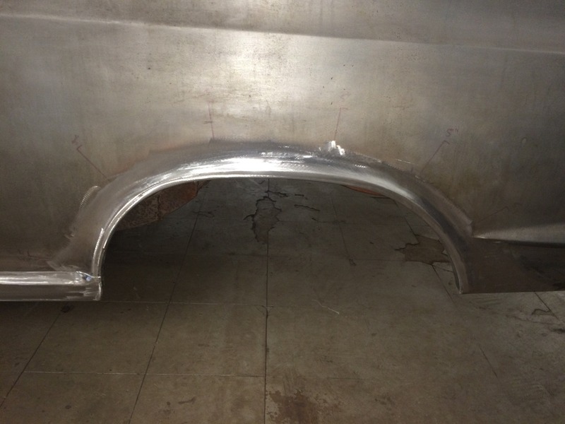

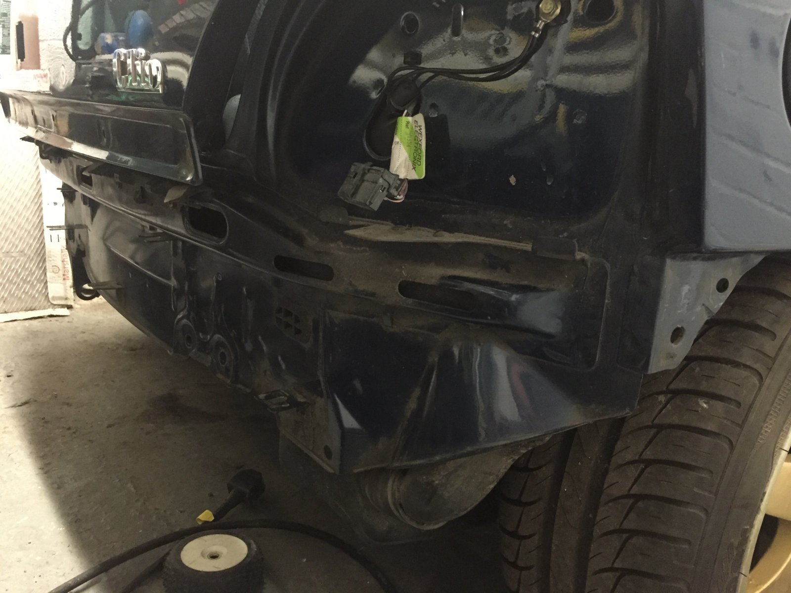

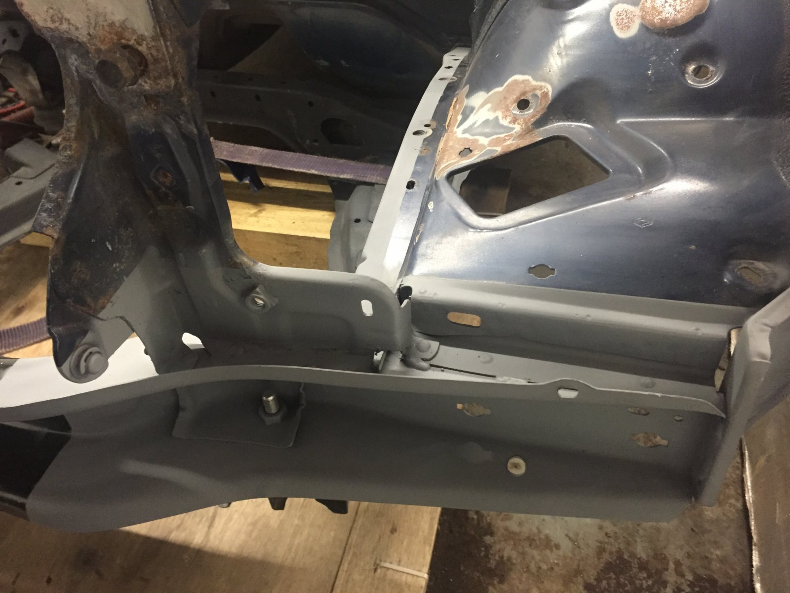

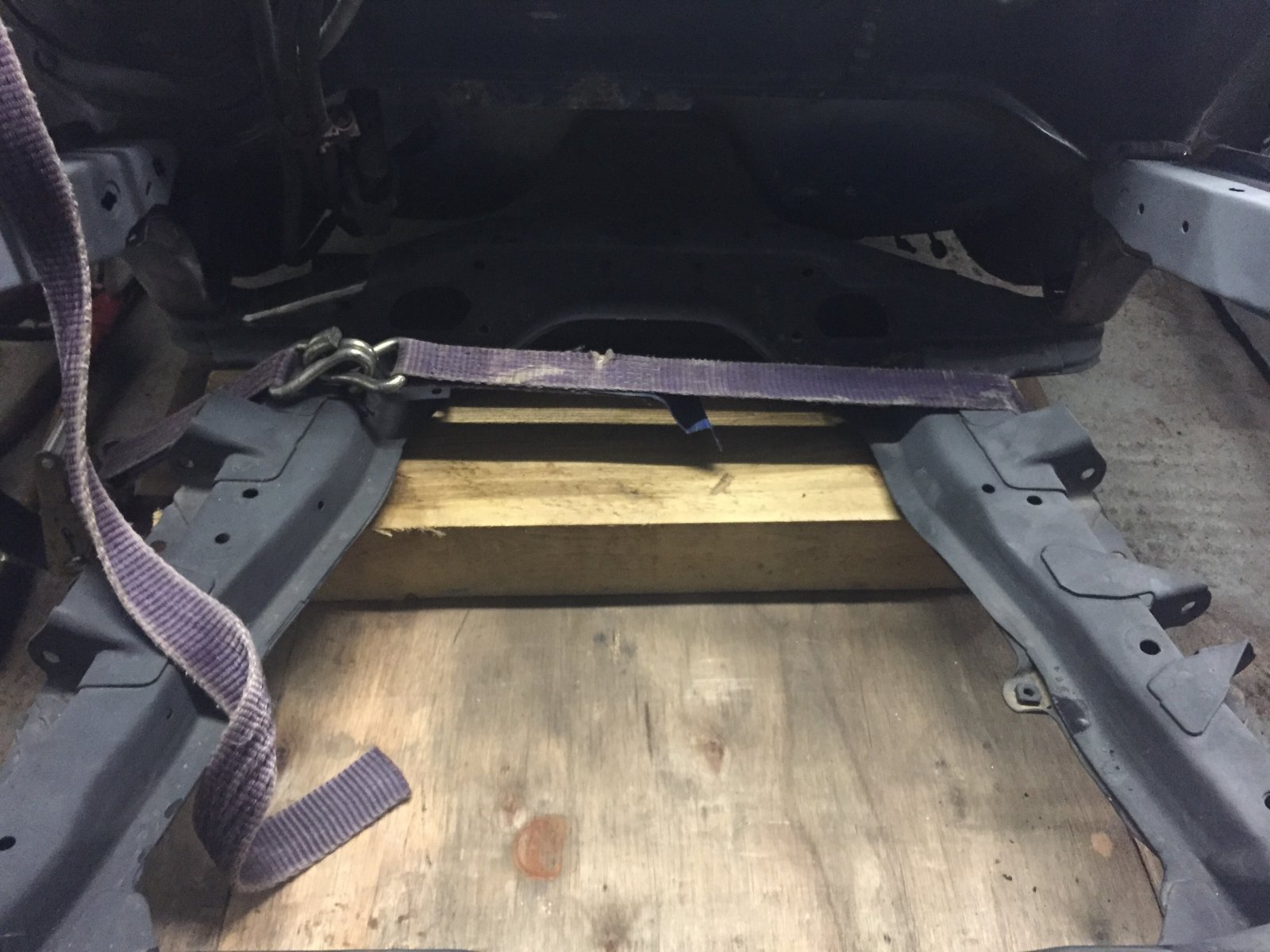

Got the car back last week from welding, new front crossmember installed, arches turned out to be perfect, not even surface rust!

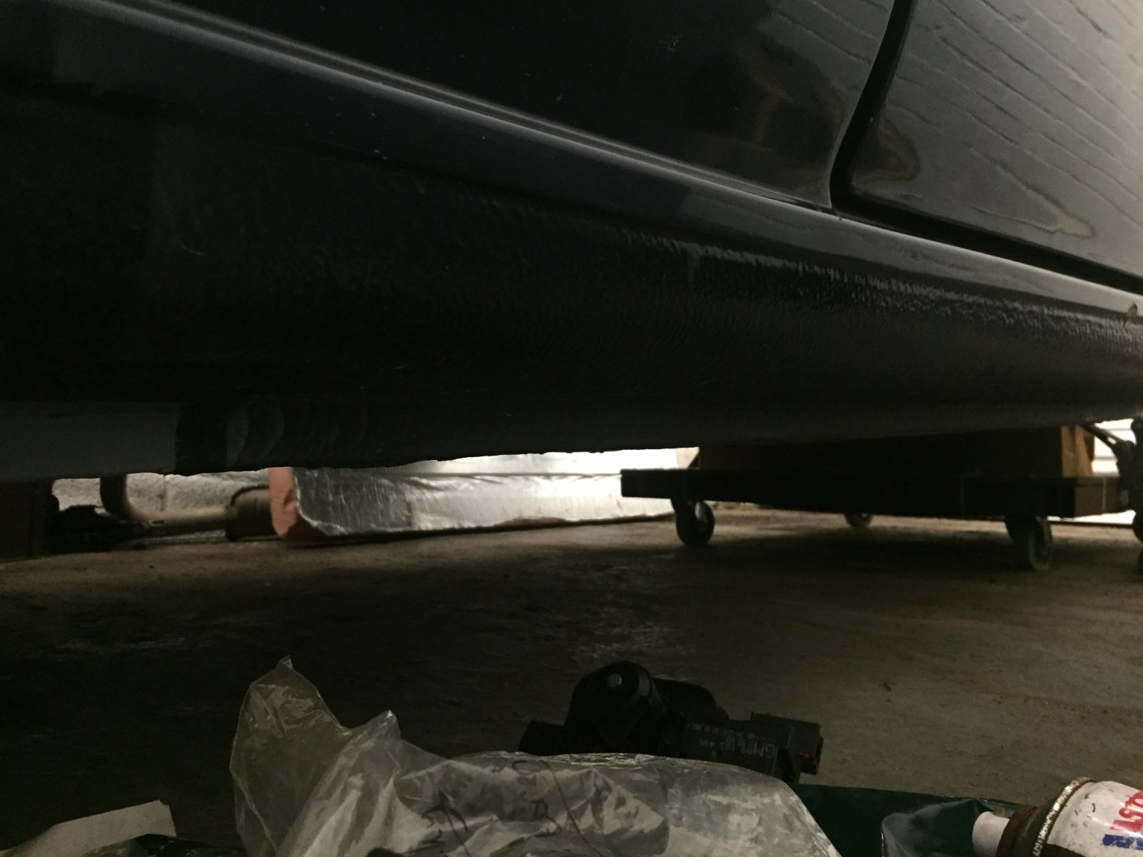

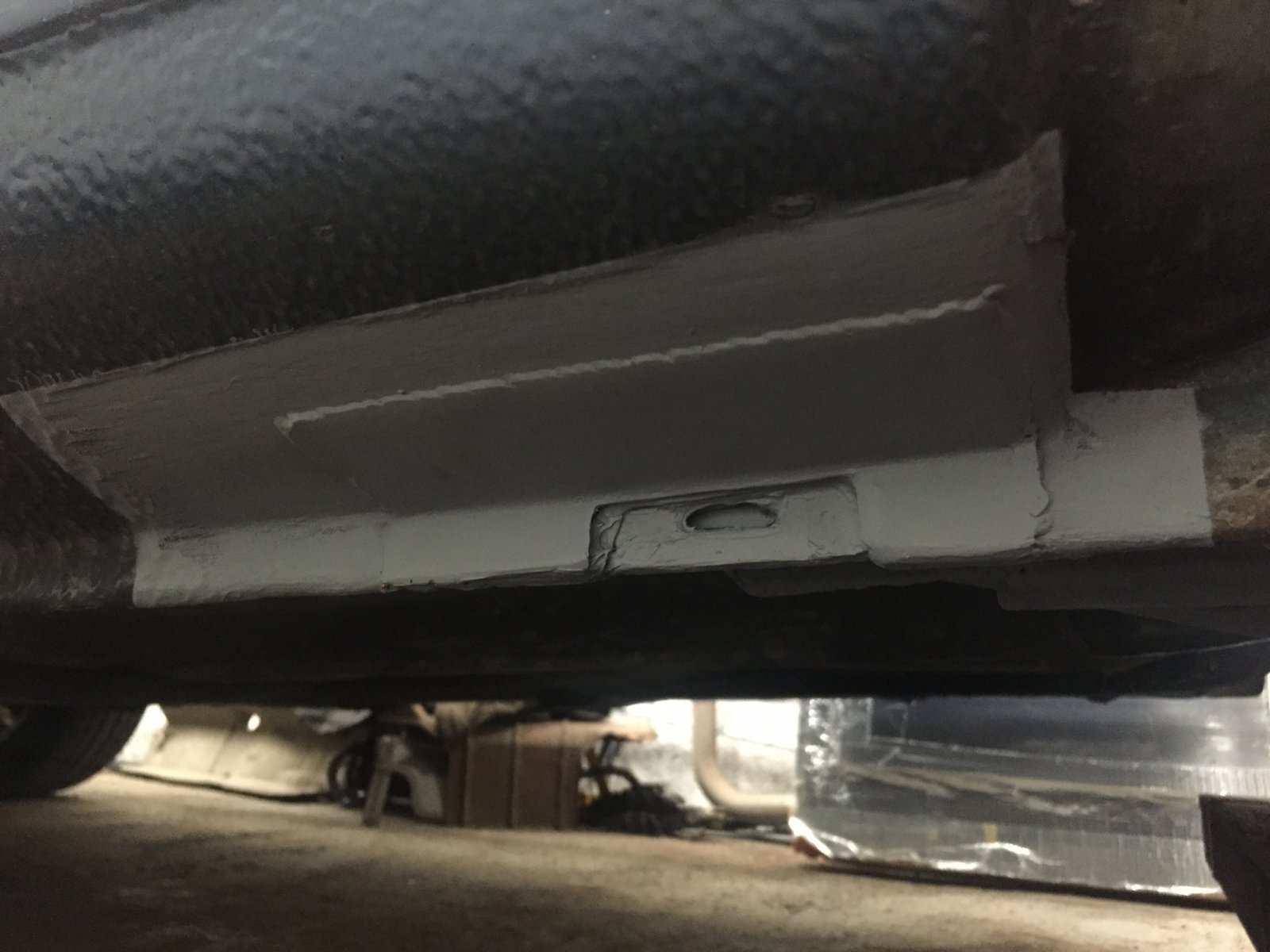

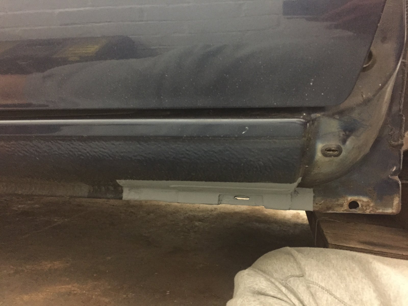

Welder said some small repairs were neccessary to the sills...he's put a little patch in that you can see above, have spoken to him again as i may send it back and have new complete sills welded in both sides just to be safe.
Going to be another £500 or so i think so debating if its worthwhile.

In the pics of the engine bay you can see big patches of surface rust - this was me earlier in the year with a grinder and paint removing disc taking any paint blisters off to check whats underneath after removing the engine. All good but its now got surface rust everywhere in the engine bay!
Engine bay will obviously be painted eventually but not sure yet how to do it...the whole car at once and build back up, or do engine bay and under car first, engine back in, then inside and out after.

Hope you carry on with this project but I understand your troubles as restoring a Williams can be a money pit - I did a Williams 2 a few years ago and spent toooooo much, lol.
  197 Cup
I Agree on the sills!
I'd replace them or
The other option is if you have that patch repaired properly and get some dinitrol to neutralise any existing rust inside. If the rest of the sills are solid! Then waxoyl once it's painted.
Putting a patch on it like that annoys me!
At least if you're going to put a piece in at least do it so it can't be seen! Just my opinion!
  Williams 2
I've had the car for years, it was my 2nd car, this restoration will be completed.
I thought about it properly and realistically how much it would cost me, and i've prepared for it. Am hoping to get it at least driveable next summer but I won't be dissapointed if not. As long as progress is being made and everything is being done properly (ie not having to go back over the same things!) then i'm more than happy.
So current situation is the sills, and the patch repair annoys me too, so think i'm going to have to send the car back to him again (£90 for a transporter each way :confused:) and get the sills replaced along their full length which means he can see the inner and treat as neccessary. I'm still not 100% if standard mk1 clio sills are a good fit so I haven't ordered them yet. Anyone replaced sills on a 16v/Williams? What's the best way to do them seeing as only standard sills are available?

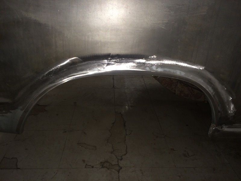

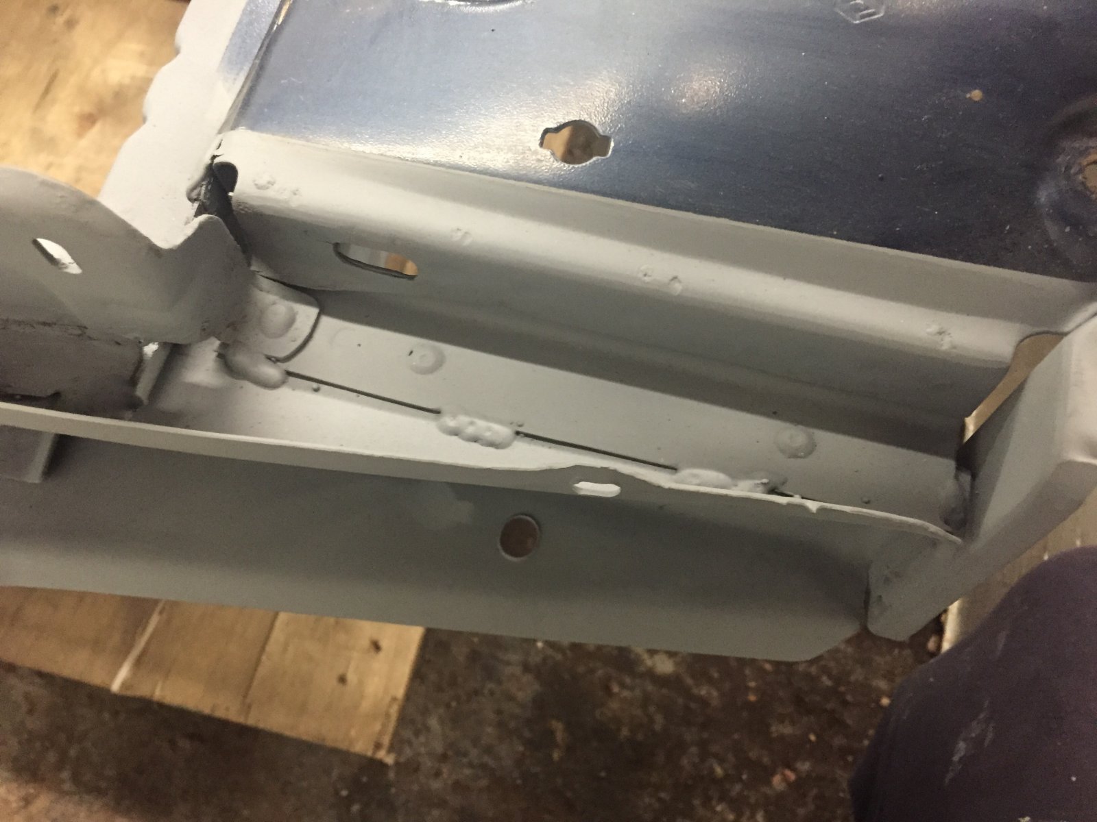

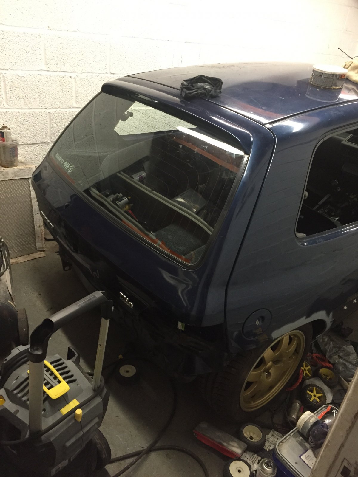

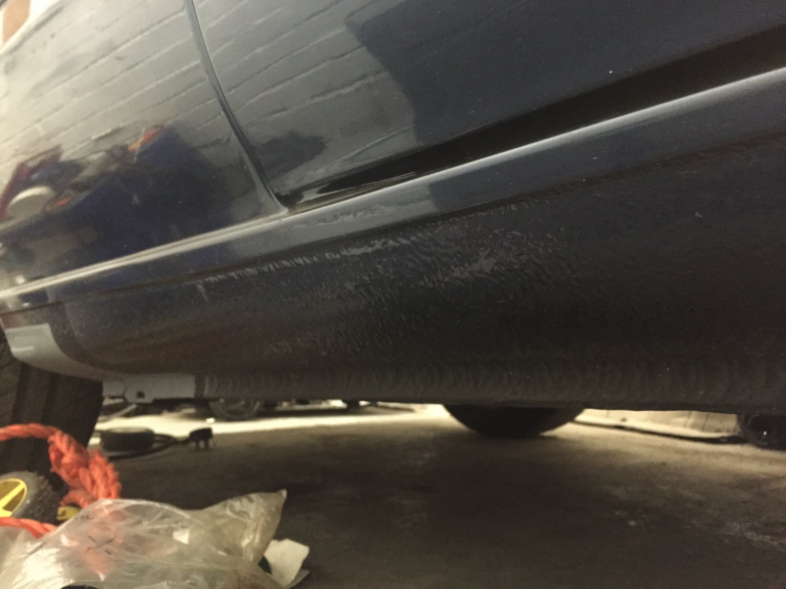

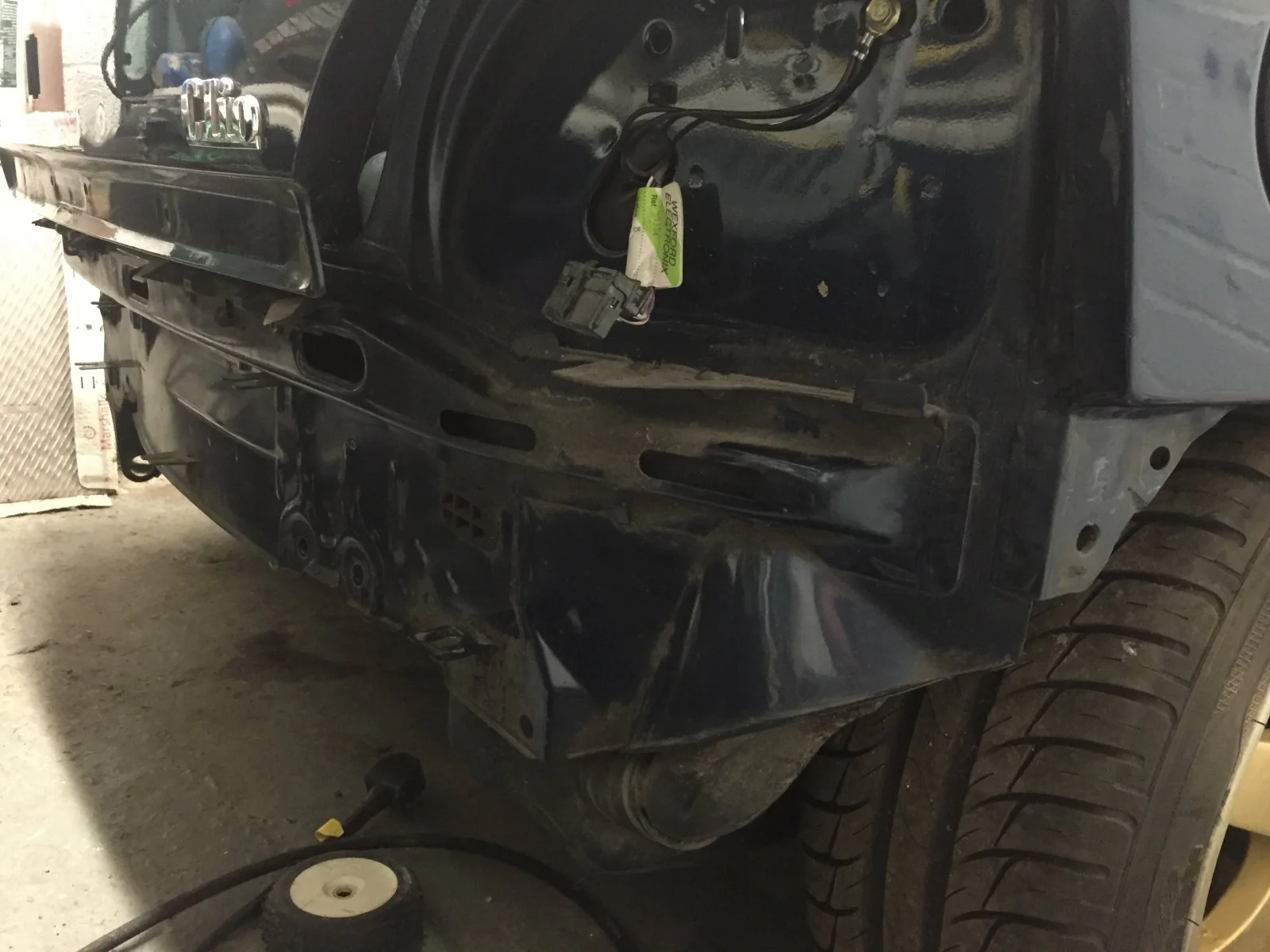

Few more pics to give a better idea of the state of the car atm.

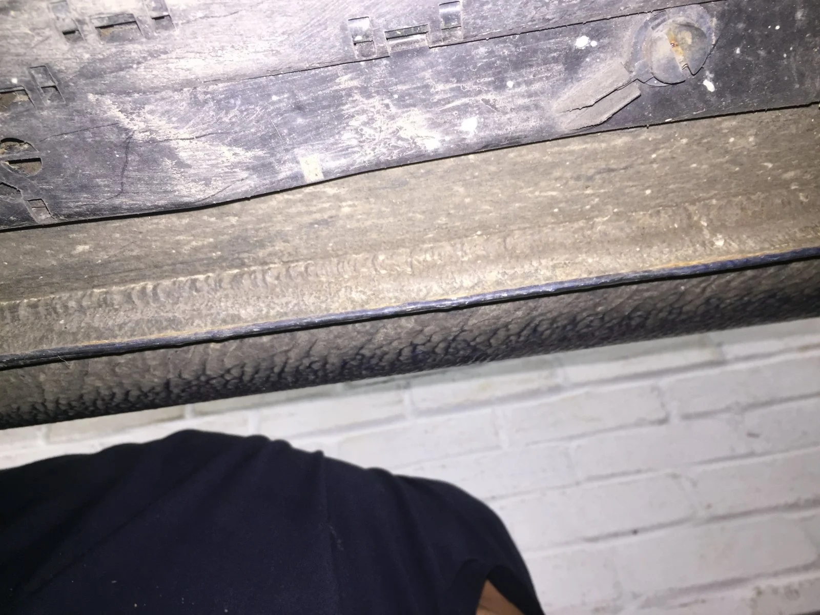

Used a paint removing disc to take the arches back a bit to inspect for rust. Not a spot of rust which was very surprising! Apologies for the sloppy use of primer to cover the metal back up 🙈
So have decided to replace the full sills just to be safe and so i can see the inner sill. Even if inner sill perfect i can still clean it out and get some extra protection in there. I dont like the idea of these little 'patch' repairs on the sill either. Seems a shame to do all that work though - whats your opinions if rather than buying new sills, just replacing like a long fabricated 'strip' each side? Basically the whole length that has the stone chip protector so a curved sheet about 4 inches wide and going all the way front to back?
It's a long way to seam weld which is what I did with standard mk1 sill which I cut. When I do the other side I'm using a standard mk1 sill upto the door and then cutting, possibly 4", off the bottom of the standard sill so I don't have the wider part problem
  197 Cup
If possible I would cut the sill off just below the raised swage about 1/4" down as the swage would keep the strength in the sill for less distortion. But it'll need to be but welded in which will take a good day or so to weld in very slowly tacking it 4-5" apart along the sill and letting it cool. then repeat. A lap joint is what most people will do as it's easier. But if you can't seal it properly from the inside it a damp/water trap.
Here's a rear arch I butt welded into a mk1 lotus cortina.

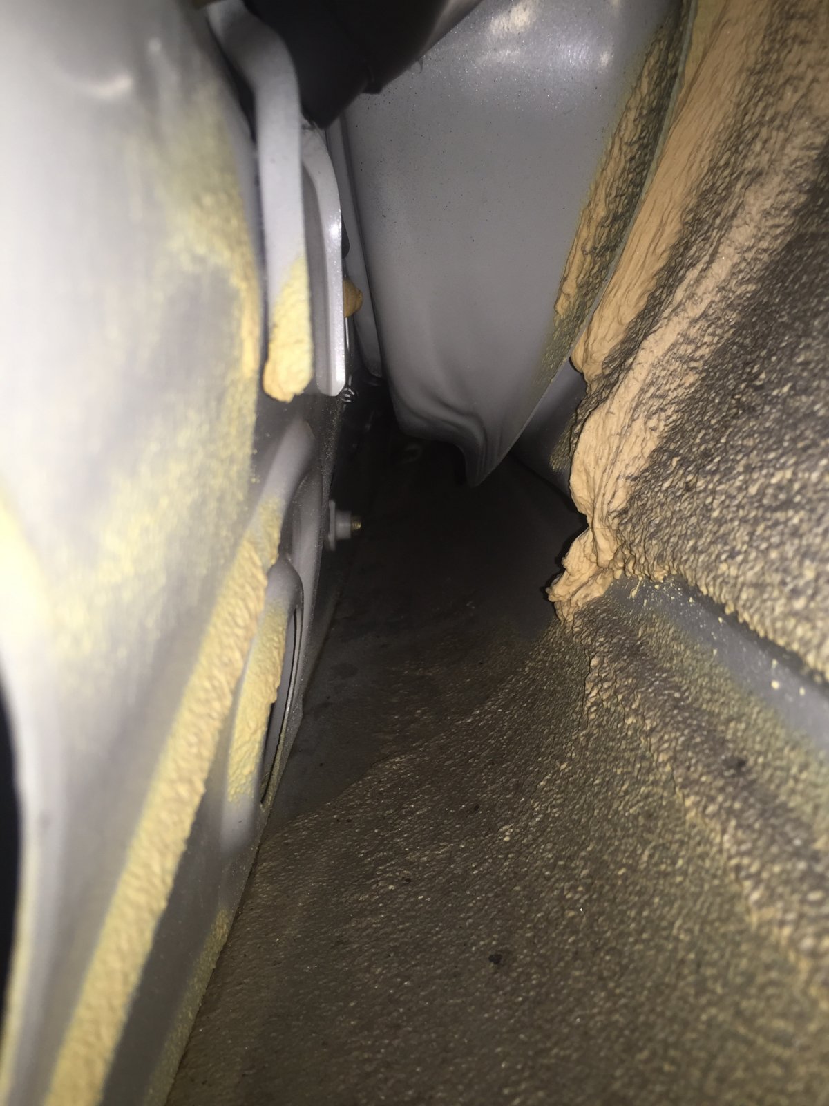

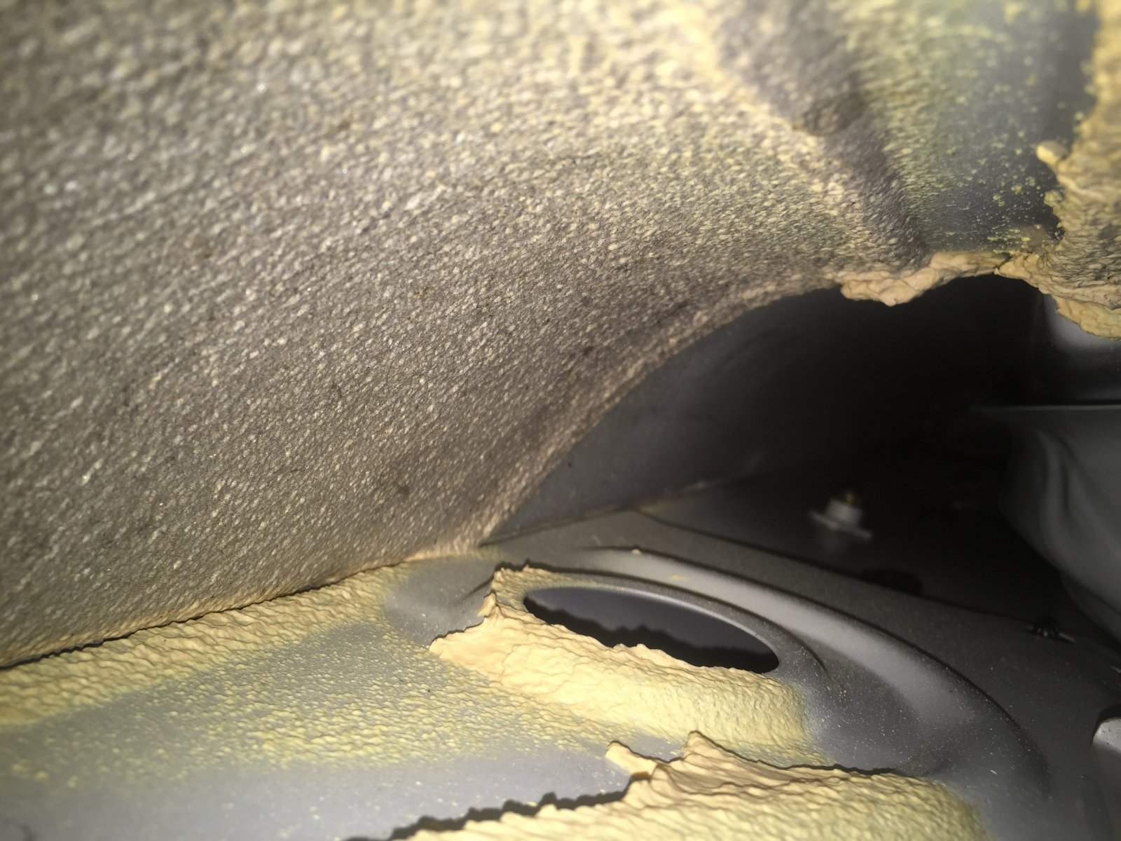

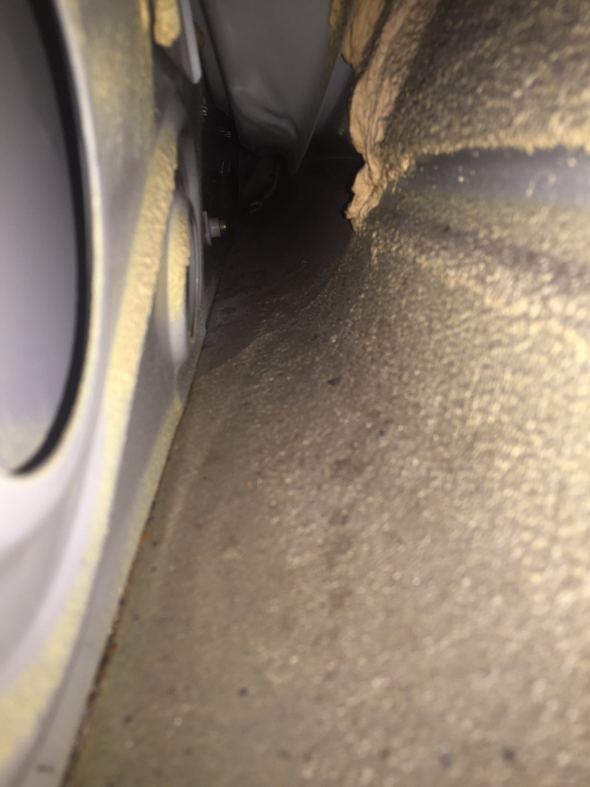

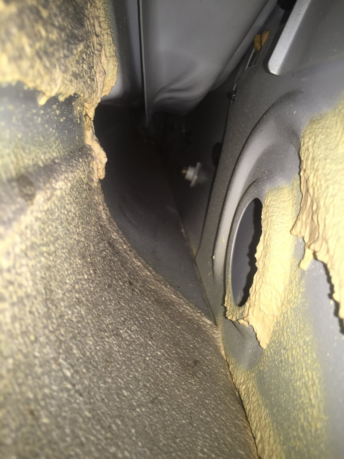

Yes that quote is just replacing the outers. The reason was purely to check and treat the inners. Ive already had the repairs done that were needed.
Turns out last night i can see the back bit of the inner arch through the inside rear quarter where i have removed the rear 'door card' and they actually look very good, so may leave the repairs as they are, but treat the inside of the sills where they meet the outer from inside the car as an added bit of protection.
Can anyone recommend a good product so spray inside the sills as added protection? Not waxoyl.

@rickyquicky check out the dinitrol range they have some with rust inhibitors etc you can get a whole kit from them. To neutralise and protect!

The other you could possibly to is pour a bottle of Hammerite rust eater into the sills first from the rear if you have the cards out? Jack up the rear of the car so it'll all run forward??
I'd also have a look at the Bilt Hamber stuff, very good and I use there wax oil on my impreza. [emoji106]

Just bought a can of dinitrol rc900 rust converter/sealer which im going to use inside the car for any light surface rust, 5L por15 metal prep/rust converter for sloshing inside the sills as m&l172 said and various other bits.
They do this eastwood internal chassiscoating spray with a long bendy 'hose' that lets you get right inside sills, chassis legs etc. Wonder if its any good as id like to get rust treatment in those places first (chassis legs will be hard as it will all pour straight out!) and then seal afterwards with the eastwood stuff

Spoke to him today and he agreed full sills arent worth doing as the inners are good. I awkwardly said im not happy with the patch on the sill (i am happy but everyone seems to be saying a proper job is a butt weld)
So he's going to redo the patch and butt weld it flush - now im not sure how much i should be paying for him to redo it. He should be paid as he's done a decent job but at the same time he knew i was fussy so dont know why he patched it like that if butt welding is the 'proper' way. What do you think i should pay m&l172? 100% to redo the patch? Or go 50/50 etc..?
  197 Cup
@rickyquicky, it's a hard one, I'd personally never do repair like that but that's just my standards. Everything else looks good but std panel replacement. Maybe just speak to him and see? It shouldn't take more than a couple of hours. It's just the cost of the transporting it back and forth?
Yeah he's offering £60 each way now as he can use a trailer, £120 before even touching the car.
I might be tight and trailer it to him instead and try work out a deal to do the patch on the sill again.

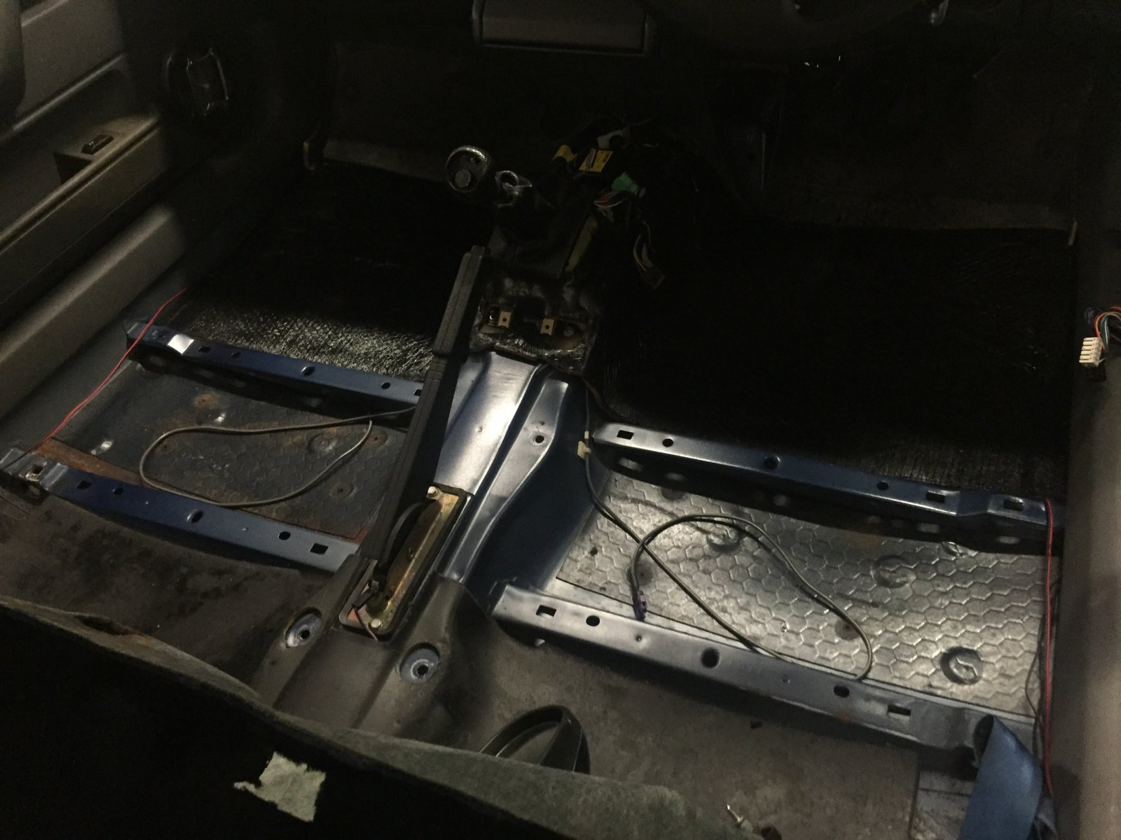

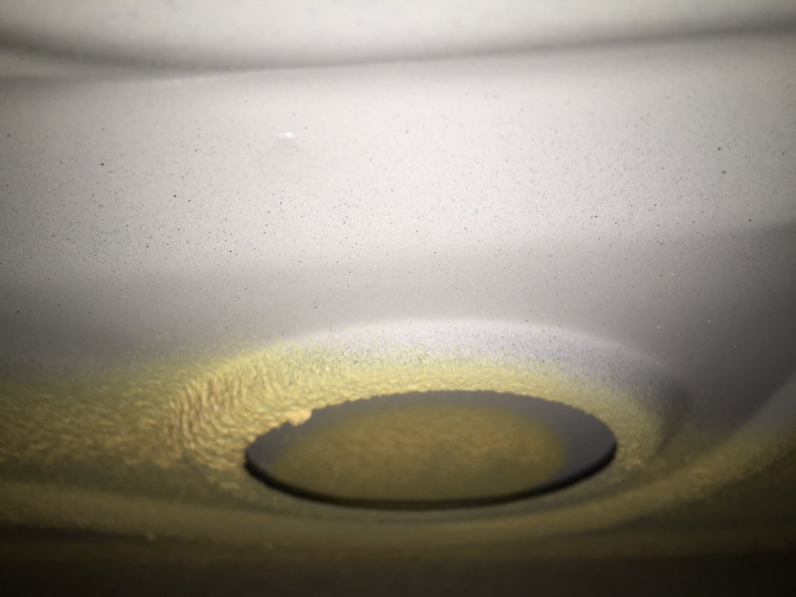

Thats the inner sills so definately not bothering with any more work. A bit of a slosh with rust converter for 20 minutes and maybe the eastwood internal frame coating for long term protection.
Get the patch on sill redone then fingers crossed can really start getting it moving
  Clio 172 Cup, Eunos
Those inner sills look pretty damn good for a 20+ year old Renault! Not bad at all. Good luck and keep at it!

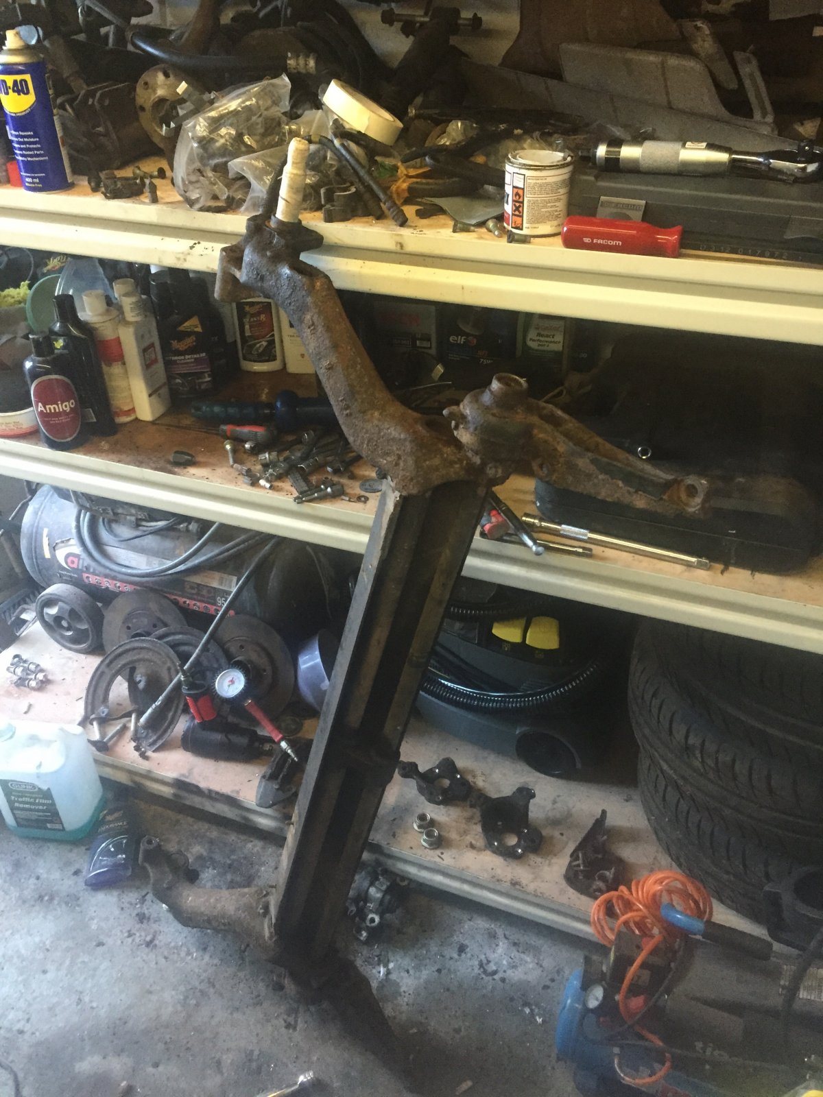

Nearly ready to get the engine bay and underside of car painted, but want to get the rear beam sorted before i do anything else.
Stripped as much as 'easily' comes off...just not sure what to do now really.
The centre and torsion bars themselves are in good nick, just need a clean up. So not sure whether to take the torsion bars out and get it all sand blasted/powder coated, or possibly just get the mounts and arms done (basically the bits either end) and leave the rest.
