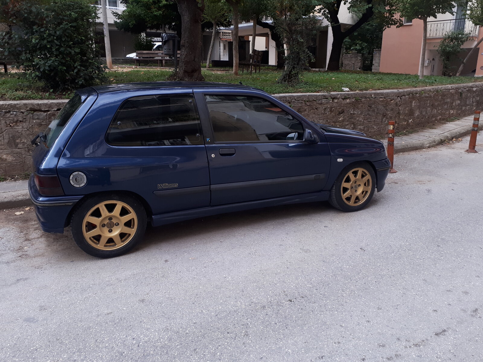

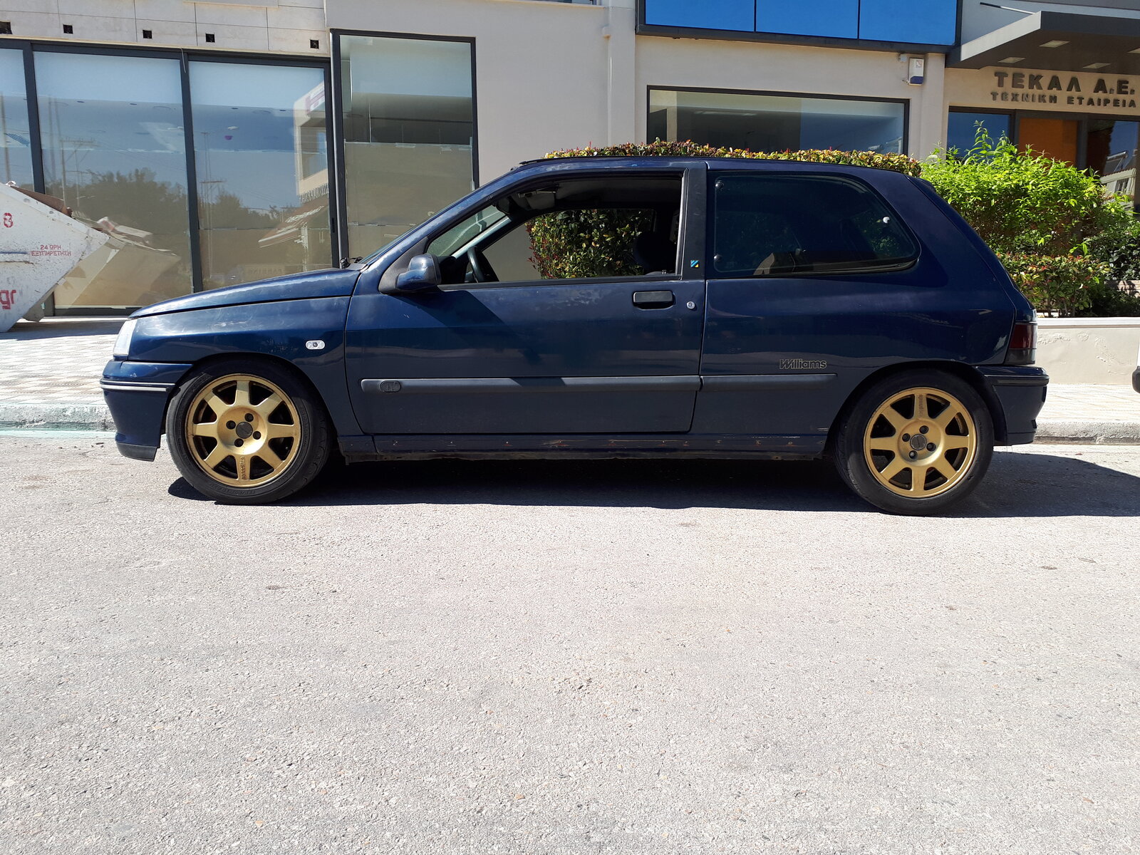

Hey guys ,new to the forum, I be git recently a clio williams, and I found a jc5 gearbox from a 182 ...does anyone know if it fits ? Currently I ve got gearbox from a diesel 1.9 I think and I hear a lot of whining ...so any info on that too it would help too ,thanks !!
