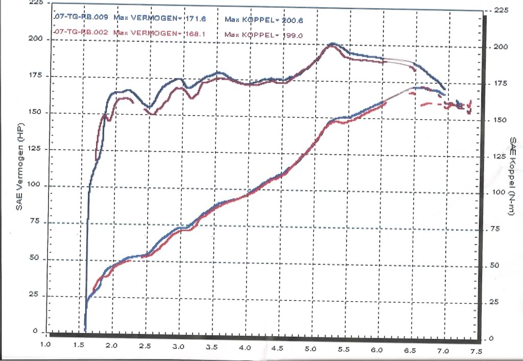

However i have put in Colombo & Bariani cams and my car makes almost the EXACT power + torque as a 197 . RR graphs compared were almost identical

Can U post that RR graph, I'd like to compare it with mine 172 on CatCams

Maybe Henk will come around and post his 197 graph ? :)
Anyway here's mine again..

They will go in fine, but I'm unsure they would work. Just from a quick look at all CATcams specs, the peak angle of the 197 inlet cam is notably different, and nothing like any of the uprated 172/182 cam, and I can only think this is down to the VVT on the F4R 830 being constantly variable rather than just switched between 2 positions. That's just based on 5 minutes of scanning number though
