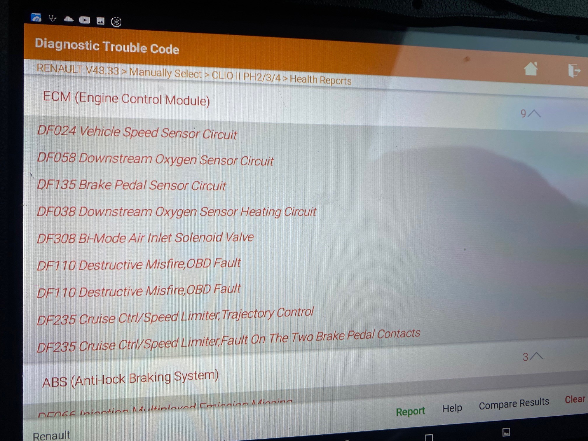

Dunno if this sheds a light on anything to anyone,
K_McDermott
  Megane 230 r26
Running a decat? I wouldnt worry about the 2nd lambda issue.
yeah decat, im sure its mapped as its never flagged up eml like usual,
just guessing its gunna be trail and error cause it doesnt actually cause any running issue, ill start with spark plugs first.
although i will do a diy flow test tonight and see if theres any difference in flow from the injectors.

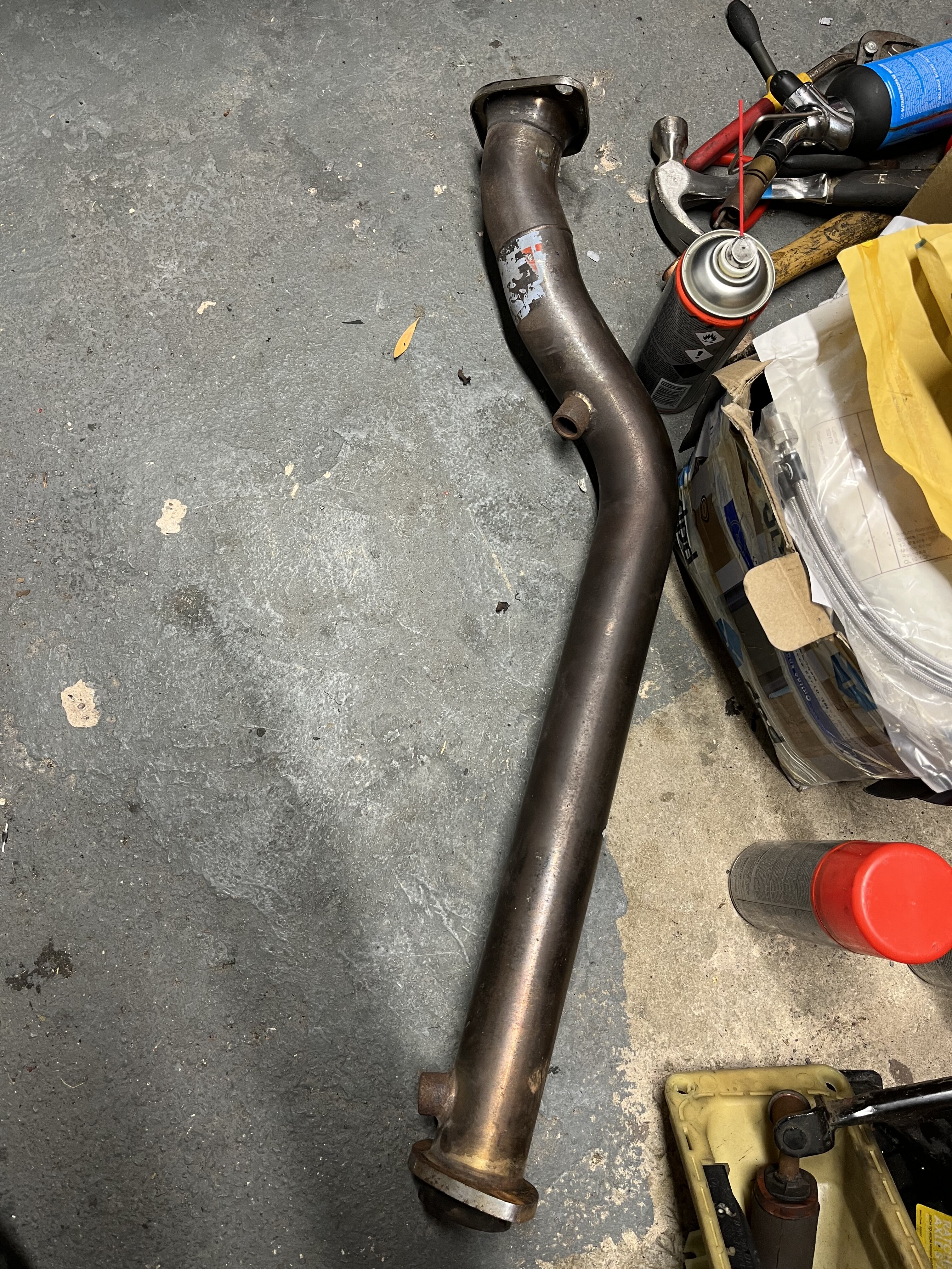

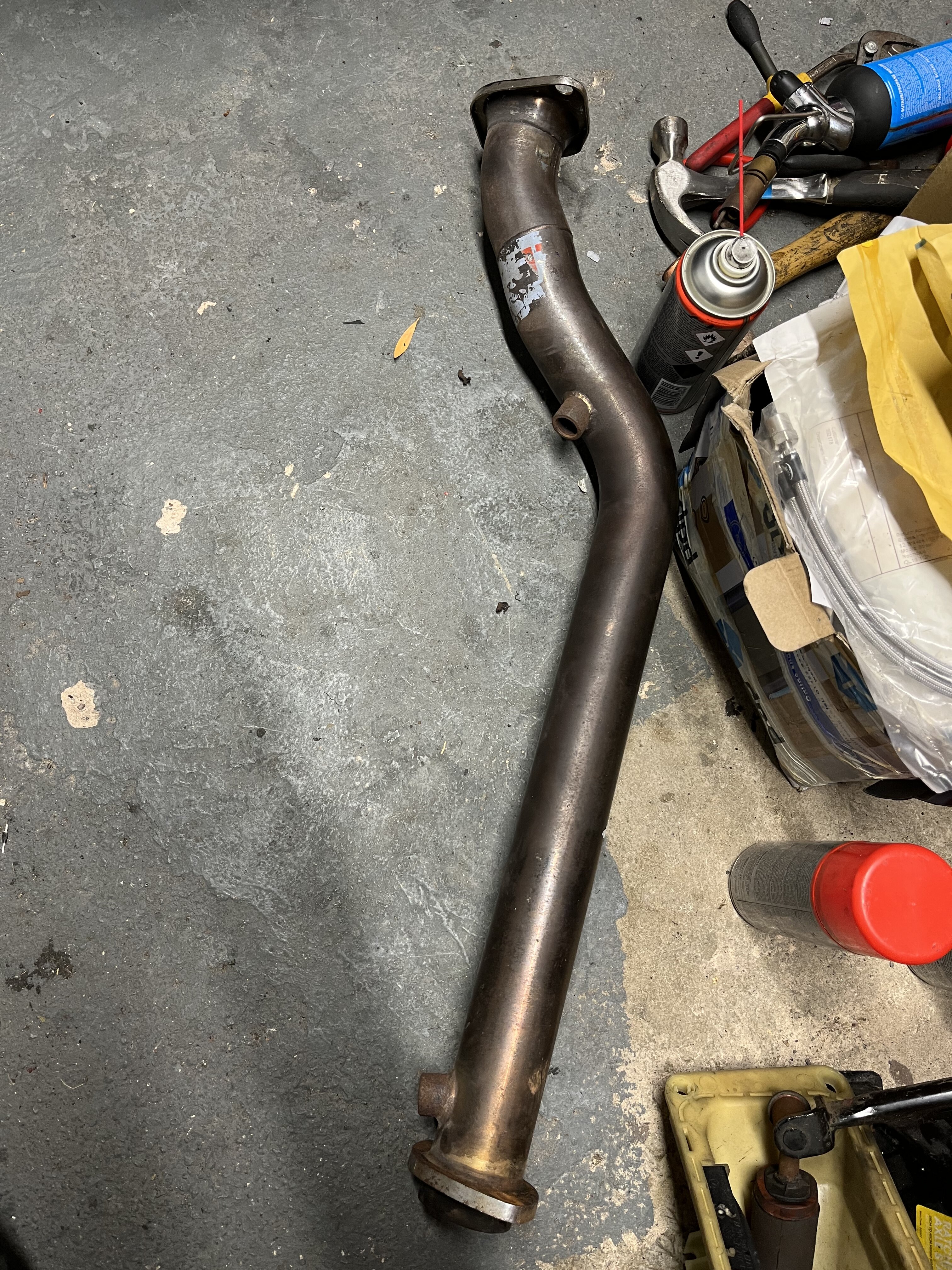

Jumping back on the thread again. Ready to fit my decat and I’ve noticed that it has a whole for both lambda sensors? I’m assuming if I fit the down stream it will throw up an engine light?
Please help, what do I do?
Brigsy
  T.Turbo
Chuck a 90deg fitting on the downstream lambda and fit it in the decat, will keep the eml off most of the time.
Ignore what you're told on csoc and just blank off with a cheap Ebay plug and tie the lambda out to read air.
Or use a 90degree like @Brigsy recommends!

Something like this will get you away, Worked ok on my old 172 Kangoo, only seen the eml come on every few thousand miles.
So do you still put the lambda in with the 90degree? Assuming with the engine running and gas flowing it doesn’t read the richness as well at 90degree as it would if it was in the direct stream?
I’ve gotten an eBay plug at the moment as that seemed the most common answer
Louis
I Park Like a C**t
Exactly that. But it makes no difference either way due to the postcat not having any effect on fueling.
