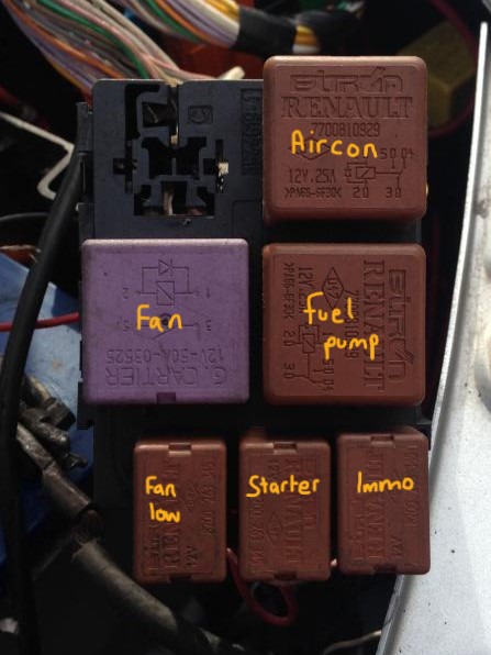

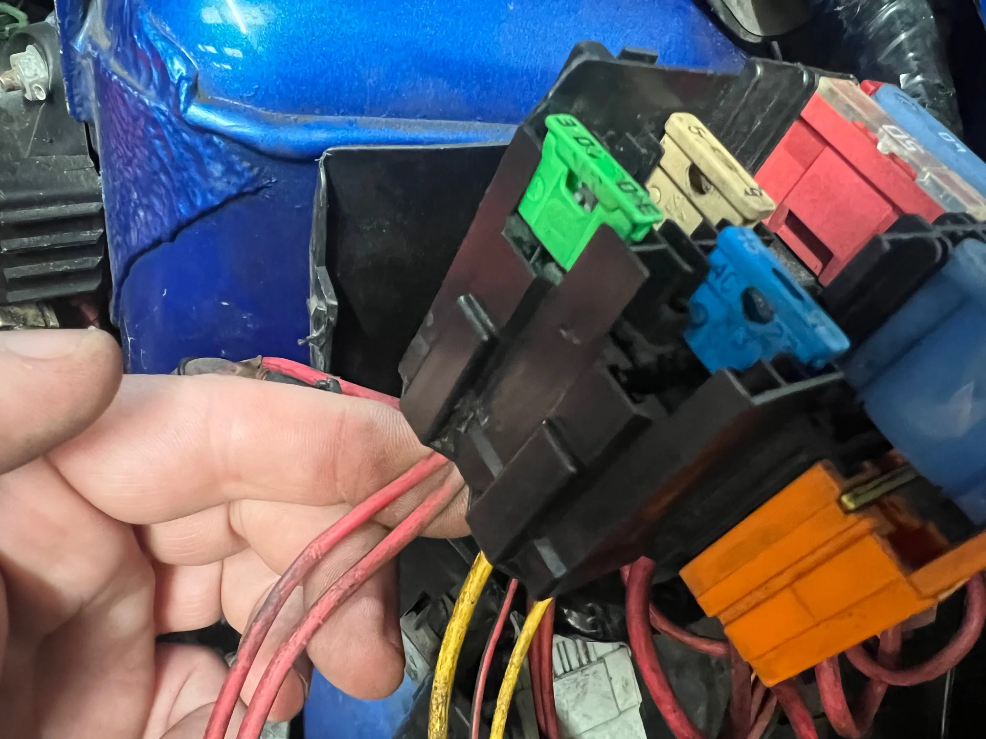

just this week i have changed -
FUEL PUMP RELAY
3 FUSES IN ENGINE BAY FUSE BOX - GREEN 30 AMP, BLUE 15 AMP & BEIGE 5 AMP (see pic)
Also changed 2 out of 3 small brown 20amp relays (one for immobiliser and one for starter)

now since doing all these new relays etc the car wont start as its immobilised and constantly seems like its no power (lights dimming) see vid below...
almost seems like its got a major drain on the battery but its got 14v to the bulkhead connection, starter motor, alternator and all the relays when the charger is on the battery.

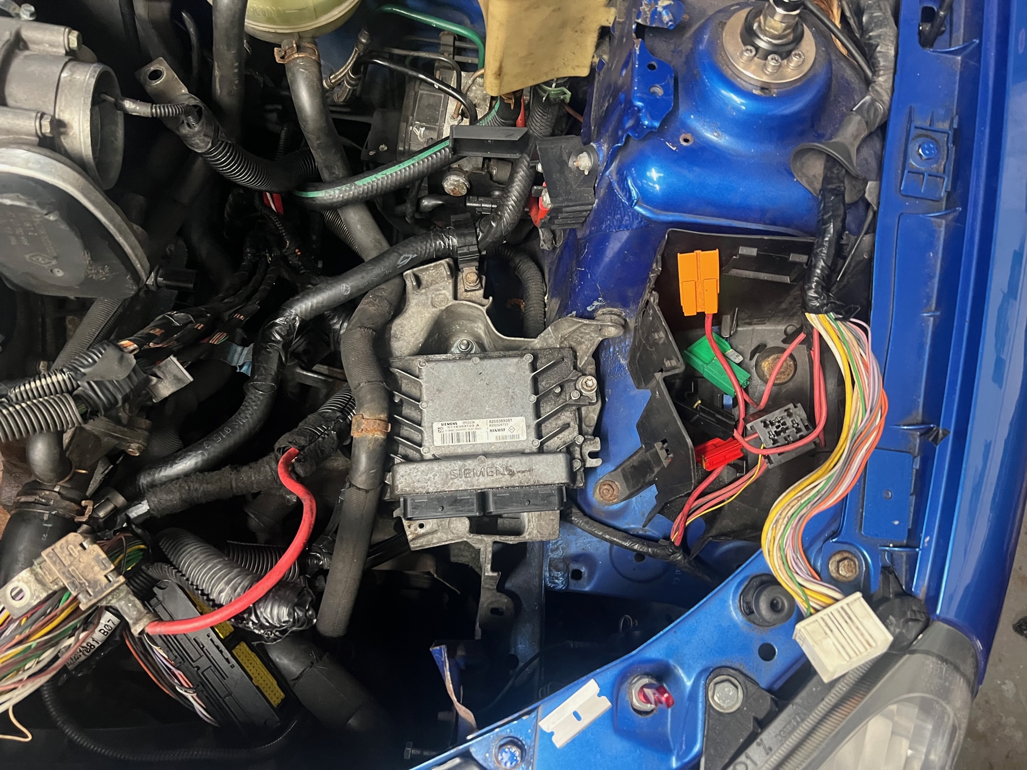

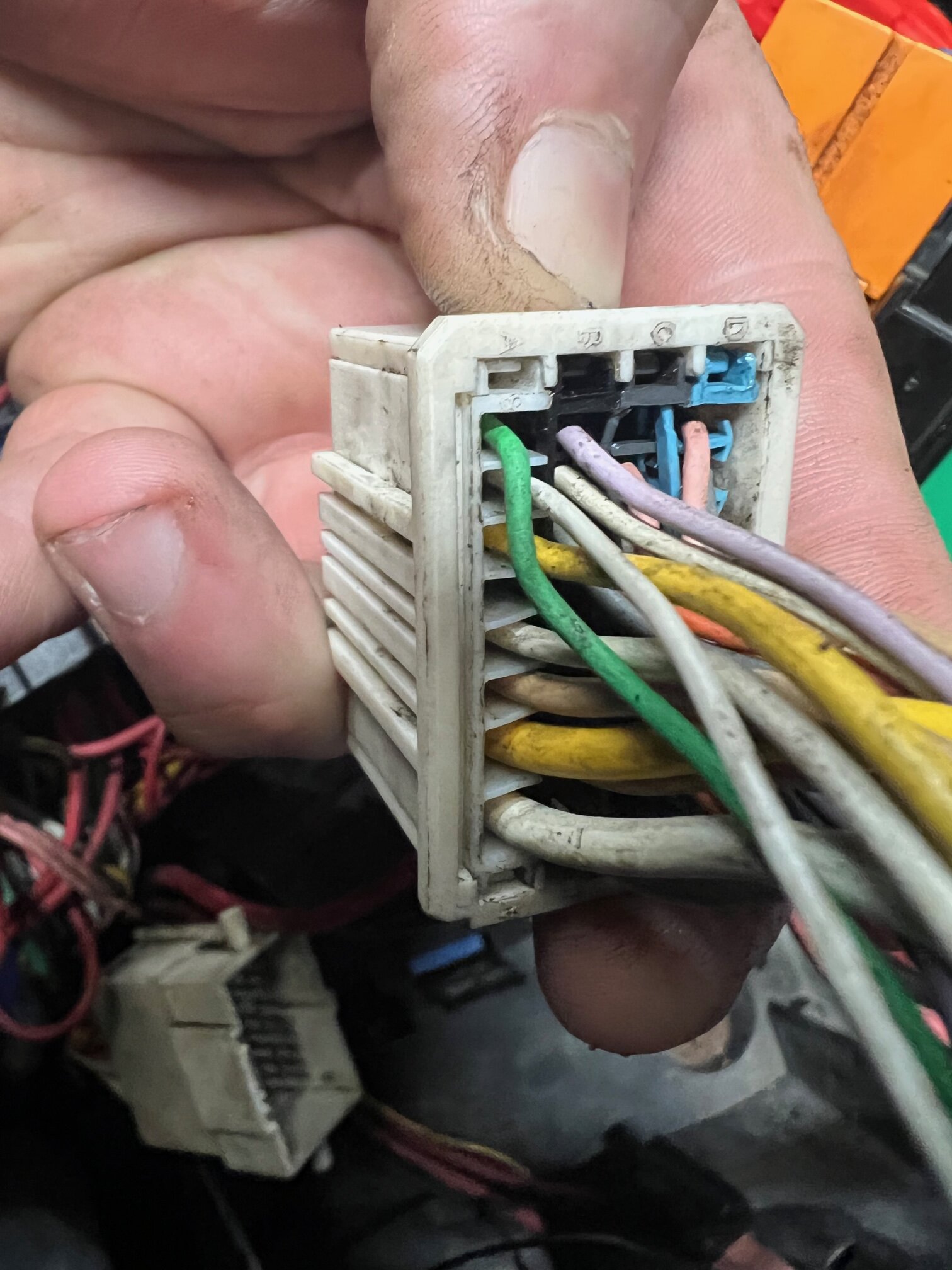

The solid Immob light on, combined with a 3 second crank is saying that it recognises the key in the UCH, but there is a comms fault between the ECU and UCH.
Looking at your post above, suggests you may have a broken/corroded wire or terminal in that area. I think the white plug can be a known one in that area - may be worth opening it up and having a look at the pins for any signs of corrosion.

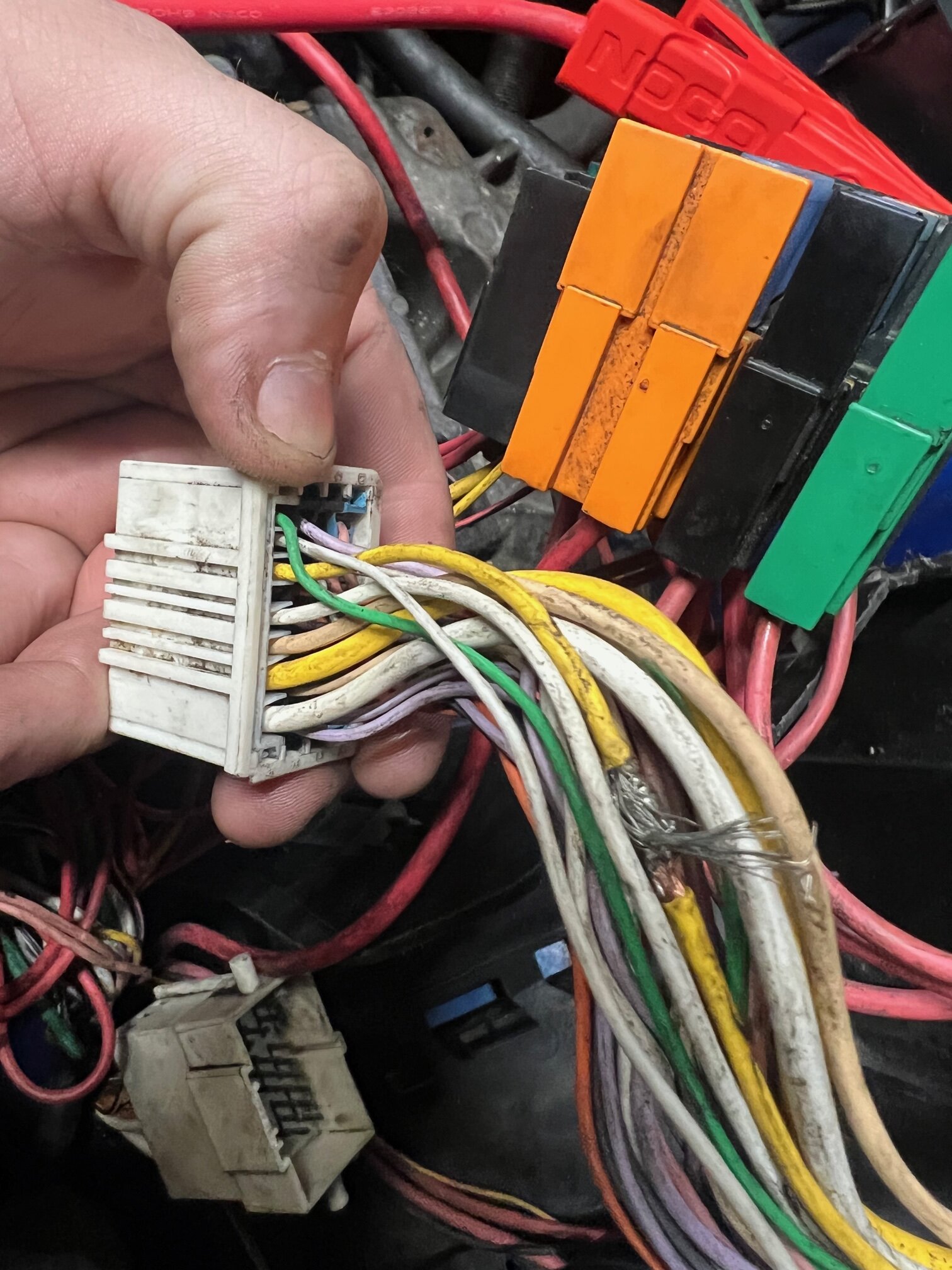

99% Sure its gunna be a broken wire as its extremely intermittent. just not sure why its not holding any charge at all.
did some digging, stripped back some tape from the white plug to the strut tower as it didnt look original tape.
found this wire bodged.. A3 In the plug if anyones any ideas? its been majorly bodged by the ''professional'' who attempted to fit the itbs.
just not sure why hes messed with this wire thats not even part of the engine loom?
white plug had some sort of liquid, can only assume contact cleaner so will dry out with an airline and check all pins are clean,
pics attached.

its only actually 2 of the small brown relays that could cause this issue, middles ones for the starter and the right one is for the immobiliser
the one on the left is just fan low speed. see pic -
