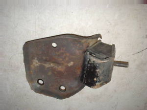

2 engine mounts. 1 lower and 1 upper. The upper engine mount is the one you can see from above the engine, to the left if looking from the front of the car. It is held to the chassis with 4 bolts. The lower engine mount is the dogbone mount and the one you are to replace it with.
2 gearbox mounts. 1 lower and 1 upper. The upper gearbox mount is again, from above but this time to the right and you gain access to it by removing the battery. The lower gearbox mount looks like a wedge and you gain access to it by removing the nearside wheel and opening a little flap.

There are 4 mounts overall.

Well changing the dogbone Is just good practice from what I hear. The noise seems to be coming from the lower gearbox mount then as the noise feels like its near the front right wheel.

Top gearbox mount under battery.
Front lower gearbox mount.
Dogbone lower rear gearbox mount.
Right hand top engine mount.

Cheers bud the garage has fitted the dogbone and reported the noise is gone apart from an occasional knock. They suggested it could be the drivers side mount but it wasnt neccesary to replace it yet.
