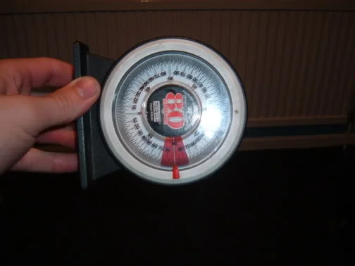

I've pretty much got the camber sorted now anyway....borrowed a very handy protractor tool from work which measure angles. Still need to get the wheels alligned though as this may affect the camber again. From measuring the wheels I have around -1 degree of camber...so it's not too bad at the mo. Is it still worth going to somewhere like Northhampton Motorsports though to get them set up accuratley?Matt:D

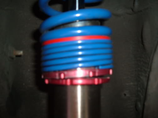

I have a major problem with my coilovers now....I've tried to wind them back down again but both have cross threaded!!! :( I really did'nt expect this to happen so now it looks like there fucked and i'll have to take them off again! Here the pic -
Take them off first before winding any more as this will take pressure of the thread and more than likely stop any more damage. you shouldnt need the thread this high up so you may be ok still.
its more likely that the soft ally platforms are damaged, rather than the body of the damper...
you should be able to get replacements.

Ok...cheers for help lads....I don't know how I get myself in these situations!:o
