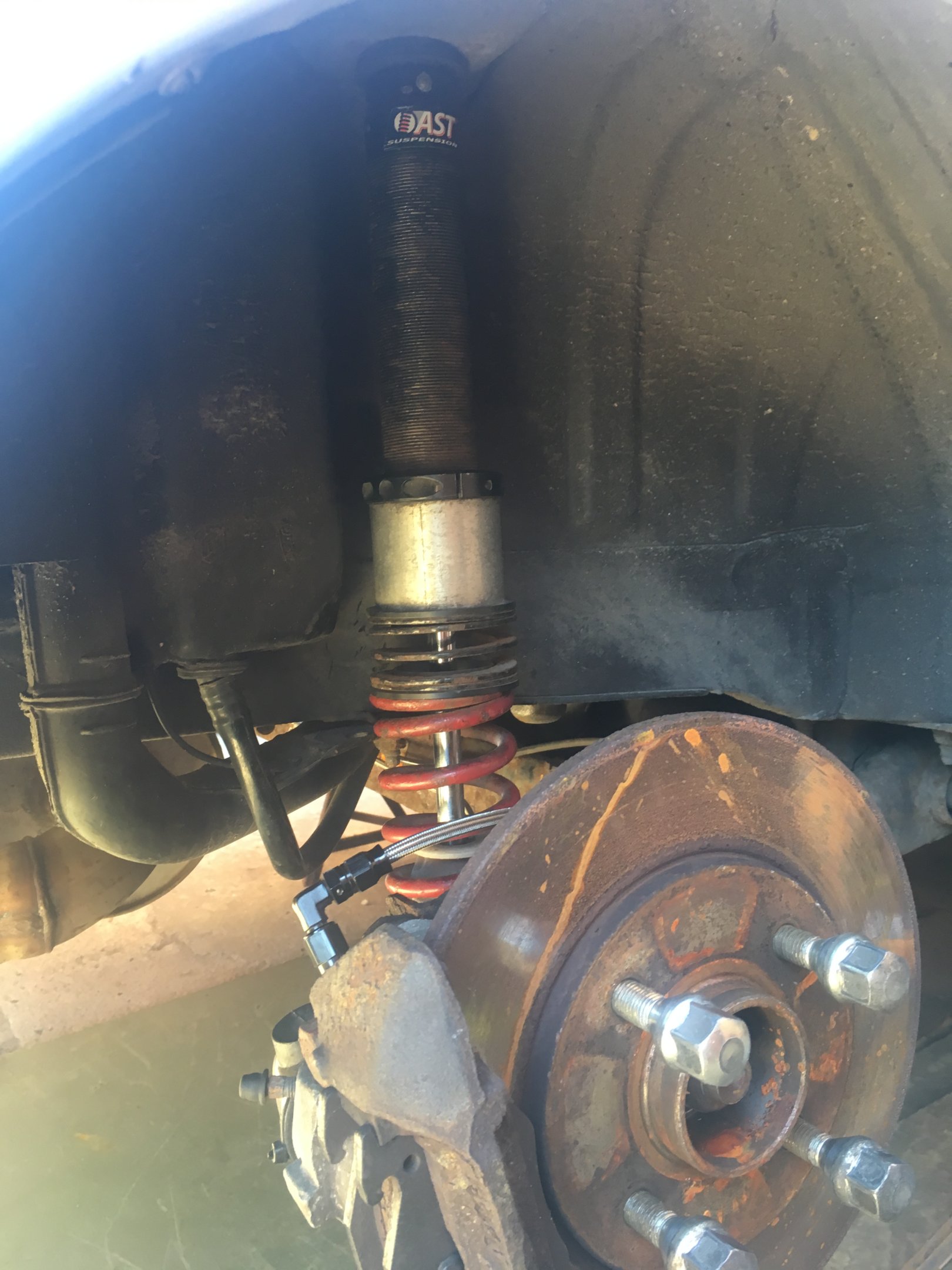

Will longer springs raise them up a bit? I assume its because they cant be done up anymore. Also cant seem to find 51mm i/d springs that are long enough anywhere if someone knows where to look?
You will need to get the correct springs from AST ideally. You have some Eibach springs on there, basically the setup when AST could not supply the correct length and poundage in their own ones. You will have more piston travel too as you wont need that huge spacer..
