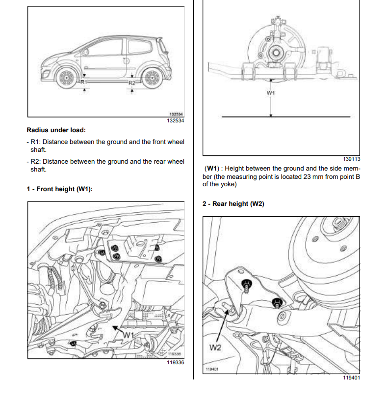

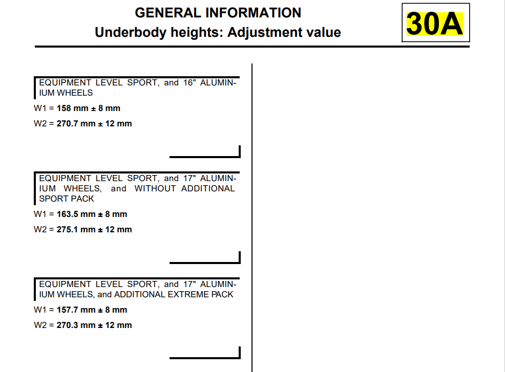

Ok I've found the spec for the RS Twingo with and without cup spec so if aim for the same difference between front and back just slightly lower it should have a similar balance at a guess? or even just a decent starting point (y)

Yeah probably but ill do that further down the road. As above I'm looking to just set it somewhere close, I might decide the suspension is no good with the new engine and extra weight up front anyway so it may end out come off for something different.
