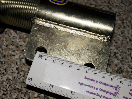

However, thought it sensible to check the hole spacing before doing anything with them. The kit was ordered for a 172 cup, but I've received 60mm spacing :(

I explained the fact that 172, 172 cup and 182's should have 54mm spacing, with the 182 cup having 60mm spacing...only to be told that all sport's have the same hole spacing :banghead:
Stating again that 172 cup should have 54mm spacing and not the 60mm spacing I've received from a 182 cup, I was told again they're all the same, but they'll contact Gaz on Monday and take it from there.

Gaz have said they supplied the correct kit for a 172 cup! They've said that 172 cup and 182 cup share the 60mm hole spacing :banghead: :banghead: :banghead:
They can change them to 54mm hole spacing, by swapping the casing, however that will incur a cost to me. So all in all, completely pissed off by it!
Corby motorsport have given me the contact number for Mark Gazzard, so I can discuss it with them!
I'm certain I'm correct, but just to make sure, 172 cups definitely use 54mm hole spacing, correct?
Basically, this won't fit a 172 cup?

^^^^ correct 172 cup is 54mm

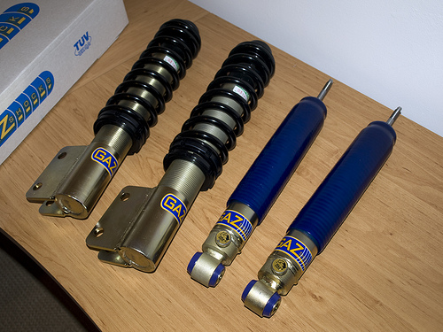

where are the ajuster knobs on the front coilies???
They're on the top; they supplied a key which sits on top and allows the adjustment :)
