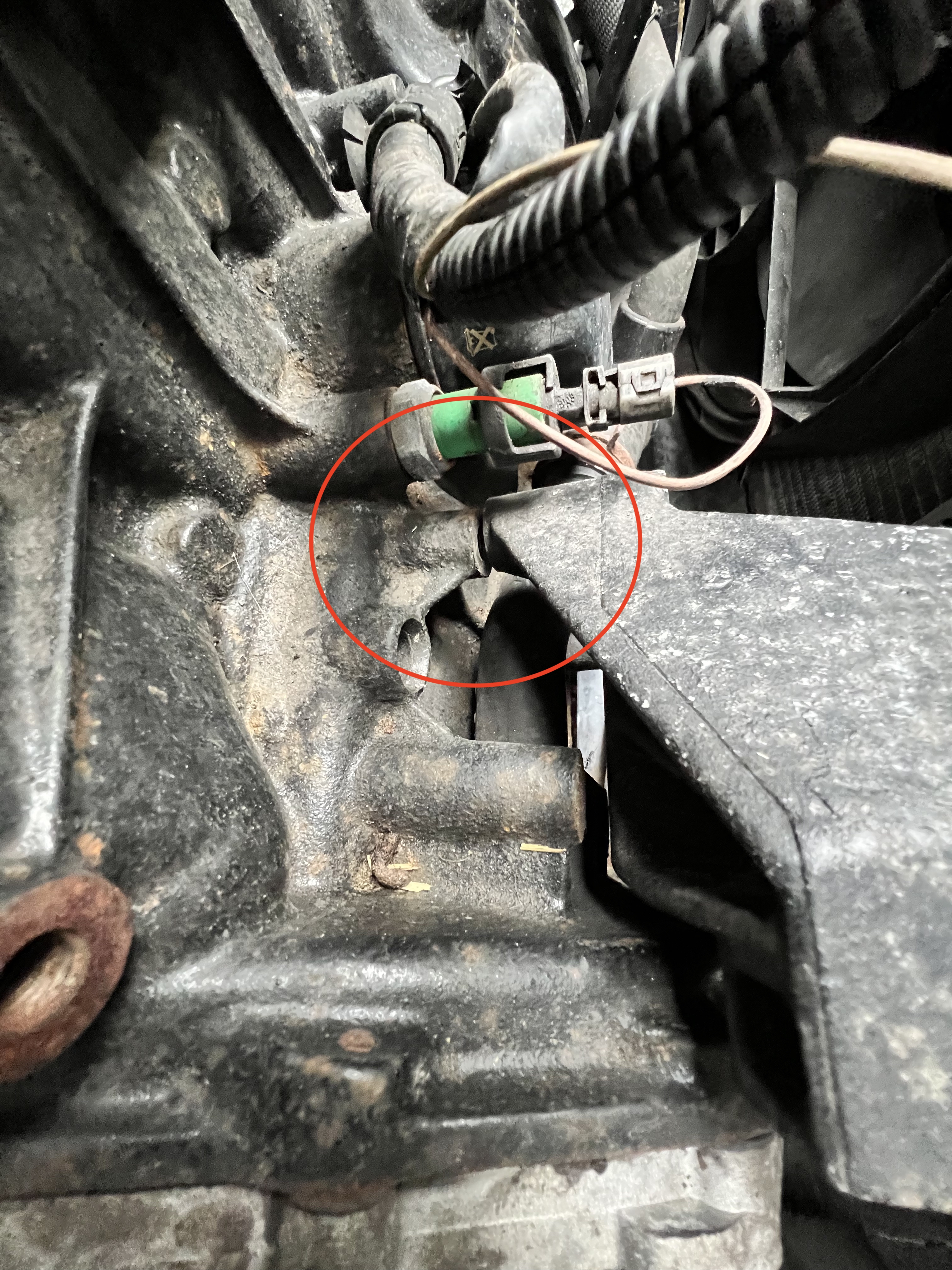

I am attaching a photo of the engine mounting bracket and you can see where the mount is not attached to the engine.

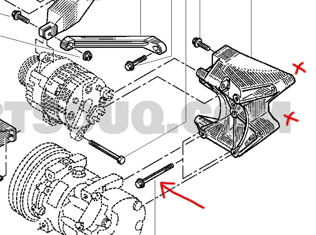

This is the illustration showing the bolt and bracket (arrow and x).
Don't refer to that other thread as he was after the pivot bolt which goes through the alternator.
The bolt you are after is an M10. From memory, it was M10X150-65 mm (150 = 1.5 thread, 65mm in length).
Part Number was 7703002190. N/A from Renault but the good news is the bolt directly beneath it is identical.

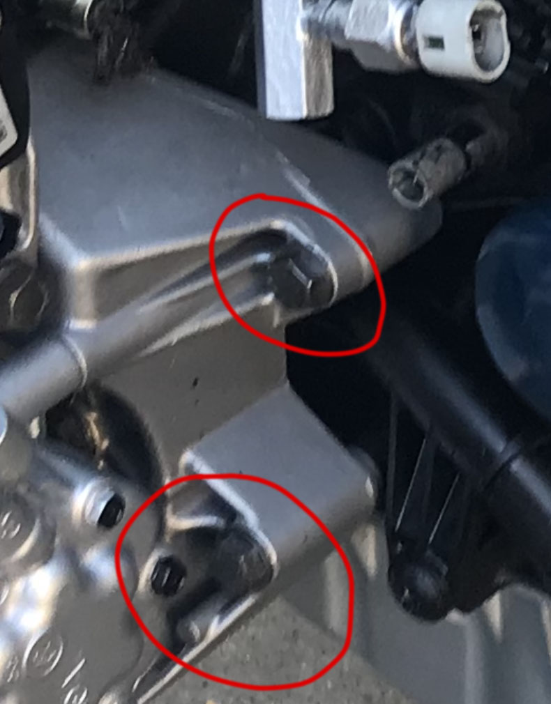

See the picture from my engine. Same bracket, and the same bolts.
So whip the other bolt out and take it to your local fasteners and they'll find you one to match.
