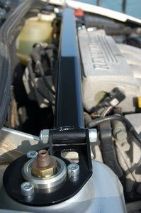

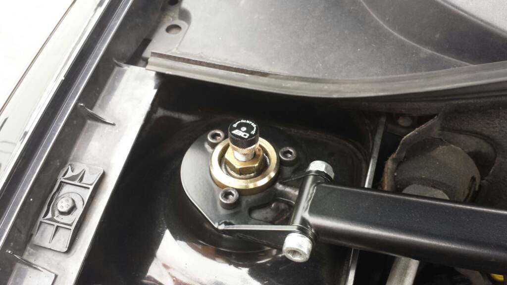

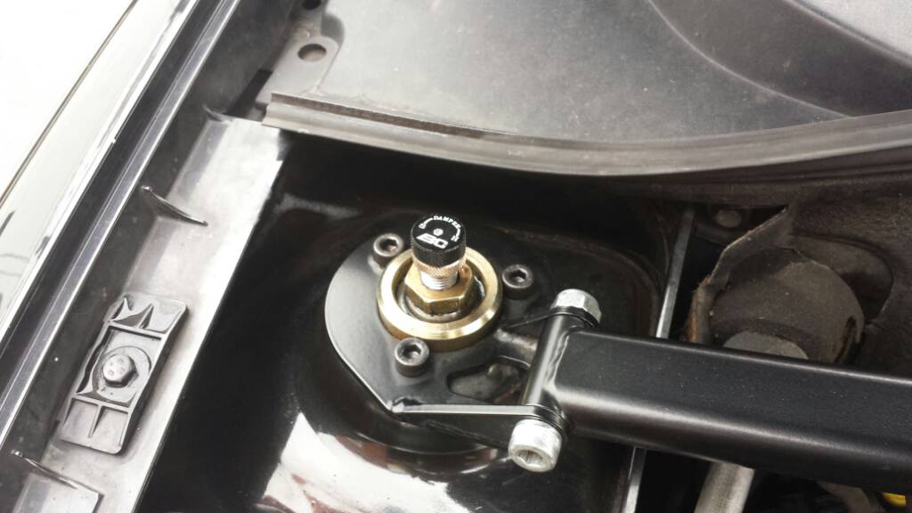

Don't think they offer caster mate no, but makes sense to get the BC topmounts with the coilovers as theyre only £60 extra...
https://www.kamracing.co.uk/car-tun...ilovers-172-182-renaultsport-inc-172-cup.html
Yep, they looked like they do...
"...Like the AST suspension and KAM Racing adjustable top mounts, these Renault Clio solid top mounts have an offset pillow ball mount which can be rotated to adjust camber and caster angle..."
...though doubt it works with PMS front brace without some modification >>>
  Clio 172 (CUP)
Looks good, does a strut brace do much?
It's one of the common upgrades on the Clio, couldn't say what the difference is like on its own, but along with a suspension refresh, cooksport springs and fully polybushed (black series) car when I rebuilt it, it totally tightens up the front end.
