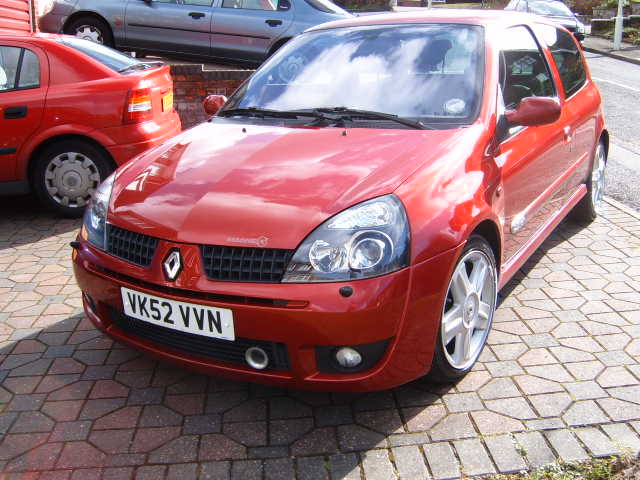

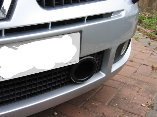

i removed the acoustic valve then ran a feed from the lowergrill up and behind the headlight and stright into the hole left from the acoustic V. basicly same as what you want to do (see grill pic (bit small i know)

Hi, I have done this on My Mk1 172, will post up some pics later. Have used 2 70mm feeds in place of the standard ones. Sounds miles better and more responsive.
