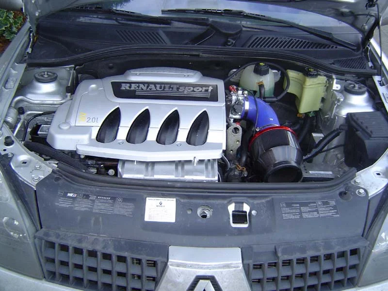

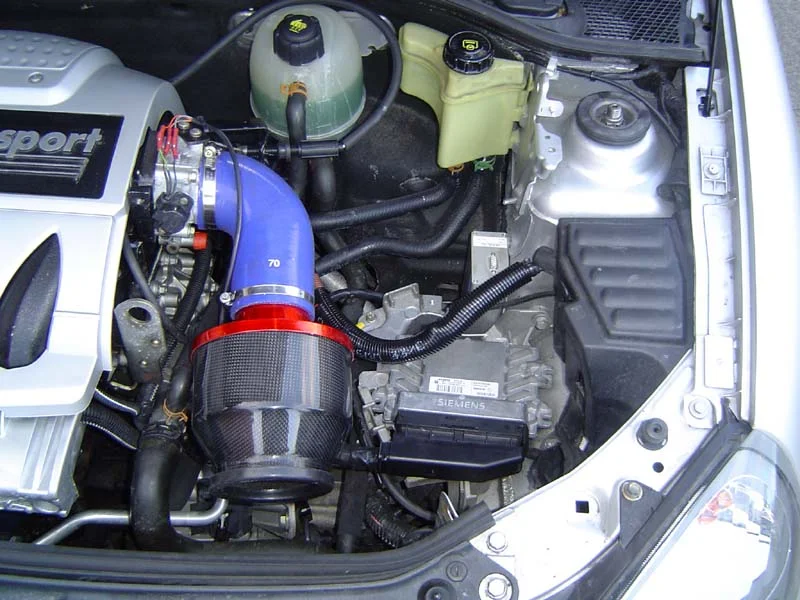

Battery move pics.
Just need to reposition the viper next. I may buy an itg filter and sell my viper, they do a cone shaped one that would fit nicely behind the headlight.

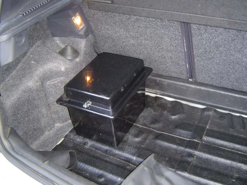

Cheers Mark, looks very neat. Is the battery relocated to the boot? Where is your Omex mounted?
Andy - how about a custom rad with a chunk cut out of it to fit a more direct CAF?
I removed my fog lights and the valve, then just ran the hose straight to the filter. A 70mm hose works best, as it fits perfectly and doesn't get squashed.

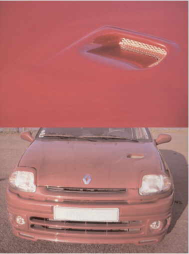

Can't help feeling that the ideal solution for this problem is some form of bonnet vent - SHOCK HORROR. If it's done for a useful purpose, would that be more acceptable to the cliosport purists?
f**k what people think lol, if you want to put a bonnet vent in put a bonnet vent in, can't live your life worrying about what other people think lol
  Ph1
Some idea's on getting cold air in:
Bonnet on this one looks pretty cool but not a clue who makes it !!
Not sure if these vents on these replacement front wings would be affective enough
  Clio 172
Ha ha Lunner - That was said tongue in cheek. I don't give a monkey's what people think.
I'm thinking of relocating the battery and having the IK (where the battery normally is) pointing towards the wheel arch with a side mount bonnet vent feeding the open IK. What do you guys think, on a functional basis?
Certainly on teh mk1 clios you can relocated the IK down behind the front bumper.
The vents int eh wings will only work of you relocate teh filter inot the wing, whcih isn't a bad idea, although i can't see the need for the vents in the wing if you do that.

Battery is in the boot.
The omex is the silver box with the DIN socket on the top, mounted behind the siemens ECU.
custom rad will cost alot of cash.
