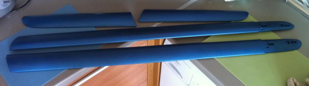

oh, heres a picture of mine when i'd just finished them
sometimes you have to try and if you make a mistake it can be rubbed down and redone, the majority of the time its just about preperation and not rushing things which is easier said than done sometimes lol
