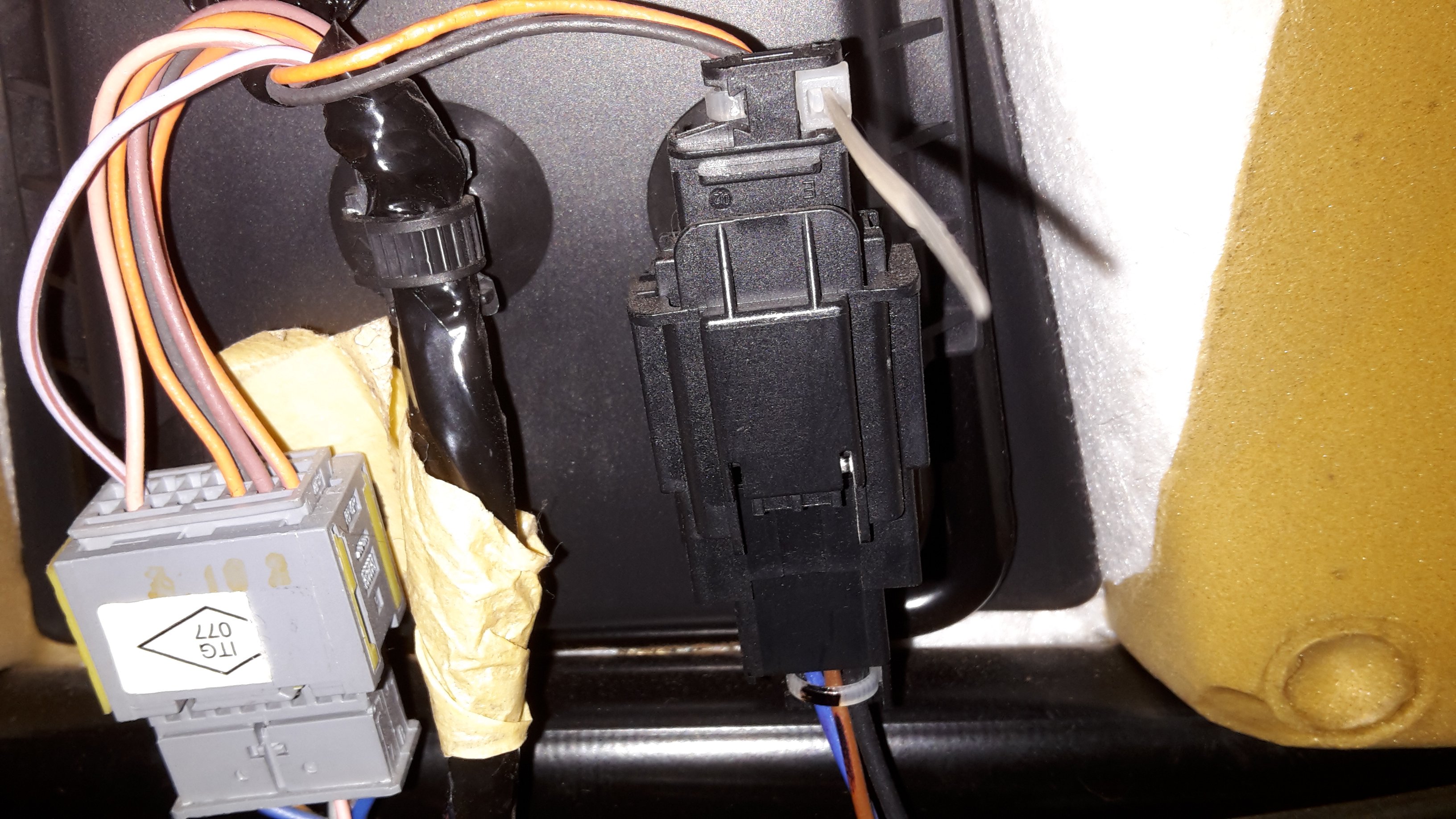

I thought I had the air bag light cracked - connection under the driver's seat wasn't fully home. Only a very small movement to push the connection fully closed, lights stayed off at first but came on again after a few miles and has stayed on. I'll have a look under the passenger seat tomorrow between tests on the Knutsford Autosolo. I'm assuming that the passenger air bag is still present, so would anybody have inserted a resistor below the passenger seat or just the driver's seat as the steering wheel air bag has been removed?
Are you sure the resistor that's been fitted isn't to replace the steering wheel airbag?
The underseat connectors are notoriously dodgy, so it may be worth either soldering them up directly or fitting a resistor.
That's what I'm assuming - whatever has been done to the wiring has been to cater for the removed steering wheel air bag. I haven't checked to see if the passenger air bag is still there but there's not an air bag on the driver's side. Does the passenger side need the resistor soldering in as well even if only the driver's air bag has been removed?
Attached a picture of what I've found under the seat. the bundle of wires with what looks like masking tape around it goes down under the carpet. There's insulating tape wrapped around the lower part of the cable bundle so I'm guessing that's where the resistor has been fitted. I'll pull it all apart and check the connections in the plugs next week when I have more time.

And the SERV/Airbag warning light was due to the connection under the passenger seat, as you all said, thanks.
