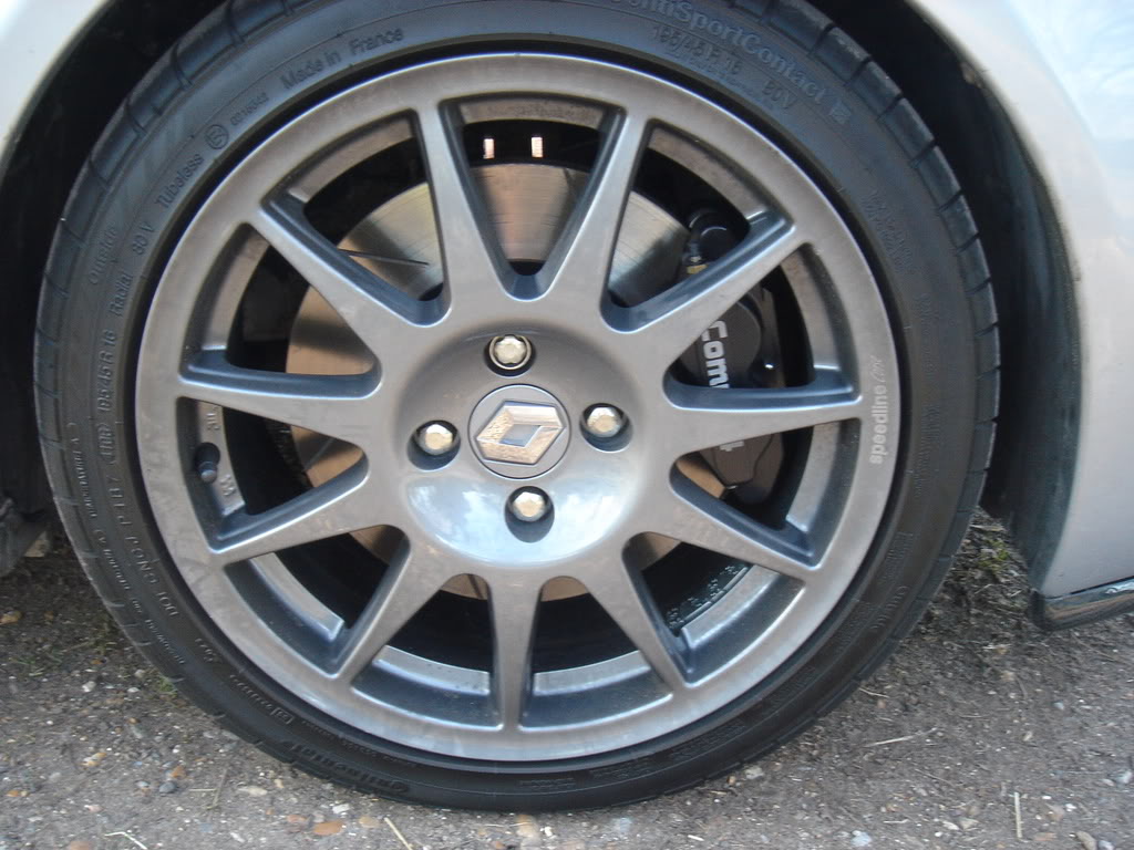

4 pots are the better option for trackdays, everyday a good setup will do as well, but 4 pots dont fade as much.
Fletcher
Do these come as a complete kit? Brackets and all?
Cheers
Anthony
Yep, all the fittings and fixings in the kit,IIRC now including Goodridge braided lines.
I have this kit fitted to my 172, great stopping power, and no fade whatsoever.
Also they're a lot lighter then the standard set-up, and look 100x better IMO.
  Mini JCW
Yeah braided lines are included too :)
Awesome, I am very tempted to purchase them
