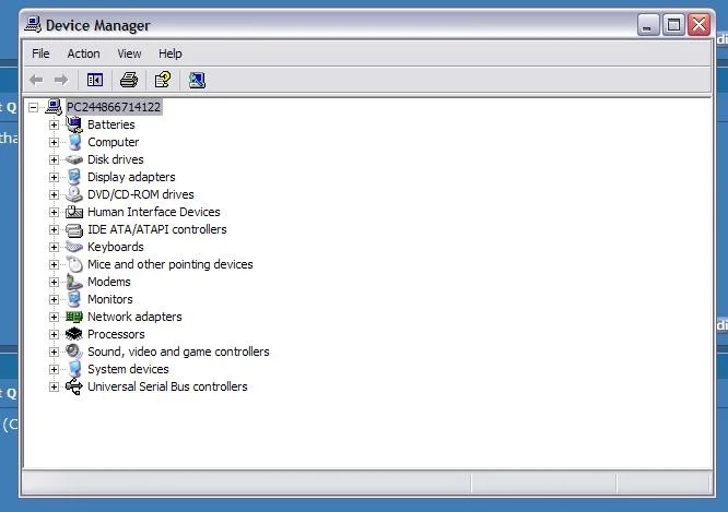

You can check by right clicking my computer.. going to device manager and seeing which ports are installed.
I dont see ports :(

humn. You really need to see the "ports" section that daz mentioned earlier, but that isn't showing up on your computer!
When you insert the cardbus card does the computer go "Bing Bong"? Have you installed the drivers for it?

and im guessing it would show up in that ports section if I could see it?
Yeah, I would expect that.
