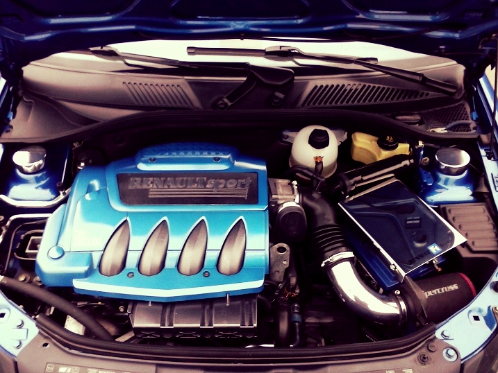

I used this filter...
http://www.regals-motorsport.co.uk/s...eck-c0171.html
and this 70ml 90 degree bend...
http://www.ebay.co.uk/itm/2708657138...84.m1439.l2649
  RB Clio 182
Does that just attached to the original pipe that goes into the normal airbox? Then with 2 jubilee clips?
Yes mate, its the standard hose from the tb to the alloy bend, all you need is the alloy bend and filter, i think you get a jubalee clip with the filter, so you shouldnt need an extra clip either.
Hth, Tom.
  RB Clio 182
Liam how did you secure the filter mate, cannot see your bloody thread about it!
The filter sits snug behind the battery and fuse box, it doesnt need a bracket as the alloy bend is sturdy enough, it doesnt budge where its sat :)

Just finished measuring mine all up and test fitted it. Im just trying to decide on what filter to get, mine is slightly different to the pics above though as I've used 2 silicone hoses, with a aluminum joiner inbetween them.

I made a KTR copy as per artic clio with a pipercross filter(not the same one as him) and the 90 deg bend and it sounds mental on full chat, cost me about £40 all in - bargin!

Just make sure the fiters not too big to fit behind the battery, thats why i used the slim pipercross one and thats a tight fit.
