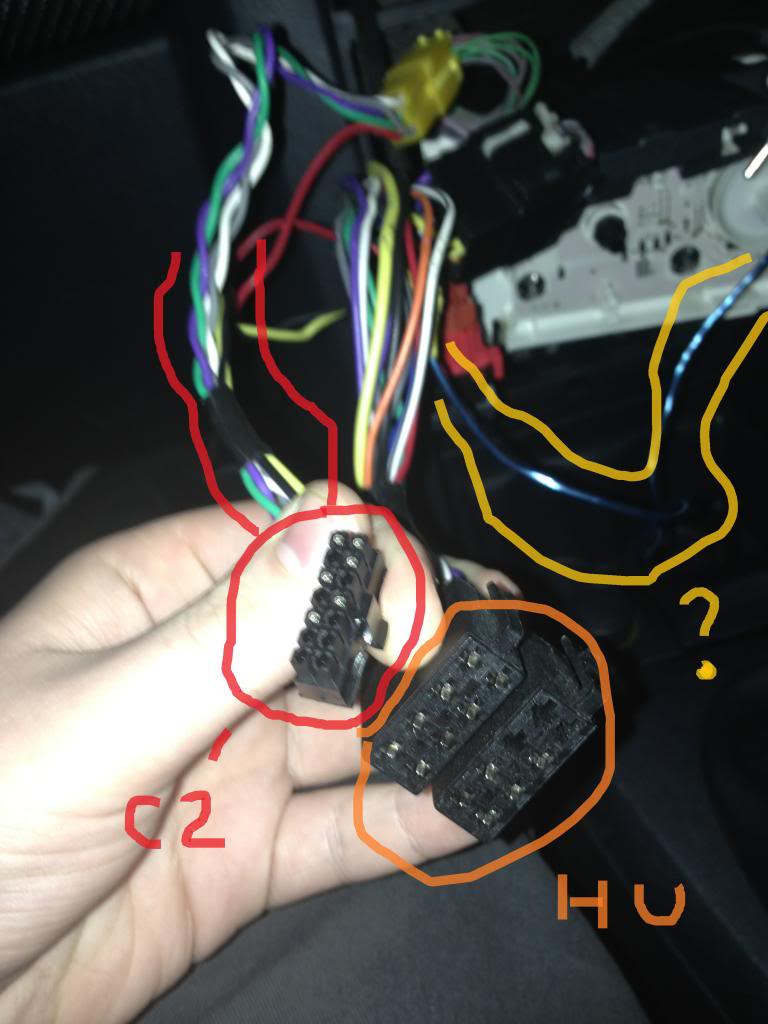

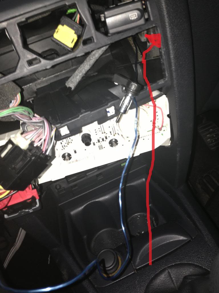

I have the block for the Headunit and this connects2 adapter im assuming? this wire then goes back and splits across lots of different ones including a blue one that goes up behind the dash.

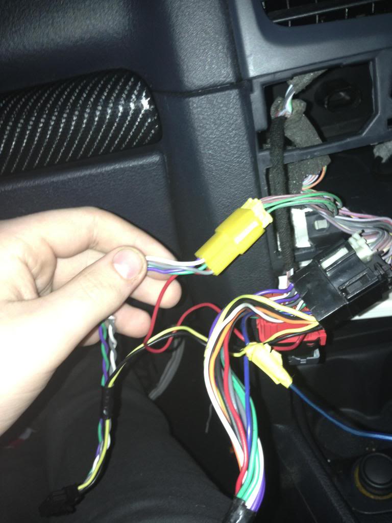

The said wire
more cables :s

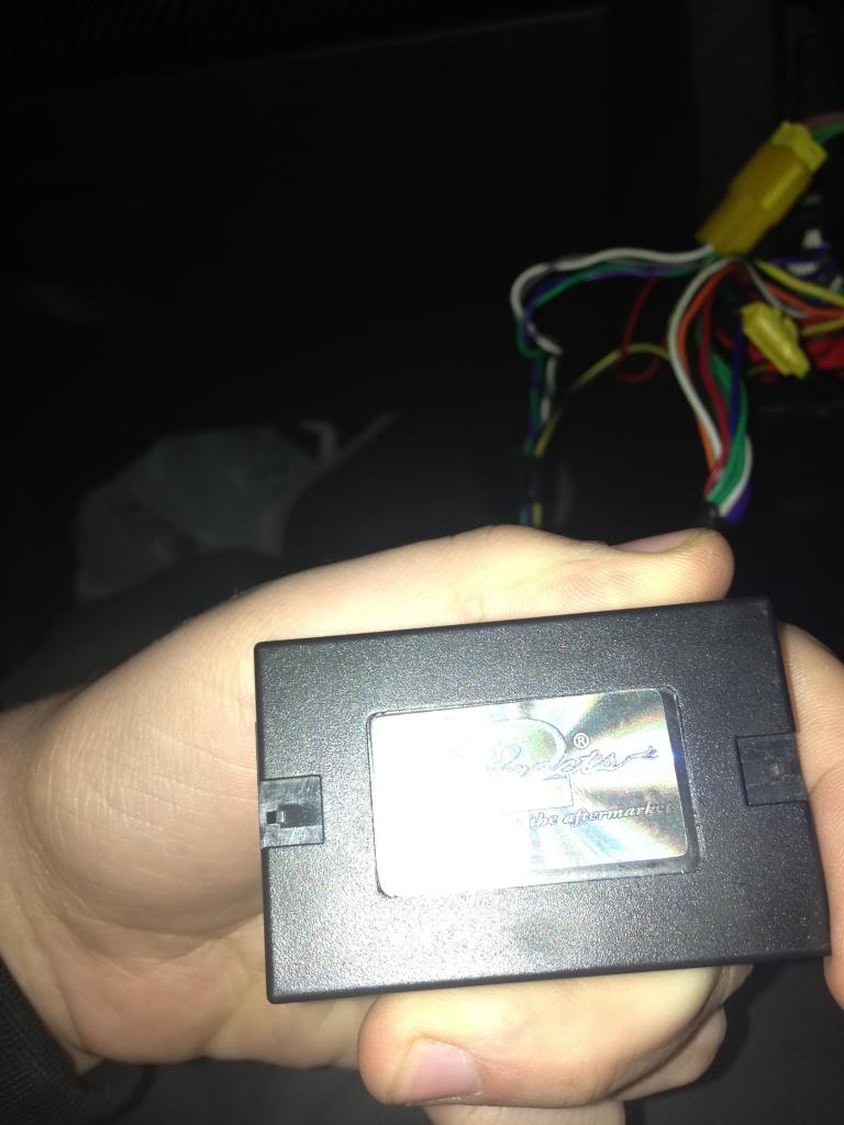

the connects2 box

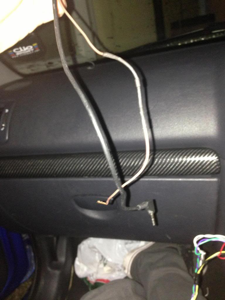

a brown wire and a 3.5mm headphone jack? :s this has a connector on the end that fits into the connects2 box
When removing everything none of this was wired up??

Its a stalk adapter harness. Allows you to control an aftermarket headunit from the steering wheel controls.
The blue wire looks to be a remote wire for a previously fitted amp.
If you want to get rid of it just get a standard kenwood harness, unplug the existing one from the little yellow connector, and the iso block.
Then fit the standard Kenwood harness and leave the yellow plug coming from the loom loose.
Or you could unplug the patch lead from the connects2 box (the 3.5/2.5mm + brown wire harness) and source a kenwood one so you can use stalk controls with your existing headunit.

It means you can run your Ipod/Iphone instead of the 6 disc changer whilst still maintaining the stalk controls. Looks OEM, but also allows you to put the device in your glovebox away from prying eyes.
Oh right I think we have different connects2 boxes mine retains stalk controls with an aftermarket HU. I think Jared has the one that allows aux/iPod with standard HU

Correct, you have the connects2 stalk adapter, nobrain has an ipod/aux adapter. To completely different things.
