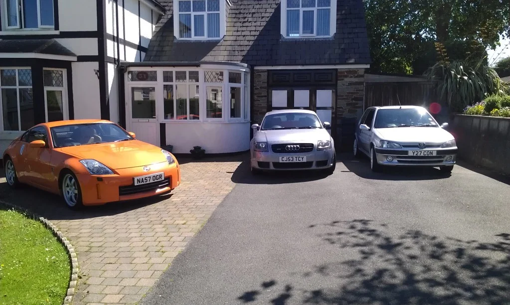

Bit of background info.. have come from a 106 Quiksilver.. was mint and was a helluva lot of fun and made me smile very often! however, the time came to move on!

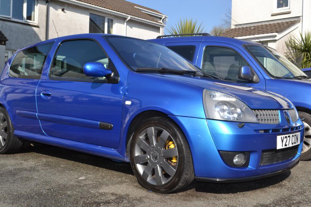

There she is above next to my aunty's and cousin's cars :p

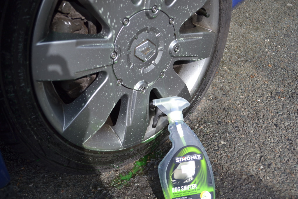

I first gave the car a spray over with some bug and tar remover in the common dirt areas;
i let this soak and then got a "pressure washer" and put some shampoo and hot water in there ready for a rinse!

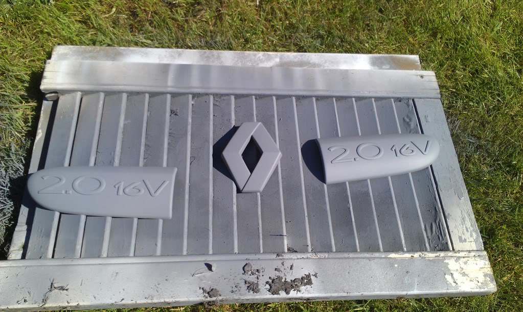

The plastics were looking rather worse for wear (forgot to take pictures before) so after a great deal of bumper shine they looked like so;

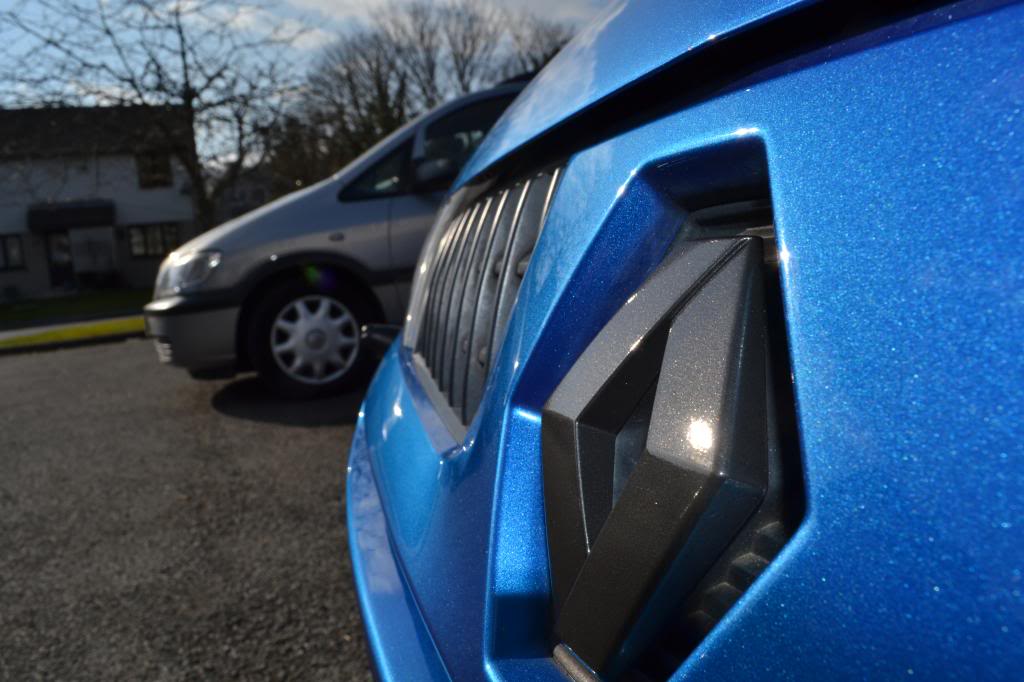

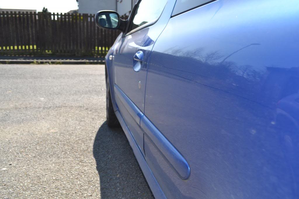

Once i had finished the whole car i got to work on the sill, 50/50 shot;

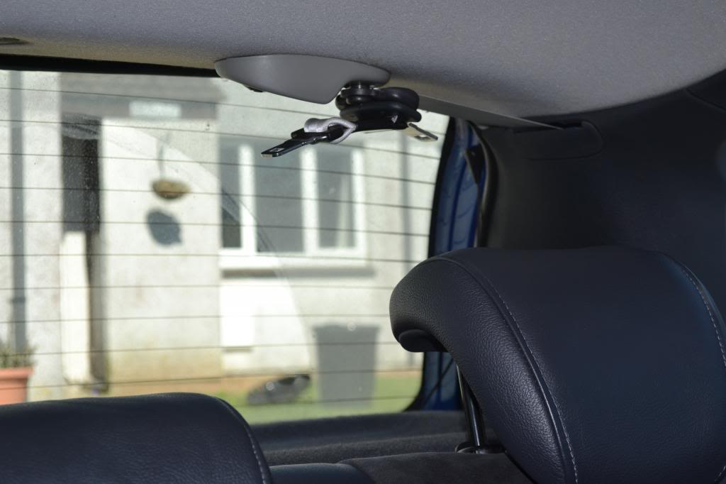

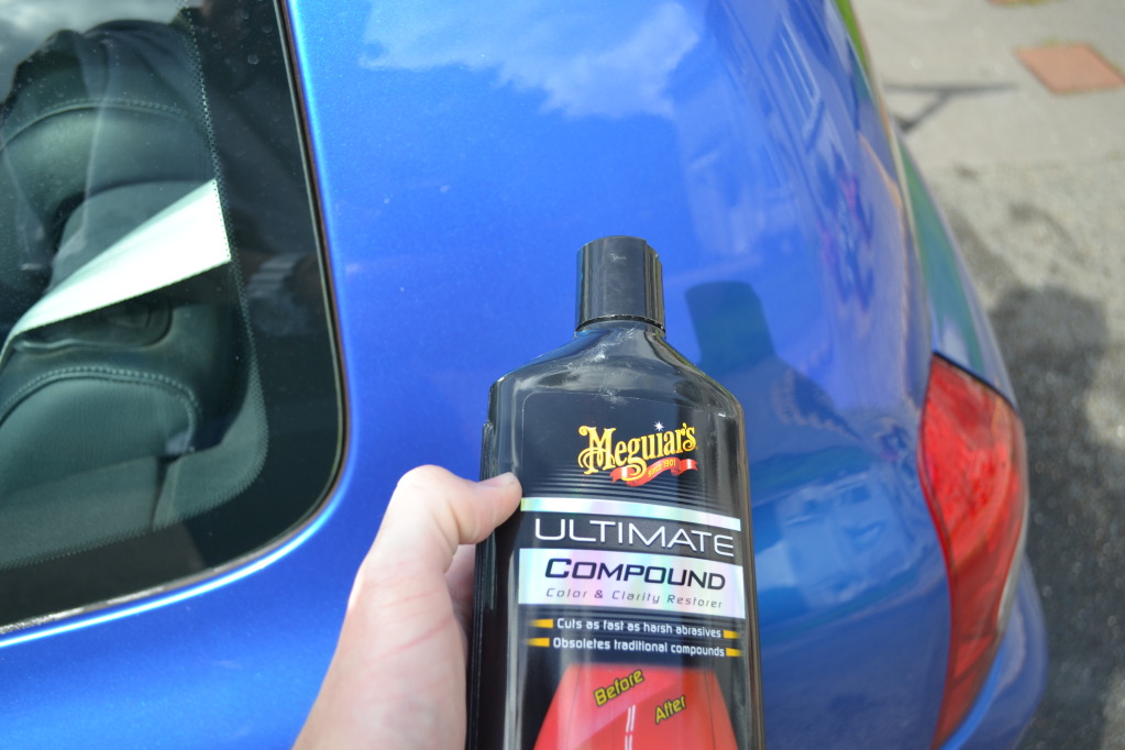

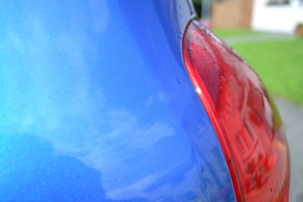

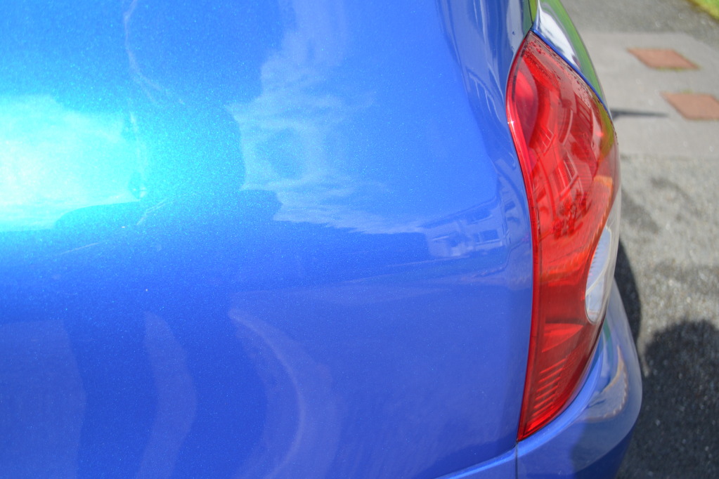

when i bought the car, i knew full well it was in need of a good detail.. there were a couple of spots where the lacquer had been marked;
so out came the meguiars ultimate compound..
and its nowhere to be seen!

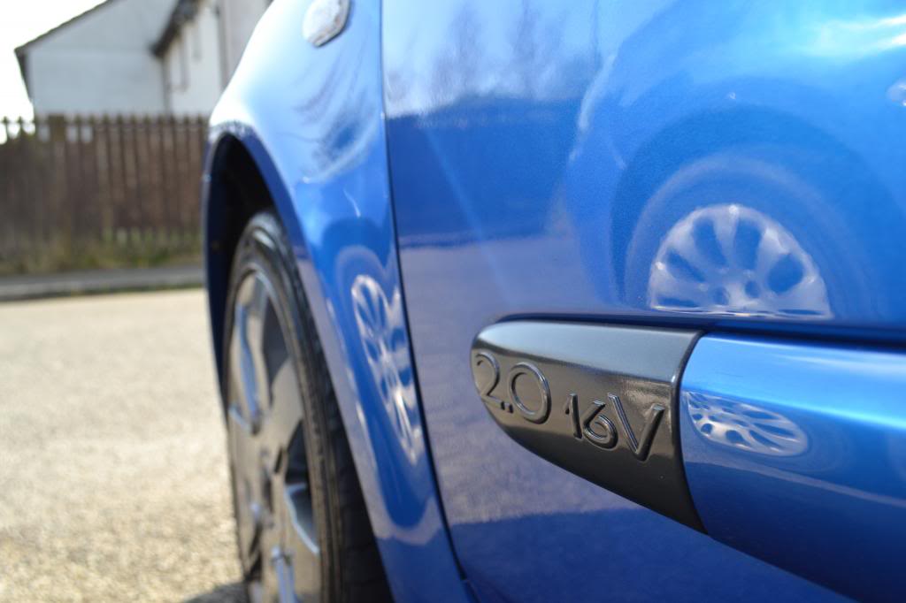

and to finish up, none other than;
matte arctic blue anyone?
even the cat came out to help!
and then the finished article :p

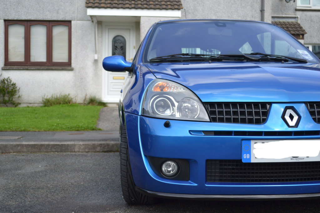

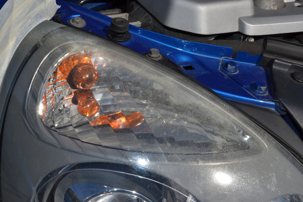

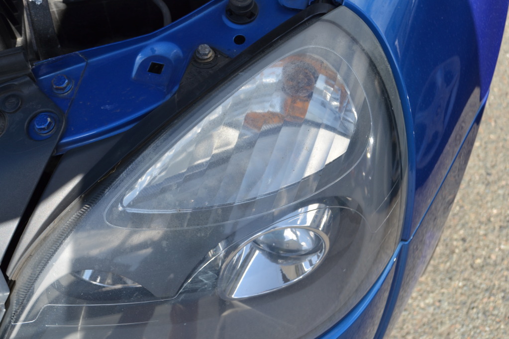

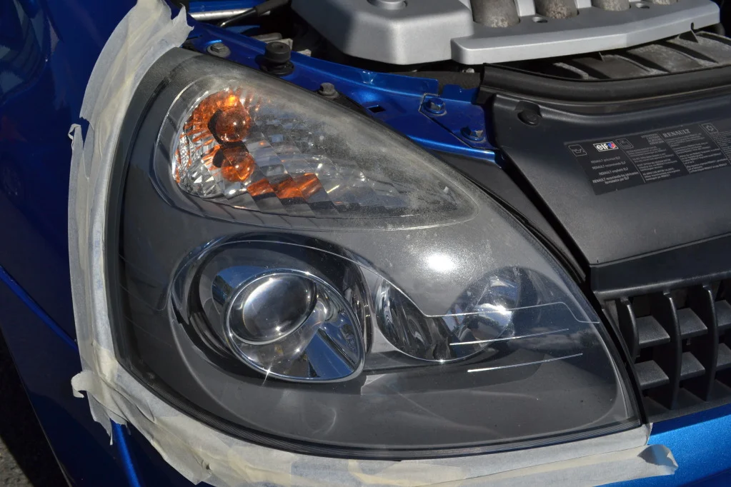

Headlight Correction
So 13 days after my op, and near enough 3 weeks after the break the novelty of sitting on my ass doing nothing has worn off.. and daytime tv is utter shite :dapprove:
Having only sat in the passenger seat of the car for the majority of the time I have owned the car I wanted to get my hands dirty again, so not needing to stand to do it, i attempted to correct the headlights!

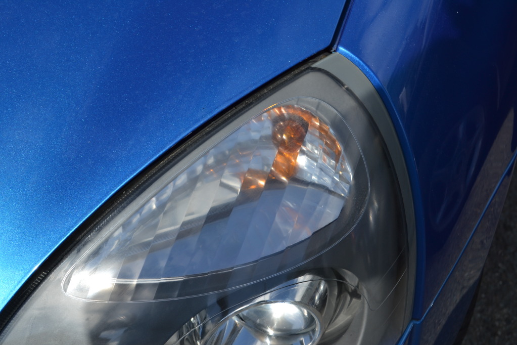

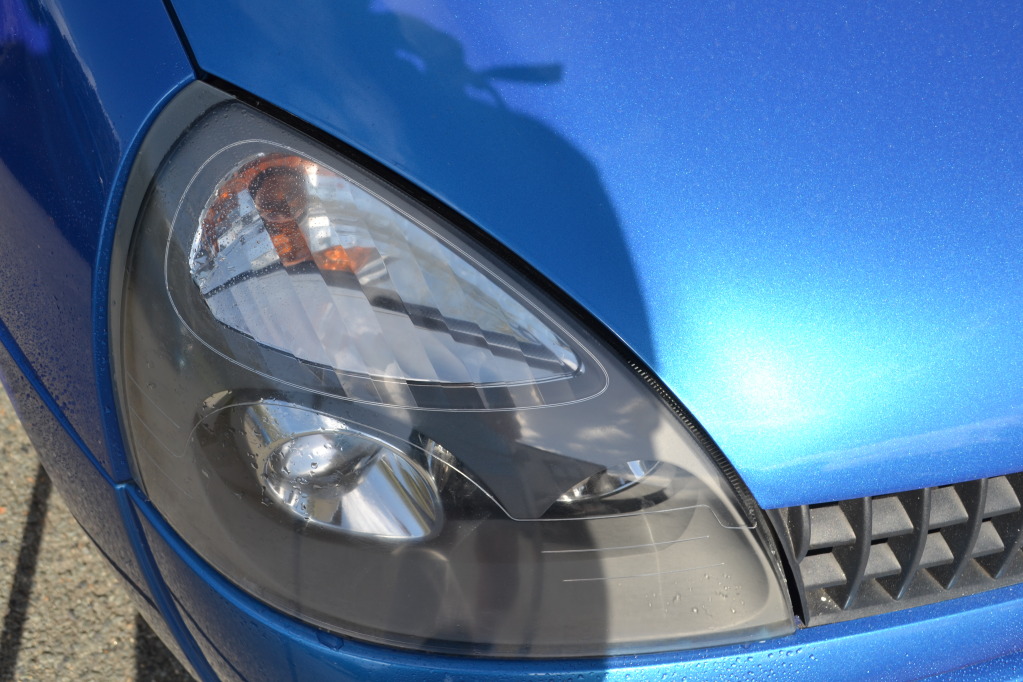

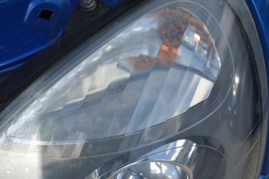

To be honest the headlights were not all the bad to begin with anyways, but who likes ragged old headlights anyways?!
I had some 800 and 1200 grit sandpaper already from previous painting sessions with the 106, so got to work wet sanding them until the headlights were hazey! In hindsight, i should have started with 400 but hey ho!:D
Finished them off by applying some rubbing compound by hand, and then followed by some meg's UC to shine em up!
results;
by no means the best results that I could have acheived, but it was just to diminish my cabin fever for a bit... and i am a cripple:rasp:

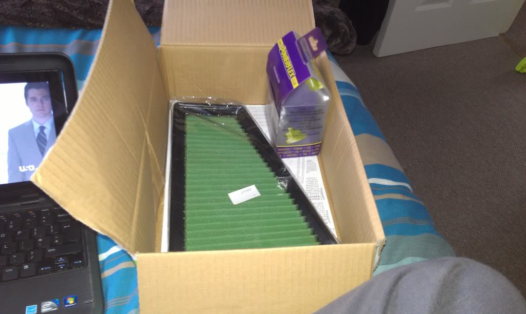

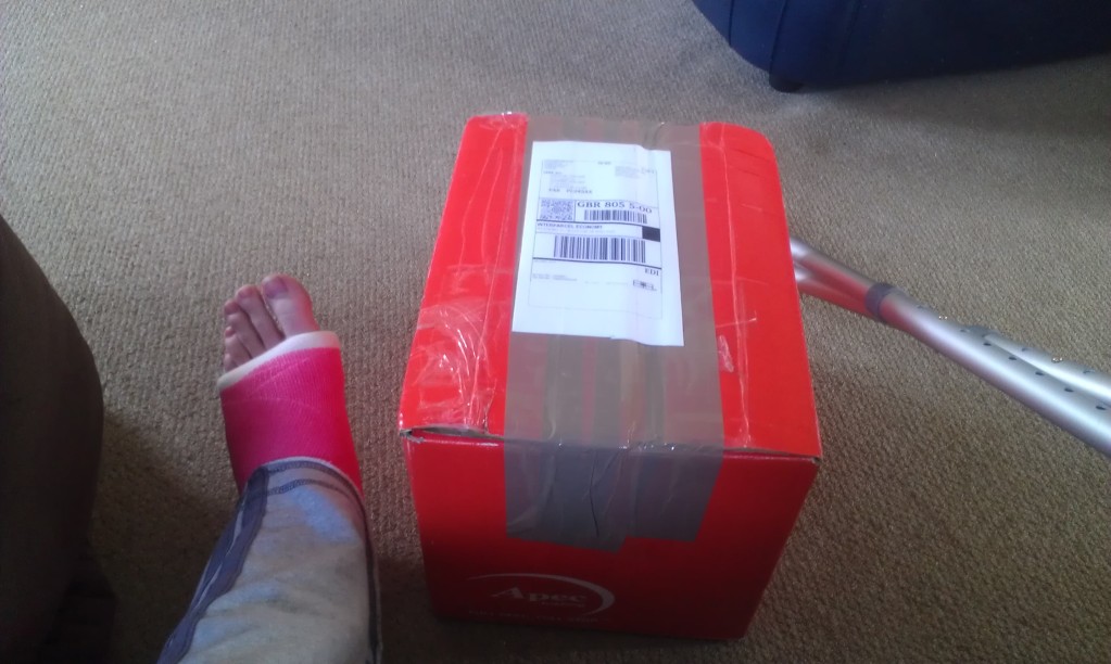

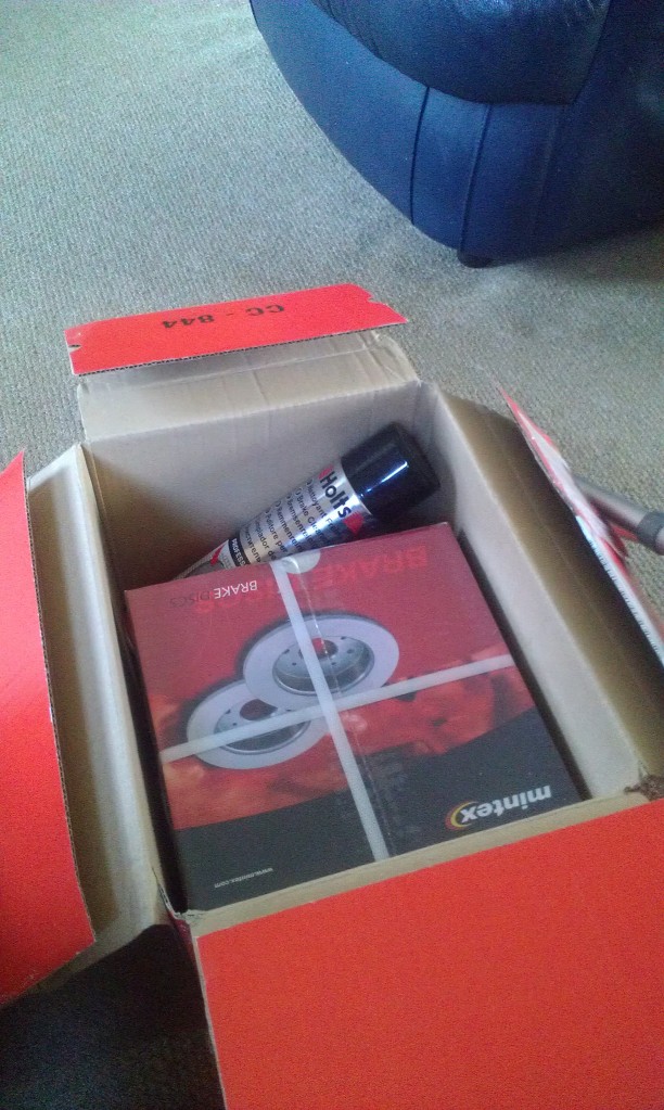

Not wanting to miss out on a bargain, I ordered these on Wednesday and they turned up this morning (Friday).
Nothing exciting but heres some pictures!
The box alongside my fetching cast and crutches!
Box at first glance

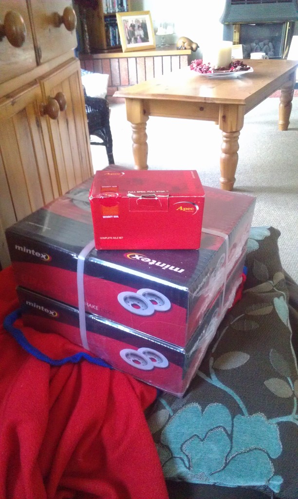

Contents of the box. Bit disappointed as I thought I was getting mintex discs AND pads.. turns out that its just a generic brand of pad. Nevermind!
Making his second appearance on the blog, my cat decided that my empty box was is new home! :p
So as soon my cast comes off I should be putting these straight on (the 19th October)

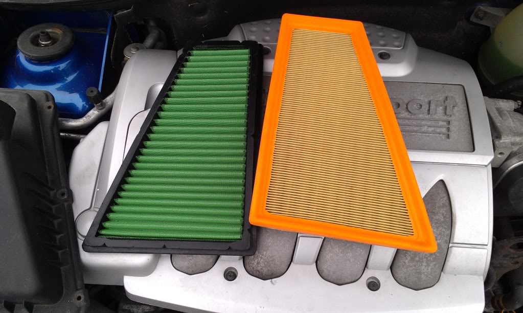

I am looking to replace the current filter with perhaps a green cotton filter or similar, anyone had experience with these?
I am also looking at a decat, but again is this really worth it?
Comments and suggestions welcome :approve:

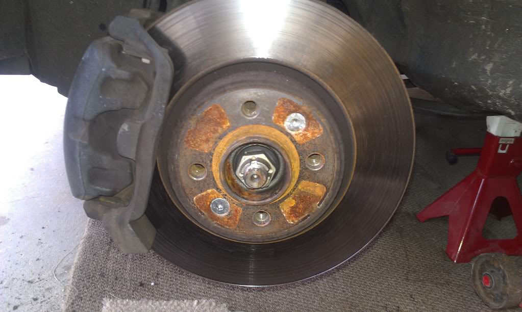

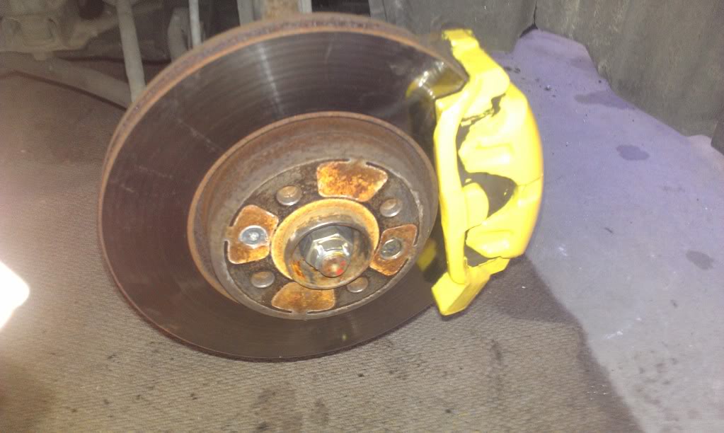

Onto the car... so on the sunday after the cast removal, I deemed myself fit enough to get down and dirty with the rear discs/pads :rasp:
Unfortunately due to my mobility I shy-ed away from taking photos and just got on with it in case I started to ache, so sorry for more writing than pictures!
Drivers came off nice and easy, but the passenger side needed a little more persuasion, but got the job done in the end no troubles!
It was safe to say that both the discs and the pads were shagged, the pads were near enough metal and if I find them I will upload a picture!
I did this job with my cousin who owns a 172, not sure of his name on here, but having moved my car he noticed how the brakes were quite spongey in comparison to his, so I am buying some braided lines and giving the car good bleed!

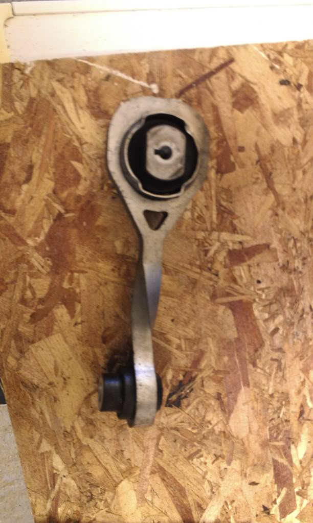

Also whilst we had the car up on the stands we took a look at the exhaust and CV joint which had come up as advisories on the last MOT. Having assessed both, I took to ebay and bought the required parts!
Pics of the shagged exhaust clamps;
notice alot of smoggy blackness on the second picture.. both are being replaced to try and cure the leak!

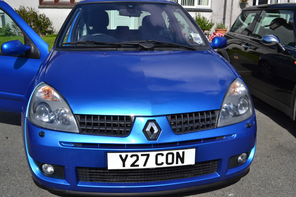

and quick snap of the car in the garage;
Arctic Blue looks very nice in different light!

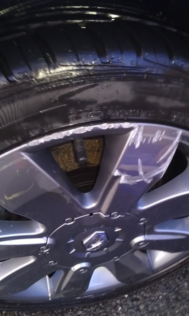

Also very very annoyed with myself as I have kerbed one of my wheels :mad:
If I am honest none of them were kerbed, although this one was worse for wear so was in need of a refurb anyways.. someone say silver lining?

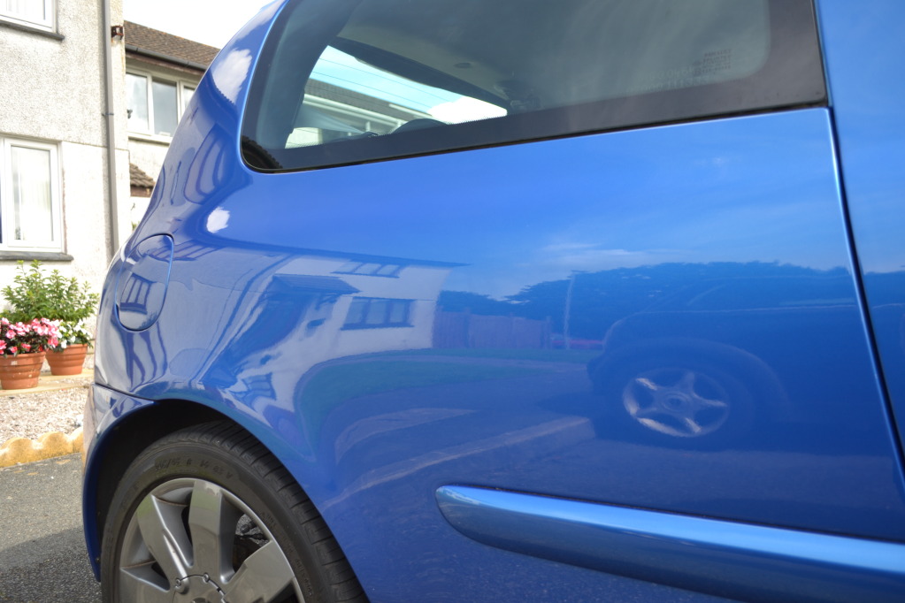

So with the weekend off, I planned a detail session with the help of a friend, a Makita machine polisher and plenty of tea :p
Saturday came, and after getting up at 9 to pick up the Makita off of a mate I cracked on with the onset of a rain shower imminent. My intention was to just use the Makita on my headlights which were in need of a good seeing to! However, I got a tad carried away and decided to continue with the bodywork :rasp:
And then... THE HEAVENS OPENED :banghead:
And unfortunately stayed open all day, causing me to abandon the detailing session till Sunday!
In fear of a repeat of Saturday, I text my cousin, so I could borrow his garage for the day and play continued on Sunday morning.

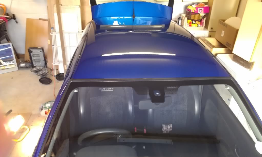

Again I started early, and took my car up the road. I had only managed to do the headlights on Saturday so got cracking on the bodywork!
I used a combination of a 3M Green pad and Megiuar's Ultimate Compound purely because I couldnt be bothered to buy more polish! Then finished up with a healthy layer of AG HD wax
I did bring my DSLR but failed to take pictures beforehand, and afterwards because it ran out of battery :eek:
So a couple of phone pictures from afterwards;
Nice bit of sparkle in this one as well as my ugly mug ;)

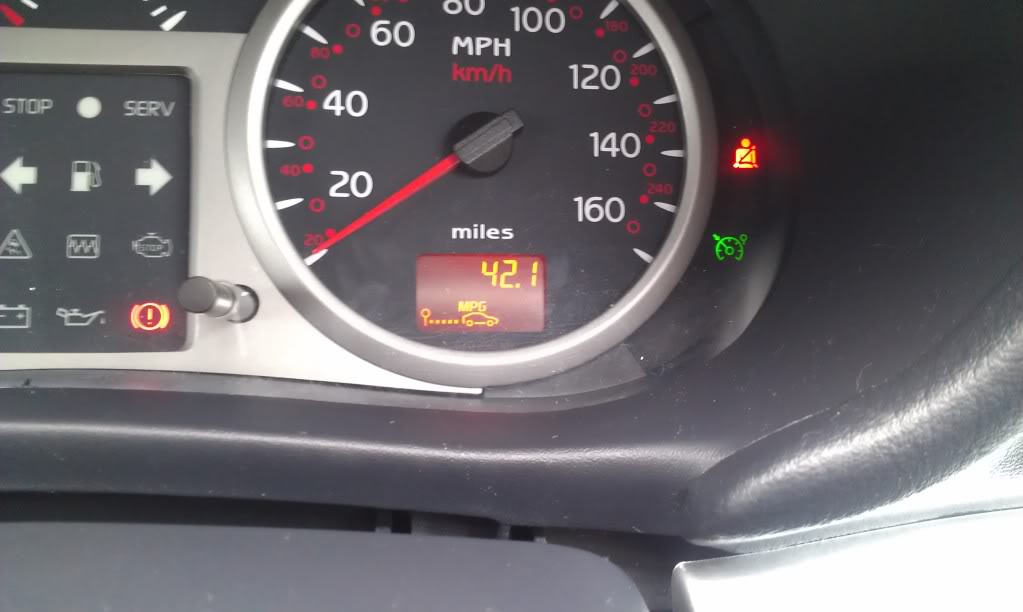

and who said the Clio sport wasn't economical :cool:

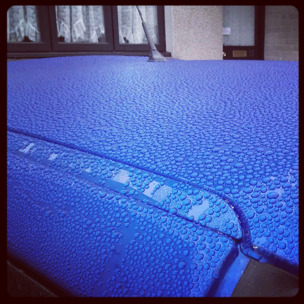

bit of epic beadage from a couple layers of AG HD wax

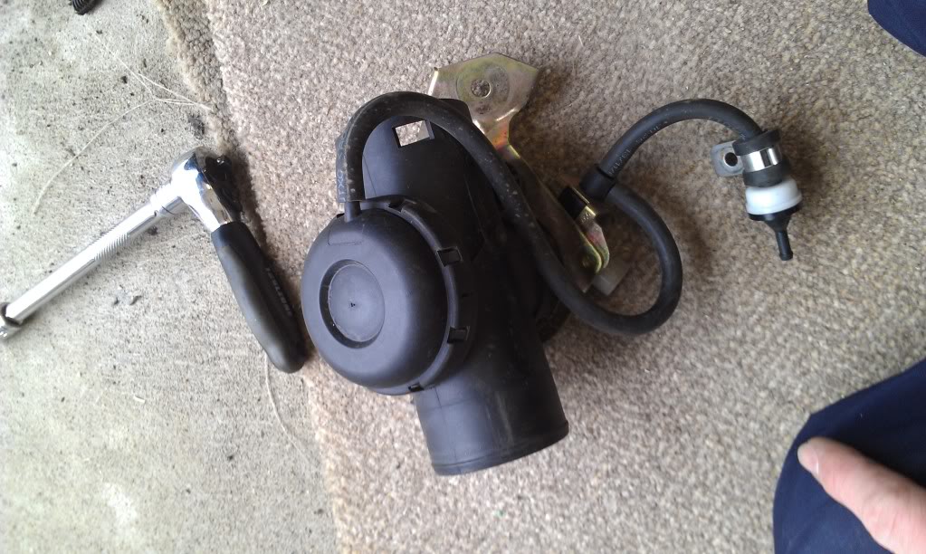

So today I was beginning to get bored of the whole laying in bed doing nothing cycle that I had gotten myself into, and with no parts to add to the car I decided to take some off!
After reading through here about an air resonator in the intake system which decreased the noise of the airbox I decided to remove it!
Fairly simple job, hardly worth the pictures...Just a matter of removing a hose and cable from the unit and undoing a bolt as well as plugging a hole!
And the unit itself-
Whether or not the removal of this will have any affect on the car remains to be seen, but if it is limiting the air going to the box, it cannot be doing any favours!

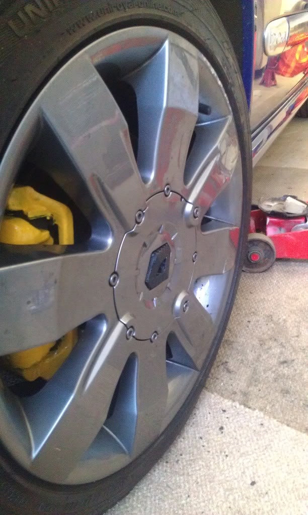

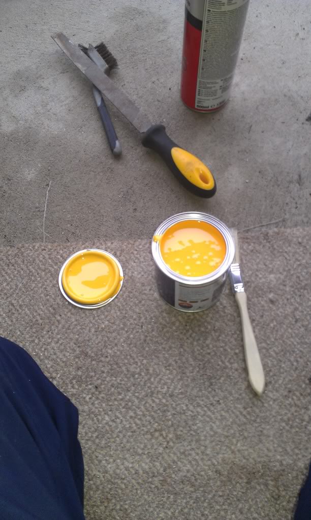

Also, a while back a bought some yellow Hammerite with the intention of doing my calipers as soon as, which turned out to be several months later :p
Before:
Lovely shade of yellow!
Doesn't look half bad behind the wheel!
After:
The keen eyes out there will notice that I have had a little play and wrapped the Renault diamonds on the wheel caps!

Looks good mate, glad you're back on your feet now, I know what its like!
Just a heads up though, someone else painted their calipers with yellow Hammerite, and after some heavy braking the paint actually burnt/melted and bubbled off! You're better off getting some proper caliper paint
Jon
  Arctic Blue 182FF
Jon
Worst feeling ever right?!
Ahhh man! Read some reviews on the yellow caliper paint from halfords and apparently its awful! nevermind!

So earlier this week I FINALLY got my Green Cotton replacement air filter and Powerflex lower dogbone mount kit in the post.. If anyone wants to order from kamracing... don't, they took over 2 weeks to get it sent out to me, and they didn't notify me that there was going to be a delay :mad:
So anyways, cracked on with the jobs!
Air filter comparison, in and out without trouble!
Then came the difficulties... got this off no trouble
and getting the mounts out was not much trouble either! But I went to fit it yesterday and it was just too tight! I gave up and had to leave the clio on axle stands over night :eek:
So today came and after a post in the correct area last night (very helpful!) I managed to figure out the problem.. basically I had hacksaw-ed the ridges of the old mount and taken out the rubber but forgotten to knock out the ring in the middle! So again I got the hacksaw out and cut a tiny slot so I could hit the bugger with a screwdriver to get it out! Job done!
Sorry there isn't many pictures, but after the trouble and stress I had last night I just wanted it done!
Last night whilst reading through about the Powerflex mount I read alot of criticism about it... so for any of those following this that are considering this mount here is my review - before I had a lot of gear knob movement and now I have very little. Peoples main criticism was that the mount would cause the car to shake.. I had a similar mount on my 106 and its exactly the same on this, there is very very little vibrations, and they can only be felt on idle, and through the steering wheel. Overall its well worth changing!

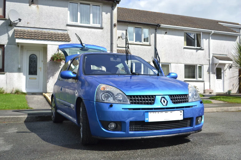

SPRING CLEAN!
So with the good weather finally here (sort of :rasp:) I decided it was as good a time as any to crack on and finally remove the salty, muddy grime that had built up on the 182!
Heres a couple pictures to highlight the state of the car!

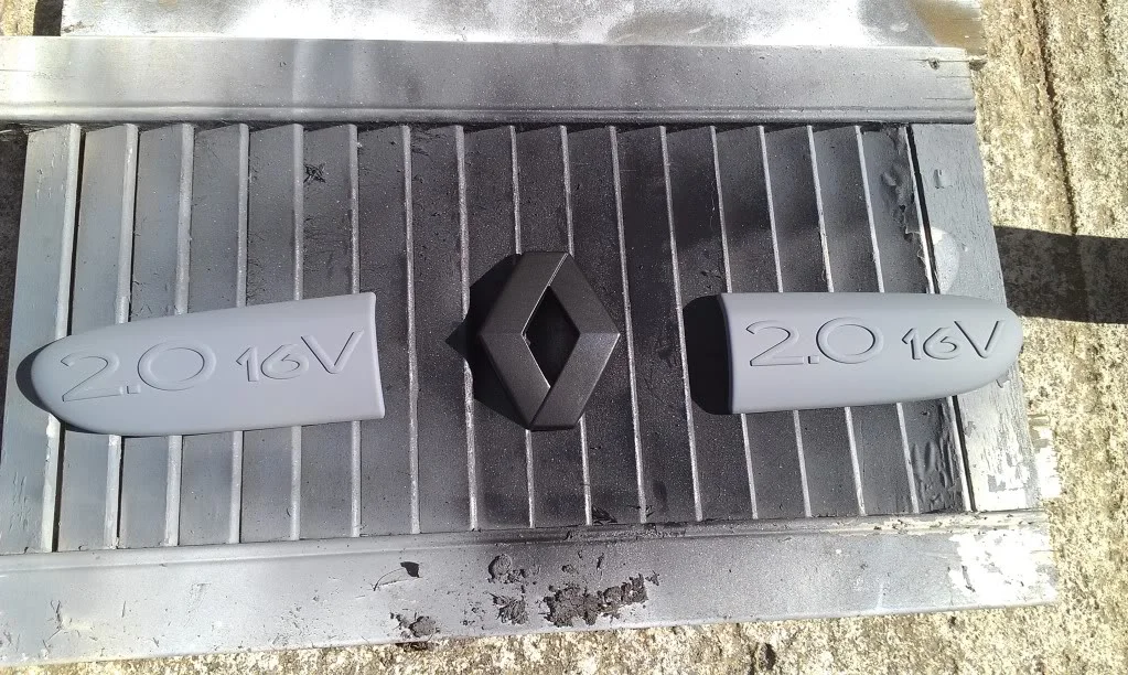

Before I had even got started with the cleaning, I finally decided that the diamonds and bullets needed a little freshen up! I am not really a fan of the chrome, and the bullets being a complete different shade to the wheels and the chrome badges didn't make sense to me.
So after a trip to halfords, I decided that Ford Graphite Grey was a nice shade and picked a can out to try!
Primer baking:
Comparison of paint to primer:

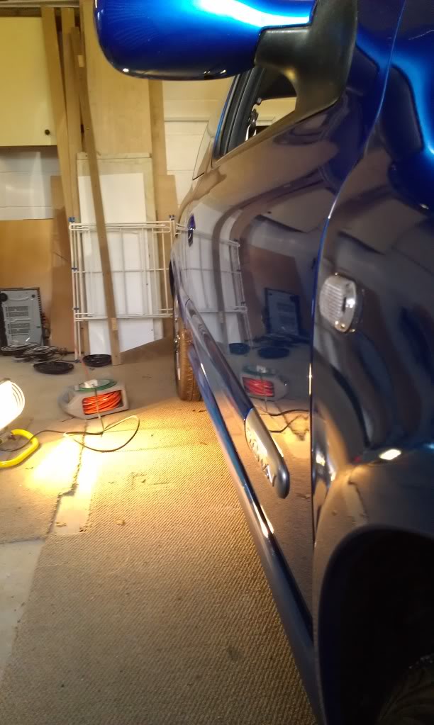

So in between hoovering, and washing etc... I was either prepping, "priming", painting and lacquering the pieces in order for them to dry whilst it was still sunny and mildly warm :rasp:
Recently, whilst fixing my exhaust for the fifteenth-millionth time, I had bent my jacking points back (never making the mistake again! :eek:) so another thing on the list for today was trying to make them look more acceptable! Using mole grips and a clamp I managed to get them looking straight-ish and I slapped some smooth hammerite on there for good measure! I was contemplating getting them done professionally, but considering the cost and how likely it is to happen again there was only one option ;)
So all in all the car ended up looking a little like this:
The last picture just shows that the upper grill needs to see some paint :S
Anyways, sorry for the amount of pictures! Comments and suggestions are welcome!
