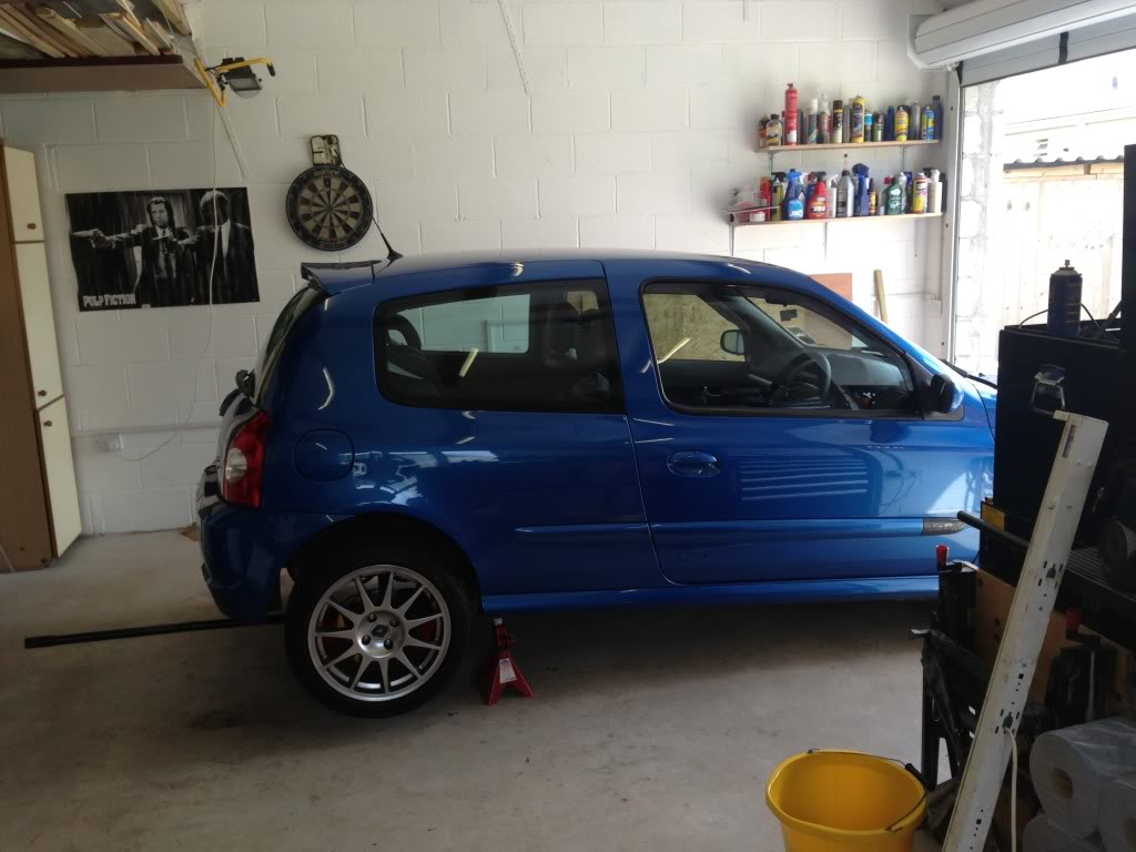

After receiving my Cooksports last week I thought it was about time I got cracking and fitted them!

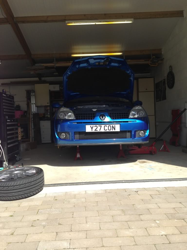

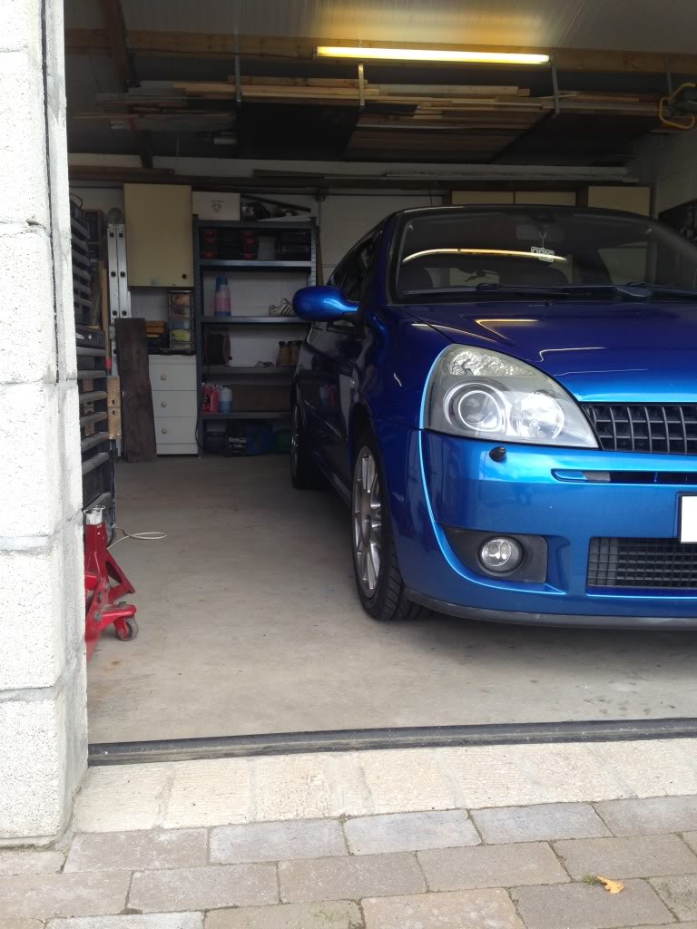

Off I went to the clio's natural habitat in my cousins garage, but anyways enough talk, heres the before pictures!

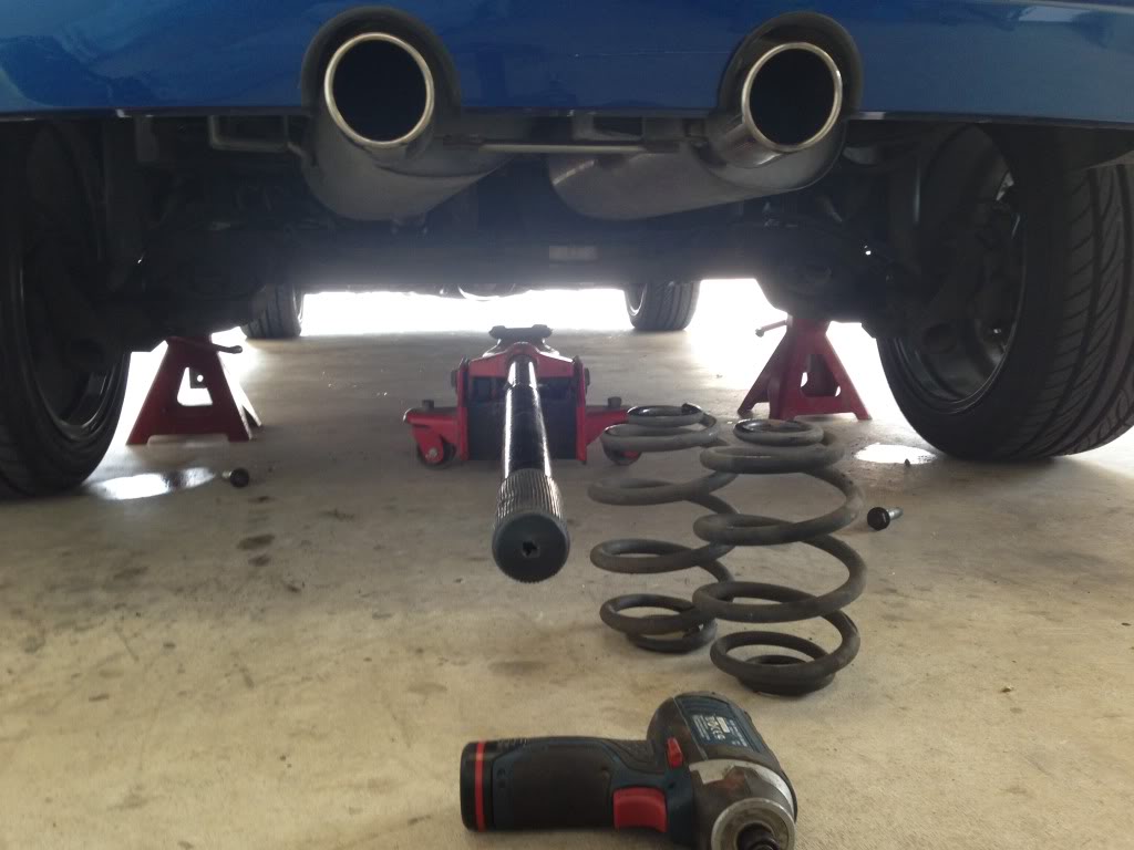

Then got the old girl up on stands..

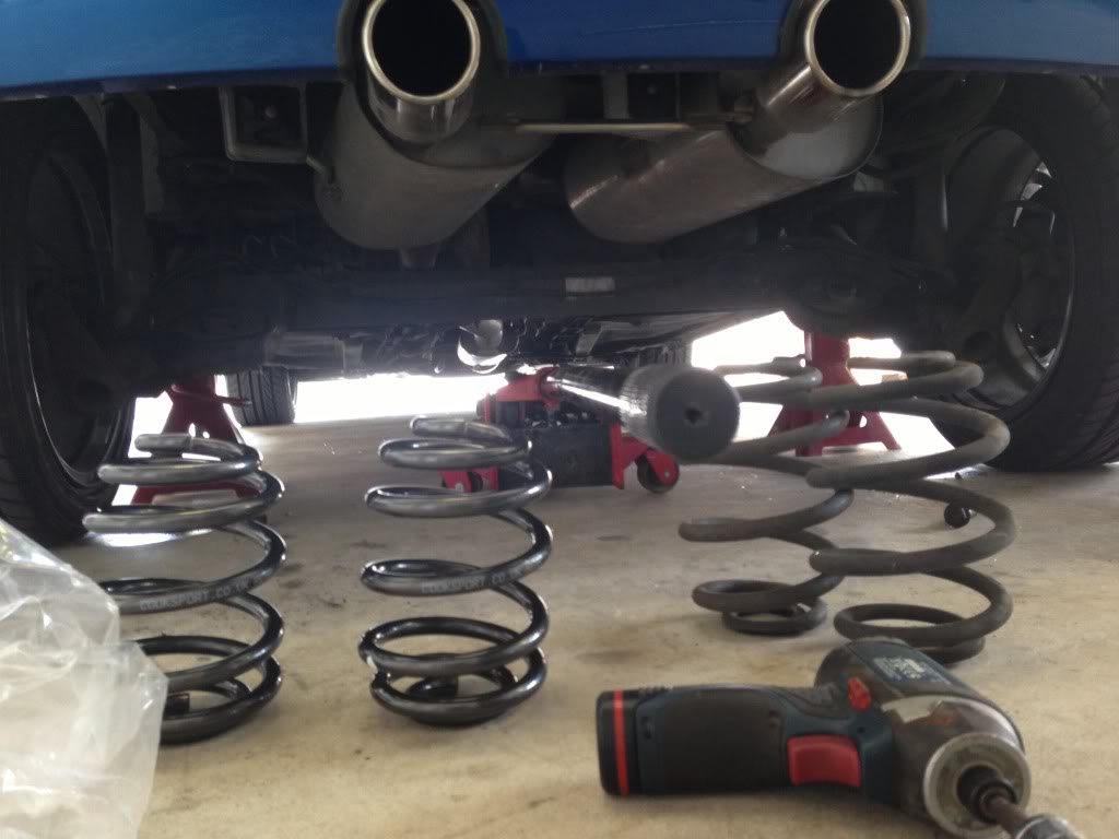

Out with the old...
In with the new...

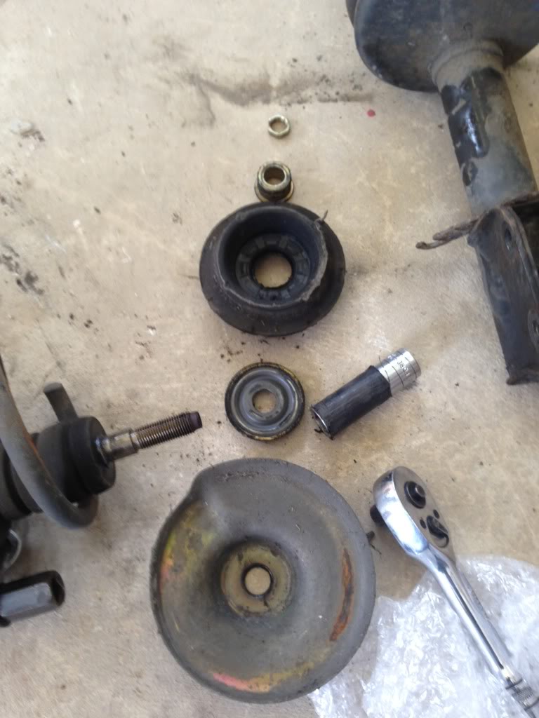

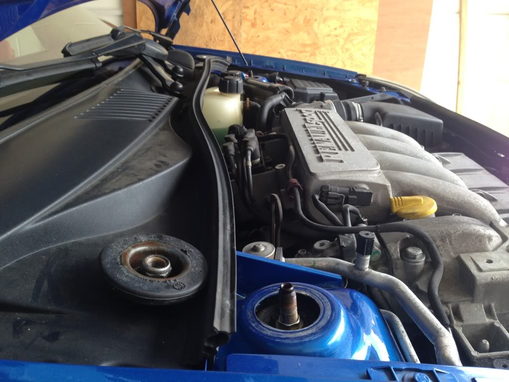

Top mounts off...
Up to this point I was completely confused as to how people could find a job like this hard, managed to get the rear done in no time, and the drivers strut off no trouble... then I made the fatal mistake of thinking it was easy!

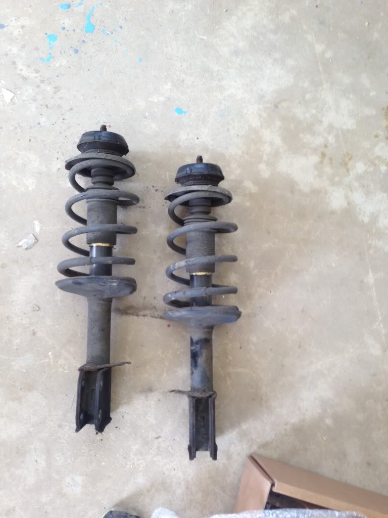

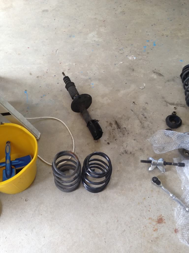

So anyways, here they are off the car;
Completely dissassembled;
New spring in comparison to the old one;

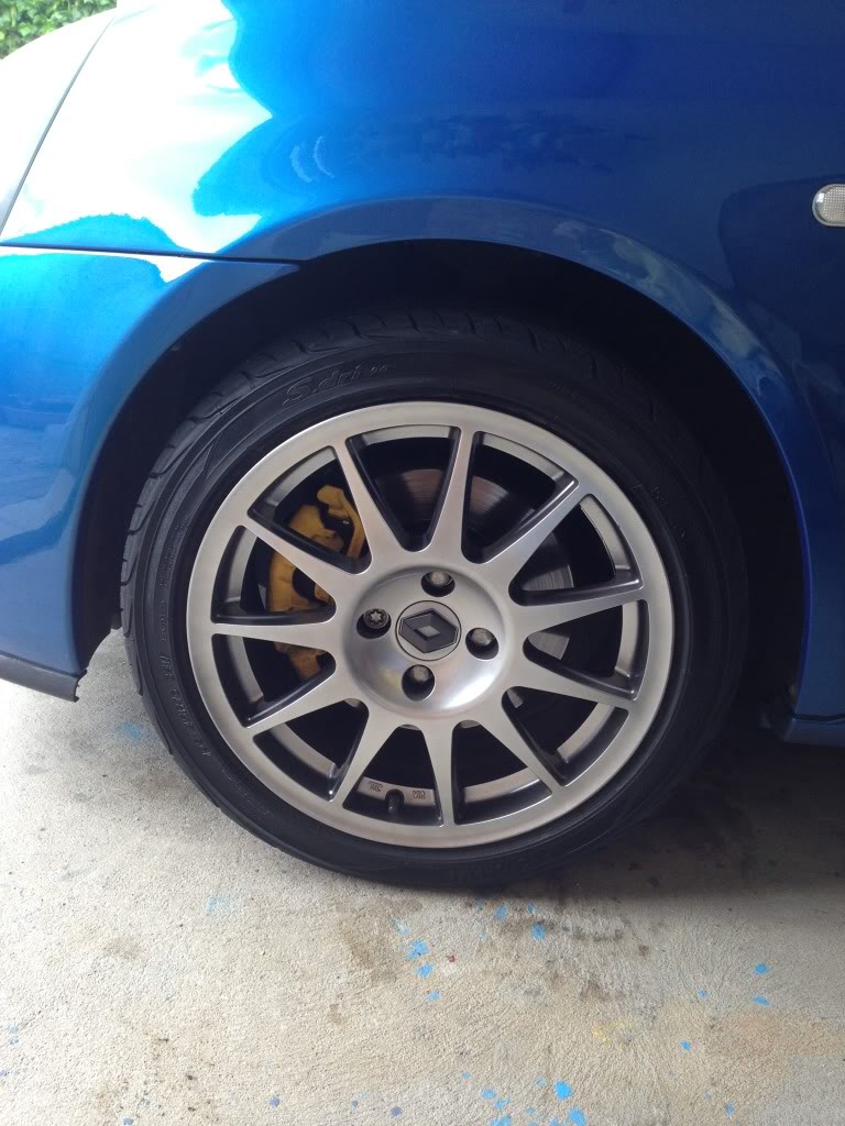

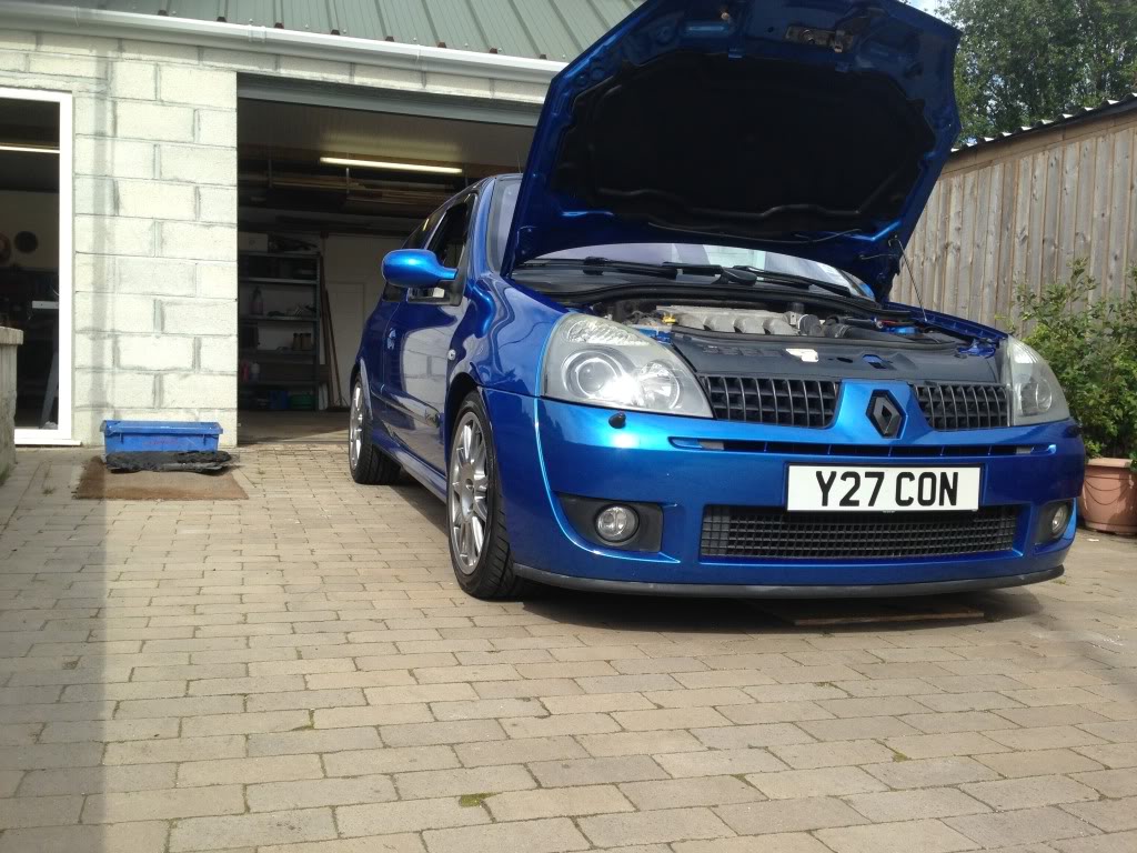

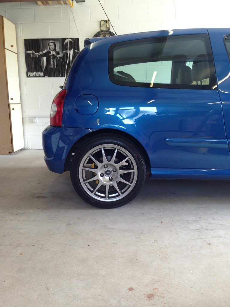

And the final product.

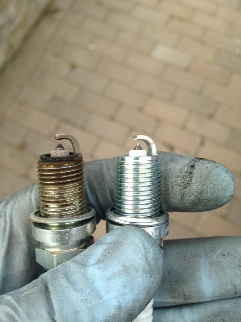

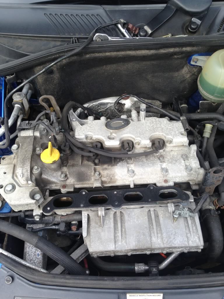

Also managed to find the time to change the spark plugs round!
Was a bit embarassed by the comparison

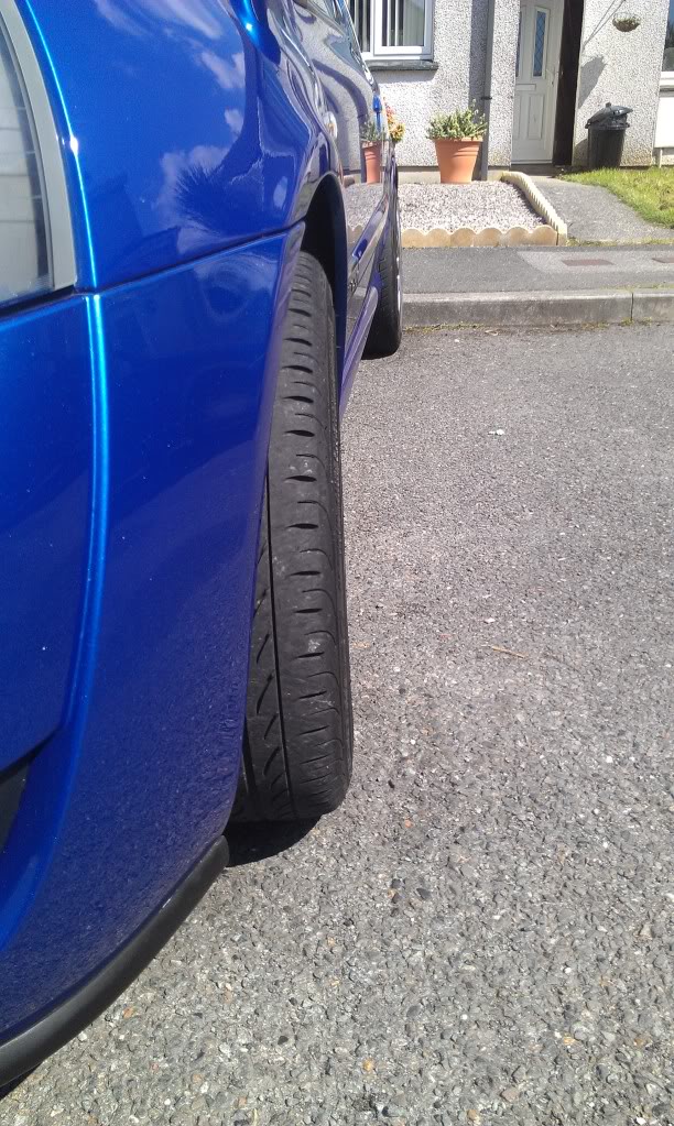

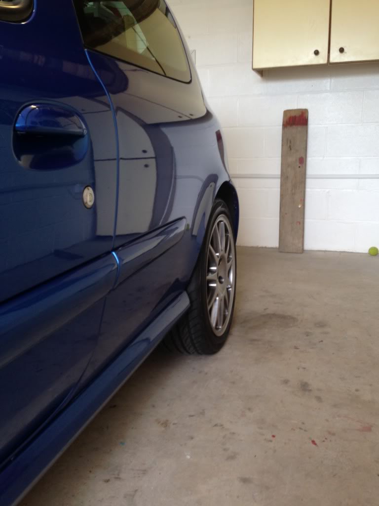

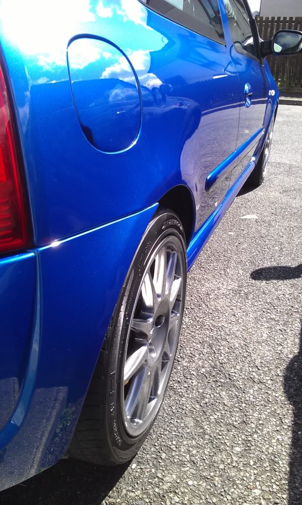

I have to compliment the Cooksport springs, they make the car look absolutely fantastic (yet to settle in of course), yet it I havent felt any substantial decrease in ride quality and I have yet to push it but the initial assessment is that they are fantastic!
