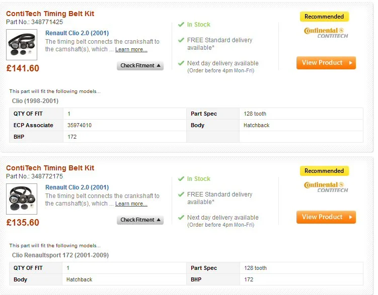

can anyone tell me please which of the timing belt kits in the picture should I use on my exclusive? when I asked them they said the one for models 2001-2009 but I not sure if it should be the 1998-2001 one? thanks

1998-2001 is phase 1

Both of those part numbers are vendor specific numbers. The actual Conti-Tech part number for the kit you want is CT977K1 between 2000 - 2001 and CT977K2 for vehicles 2001 onwards.
I've never fitted a K1 before so couldn't tell you the difference but I suspect it'll have the same belt, tensioner and idlers as the K2

Many thanks.. I've ordered now so lets hope it fits..lol
