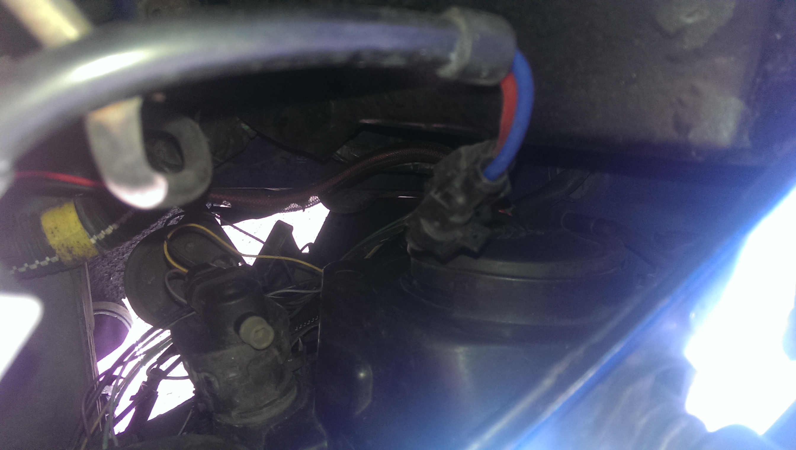

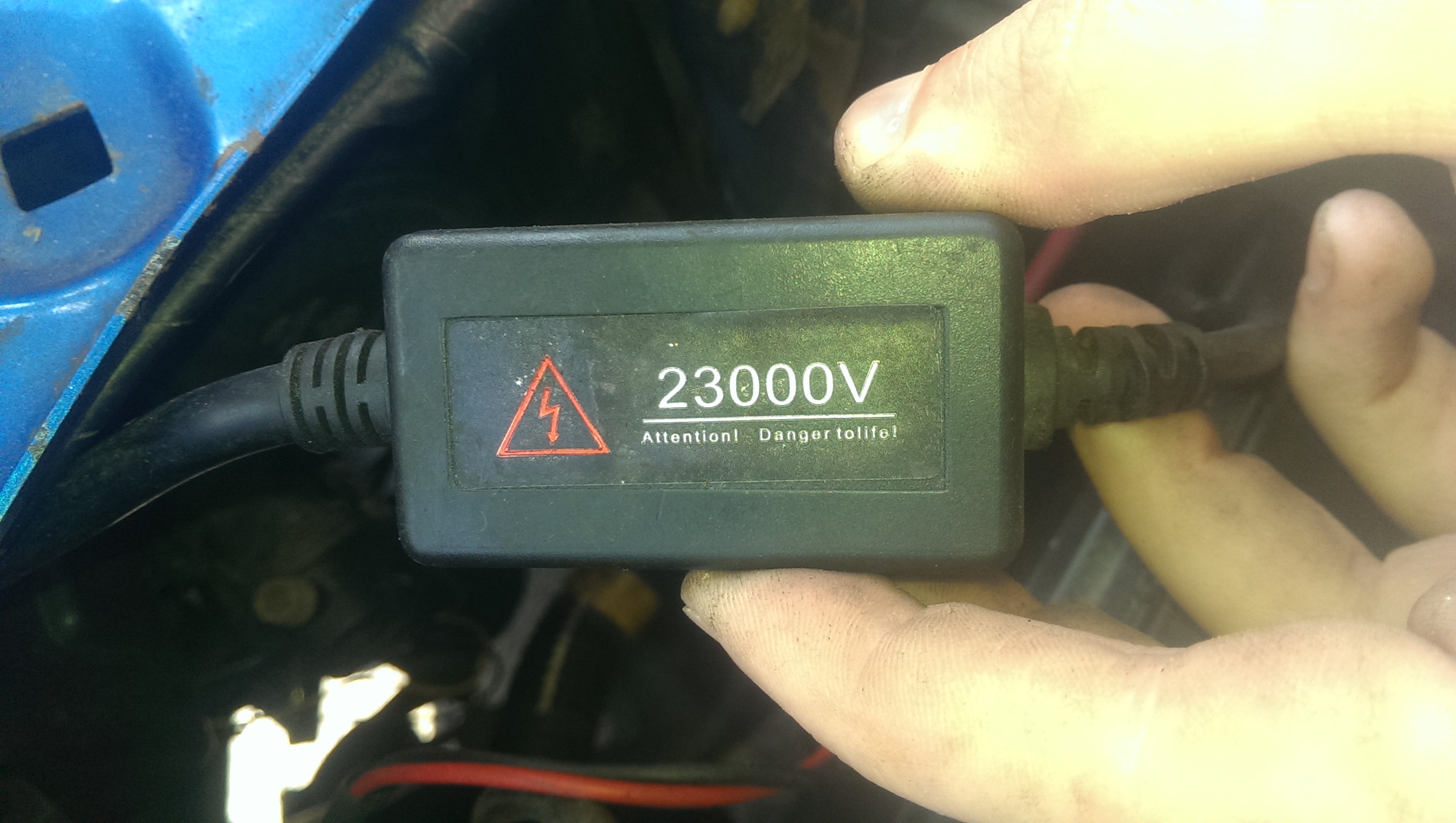

Bought my car back in February and one of the previous owners converted the headlights to use a different bulb/ballast than what is found originally (to my knowledge). Here are some pictures of what it looks like now:
Just a general overview behind the passenger side headlight, the bulbs have a wire tail coming off, unlike normal D2S bulbs which have a plug-in connection

The ballast pack itself. Note that there is absolutely no-where to mount them securely, this one is currently cable-tied to the battery support bar.

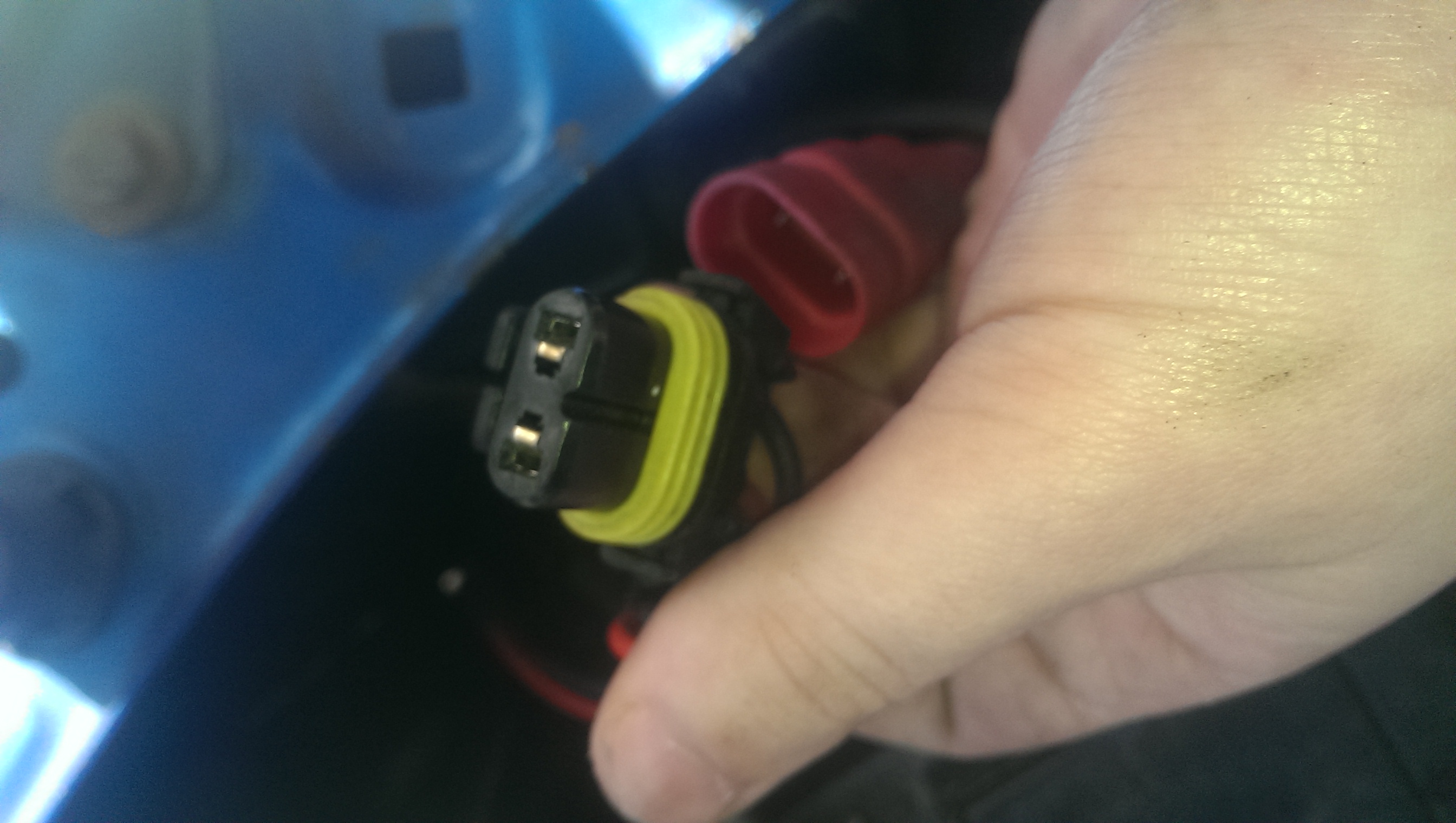

The connector itself
And the voltage regulator(?) which also comes off the ballast
On the drivers-side connector, it seems to be loose, as you have to jiggle it around a bit for the headlight to actually turn on.

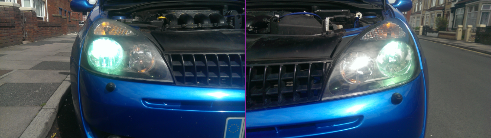

As far as I'm aware the actual headlight enclosure is untouched, however one of the previous owners decided to completely seal off the headlight (as far as I know the front clear plastic is supposed to be able to separate from the rest, which this can't) probably due to moisture getting into the headlight which when I bought it, was the case, but the moisture in the headlight was cleared for the most part by me. THis is both of the headlights on (the headlights are NOT green/blue in anyway, it's just how it came out in the picture, plus I also seem to have taken the pictures at different heights, so one looks dimmer than the other, this isn't the case either.)
WHen driving at night (which I rarely do anyway) the highlights compared to each other seem very out of level. As far as I know (this could be wrong) headlights are a little asymmetrical anyway, but this is extreme.

that is an aftermarket hid kit mate, your headlights aren't made for hids (oem had projector units)
best bet would be to follow the cables to if they were spliced in somewhere , or just used a converter plug (if you're lucky)

Headlight alignment is massively out either because the servo is disengaged from the linkage, the servo arm has fallen out completely, or the linkage has shattered inside the headlight. If you're lucky it's just really badly adjusted but a lot of the time it's one of the above.

Ah, I see how the enclosure is different now after a quick google. I'll try following it back, but the lack of space behind them really isn't helping

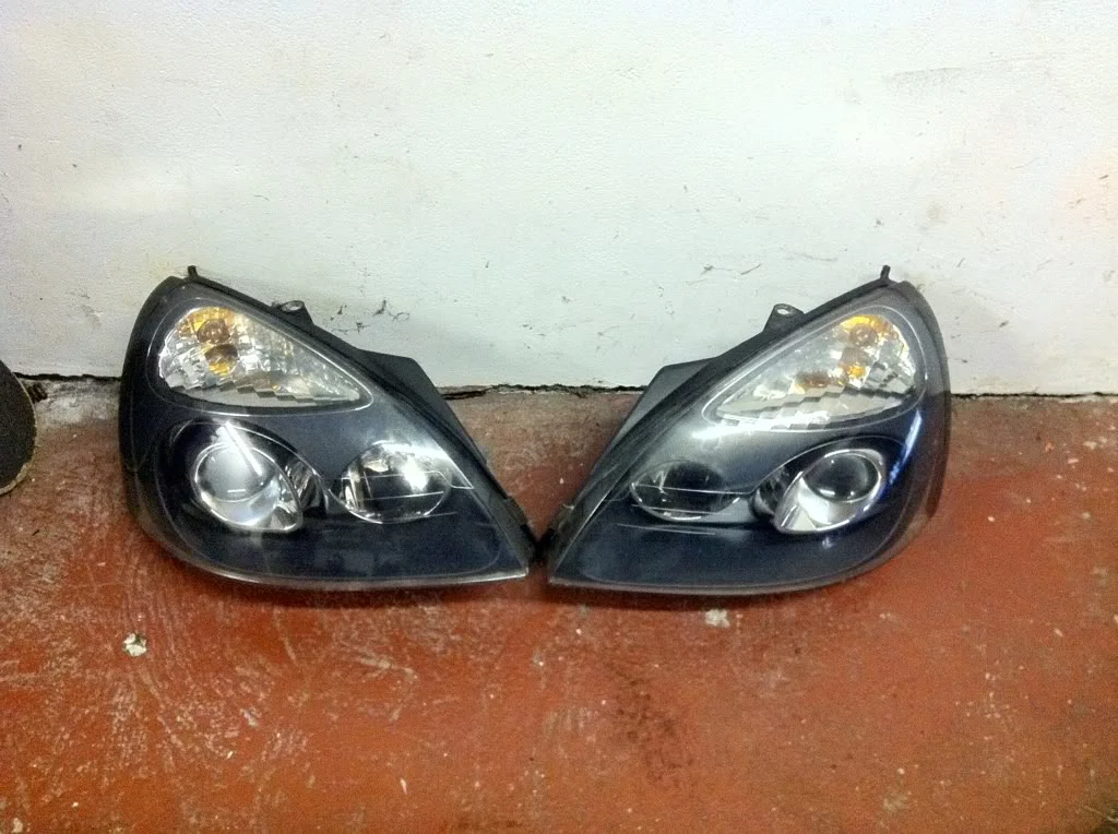

So its good to do a straight swap with the original headlight enclosure (with the different ballast too)? i.e ones like these (those are the projector ones previously mentioned, right?)

Yup, straight swap.
Don't get them posted though, the linkages in them, as previously mentioned, have a habit of shattering in the post.
