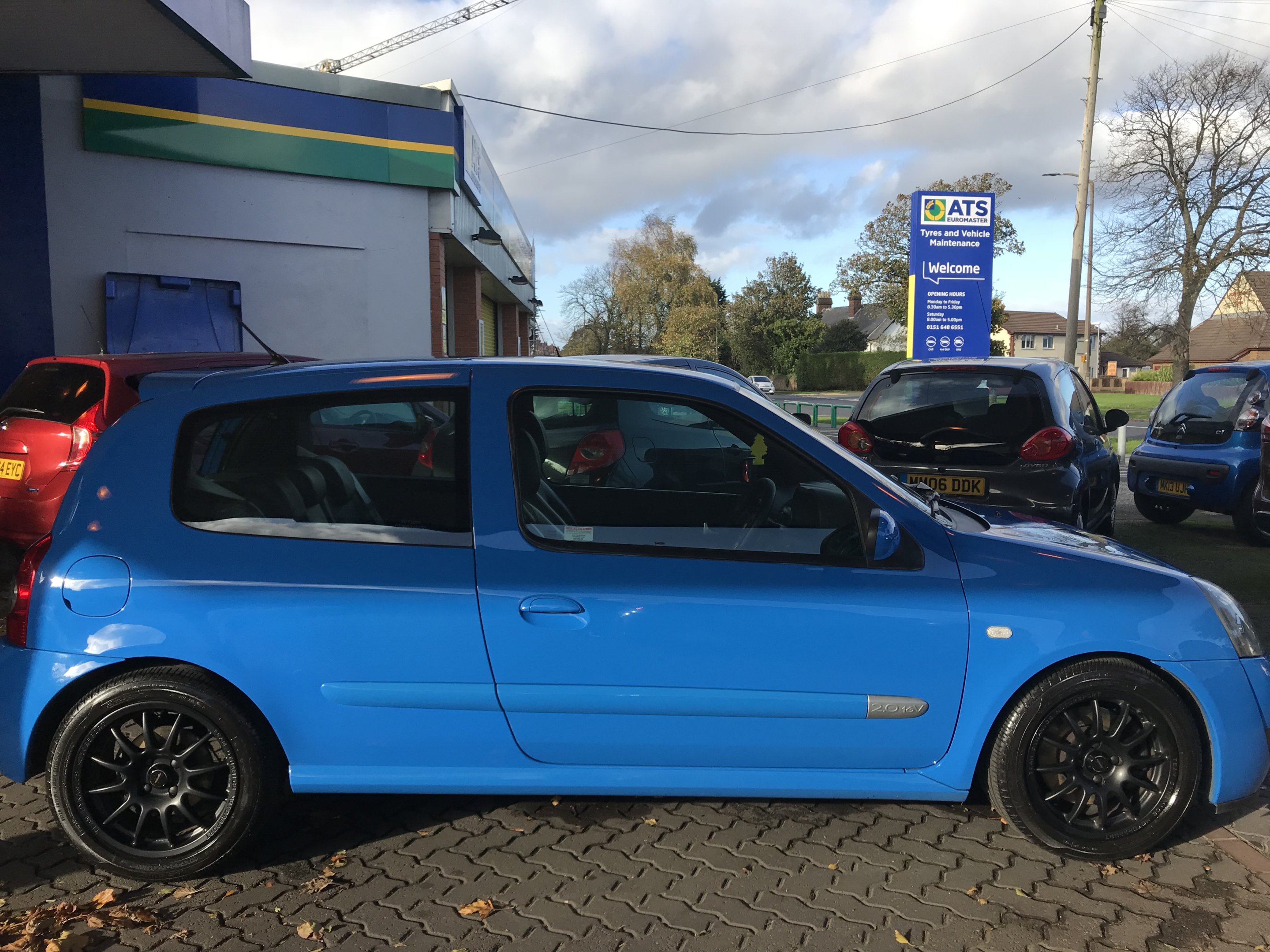

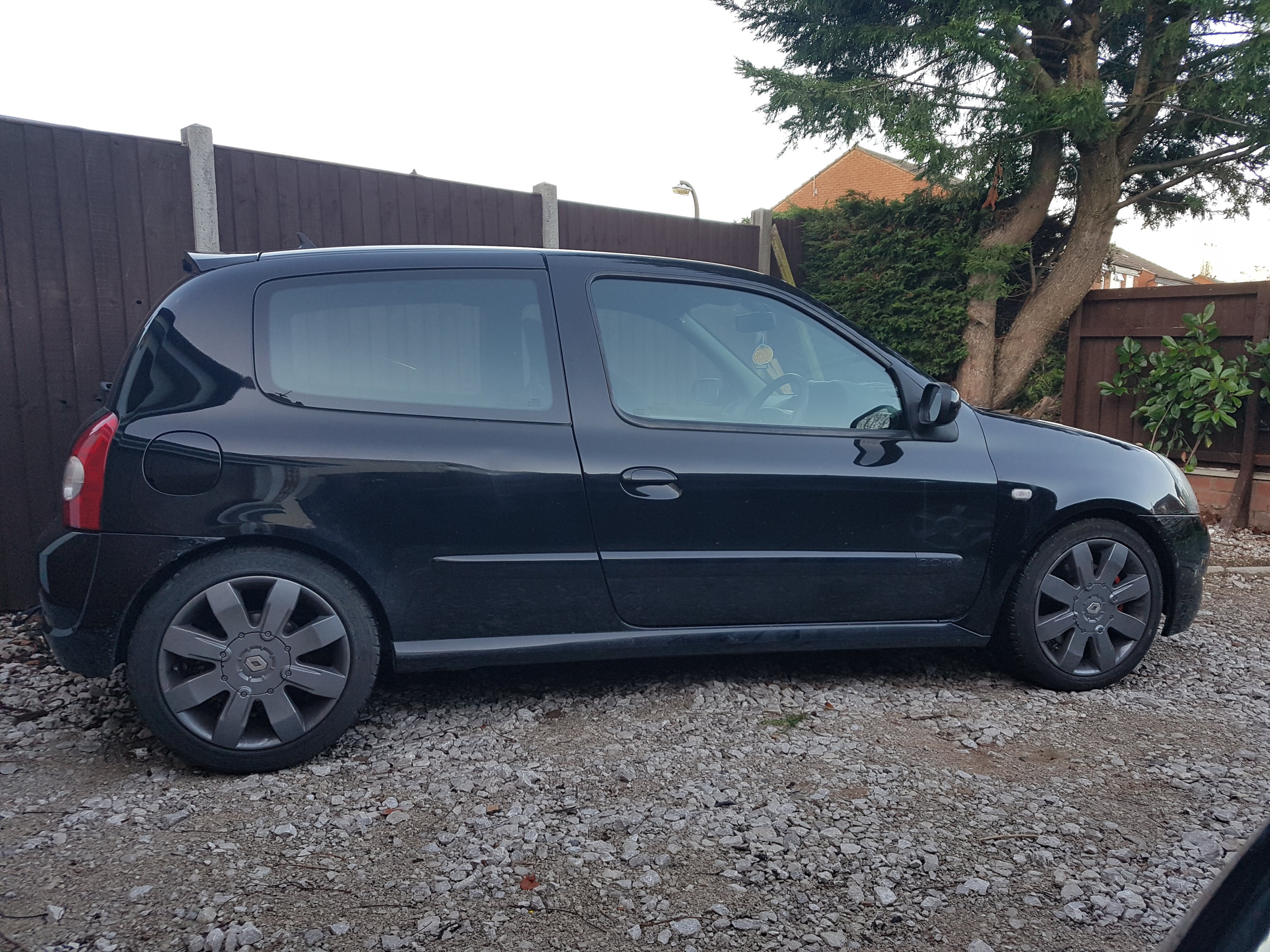

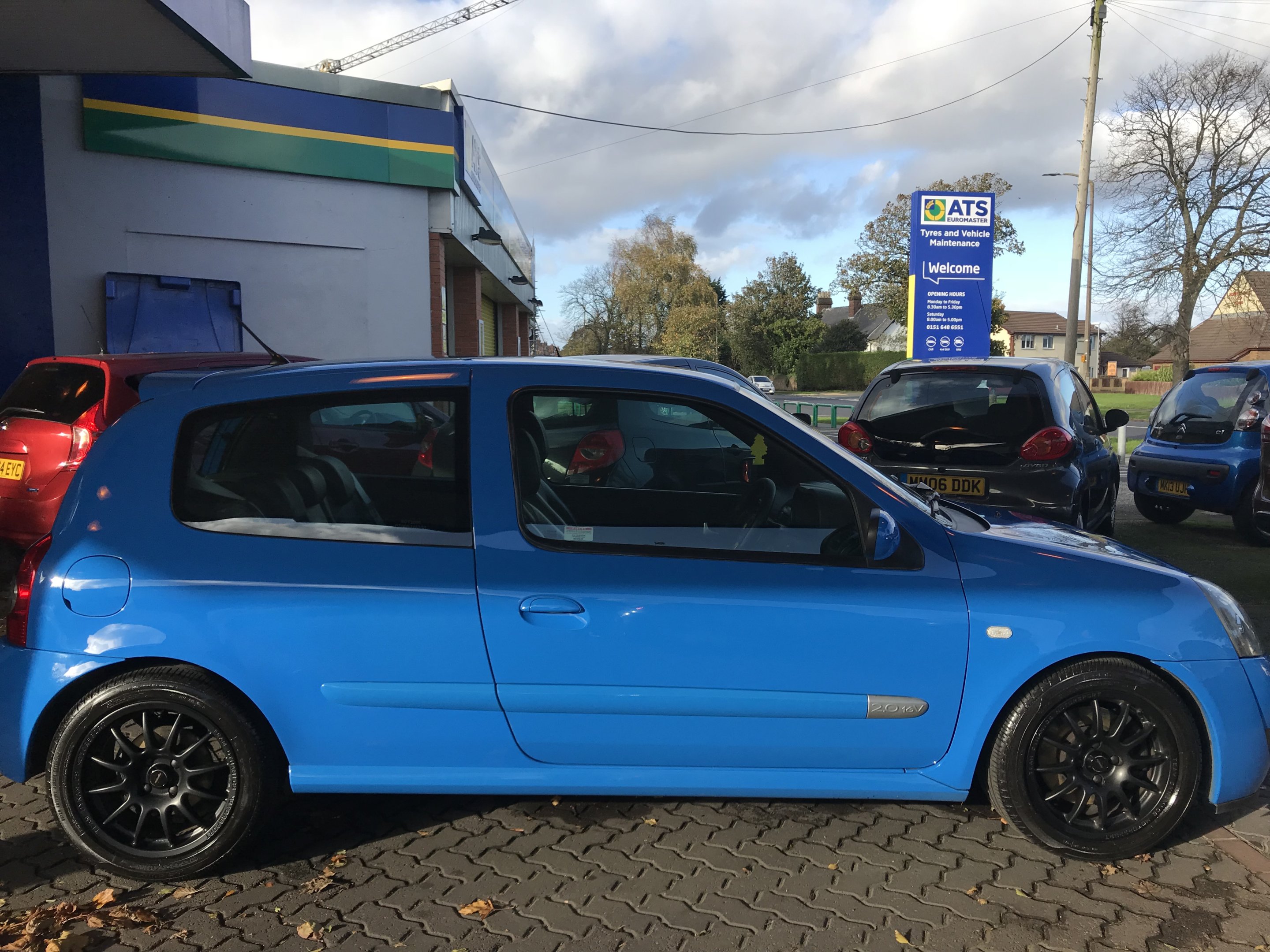

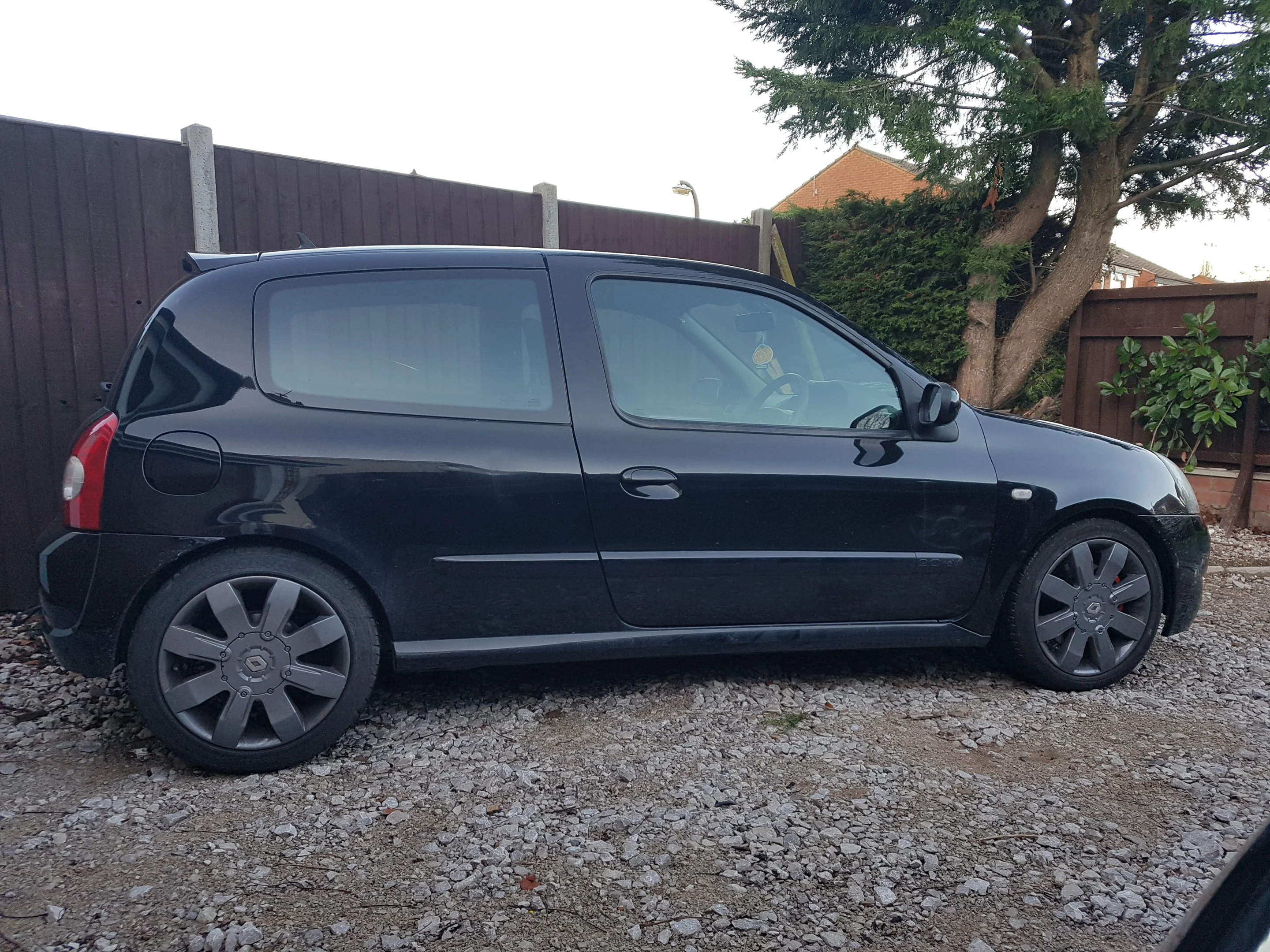

Any pics of the h&r ones? I'm umming and arring about whether to replace my KW coilovers at the minute.
Crap picture but gives you an idea
You're right, that is a crap picture ;) Nah, looks good.
@leeds2592 You'll miss the lows.
I'm just fed up constantly messing with the suspension. It looks spot on when it's parked up, wait until there's more than half a tank of fuel and me in it and it looks too low. My daily commute has also just got longer so would like a bit more comfort.
