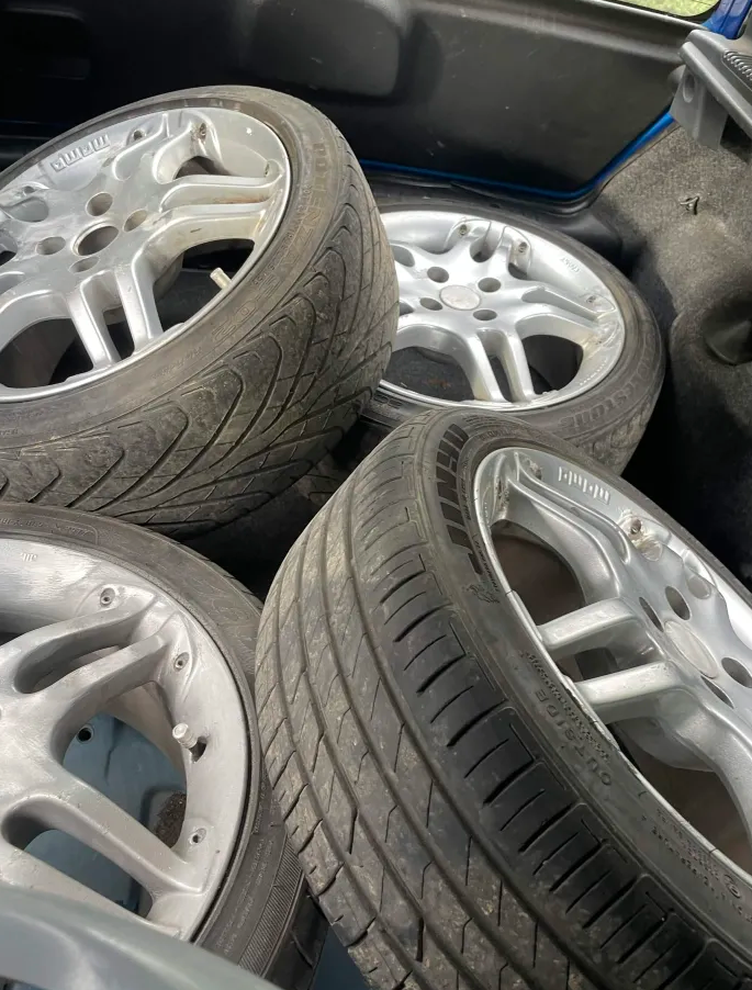

As a stopgap (and a bit of a test), I've chopped in the TSWs I've wanted rid of for a set of standard 182 alloys. These are temporary while I suss out fitment, clearance etc and trig up on a set of Enkeis from Torque GT. I've fitted a set of 195/45 Yokohama Advan V701s to them and feel like I've unlocked a tonne more potential out of the car now I'm not on Chinesium ditchfinders (who'd've thunk it??)

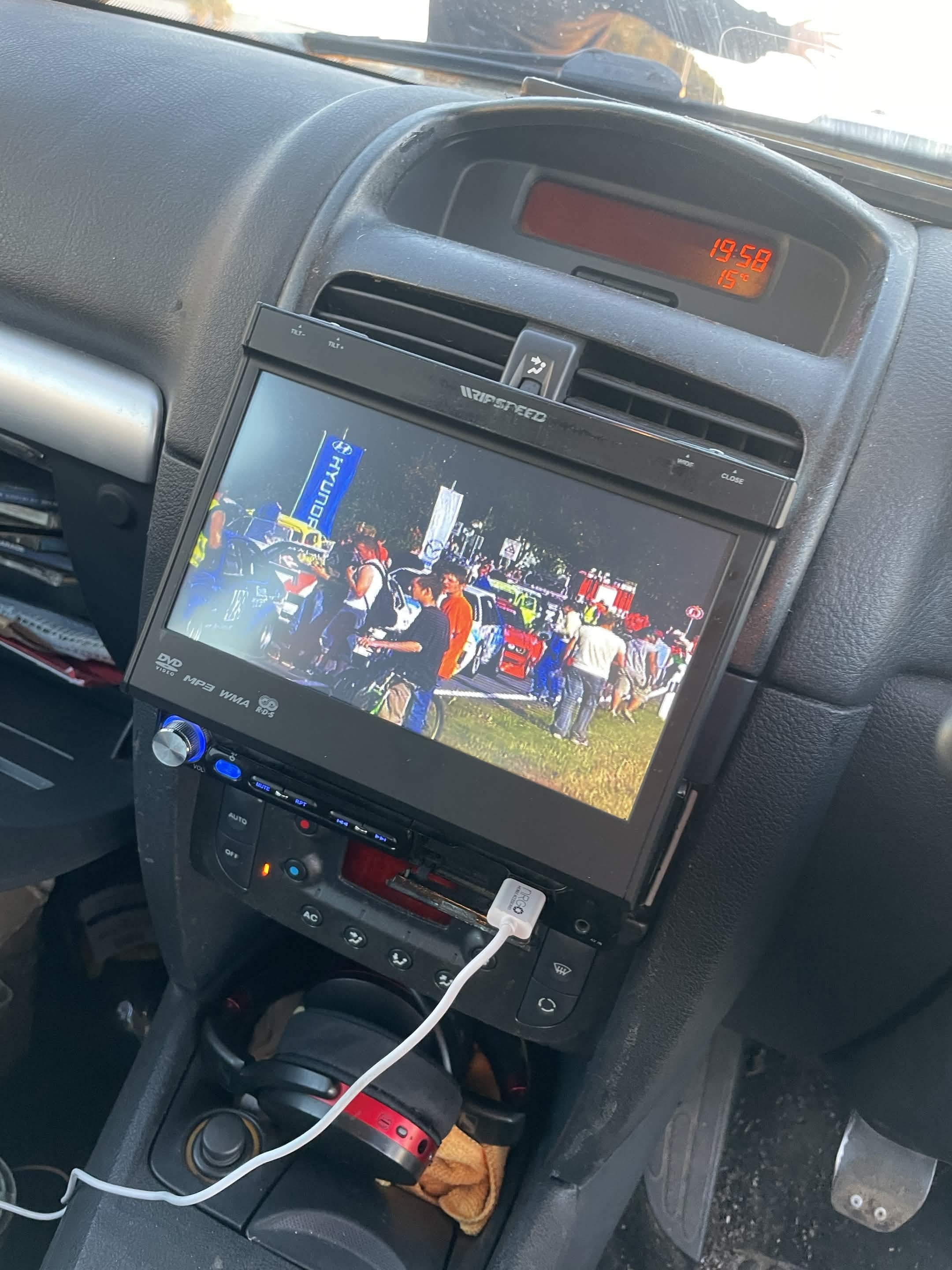

Furthermore, in the name of having a bit of fun, I managed to get my hands on a Ripspeed LCD flip-out headunit. Still need to sort a proper fascia panel out, but it's in, it works, and I can now pretend it's 2005 with my Pure Garage and Ministry of Sound CDs. It also plays DVDs, as pictured with a Berg Cup timeattack DVD that's almost as old as I am.

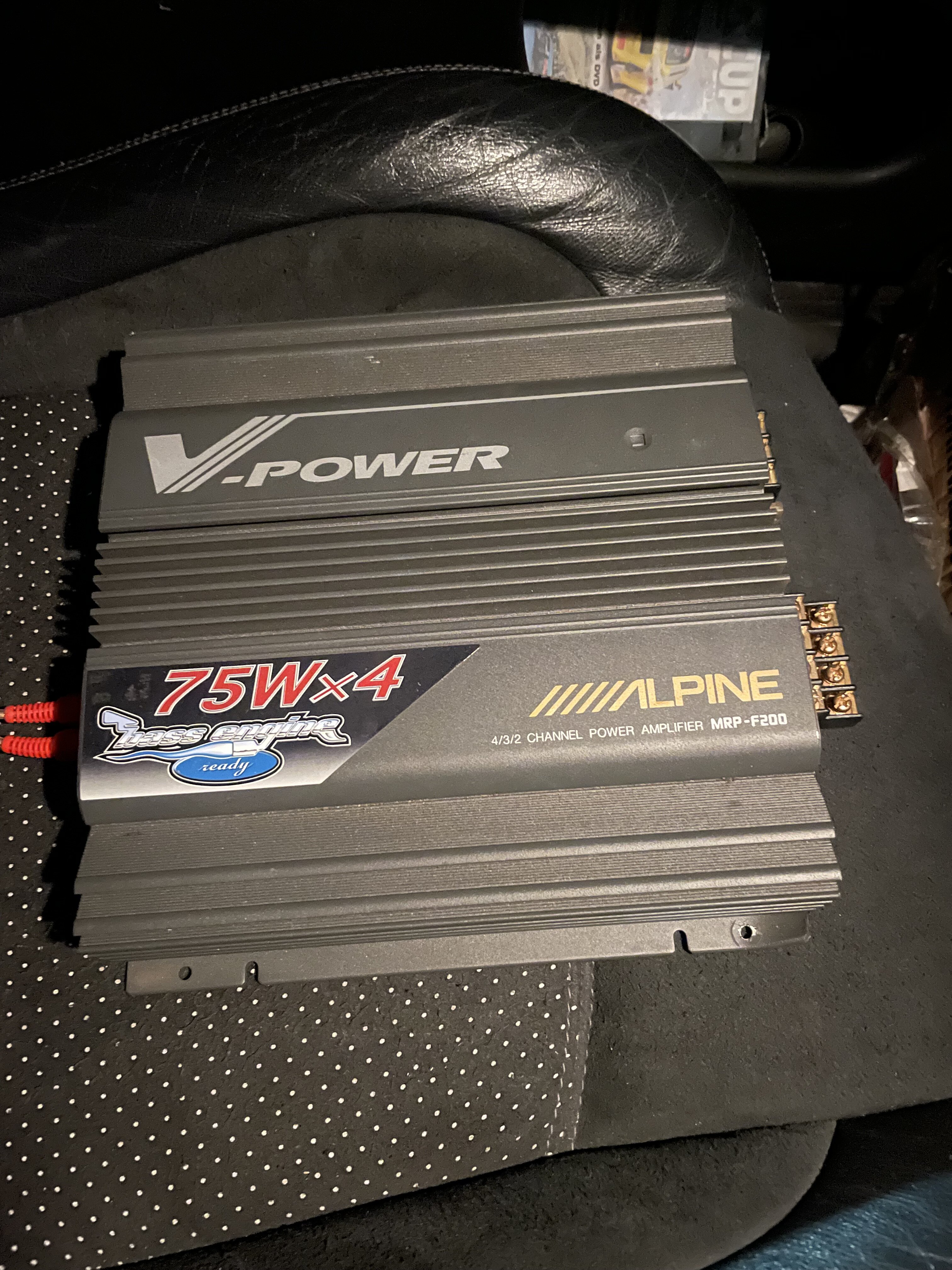

Alpine 4x-75w amp for the choons! Will be running the front speakers and tweeters off this to add to the ear ringing that the Milltek and absence of emissions equipment already gives me after five minutes.
Plan is this, a set of Alpine speakers up front and a pair of under-seat subwoofers, then call it a day with audio. 😁

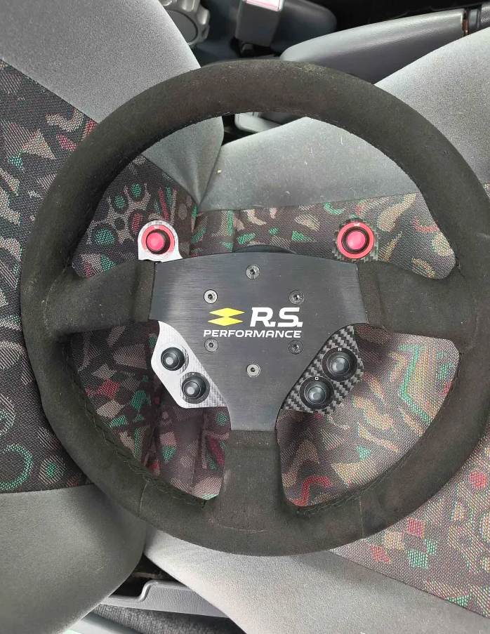

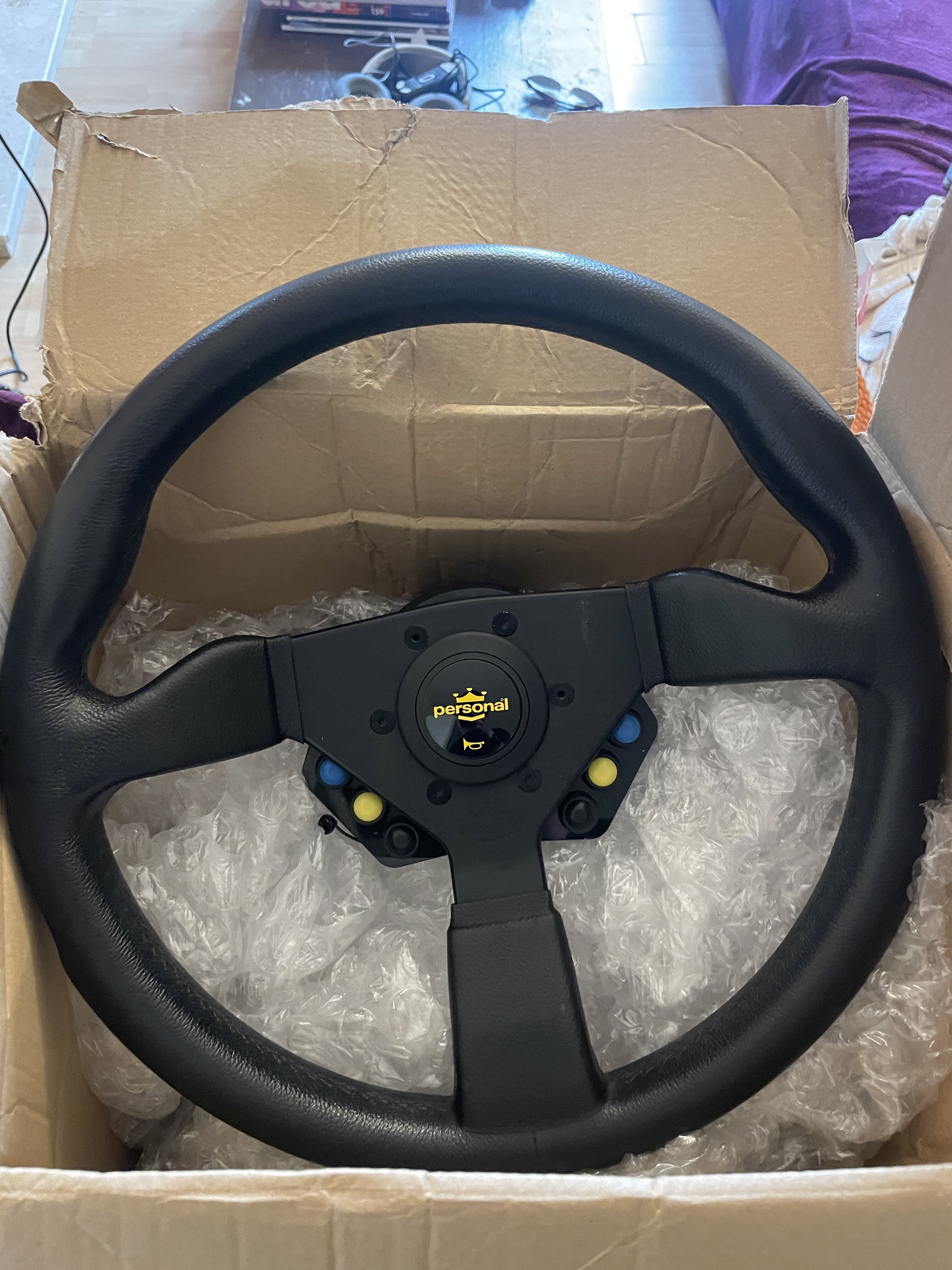

My buddy also hooked me up with this steering wheel, which we're going to look at wiring cruise control and the horn into while cleaning up.

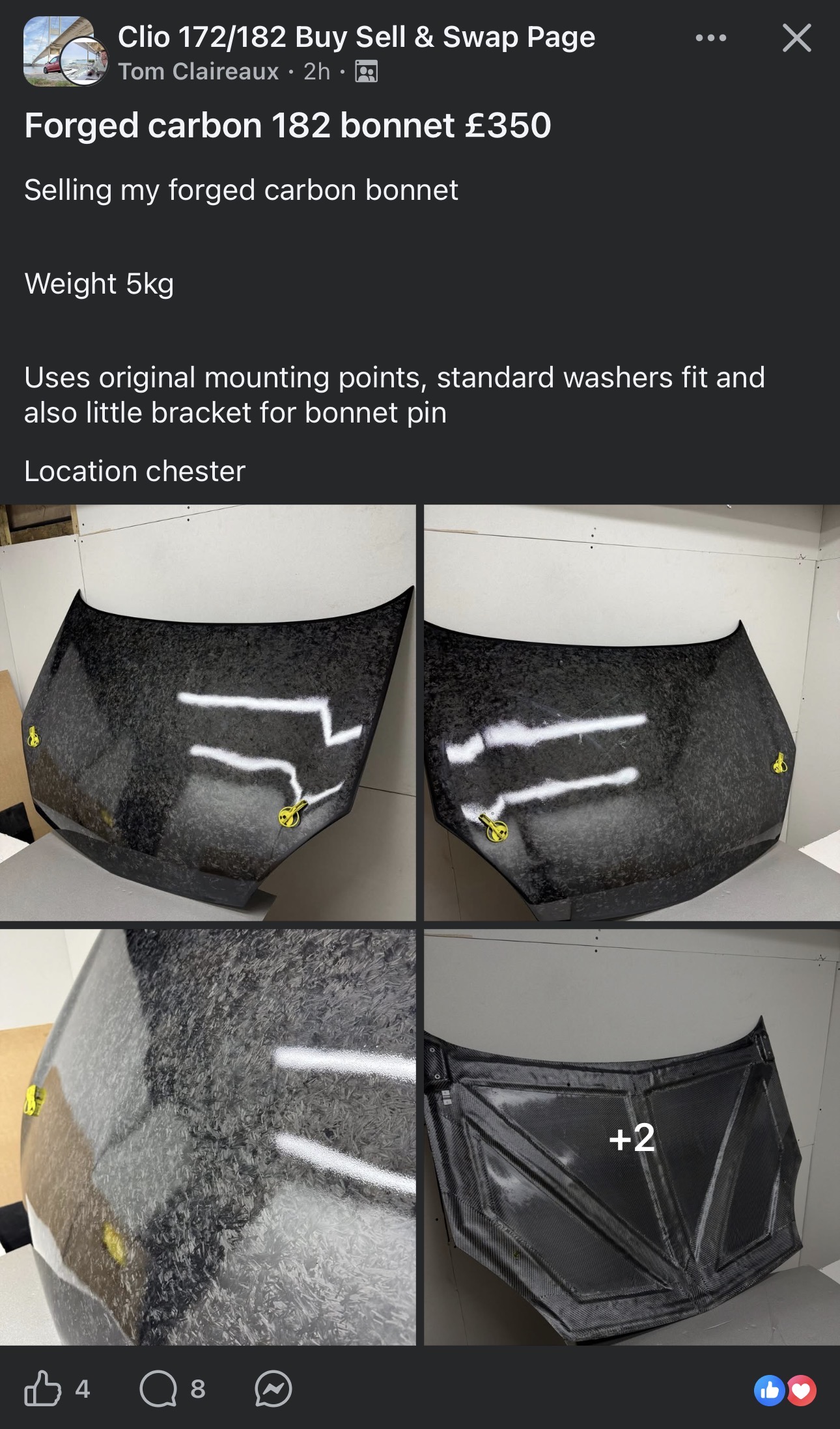

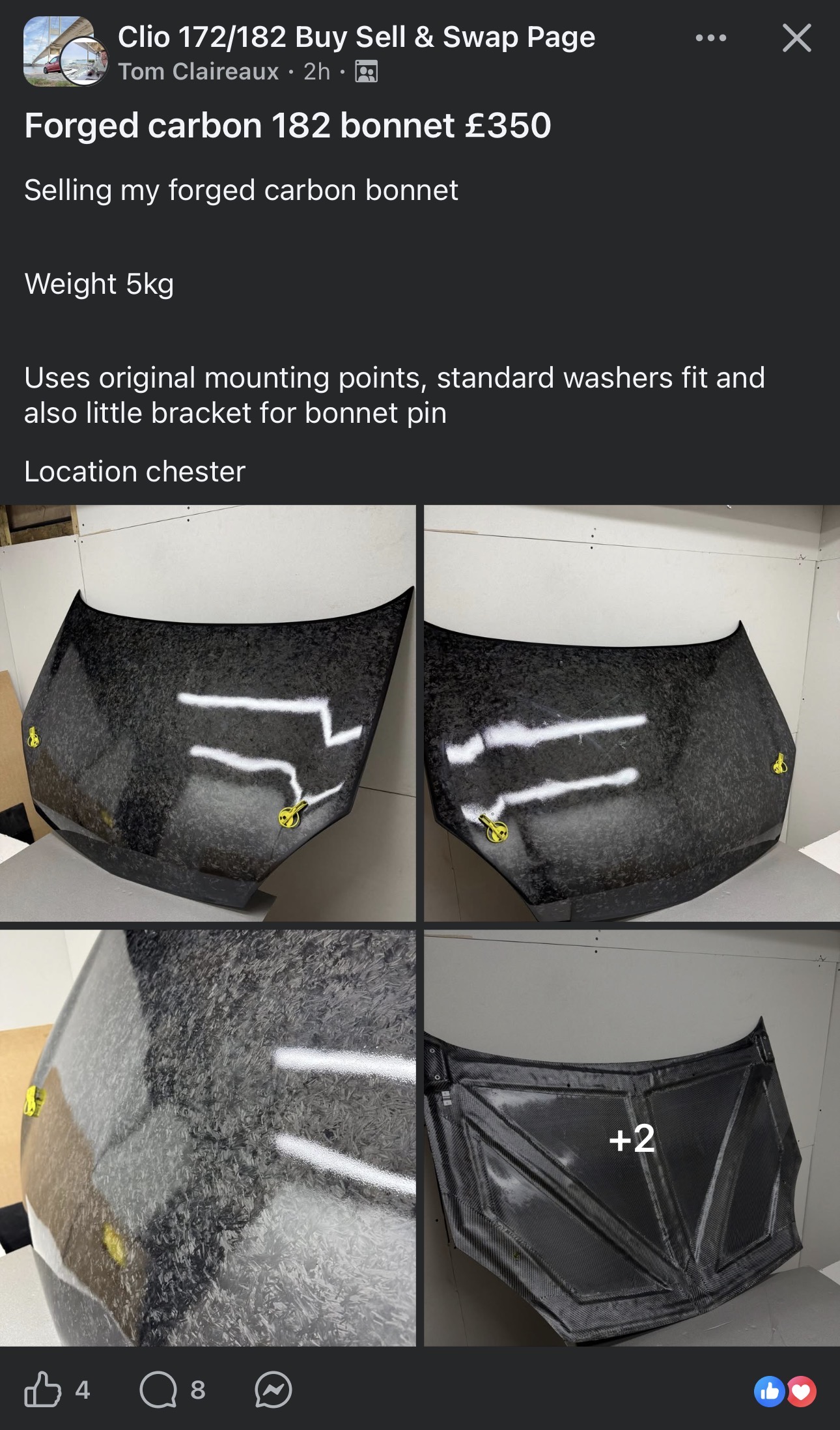

Ayyy that's cool! I'm still absolutely gutted I missed out on the vented bonnet up on Renomotive. It sold a day before I got paid 😭
Forged carbon is a bit noisy texture-wise where I'm aiming for a smoothed/euro look sadly. If another vented one pops up I'll absolutely have it though 😁
Tbh I f**king hate forged carbon. So I am glad you are turning it down.

Speaking of questionable taste, these are off for a refurb, refresh and new hardware.
I shall be continuing my Yokohama tyre addiction with ANOTHER set of Advan V701s, given these are my style/cruising wheels.
Shall still be cruising around on a resoundingly dented silver bonnet, buuut should at least have some sick shiny wheels come early June :)

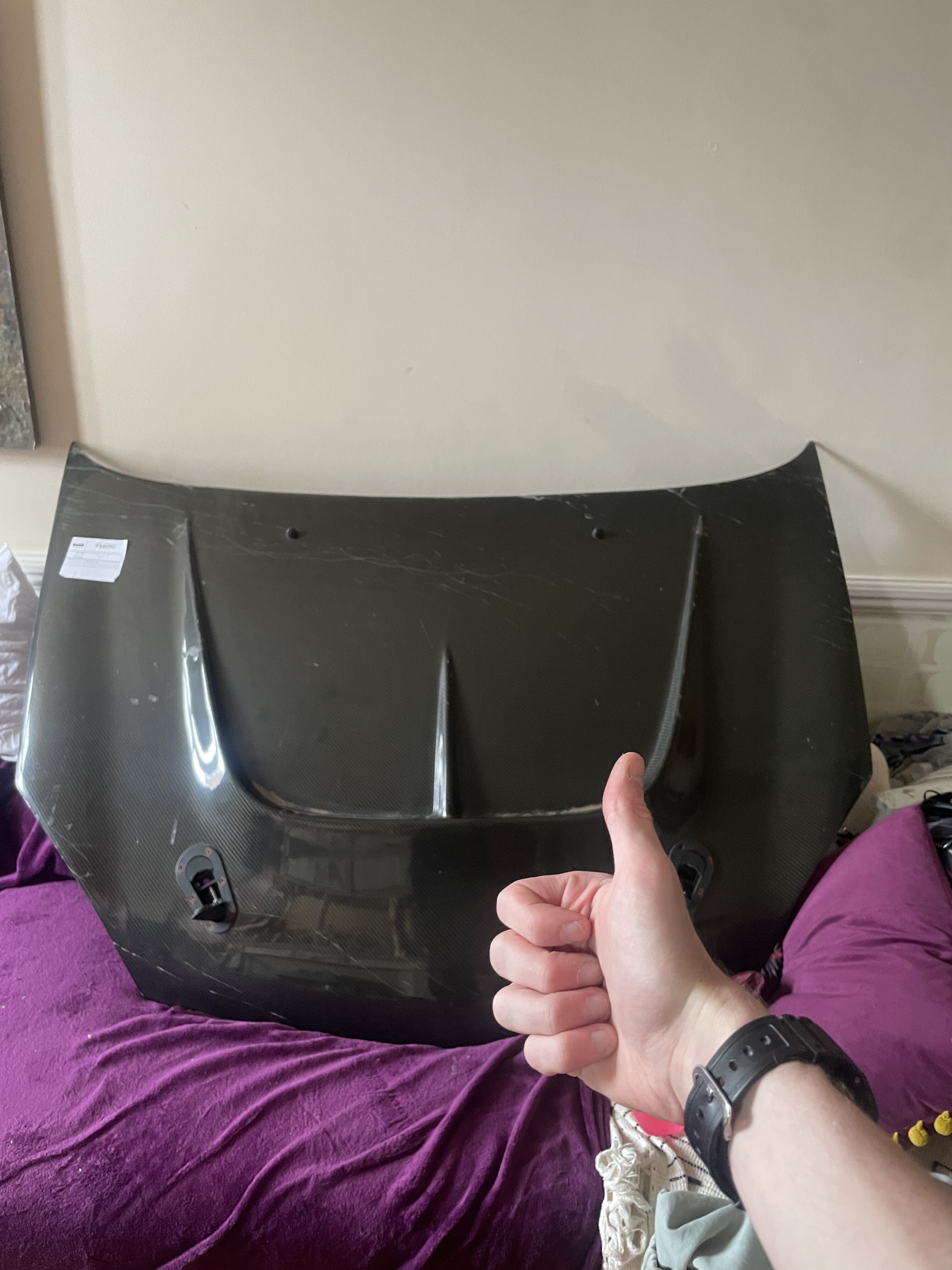

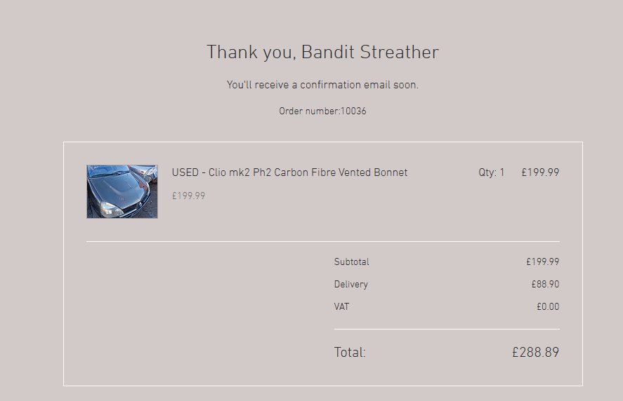

Carbon bonnet popped back up on Renomotive! Someone in Scotland will be cursing me for having to ship it all the way down to Bournemouth, buuuut it's mine now.
Will see to making some vent covers for when the car's sat, God bless having access to a laser scanner and 3D printer.
Just a small update, got the bonnet ready to go in for a re-lacquer with Empire Paint once it's in my hands. ETA Thursday.
Quite excited to have the giant silver bloodclart off my car and a fancy piece of carbon! Proper. :D
That's a really nice wheel.. if you're planning on using the personal horn push and it's a two wire one like mine was it will need some modification, it's really straightforward though, just need to remove the earth wire from the back of the horn push dismantle it, drill a small hole in the body so you can feed the wire through and attach it to the spring inside.
That's an absolutely wonderful bit of info to have. Really appreciate that dude, thank you! 😁
