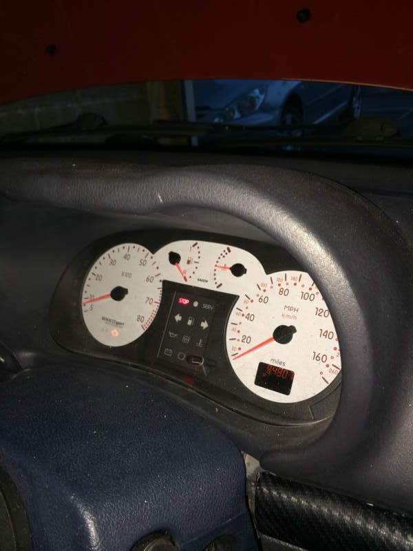

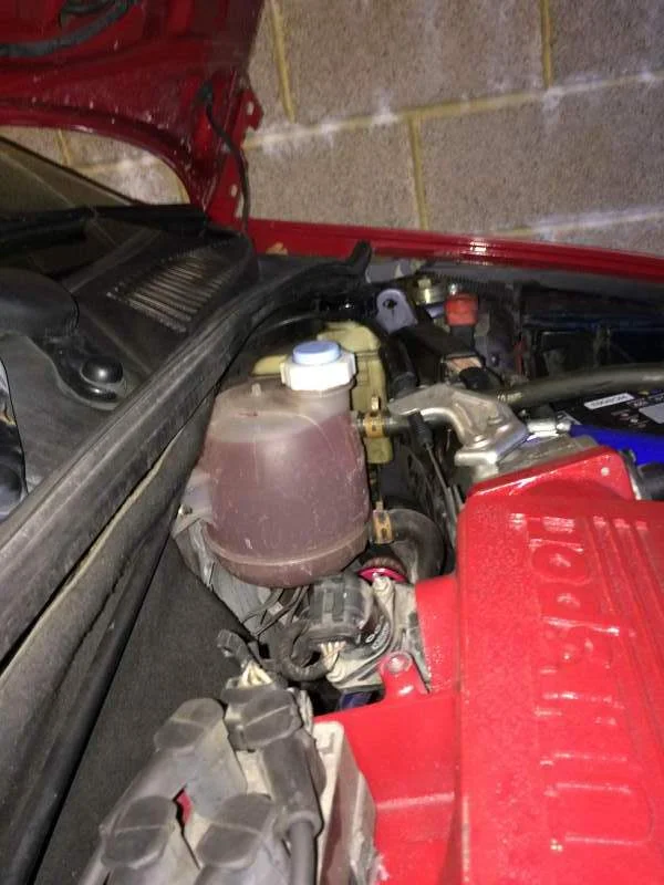

Right I'm having a bit of a mare with this.
I've done the above bleeding procedure, but the fan just will not kick in?
It never had a fan in the first place (don't ask, it had a smaller lower spec rad and no fan when I bought it) so I've replaced it with a 172 rad and fan, clipped in the 2 clips from the wiring loom (that was still in the engine bay thank god) to the fan, but it just is not kicking in to cool the car.
I waited for a good 50 minutes idling and all that happened was this:
Aaaand this:
At which point I thought I had better just turn the car off...
Any ideas?!
If it's any help or relevant, the car is a ph1 1.4 to 172 conversion carried out by KTEC years ago, in 2008 I believe.

Thermostat works (I think), the upper hose was cold until the car hit half temp and then the upper hose got hot.

The temp gauge never went above halfway, but the coolant just kept rising and rising in the bottle, what if when out and about it rose to the top? Would it burst the lid off/piss everywhere? Or not a likely scenario?

I waited for about 50 minutes and the fan just never kicked in, the temp got to halfway, the thermostat opened (the top rad hose went from cold to hot) but no fan came on. The coolant tank level just kept rising and rising ever so slowly until it got to the level in the above picture.
Are you saying I shouldn't have my coolant level at the MAX mark and that it should be sitting in between MAX and MIN?
And are you referring to the bleed screw on the thermostat housing? Because I've done that and it's just a stream of coolant coming out now, no air or bubbly coolant.
