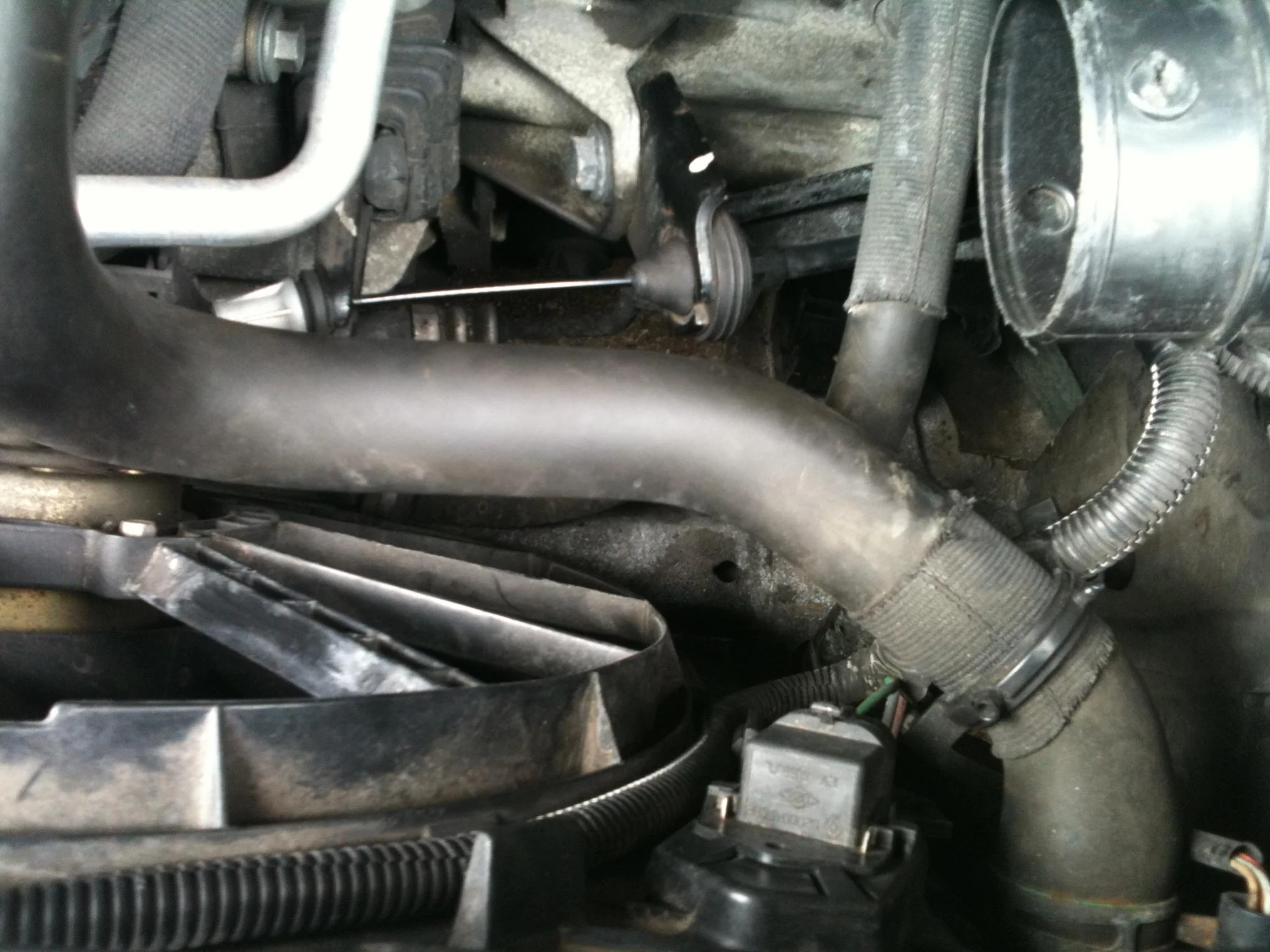

ive just took a pic of where the stains are. Its crazy though because i can sit on the drive with the engine running for ages staring into the engine bay and nothing leaks out. But as soon as i get back from a drive there as these splashed as seen in this picture on the bottom.

Are you saying the fan mounting has water marks on it? It's beginning to look like the rad leaking. Have you tried driving the car hard until it is really hot then stopping and quickly opening the bonnet to see leaks. Or disconnect the wiring to the rad sensor and leave it running, it will get hotter than normal then start to show up leaks.
nah, if you look in the centre of the picture you can see a splash mark on the bottom of the pannel. like directly below the big pipe.
yeh ive tried that and still see nothing lol untill about an hour after ive drove it.
Tricky one then, I would just wait until it becomes more obvious what is leaking. I can't suggest anything else.
yeh thats pretty much what mechanic next door said because its going to be hard to find it properly without stripping the front of the car and having a look at the rad.
