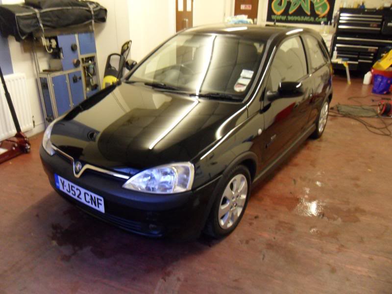

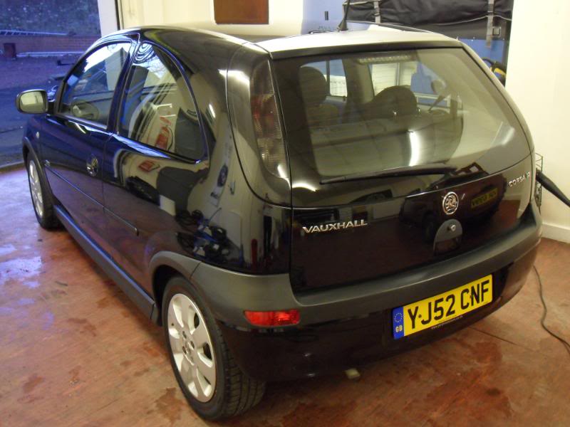

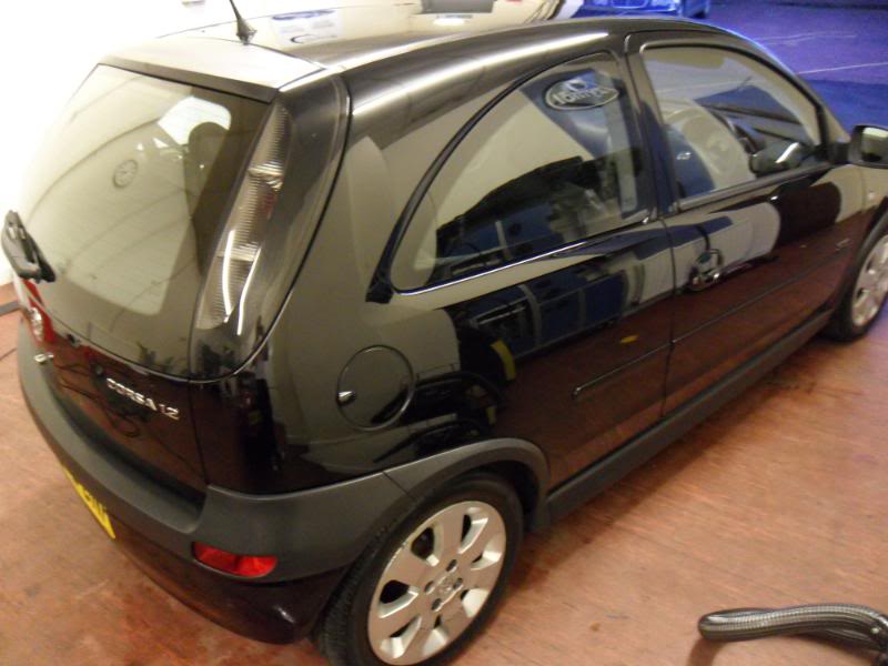

I was up at our local detailing shop (NE Detailing) using some of there space to machine polish the corsa.
Products used:
Snow foam
Washed with wookie mitt
Dried using drying towels
Black Barron to clear shuts of water
Bilt hamber clay
Dodo juice lube
3m Medium Cutting pad/soft refinishing pad (Soft paint ftw/l)
Menzerna power finish
3m Anti hologram remover (blue top)
Panel wiped to remove any polish residue
Re-foamed and jetted off
Dried again
Black barron to clear the shuts
Waxed using Zymol Creme applied with german style soft applicator
Plastics treated with poorboys natural look
Tyres dressed using megs endurance gloss via applicator
Glass Polished
Quick hoover on it

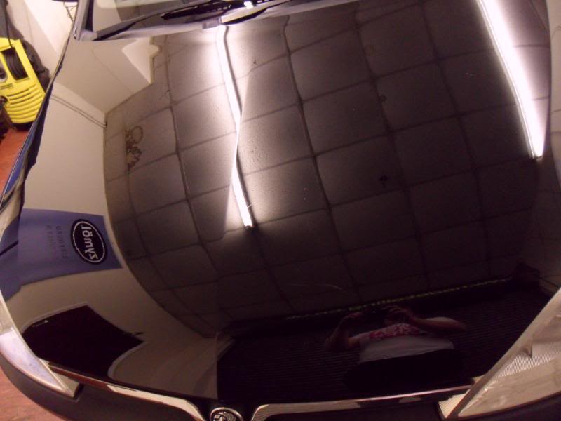

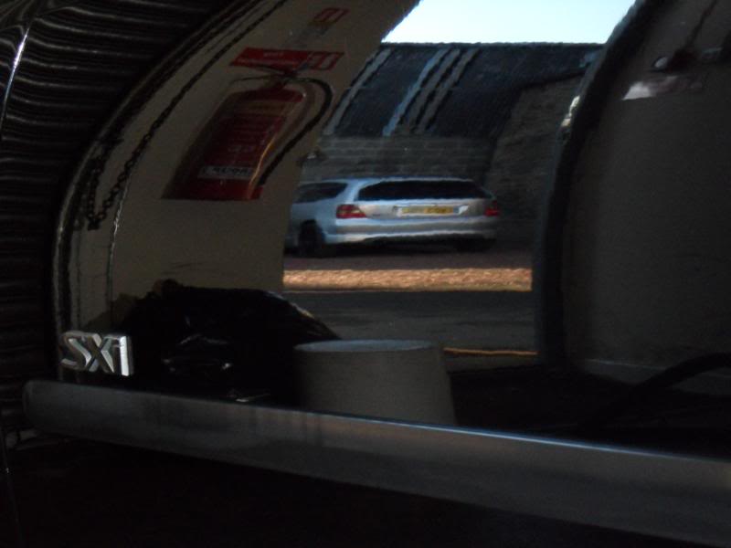

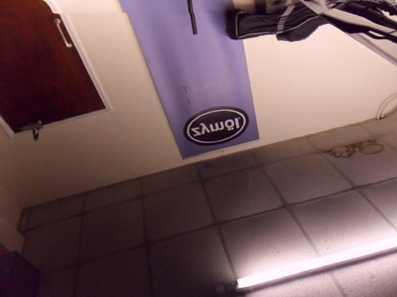

Not many pics of it sadly just a few reflections
