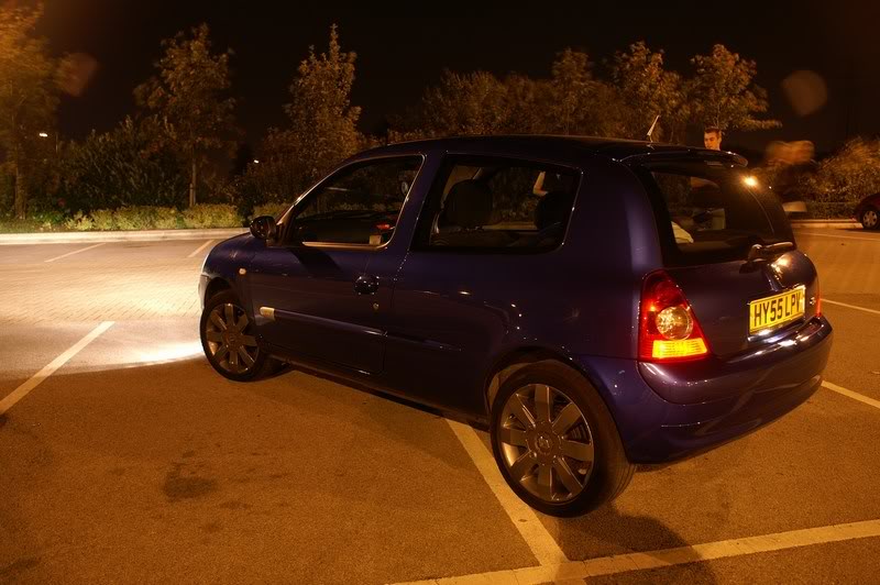

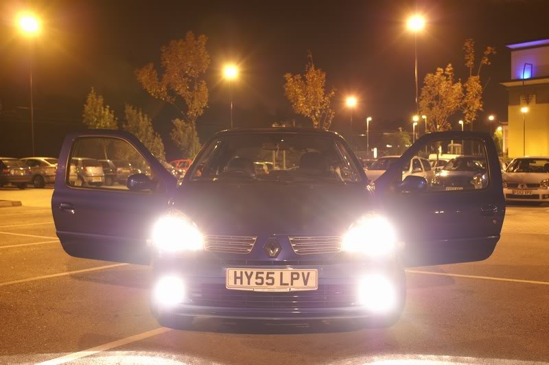

I paid £352.00 for all bumbers, handles, side strip and 16v badges and grille done in silver, cant really see but i havent got any day time photos!! If I could have done it myself i would have but id have made a right pigs ear of it!!
