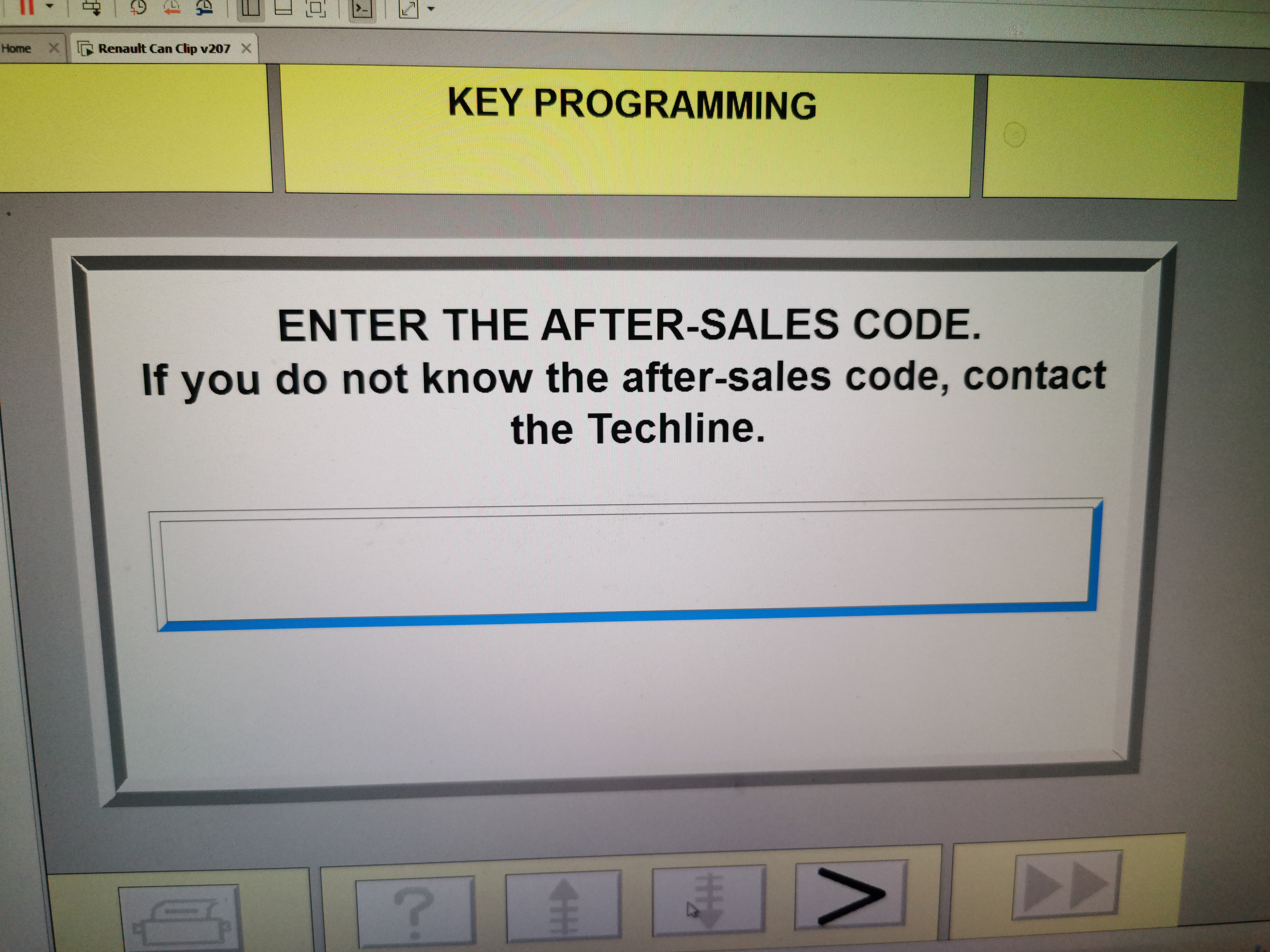

Can you code a key using Clip?
I need my spare doing since I had issues with the car started the spare no longer opens/locks the car on the button fob, it will start the car ok ASLONG as I've not locked it using the other key via the fob button! Very odd!!
Anyone know? got as far as this

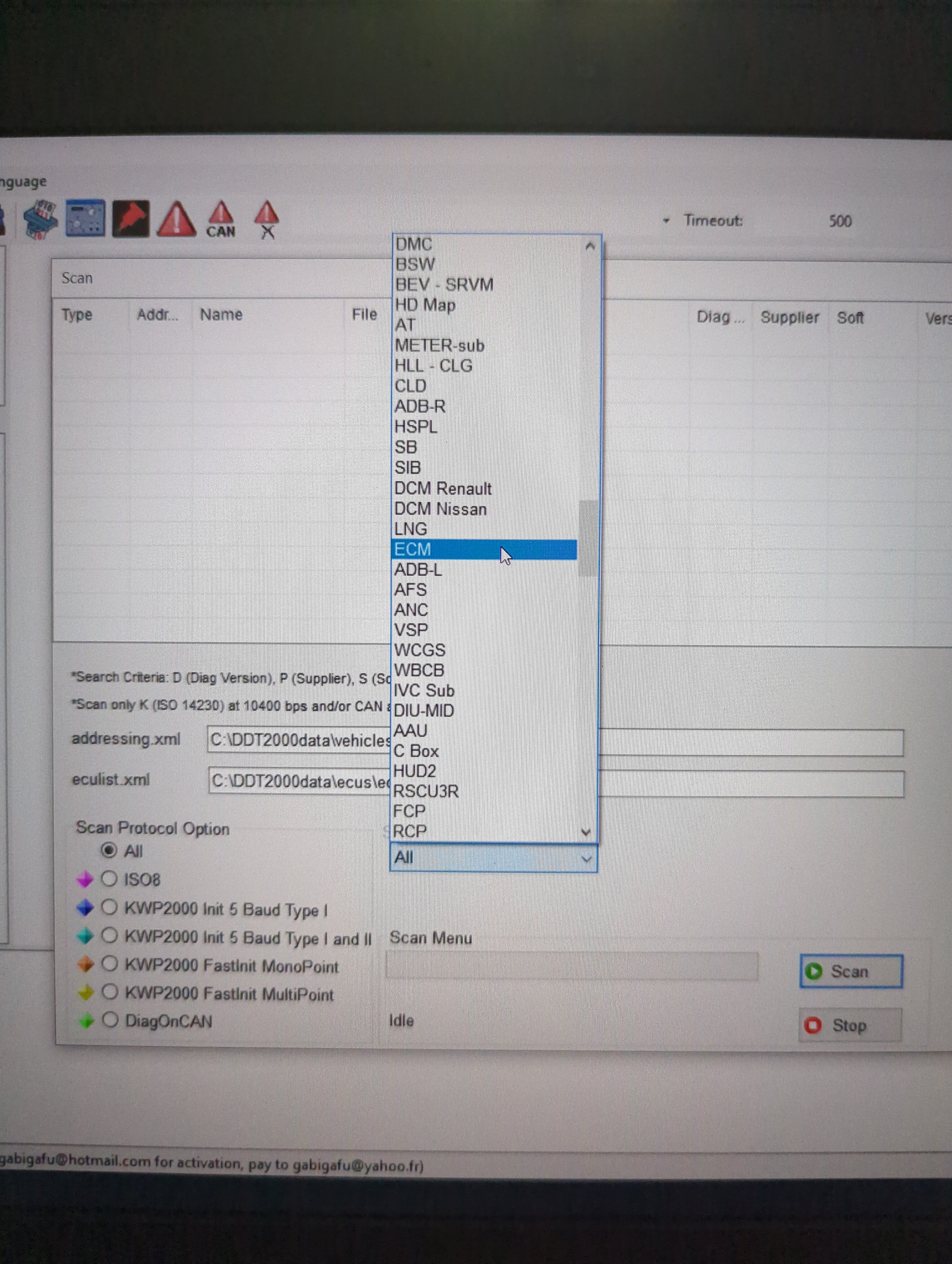

Yeah you can, slightly long winded.
However, if you go to scan it brings up a another window. If you hit scan on that it will take forever as it tries to look for every type of ECU in it's library.

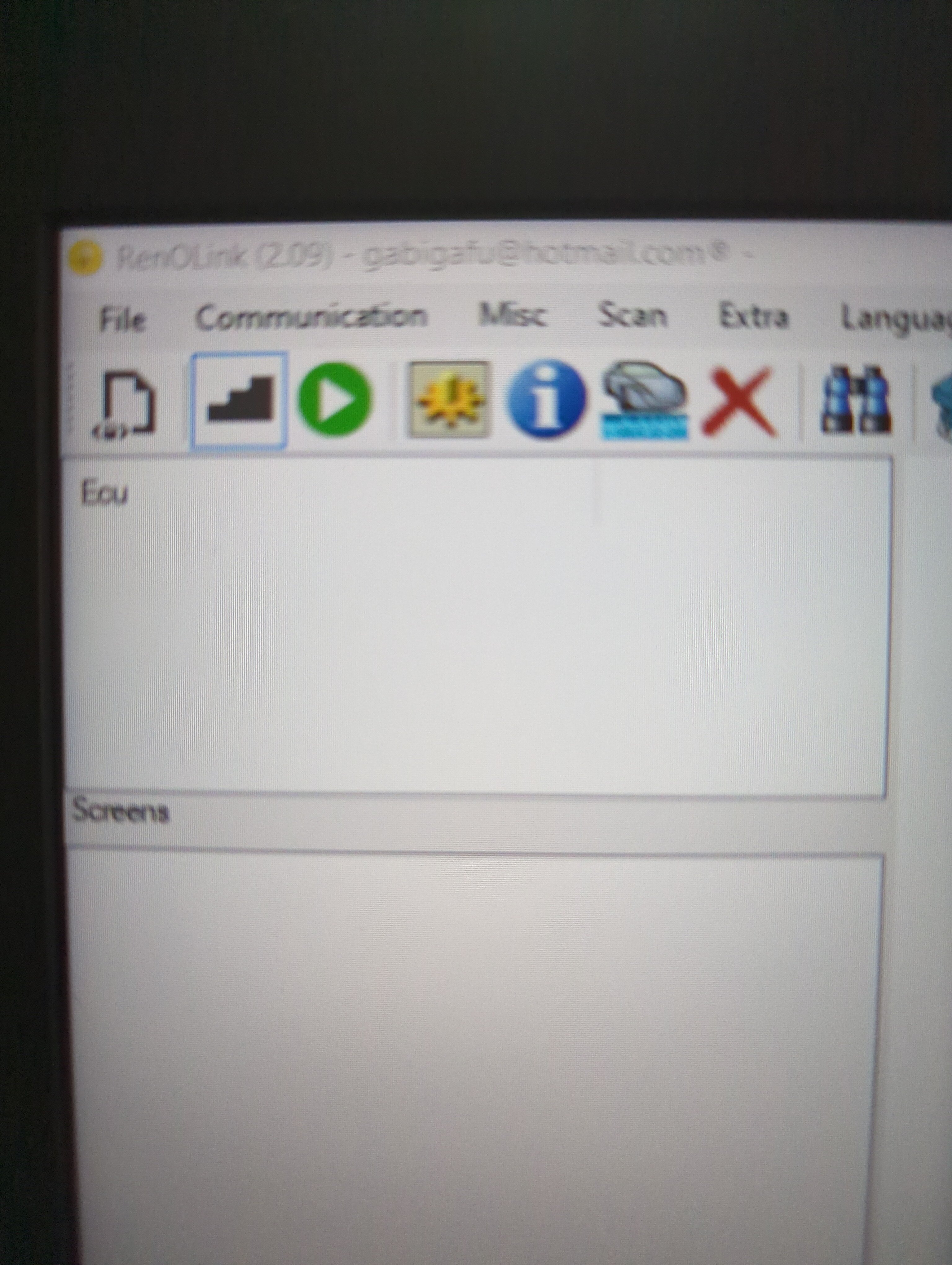

What you want to do is select the relevant one from the drop-down list, say ECM or UCH, ABS. Then scan that and it will bring up the ECU name at the top, click on that and it now show it top left in the ECU (mines blank because I'm not connected to car)

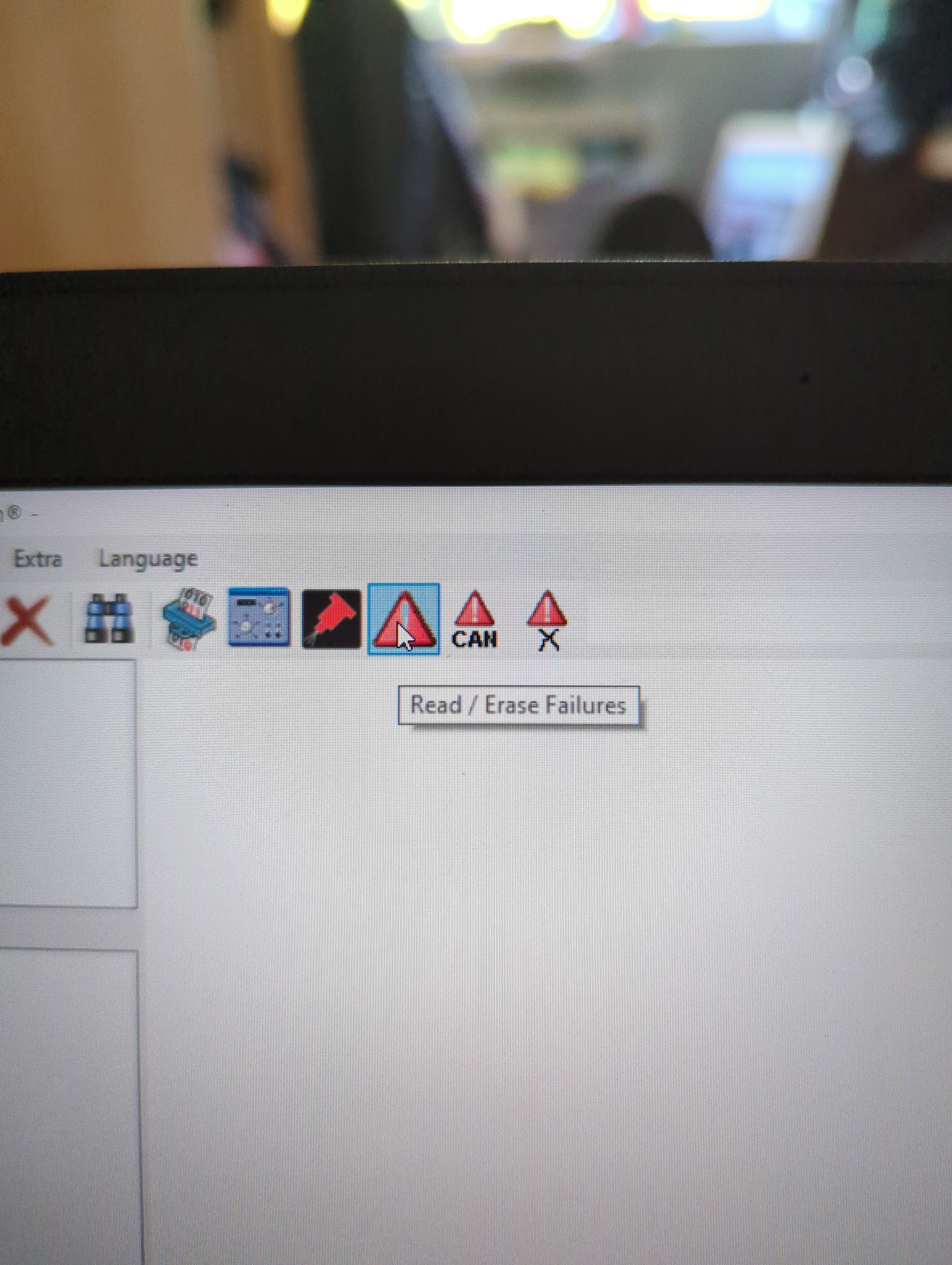

Then once you're on the particular ECU, you can go to one of these. I think it's either the first red triangle or the last...

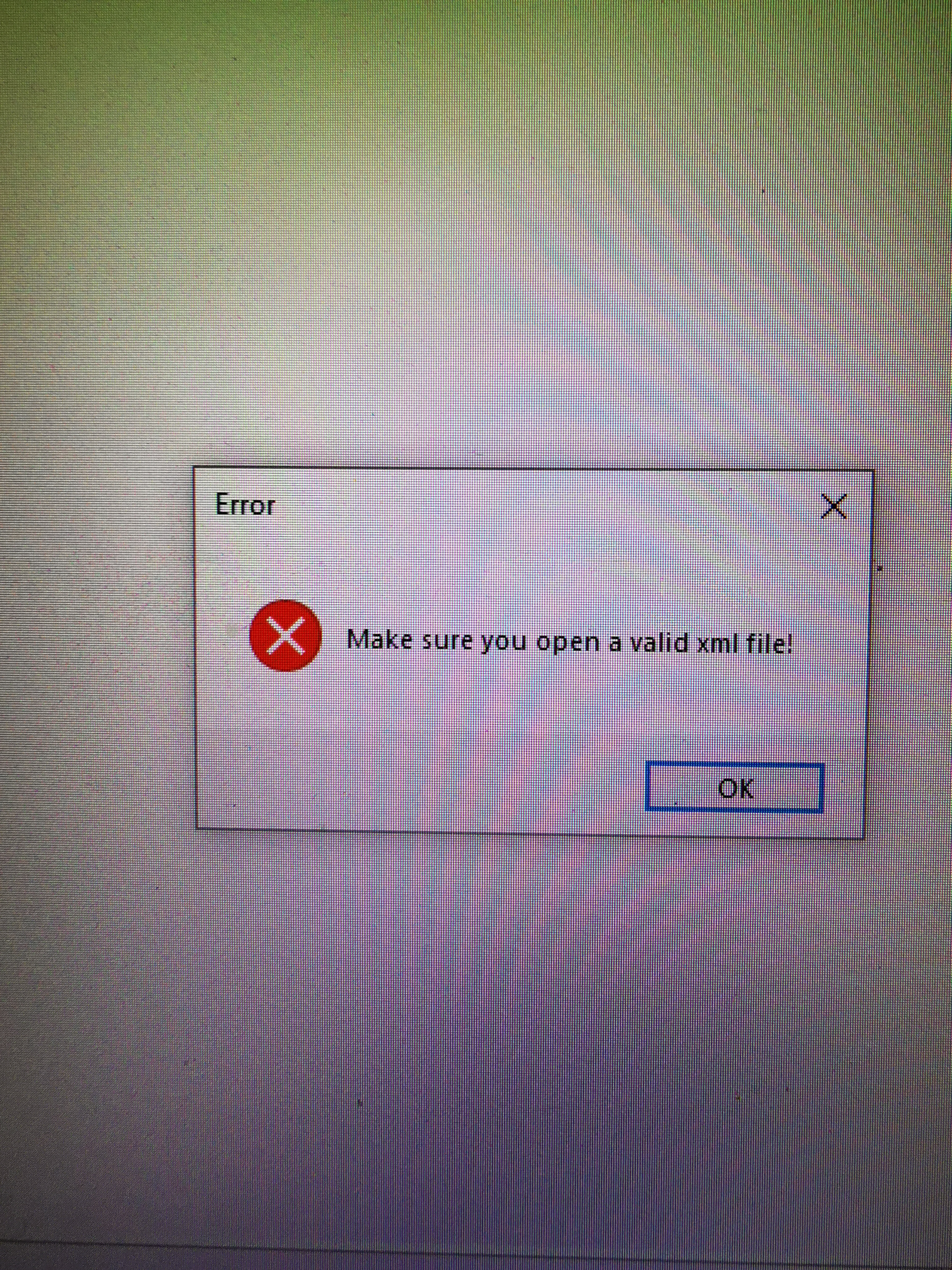

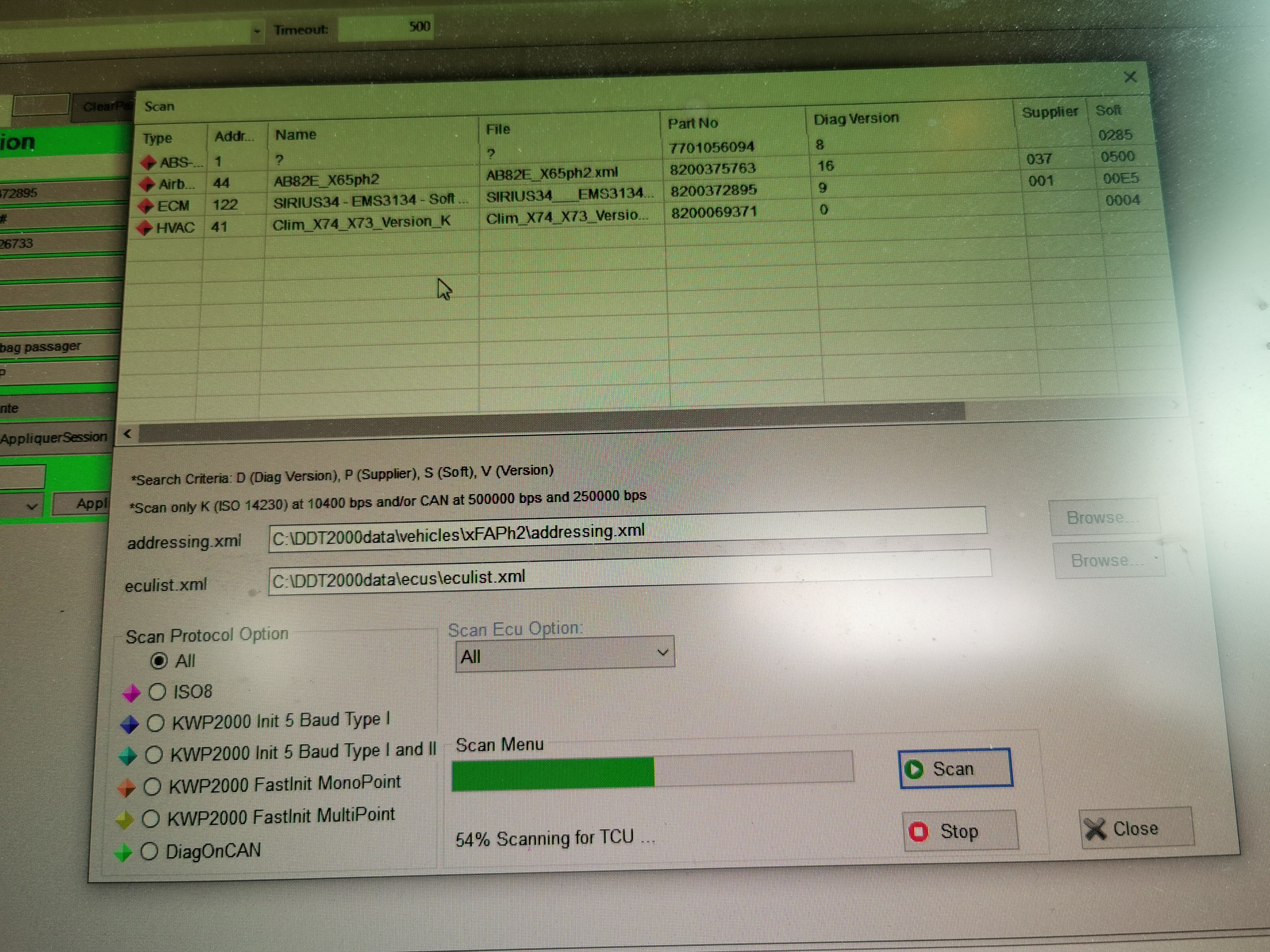

I did have a further play around until I had to leave it and I got this and this!

You'll see it's found a couple of your ECUs there.
If you click on one (might need to double click), it should then populate it into the ECU box top left like I mentioned.
You can then go ahead and read/clear faults.
You needed to have an ECU selected, that's why it's come up with the error asking for xml.
