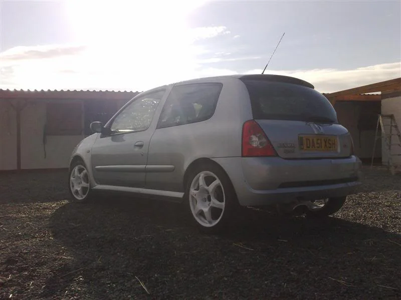

Couple of my Track **** 172....
Car  Clio 172 Sport Ph2

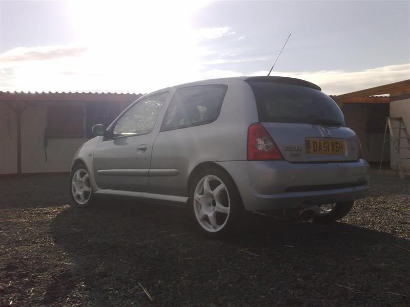

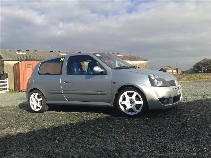

...in its current guise as of today - ready for Wednesdays track day at Oulton Park!!
Hope people approve!? ;);)
Still lots to do to get it exactly how I want it, but the next few bits will get done after winter now!! :D
Re: Couple of my Track S L A G 172....
Nice!
Spray the wheels a mad colour!
What seats have you got for it?
lower. new exhaust mount. splitter and jobs a gooden
Already lowered - on Eibach springs....coilovers are on the list to do though.
Exhaust wont sit any higher unfortunately - it already nearly touches the heatshield as it goes over the beam - I'll be making up a new exhaust anyway for it. It only cost me £50 so will do for now until after winter!
Splitter - Cupra R hopefully picking one up tomorrow morning.
Seats - Cobra Monaco S, with TRS 3" 4 point harneses.
I like the wheels white tbh- they are only my road wheels & emergency track ones if my slicks wear out - will prob paint the slick rims a mad colour though!!
Interior - just a basic strip really - havent gone fully anal on it.....YET! Still some sound proofing in there that could come out!
exhaust is horrid, wheels look good tho they 17's?
Exhaust is shite I totally agree but as said, was cheap so cant grumble tooo much.
Compomotive alloys are 16s mate!

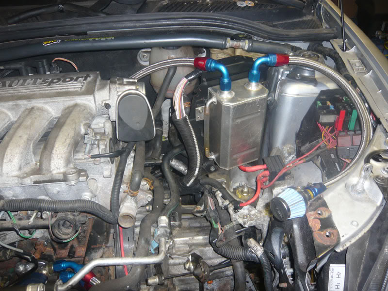

Alloy Catch Tank & -10 JIC Aeroquip Lines

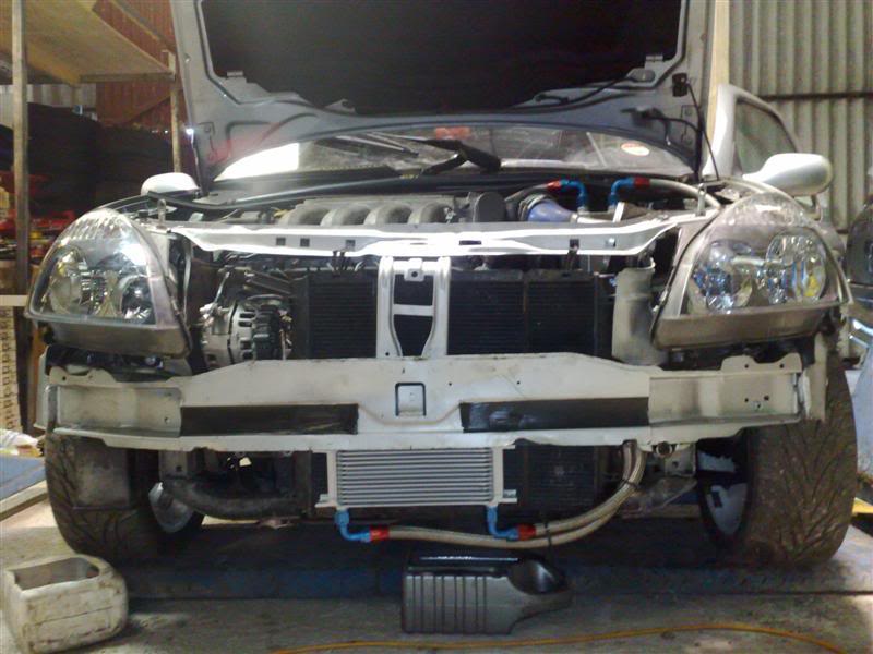

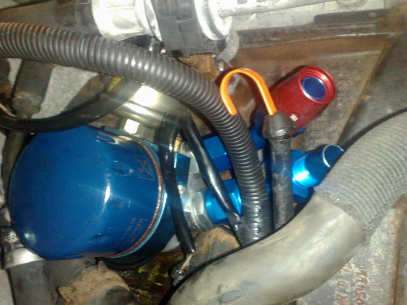

Mocal Thermostatic Take Off Plate, 13 Row Mocal Oil Cooler & Aeroquip -10 JIC Lines
Gauge Take Off Plate

did you fit the guage take off plate before the thermostatic plate or after, cant quite see in the pics
although i have heard (from a very reputable source) that it doesnt matter either way as the thermo plate stops oil returning into the engine from the cooler, meaning oil is always running into the cooler, but not always out of it.
After the plate mate - doesnt matter where it goes because if you think about it it still has to flow into the oil filter which is last in the line anyway!!

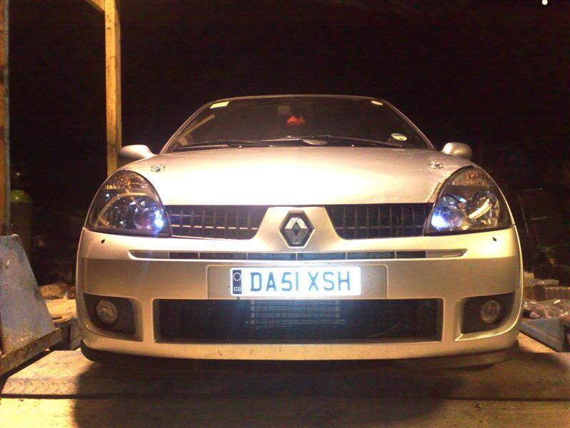

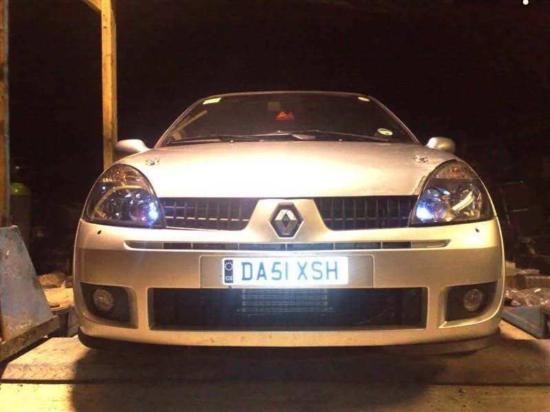

Quick update...just fitted a Cupra R splitter to the Clio - looks much much better now...
Not the best pic but still...
