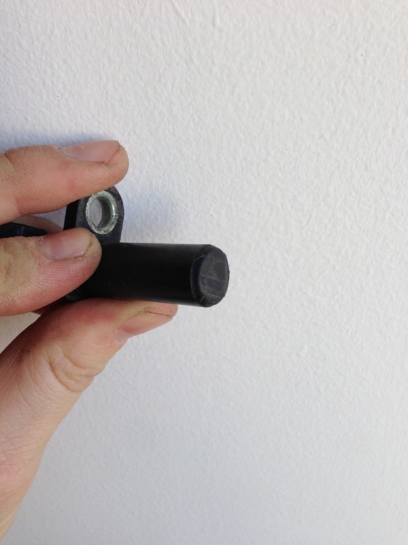

currently mine is literally skimmed by the flywheel and you can see its shaved a slice off the end, would this cause a malfunction?
It's on my megane, it has a vag box conversion and I'm using a custom flywheel with a ford zetec sensor.
its been running in the base map and it cut out all of a sudden, put it on the laptop and its telling me its reading at least 9000 rpm.
nothing has moved and it was running fine it just cut out randomly. The only thing I have noticed is the slight shaving off the end of the sensor
It's not worn through the plastic, its literally either shaved a fraction of a mm off it or just rubbed it slightly.
would such little damage throw the readings off that much?n

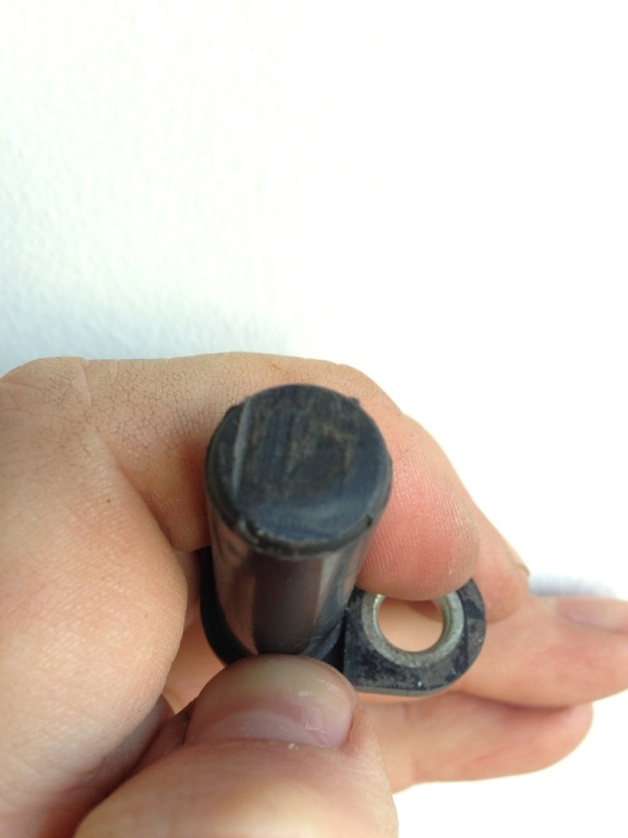

Here's some pictures of the sensor...

could of damaged it to the point its giving out incorrect reading. do you have a spare that you can try for a few mins?
I just went out to buy a new one to try but I don't want that to be damaged either lol. £16 a pop could get very expensive
Like I said air gap anything bigger than about 1mm away from the flywheel won't get recognised and it currently has a shim under it which lifted it about 0.5mm. When I measured the distance this left me with an air gap of about 0.34mm which was ideal but clearly something isn't right as its been catching.
Thats if this is the problem, I'm not even sure the amount of damage to the sensor is enough to make it go loopy
