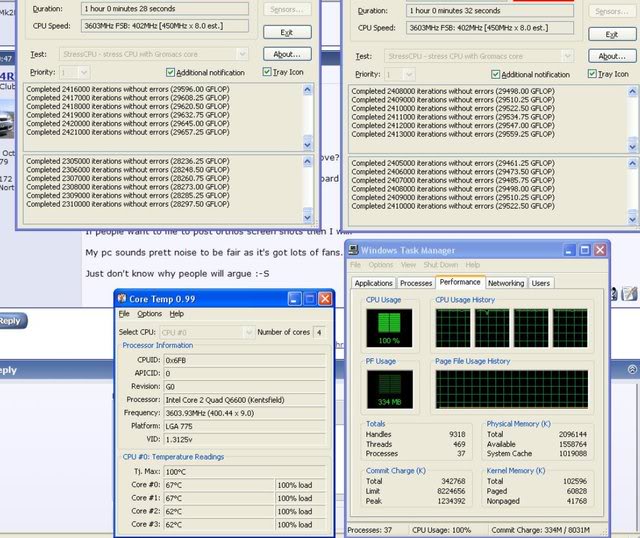

Got my Q6600 running at 3.6Ghz on air cooling. Antec 900 case, two front fans, top fan, side fan, rear fan, ac freezer7 pro cpu cooler.
Had a bit of a (pointless) argument on here a while ago, can't find the thread. About whether I could get 3.6 on air cooling. There's a few lucky other people on overclockers forums who've managed it too.
I've had it sat at 100% load over night before. It is a bit noisy to be fair but tolerable.
