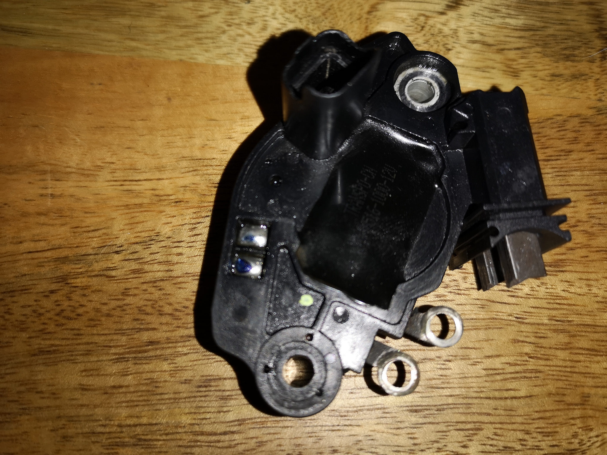

Small update. I popped the regulator out of the alternator, with it in situ.
IMG_20181115_152454https://www.flickr.com/photos/27957459@N04/
The brushes don't seem to be the issue, which is a shame as that is the cheapest and easiest option, however, I may just get another regulator and try it as the top stem connector thingy looked black to me which is usually a sign it is not making contact with the brush properly. It should be clean metal as the brush end wears the stem connector down.

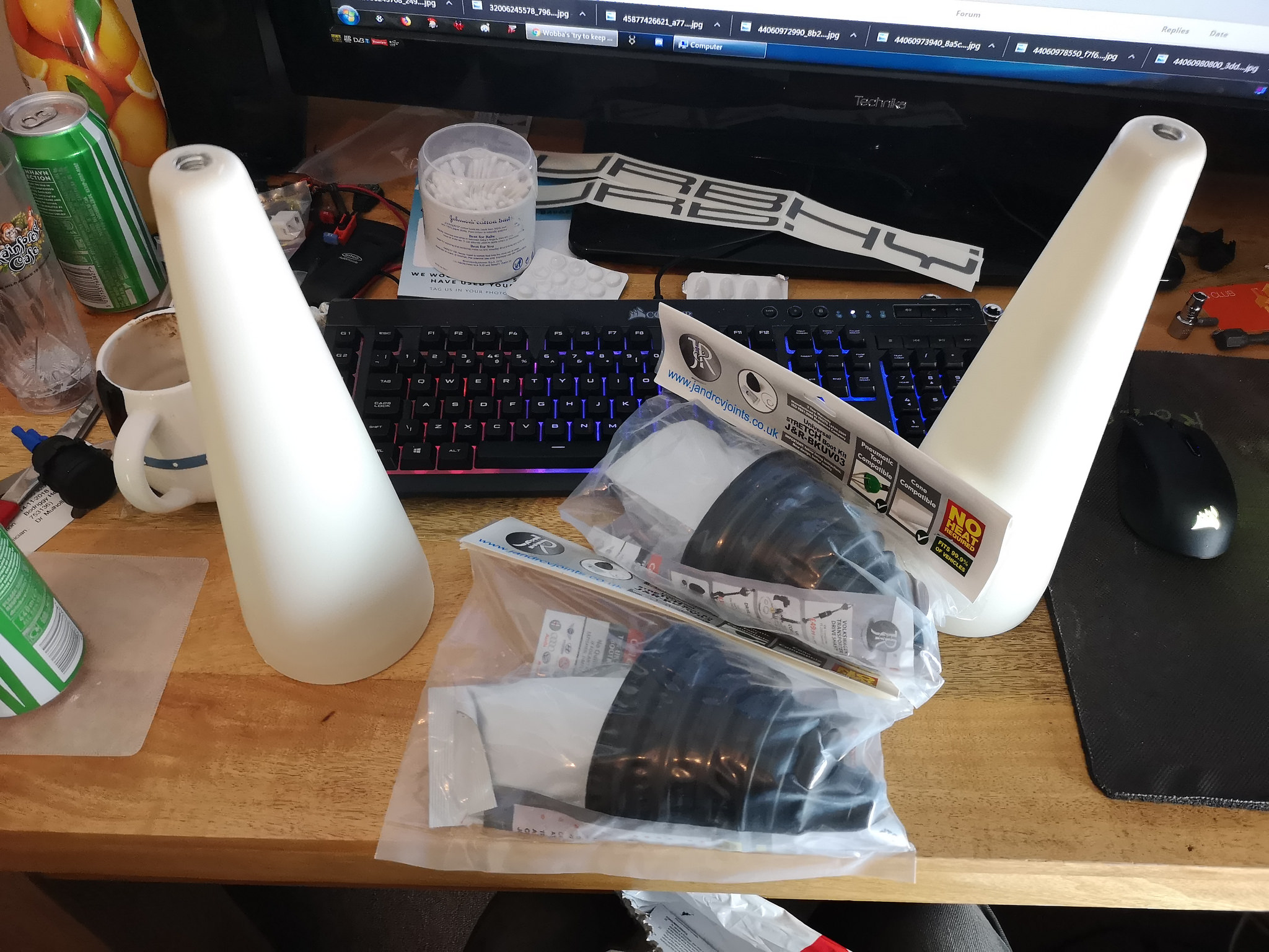

I received the CV boot kits yesterday as well, I'll do the whole shebang and the new Cooksport springs at the weekend hopefully :) You would be safe to assume, seeing this pic, that I am a single bachelor...car parts, gaming PC stuff and beer. Ohh yea :D

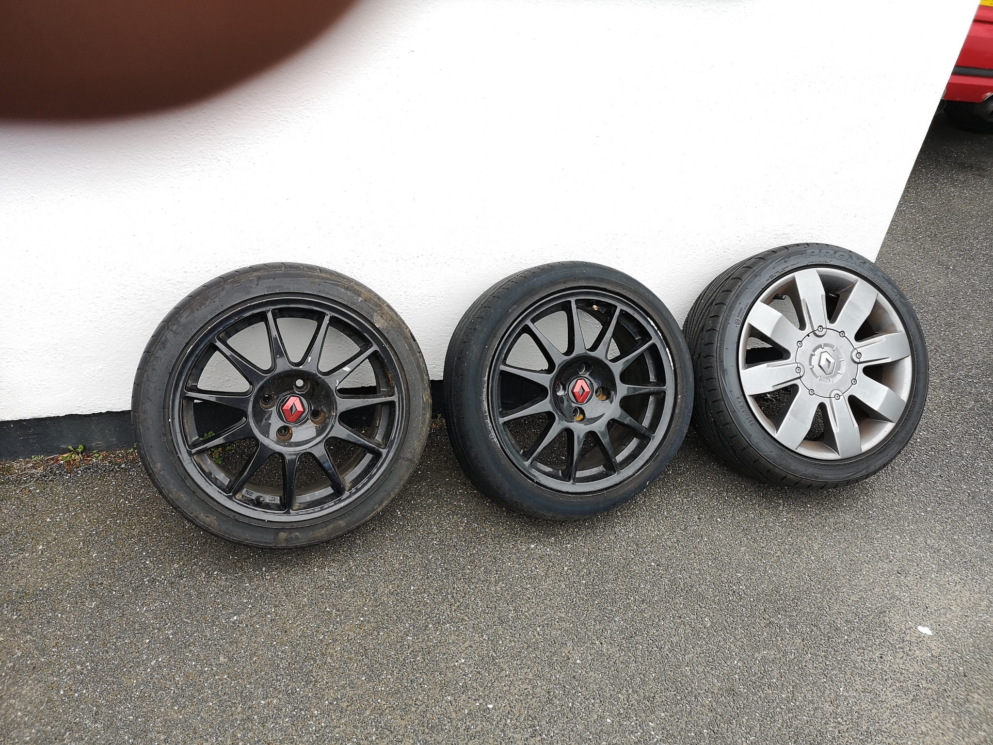

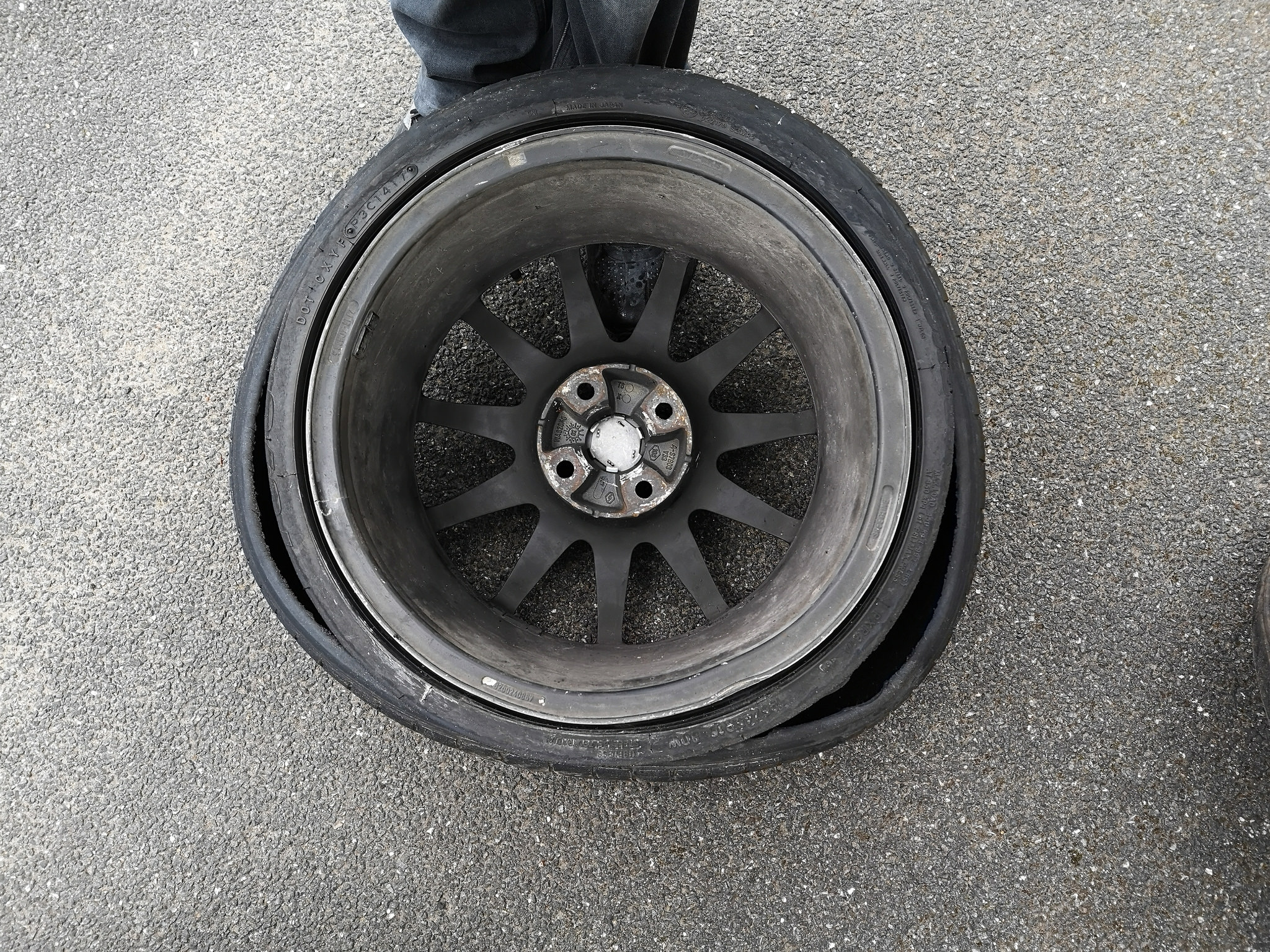

So, I popped the wheels off the Trophy (bolts too tight as usual) as I am sending them off to be repaired/refurbished back to OEM, with new tyres. The RB's spare wheels are almost mint and have brand new T1R's on, so I put them on to move the Trophy about and for MOT next week:
IMG_20181115_142604https://www.flickr.com/photos/27957459@N04/
b*****d...this was the result of a blowout just after picking the Trophy up. It has a crack in it and a buckle. It is repairable though thankfully.
IMG_20181115_142621https://www.flickr.com/photos/27957459@N04/
The Turinis are noticeably lighter than the RB wheels and I think quite a bit lighter than the bigger-tyre shod 2118's.

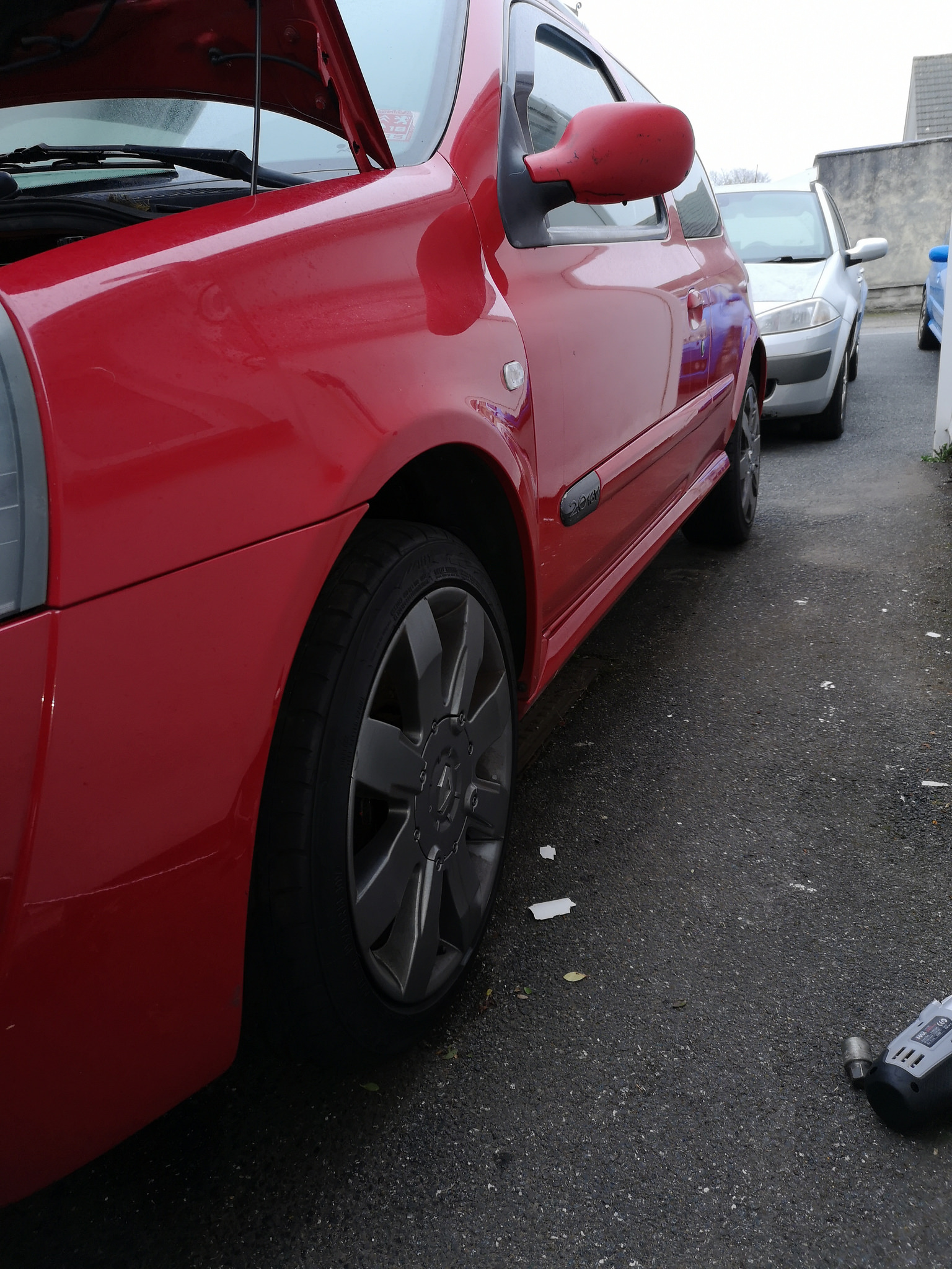

Wheels transferred. The car sits high right now as it has the wrong suspension on, but I already MUCH prefer the OEM anthracite over the black Turinis.

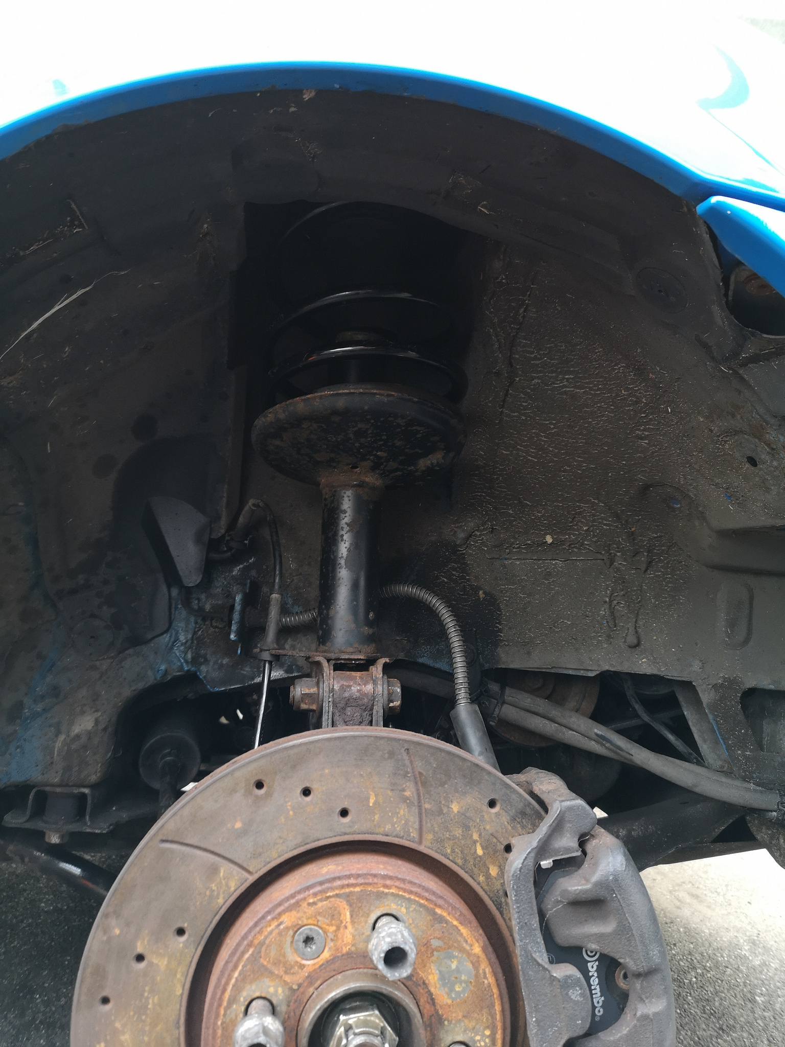

For those of you that have not done suspension struts before, the top mount can be a b**ch to get off without IMPACT GUN hehe. I've done it with and without. If you don't have a gun then an 21mm (or is it 23?) recessed ring spanner can do it while an allen key is in the strut top and somehow held in place so the strut does not spin as you unbolt the top nut.

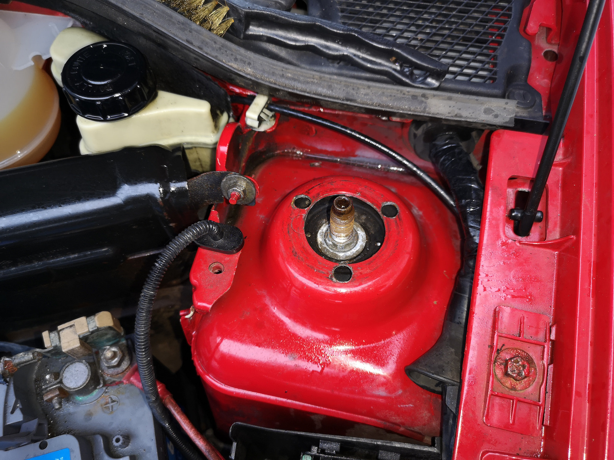

Looks like adjustable top mounts use to be here. I will either treat and plug the holes or refit some adjustable tops.

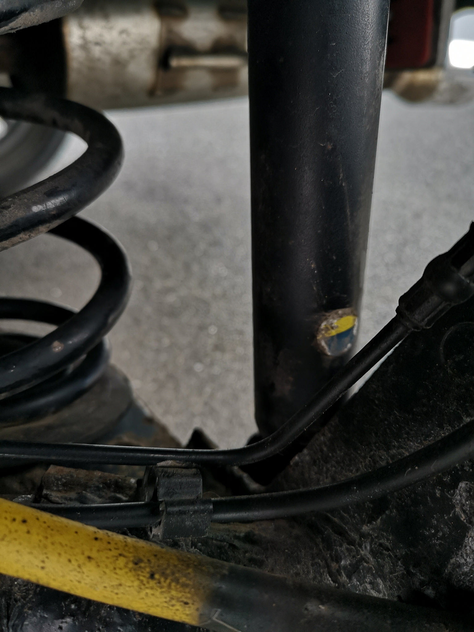

Does anyone know what springs and shocks these are?
IMG_20181115_141436https://www.flickr.com/photos/27957459@N04/
IMG_20181115_141505https://www.flickr.com/photos/27957459@N04/
IMG_20181115_141517https://www.flickr.com/photos/27957459@N04/

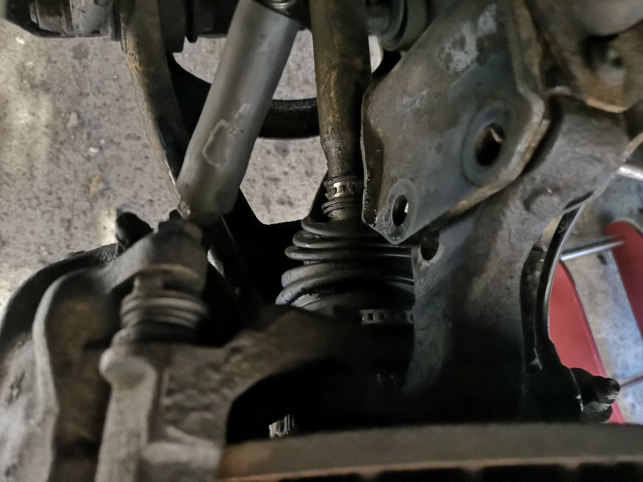

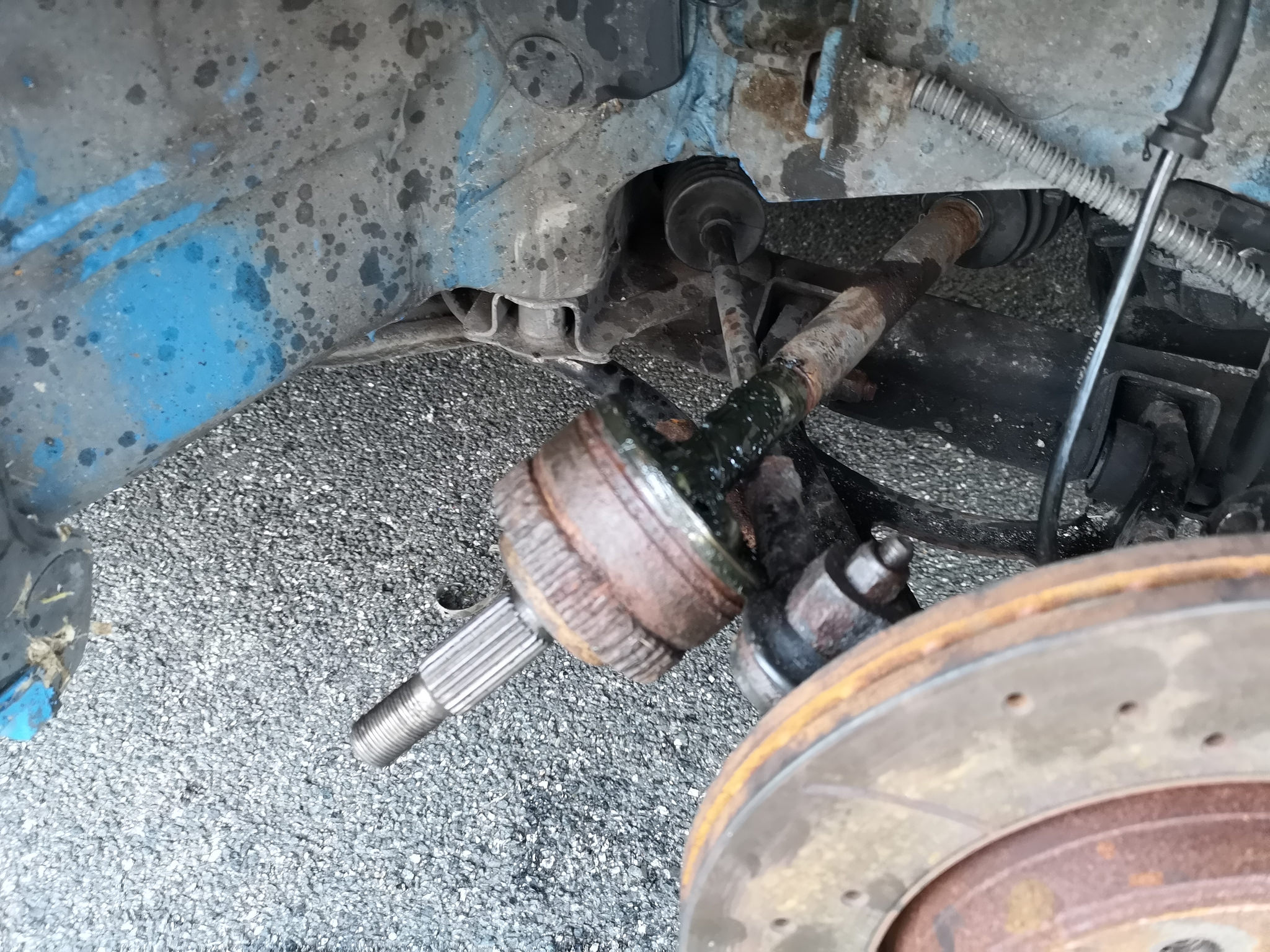

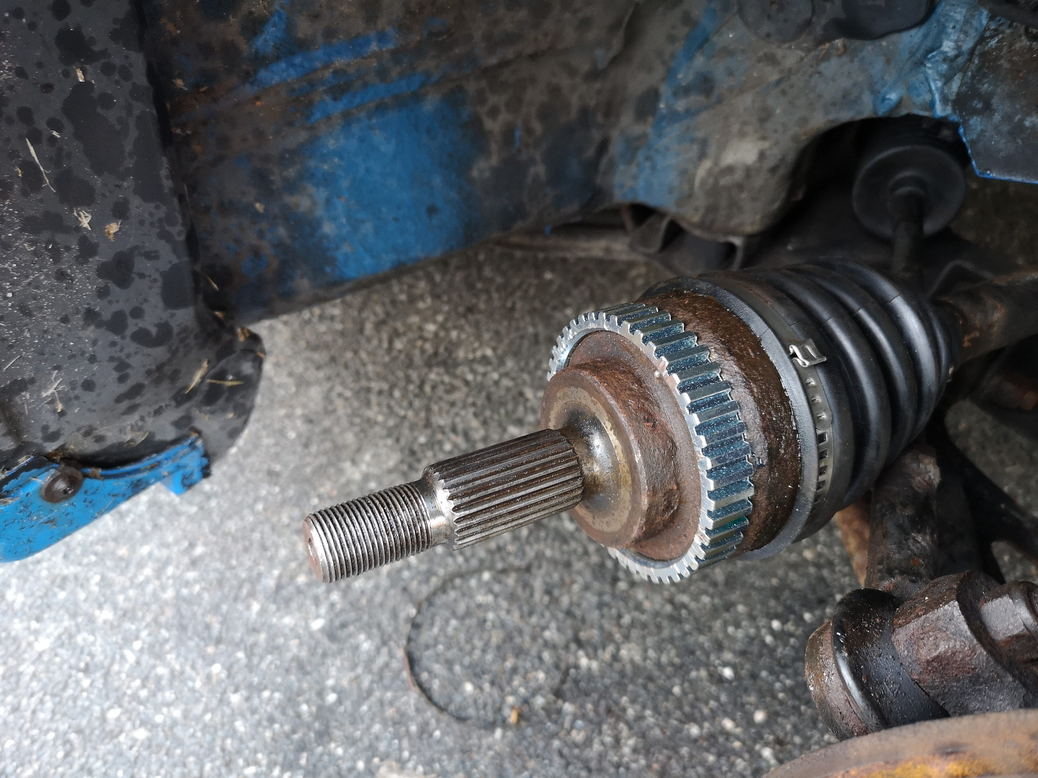

I've done boots before but only with the driveshaft and CV joint off the car. This time I used a cone fitting tool. It was quite easy having watched how to do it on youtube. Whilst I was there I investigated why the traction control light had come on. The rear sensors and ABS rings are quite new, but the fronts, I had seen some evidence of boot grease escaping and the rings looked minging so I have opted to replace those as well whilst it is apart.
Took a while to beat the bugger off as the ring had corroded onto the CV and years of compressed dirt and crap made it hard to get it off:
IMG_20181119_160747https://www.flickr.com/photos/27957459@N04/
But, come off it did:
IMG_20181120_214553https://www.flickr.com/photos/27957459@N04/
The new rings should arrive tomorrow and the new offside CV boot is in place.

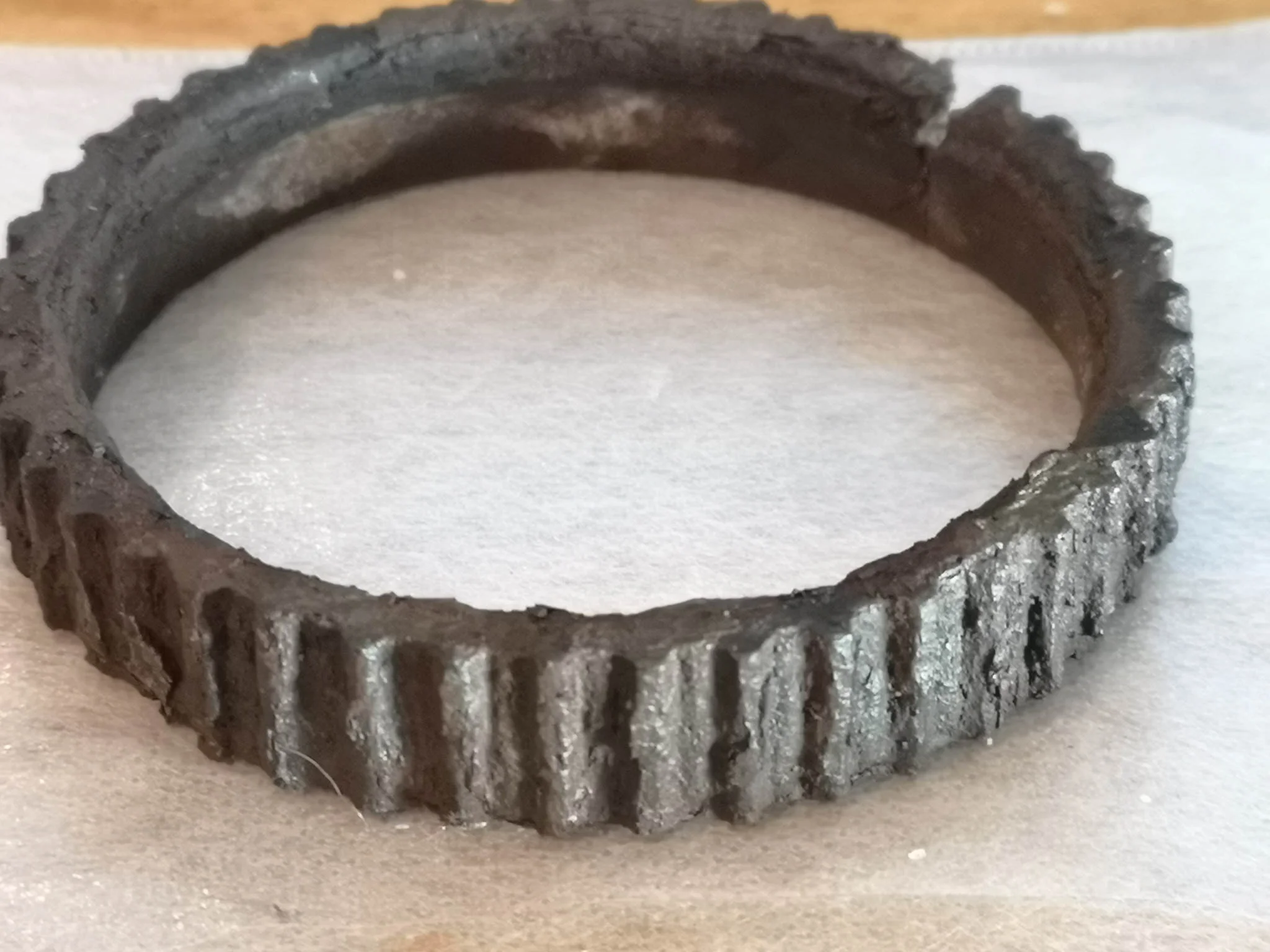

The ABS rings arrived and after popping the new CV boot on and clamping it in place I got the new ring on, quite easy actually. It came with some special fluid that helps stop the ring coming off, of which there is very little chance trust me!

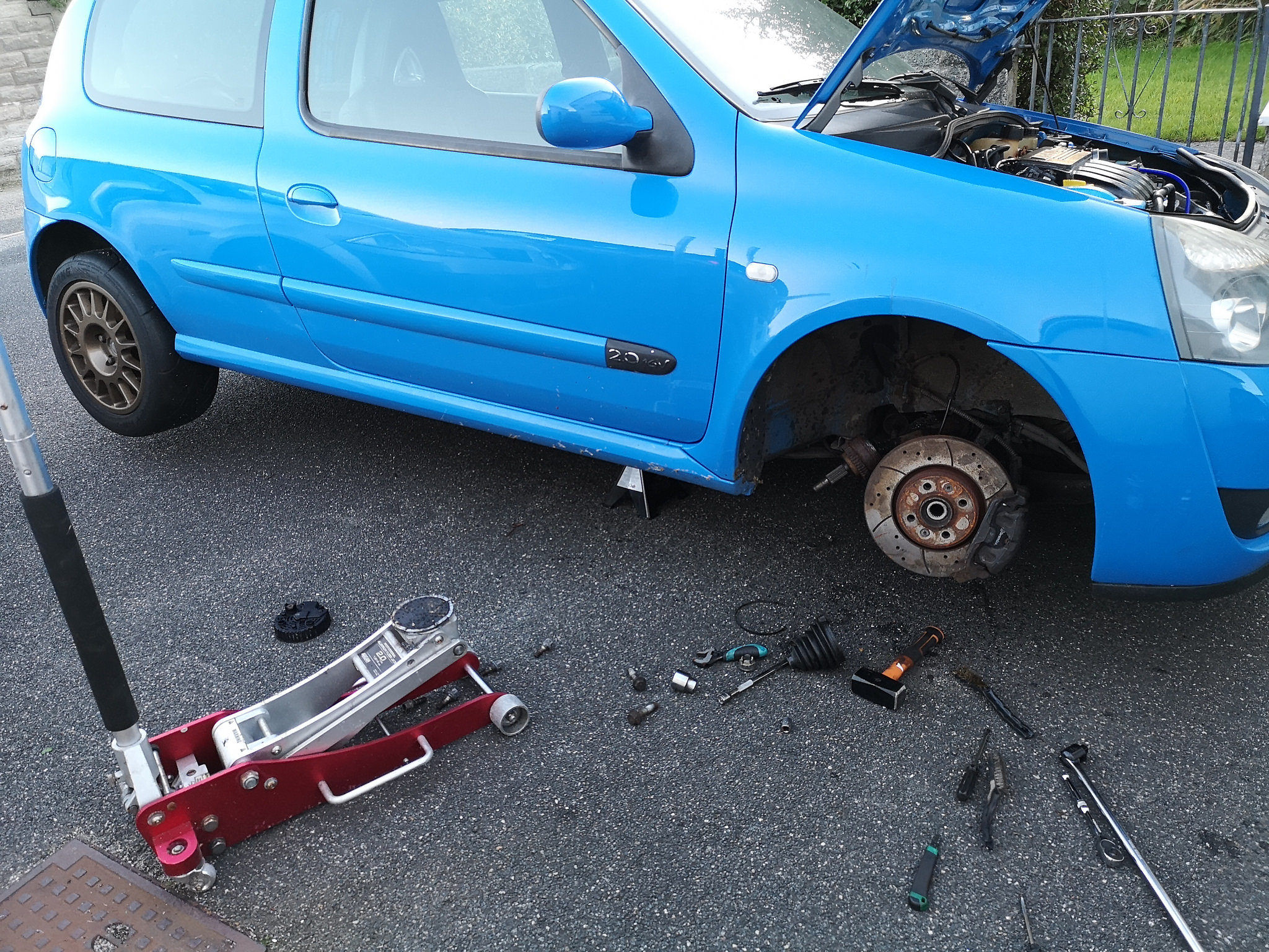

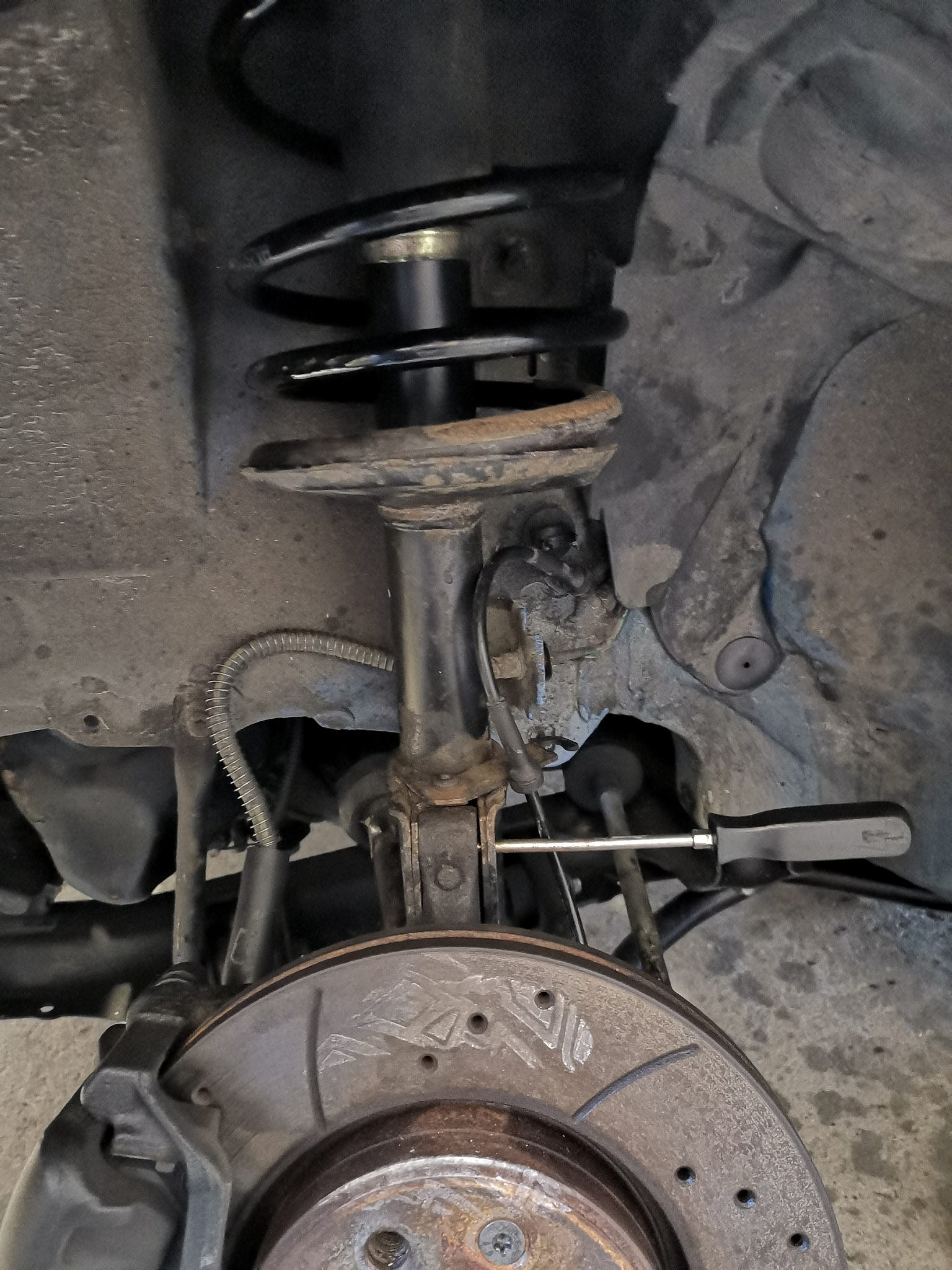

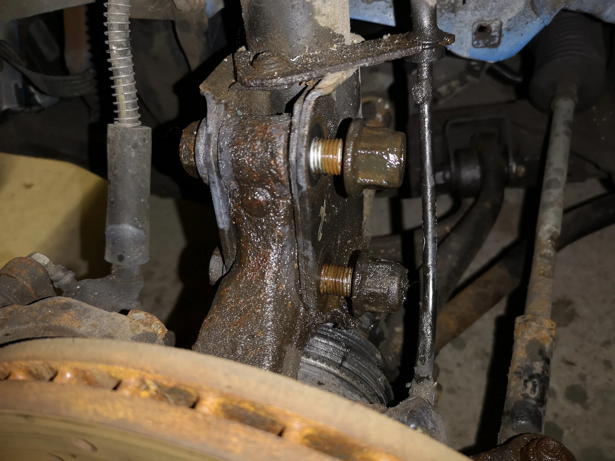

Nearside jack up and wheel off, signs of CV boot failure can be seen with horrible grease :(
IMG_20181124_164741https://www.flickr.com/photos/27957459@N04/
These were on tight but no match for my little friend, impact gun :D
IMG_20181124_164732https://www.flickr.com/photos/27957459@N04/

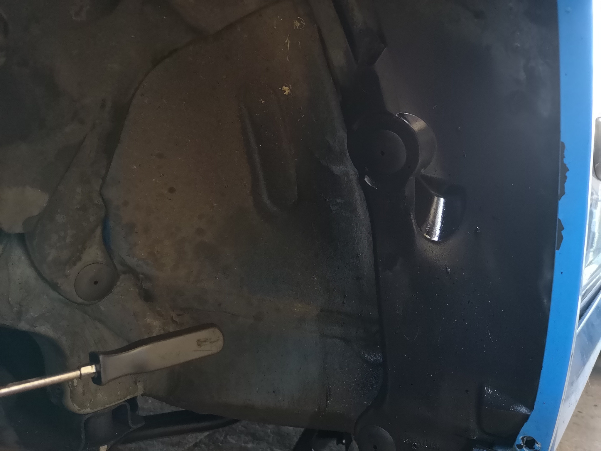

Replaced missing splash guards with nice new plastic rivet thingies:

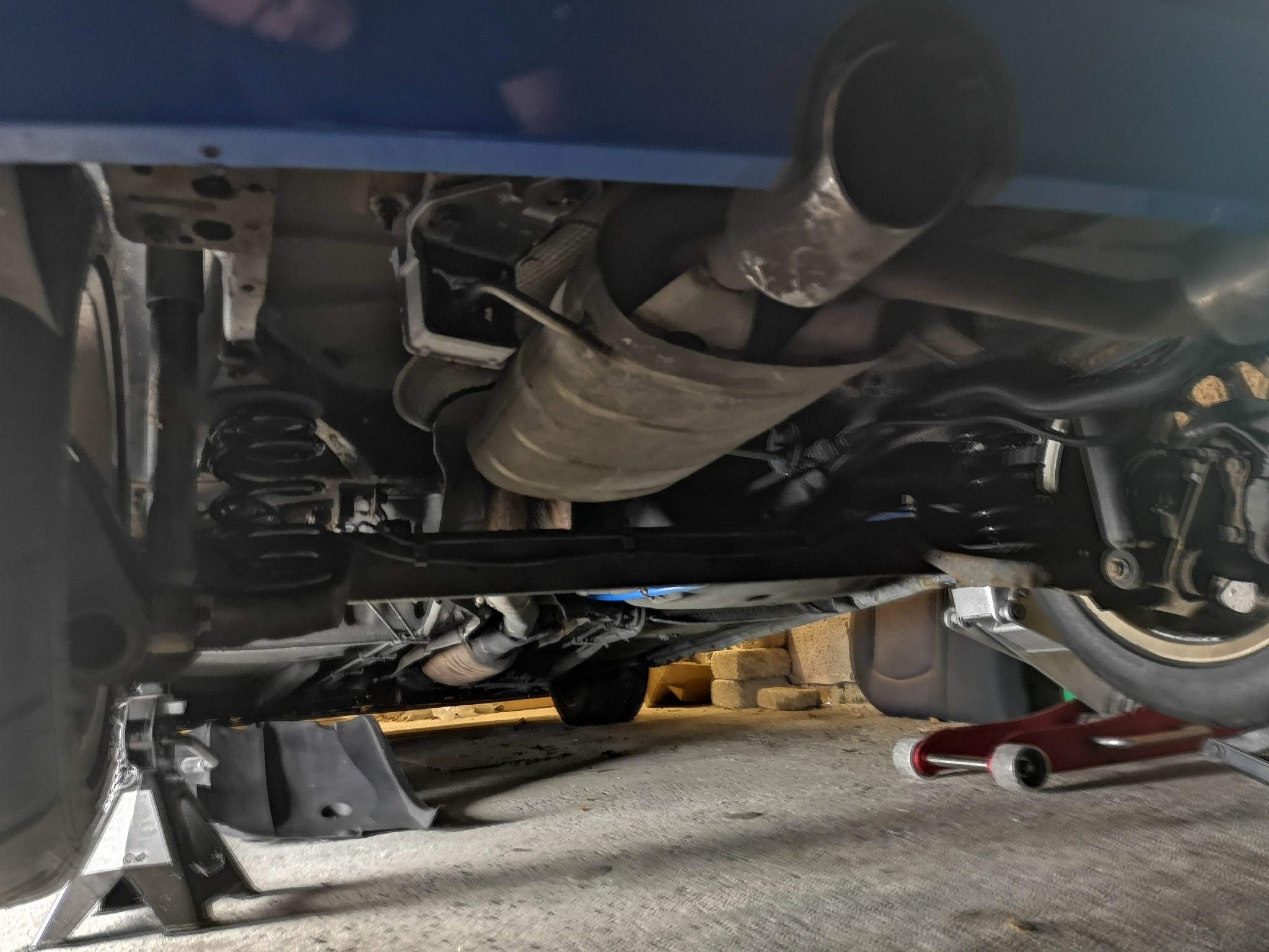

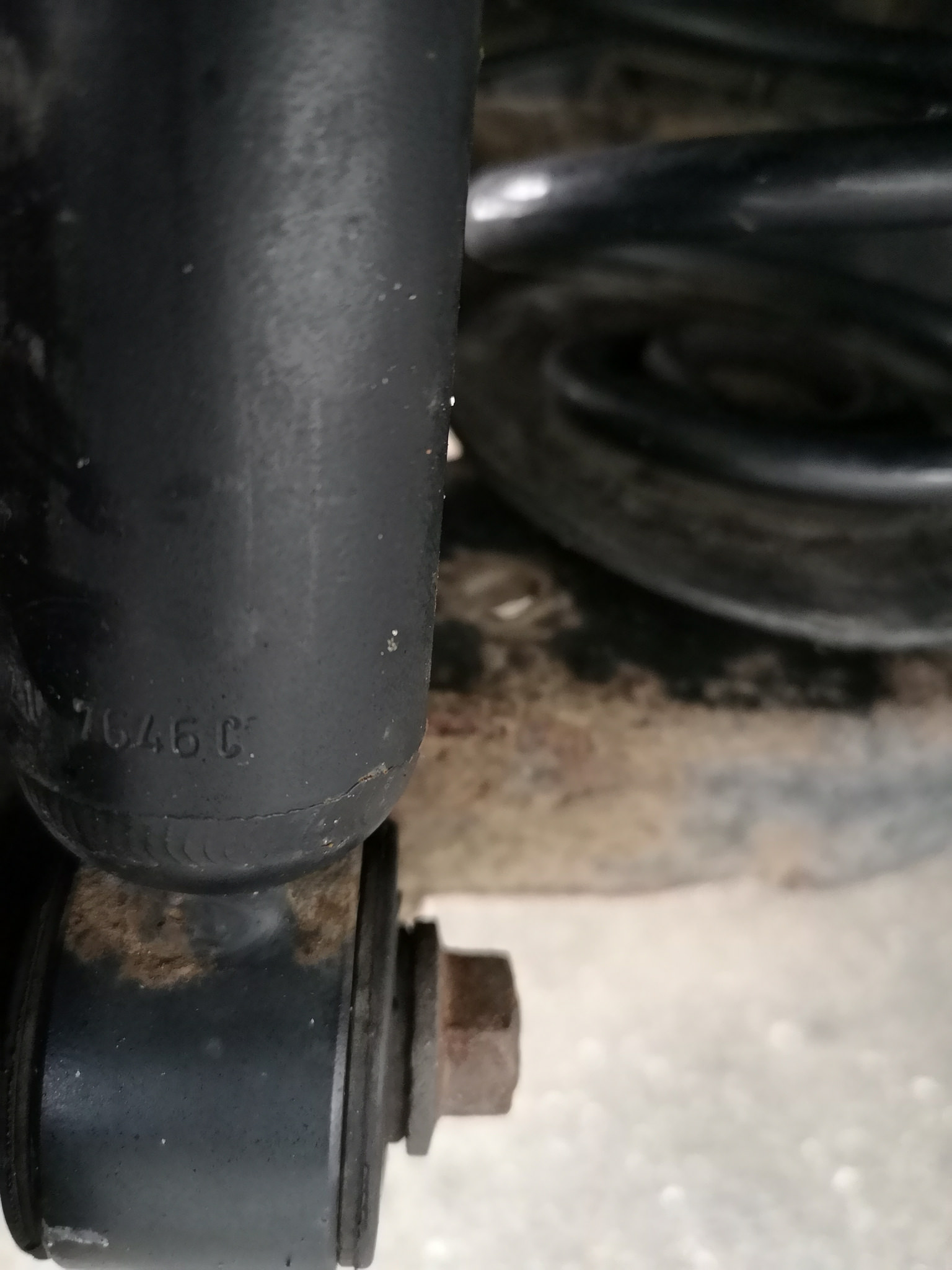

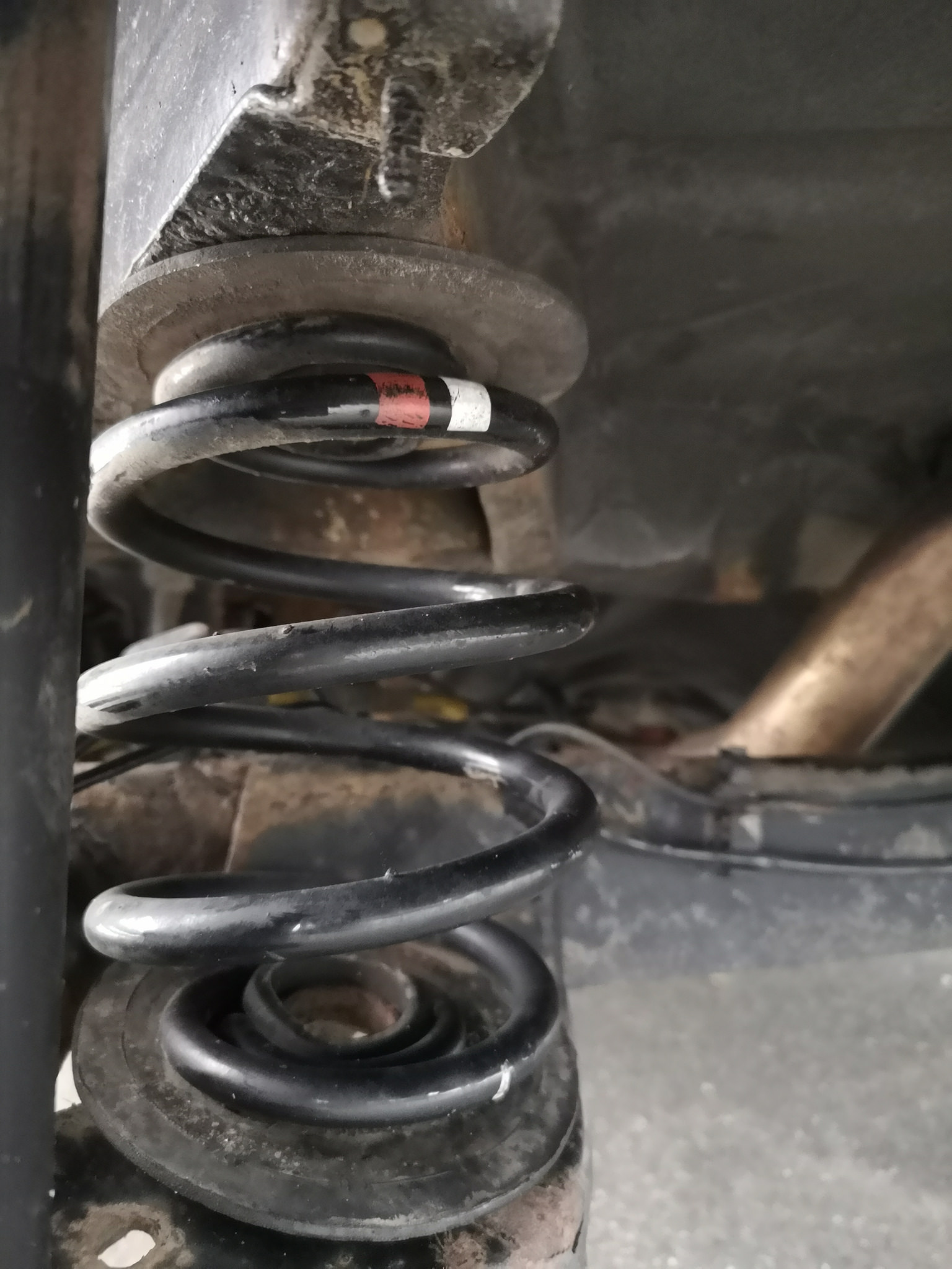

Rear up, new springs on:
IMG_20181126_171711https://www.flickr.com/photos/27957459@N04/
IMG_20181126_171727https://www.flickr.com/photos/27957459@N04/
These are black Cooksport springs. They ran out of the usual colour when making the sets up, I questioned Kam Racing to make sure they sent me the right ones!

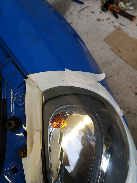

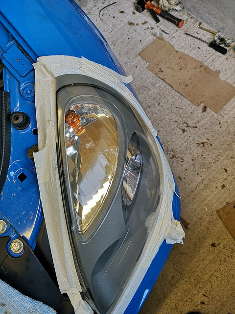

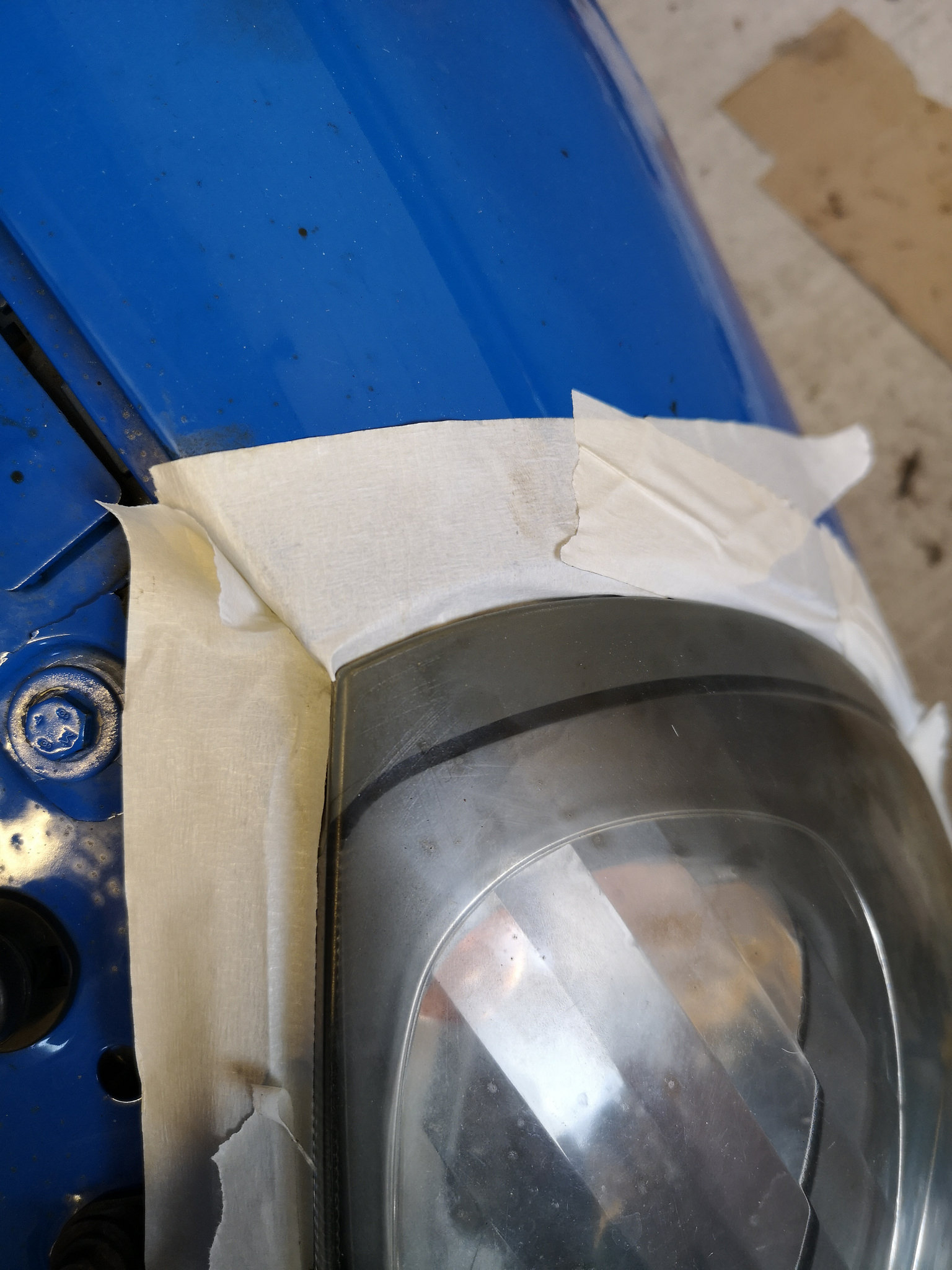

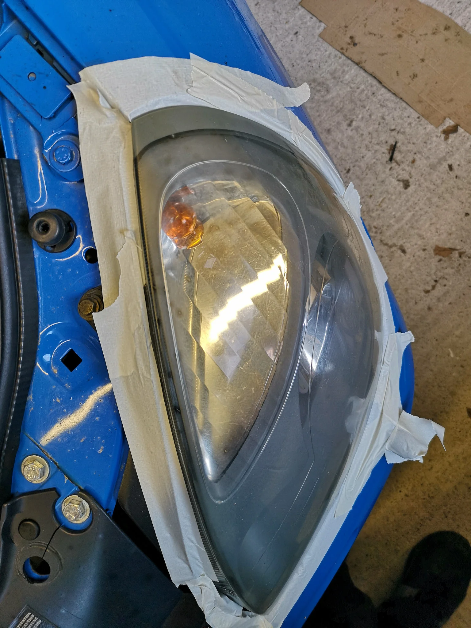

Then I decided to refurb the front lamps :)
Before:
IMG_20181128_123126https://www.flickr.com/photos/27957459@N04/
IMG_20181128_123121https://www.flickr.com/photos/27957459@N04/
After:
IMG_20181128_124227https://www.flickr.com/photos/27957459@N04/
IMG_20181128_124223https://www.flickr.com/photos/27957459@N04/

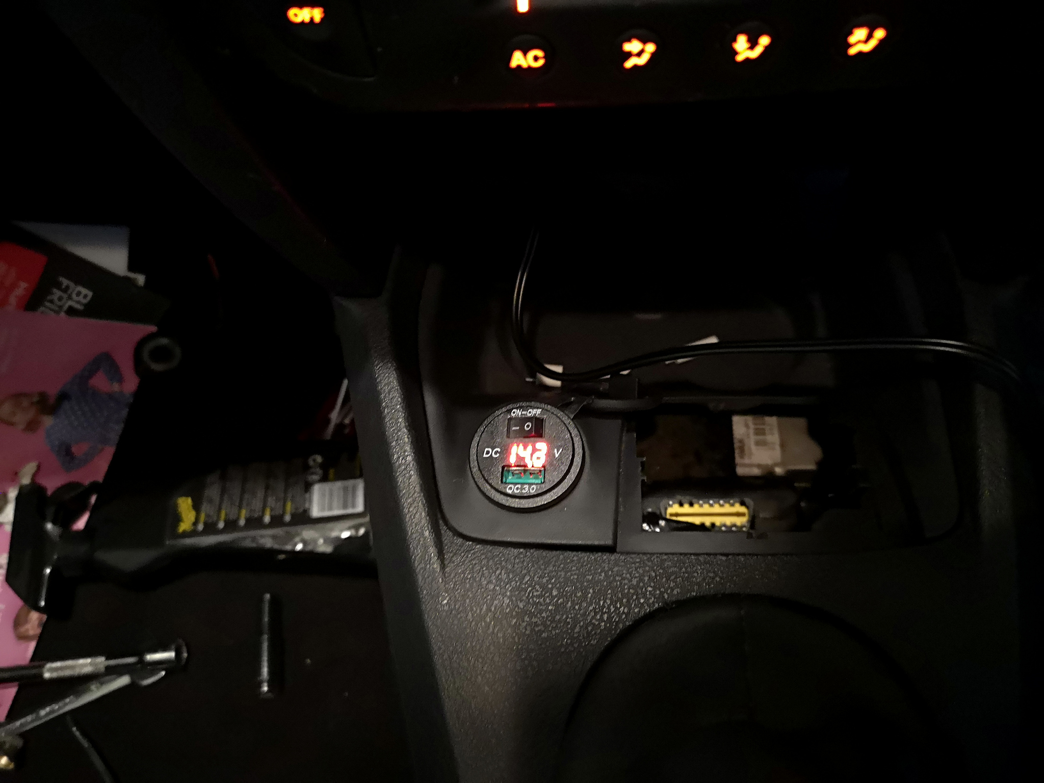

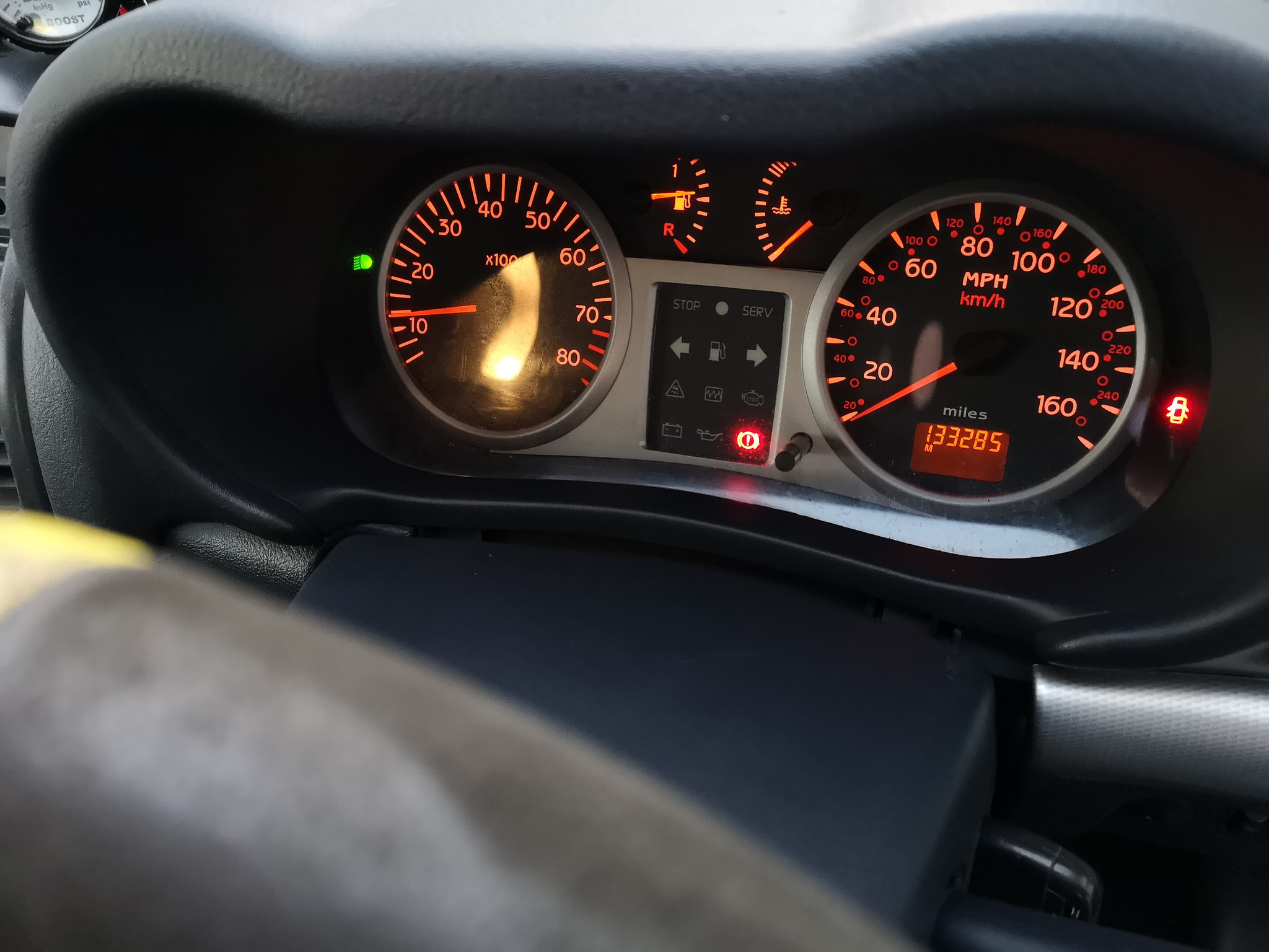

I also fitted a voltmeter and USB power point in place of the cigarette lighter. It actually gave me evidence to check the regulator before replacing the alternator as it was blinking up to 14.4V and other clues said to double check. I popped a new regulator on and voila! Fixed! Much easier than messing about with the pulley tensioner...

I did have an issue reappear that I had forgotten about, totally forgot I had the part to fit to fix it! The ESP and SERV light came on, common issue...the brake pedal sensor needed replacing or calibrating. I've replaced it now and then the ABS/ESP/SERV light came on which is a sign the sensor is set up as too sensitive. I think I've got it correct now but I'll give it another test tomorrow :)

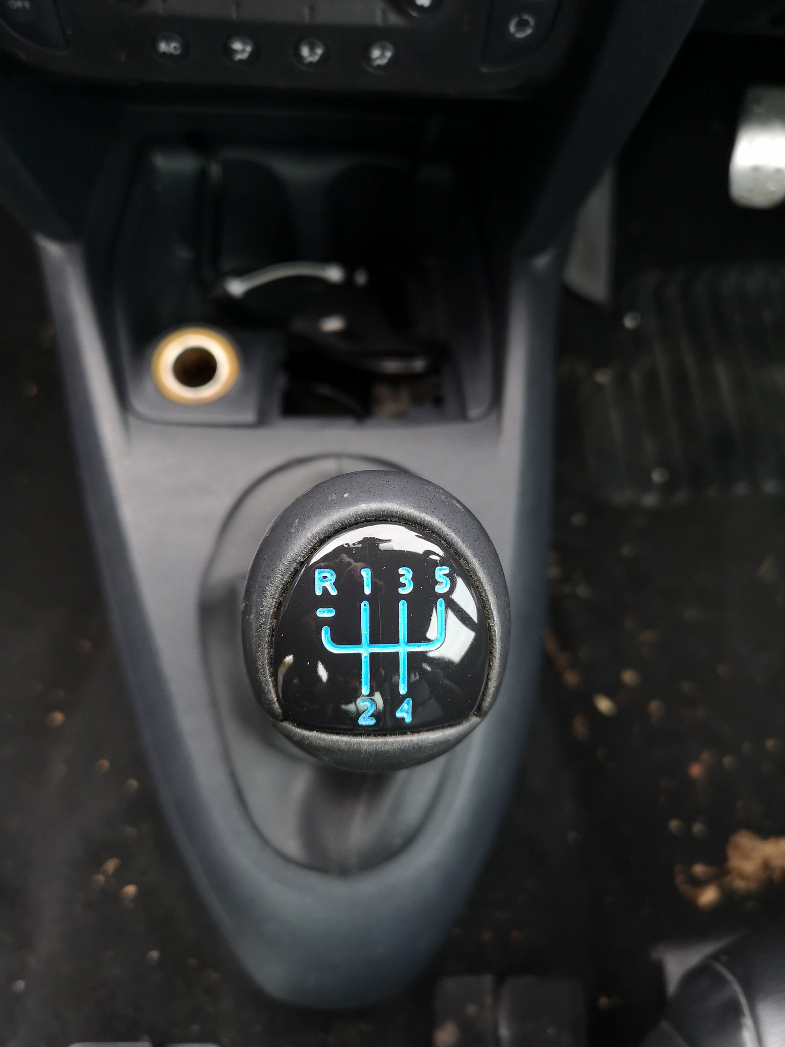

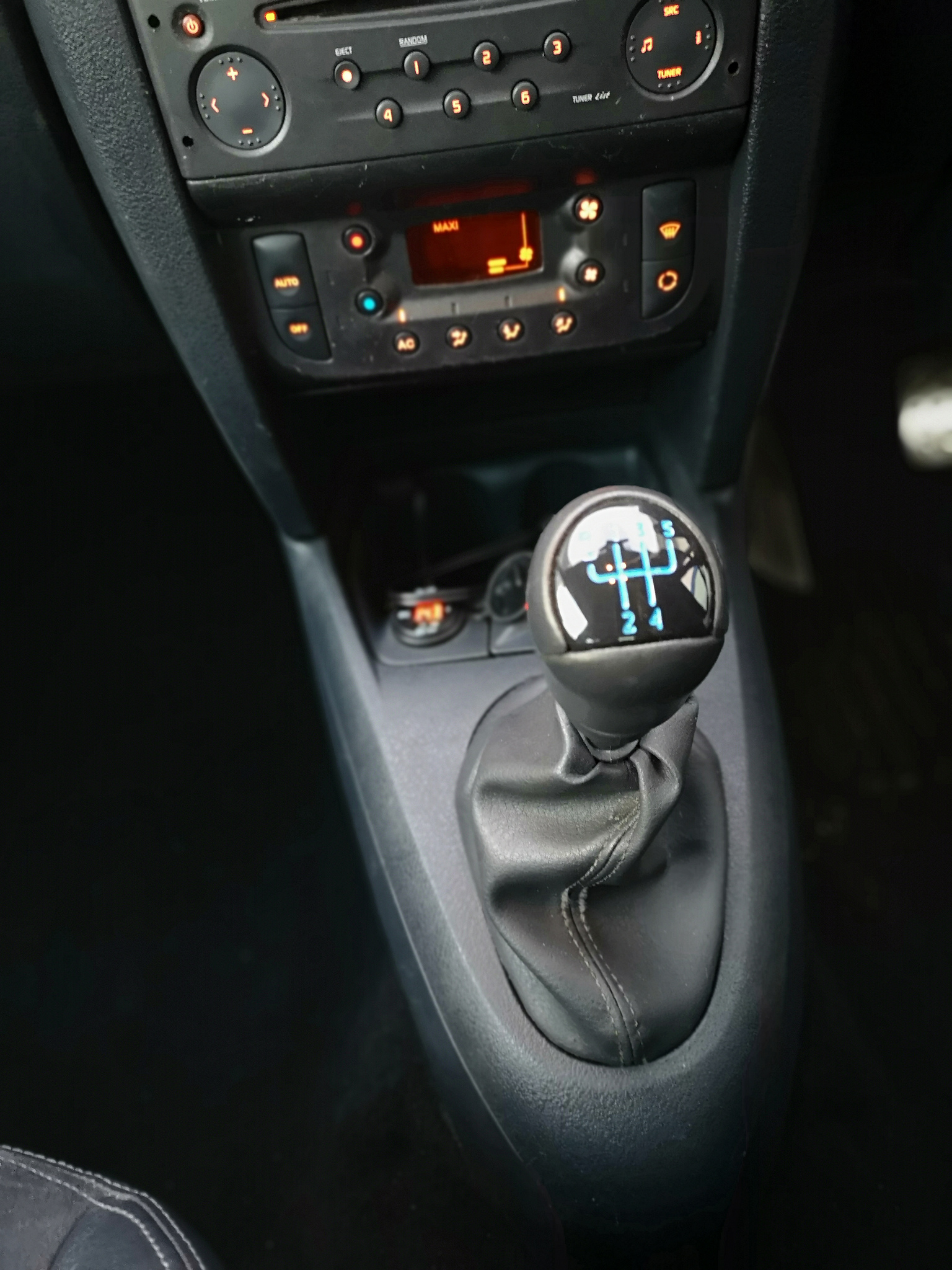

I also fitted one of my two new gearknob caps, I got one specially for this car to the same color:
IMG_20181122_133439https://www.flickr.com/photos/27957459@N04/

I removed the cigarette lighter and put in a voltmeter with USB charger instead:
IMG_20181213_155700https://www.flickr.com/photos/27957459@N04/
It's nifty! I could see there was an alternator issue and this helped me trace the issue to a worn regulator, which I replaced with a new set of brushes and it's perfect again :)

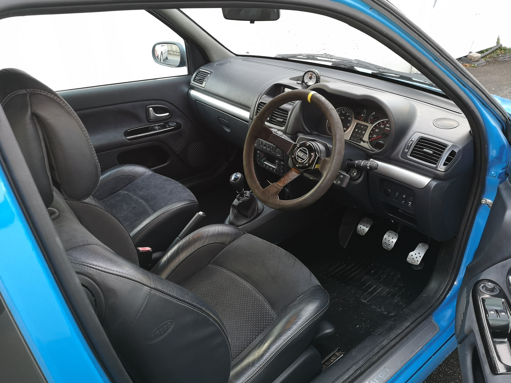

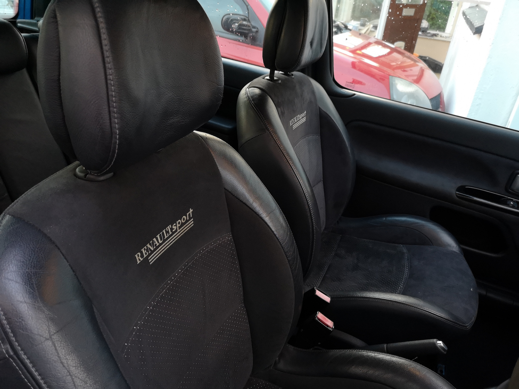

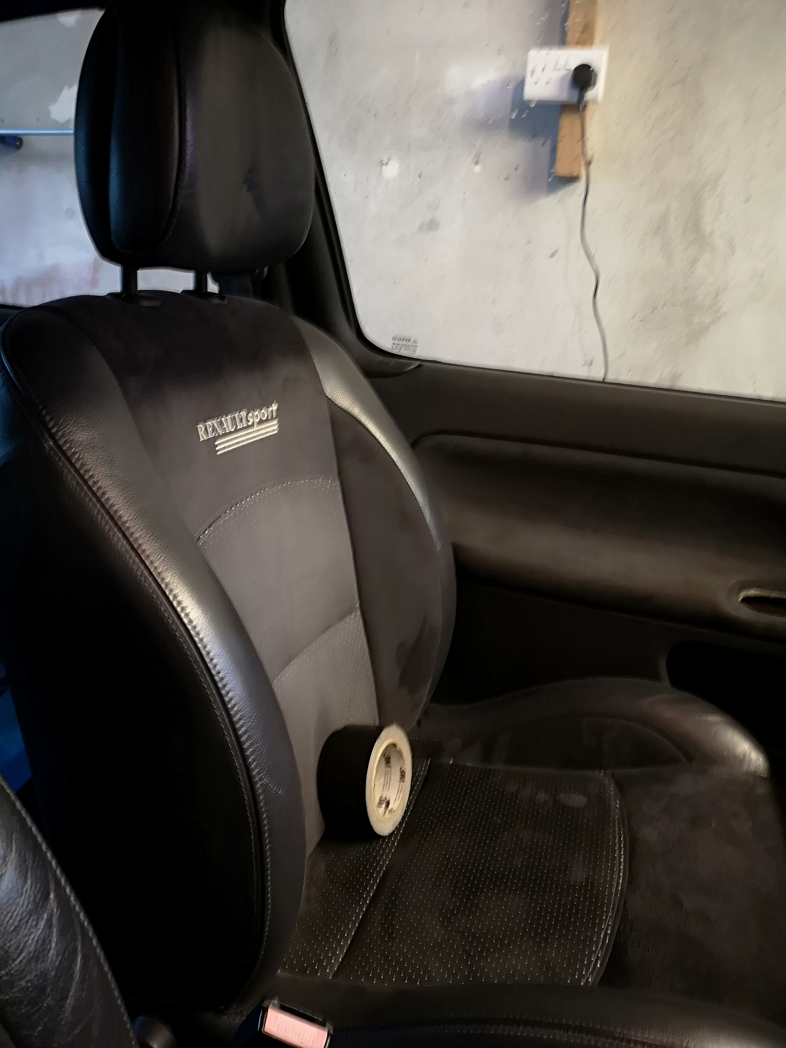

I've also refitted the RS interior, having removed the RX8 seats. They were bloody heavy! The classic airbag light issue haunted me for a bit even though I could see the previous owner had used resistors to solve it. I took the resistors out entirely and used my CLIP to remove the airbag hardware from the ECU so it ignores errors. With the seats back in it is possible to wire it all back in but as it has a Sparco wheel, not much point right now.

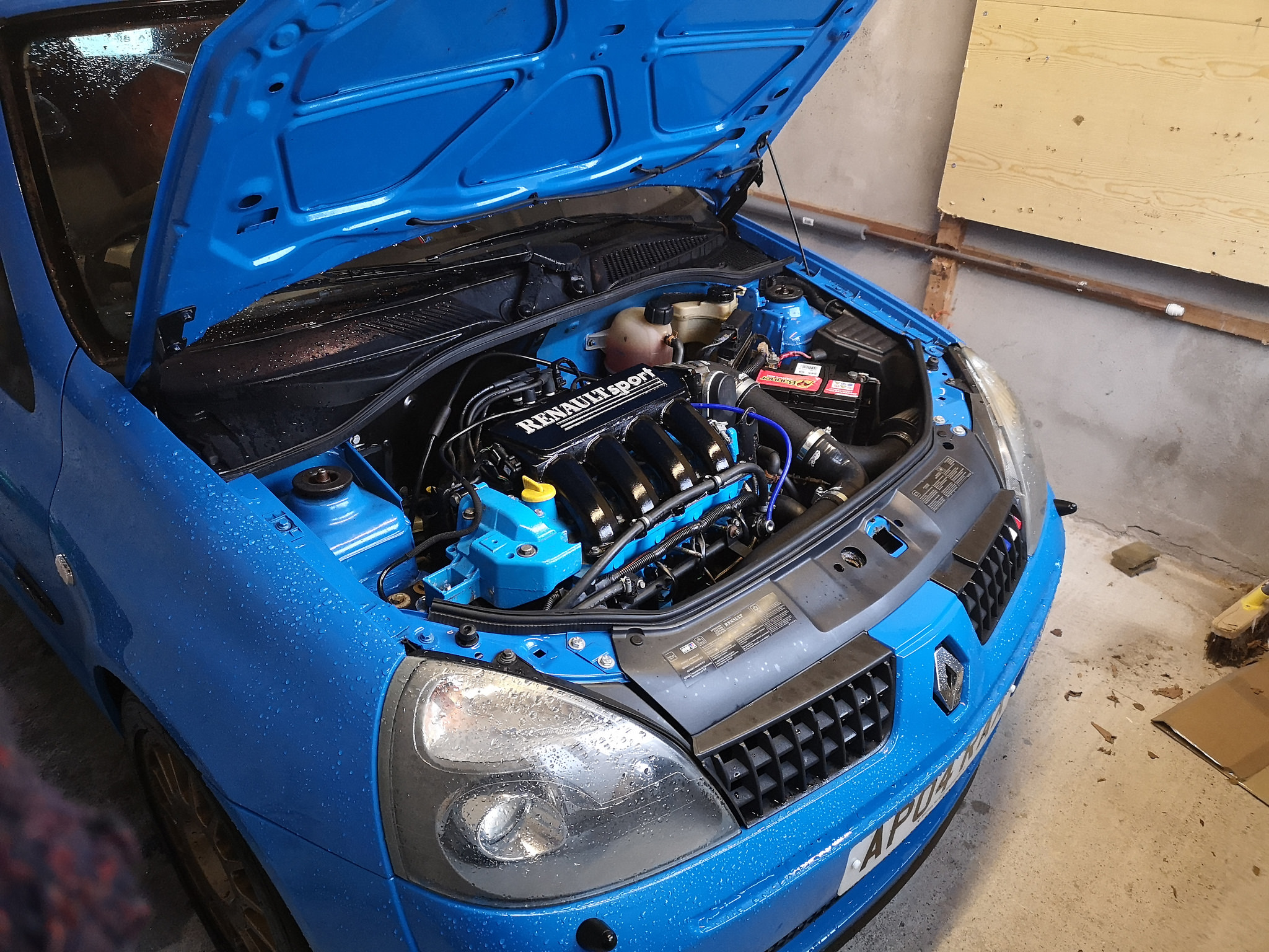

I've tidied up the engine bay more as well, but forgot to get pics before the heavens opened again. Any visible areas that were corroded are mostly cleaned up and black or pastel blue now.

So, now, the only niggles with the car are a slightly knocking turbo downpipe, tracking needs fine adjustment and calibrating the brake pedal sensor as I get the SERV and stability control light and sometimes the ABS light on, which is due to the sensor either too sensitive or not enough! Getting it spot on is a pain but I think I've got it right now.
