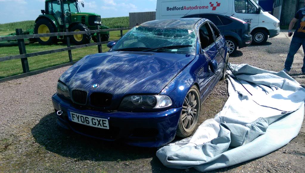

After crashing my Le Mans Blue E39 M5 in horrendous conditions, thanks to a failed DSC system and lack of skill when things start to go pear-shaped, I needed another car which was better MPG than both the Willy and M5 (both are pretty bad, Williams is okay in summer though). As I know my way around Clio's and have resources such as this website to draw upon, I started my search. As it happened my old pal 'Summeh' of WilliamsClio.co.uk fame was selling his. He drove from Kent in the middle of the night in his new toy to come and get me to see the car, after a night of debauchery out on the town in Maidstone lols :D Never too old!
Here is his new toy on the M25, on our way rather *cough* hastily to Kent from Southampton:

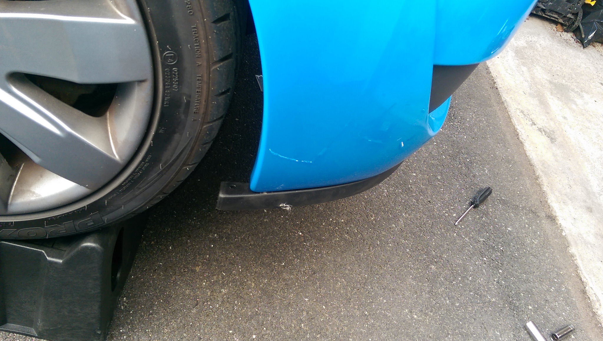

So, what else needed doing? Well the front bumper needs TLC. No cracks, but chips and scuffs all over. The nearside wing paint was going bad and there are a few parking dings, and one on the bonnet! These need to be removed.

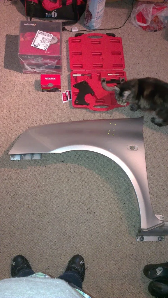

I also spotted a nearside front wing on Ebay in Titanium silver and a rear bumper, which I wanted to get to mess about with.
Kitty cat inspects my latest delivery. She always does this to make sure I've not been ripped off :)

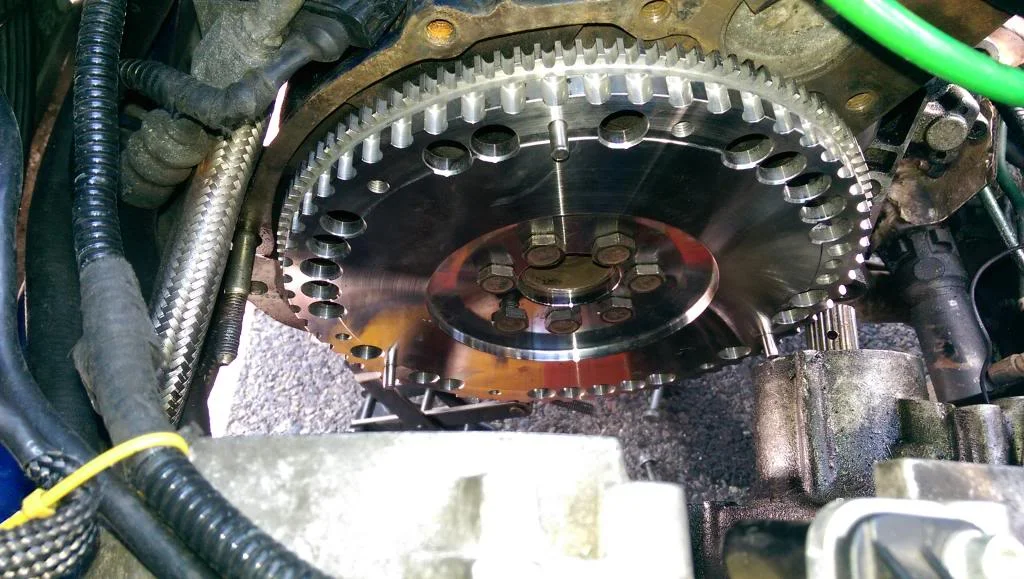

I got the dephaser from Ebay and the belt kit. I totally forgot I had a spare F4R cylinder head with a brand new dephaser on it lol. Oh well!

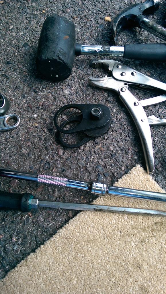

The red box is a kit of tools for the cambelt change, which I found out only partly fitted properly. The pin and cam aligning tool were correct but the pulley locking wasn't going to work. Fortunately, I've done many cambelts before and knew what to expect and how to improvise with the pulleys.

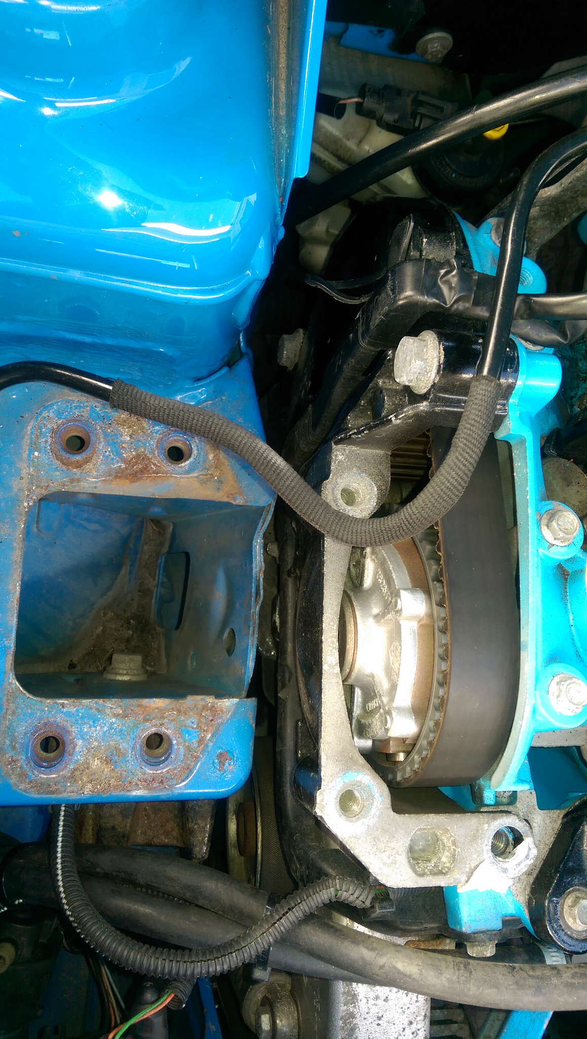

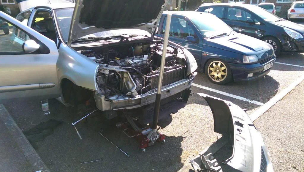

Work begins:

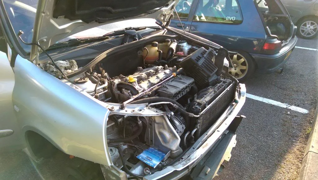

Using my really awesome hydraulic jack I get the car onto jack standsand get front wheels off. I only took the nearside wheel off to make removing bumper easier and replacing the arch is much easier. Pop the inner arches away to get to the two bolts either side holding the front bumper on. Off it comes, carefully, removing the electricals and washer pipes before removing completely. Super jack under the sump. It's a two ton jack with a big rubber pad at the jacking point, so nice and safe to use for jacking up on the bottom of the sump! I got a two tonner for the M5, and this one has a super low saddle for the Williams and the Lotus Elise I'm going to buy as well :D Yey!

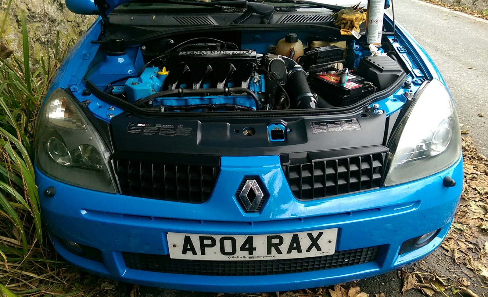

Intake manifold off, airbox off, HT leads out the way, electrics unplugged, plastics off, slam panel off, headlight out, jack engine a little, remove main nut on engine mount, jack up more, take off mount, injector alloy thing off (waste of space?), top cambelt cover off, pulley cover off, spark plugs out (helps with hand cranking engine to TDC and for final checking or valve clearance), pop end cap cam seals out with screwdriver (to be replaced) ready for D-shaped cam positioning tool.

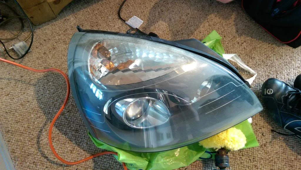

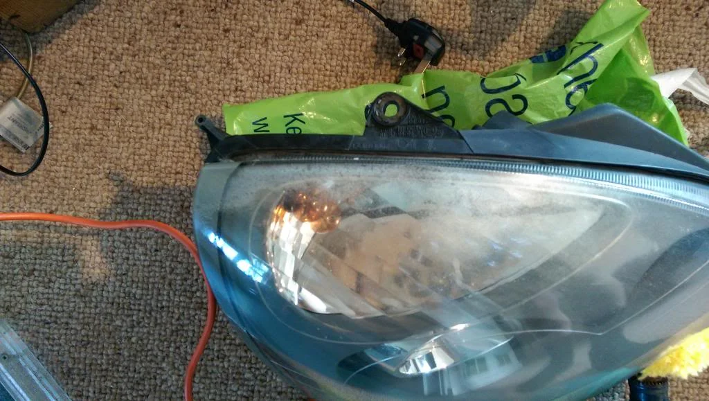

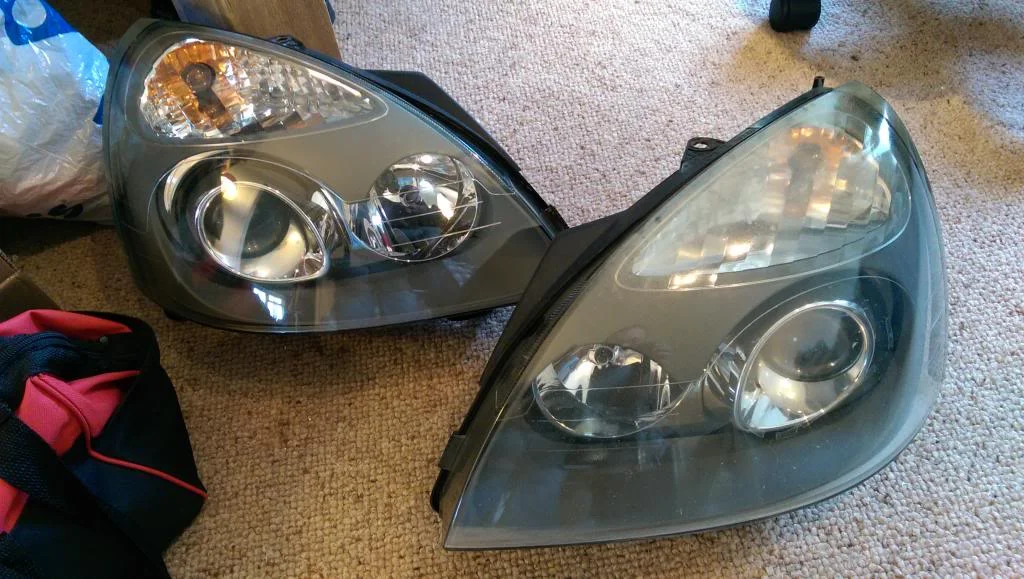

Got tired, left it overnight...but while indoors I decided to clean the headlights up a bit as they were oxidising a fair bit:
I think it would be easier to do with the headlights still on the car, but the difference was very clear to see. Excuse the pun:
Left OS done, right is still poop. I think I can do better, but that can wait for now as I had pressing things to do in the meantime!
Having done Mk1 cambelts, this was sort of similar but with the VVT and dephaser part, different too! I took my time as I had plenty and the weather was really good. I even got a tan! I wanted to do some other jobs whilst the car was in bits, and learn my way around the internals of the Mk2. Doing stuff like this gives you the chance to see things and poke about. I was really pleased to see the structure of the car is in excellent shape. Being used to Mk1's and R5's, shell rust and corrosion is normal, but I'm pleased to see that Renault have improved their construction techniques. The only rust was on bolts and the engine block itself.
Also, most things were very easy to remove. I would say though that there is more to take off to do a cambelt than a Mk1 Clio, so it is more time consuming, though I only had one bolt shear on me, which was a minor one thankfully.

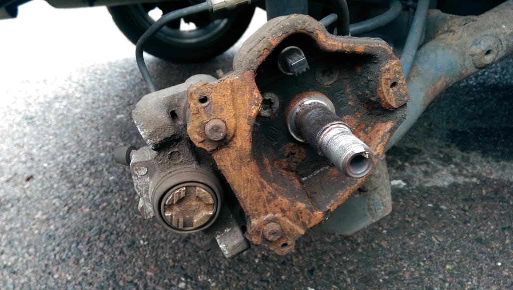

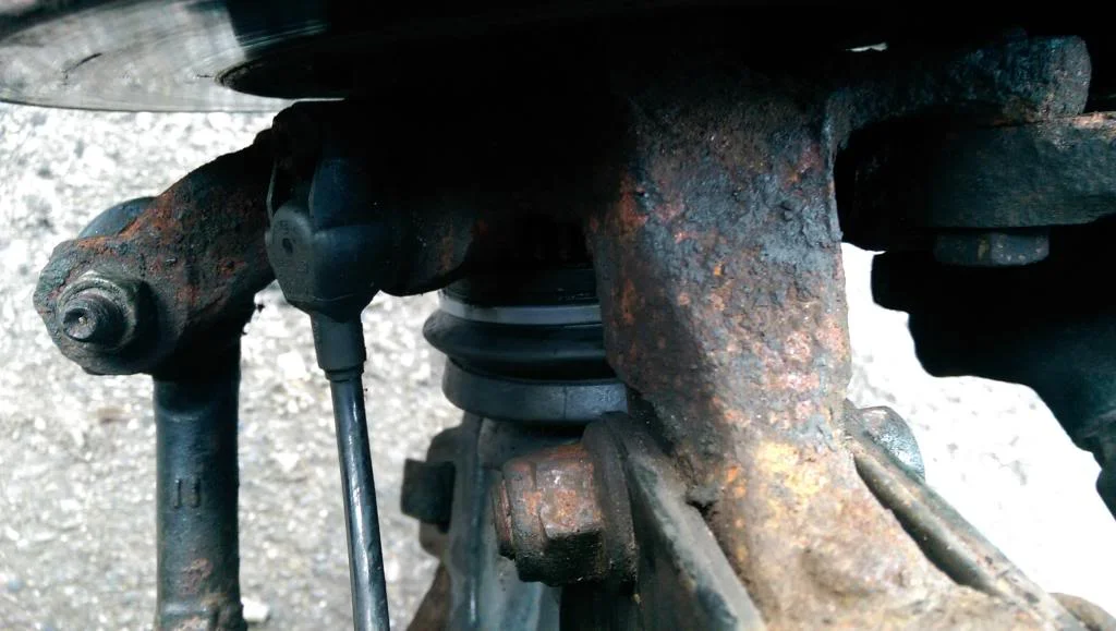

I spotted this however:

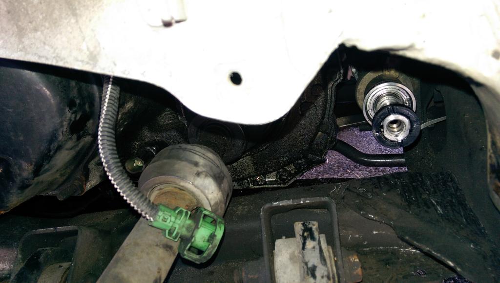

You can't really see, but the CV gaiter had popped off the CV itself, spraying damn grease everywhere. For those of you that have had the displeasure of this stuff before, it horrid and gets everywhere. I made temporary repairs, but I will return to this area again and also get my high pressure jet wash on it. It had coated the ABS ring and sensor, so I cleaned that up just in case. Horrid job. Luckily I had just done the CV on the Williams so I had a load of spare CV grease to put in before I sealed the joint.

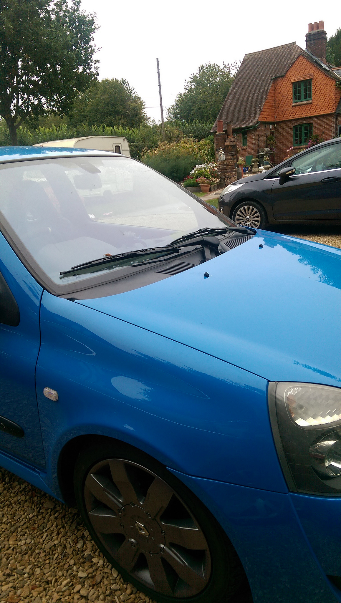

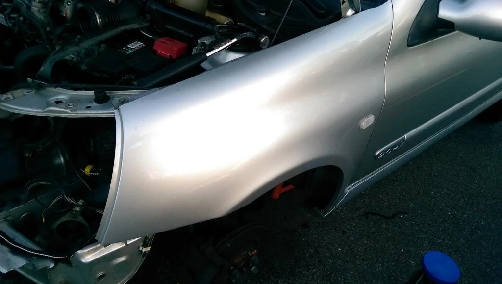

Replacement wing on:
The old one was patchy and the lacquer had gone bad in places. Much better with the replacement on :)

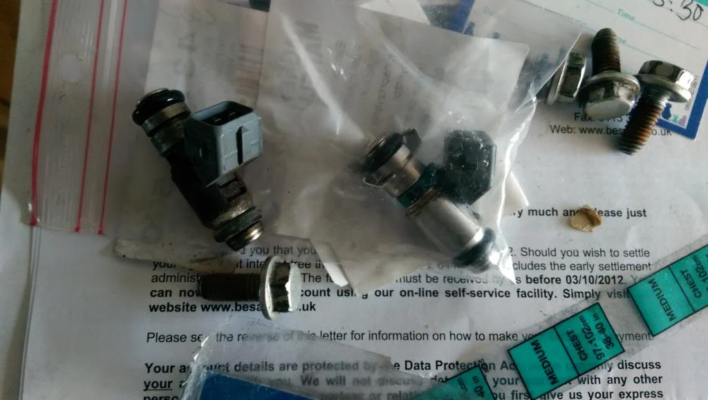

A new injector:

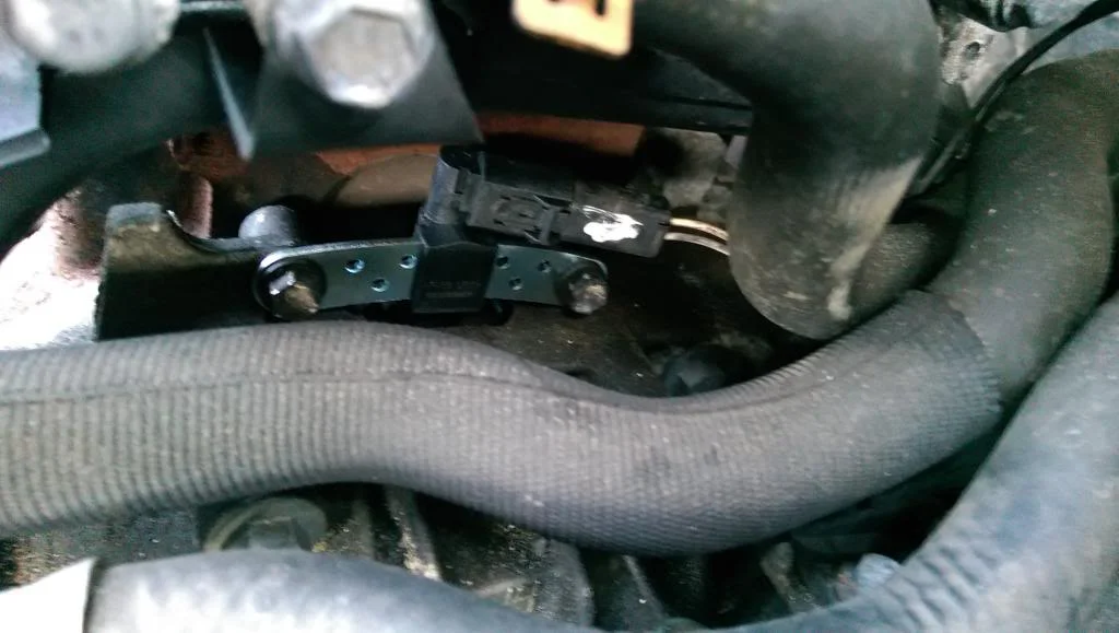

A new crank sensor:

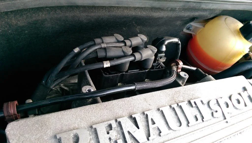

A new coilpack:
I got an email from one of the Directors where I used to work, he said a parcel had arrived for me and did I wanna catch up for a coffee and pick it up, rather than having to drive all the way to my old workplace. I said yes and popped over the next day on the bank holiday Friday. Had a chat about cars and what a tw*t my ex-boss is and grabbed parcel.

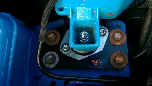

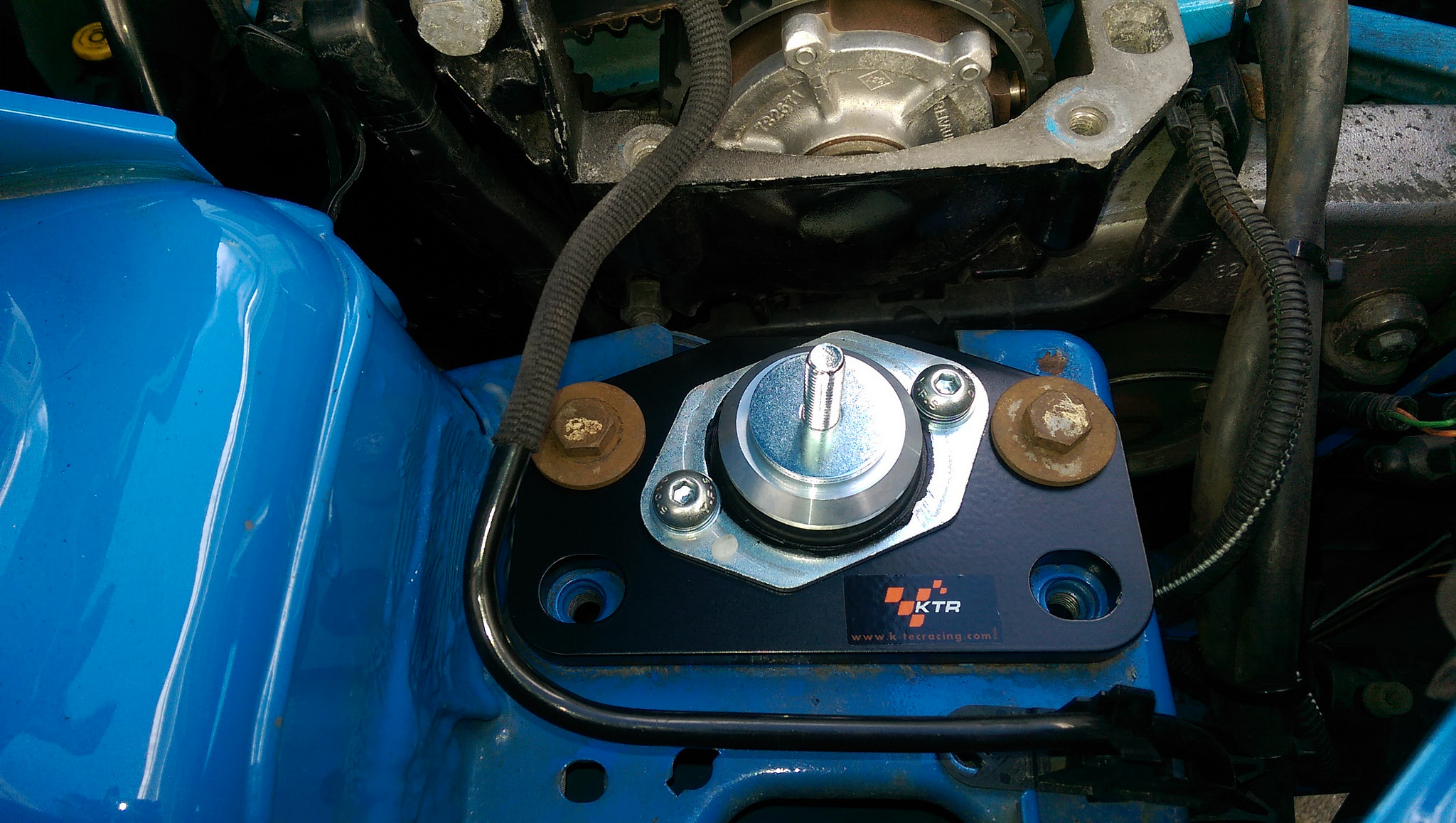

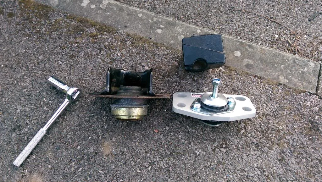

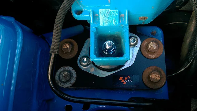

The parcel was a brand new Vibratechnics upper engine mount. I ordered it as I had gotted tired one night and totally forgot the old OEM mount was bolted in and jacked the engine up, ripping the rubber part in two. Doh! Oh well:
Guess which one I like more? Hoho. It is virtually identical I think the to the one in the Williams. As you can also see, I removed the stupid ballast weight as well whilst I was there. Big hunk of metal on the right side. there is one on the Mk1 valvers and Williams as well, but even bigger, as seen here:
Thanks for thinking of road handling and balance Renault. But...no thanks (bins).
I didn't get many pics, but I put the new cambelt on after slackening the pulleys and replacing the dephaser. Tensioning the cambelt is a lot easier in the Mk2 than Mk1 I'm pleased to say. What was a s**tter though was when I'd got the engine back together and pulled the D cam tool, I saw the f**ker was bent at the ends!!! BAH!!!!! I could hand crank the engine, but I realised after pulling that off that the timing would be off a bit. So, had to do it all over again lol. Was easier the second time.
Back together, and happy the timing was good, I started her up. At this time I'd not replaced the injector so it still misfired, but the engine sounded miles better already. Popping the injector in removed the misfire completely. the idle was still low though when the engine warmed up...all the work had not solved that French gremlin, bugger!
I started to worry the timing had gone wrong, but I was SURE I had done it right and I triple checked it before putting it back together. Power delivery was ok at part throttle but there was clearly missing power and under load it would splutter and become erratic. I had confidence in what I had done so far and decided to look again at the electrical side of things. Diagnosis 1 was the precat lambda was f**ked. I replaced this with a nice new Bosch one and OH MY GOD the car felt SO much better!
But....the low idle persisted! And the odd hesitation. I could have just accepted things at this stage and driven it as it was, but I hate niggly issues so I carried on and finally traced a fault to the MAP sensor. The two sensors I had swapped over were fine, I suspect the plug itself or loom to be slightly damaged or receiving interference from another electrical source. Unplugging the MAP sensor transforms the car into a proper hot hatch. With the wiring repaired it will improve even more :)

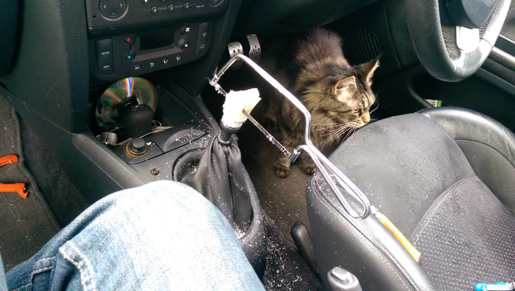

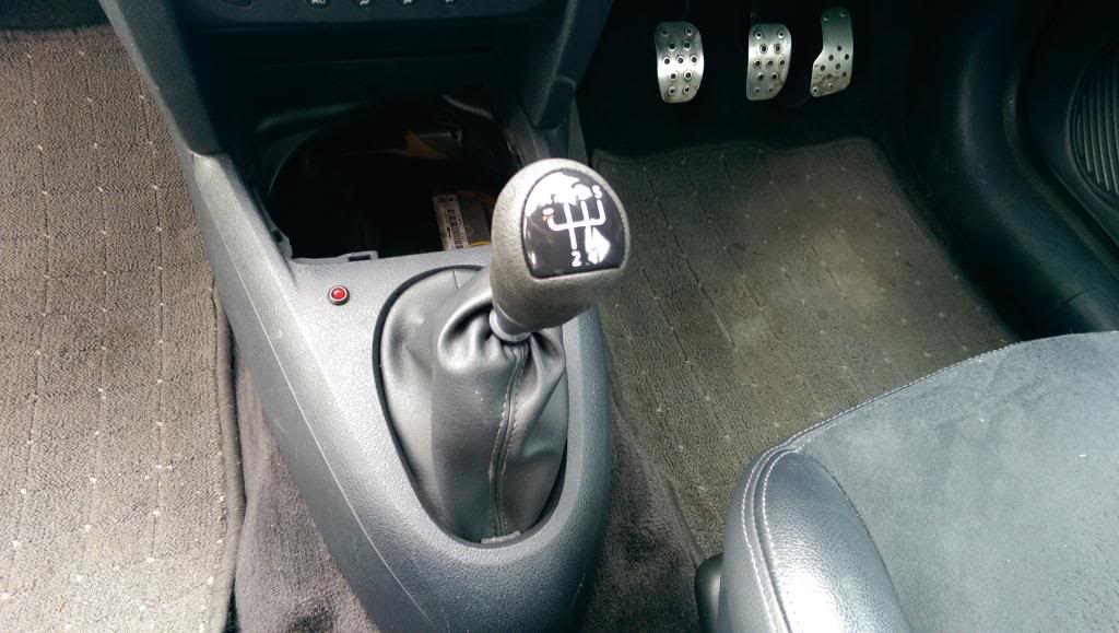

As many of you know, the interior of most of these cars are showing signs of wear and tear. Steering wheels, trims, door cards etc. Amongst one of the annoying items is the gear knob. Mine was worn out almost completely and as I hate silly things like this I ordered a replacement from my pal Schackal over on WilliamsClio. He does some items on Ebay, including gear knobs!
Removing the OEM section can be messy, and a pain:
Take the top number badge off, pull the crappy cloth exterior sheath off, and start ripping into the rubber. Underneath is a solid cage that is firmly stuck onto the metal gear stick. Nothing a hacksaw can't handle:
Makes a mess, and the smell of hacked plastic seems to attract kitteh kats!
Tada! Off it comes.
And...
On it goes! With a bit of glue added on for good measure :)
Much better!

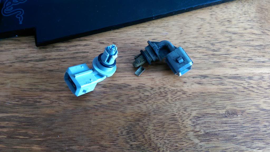

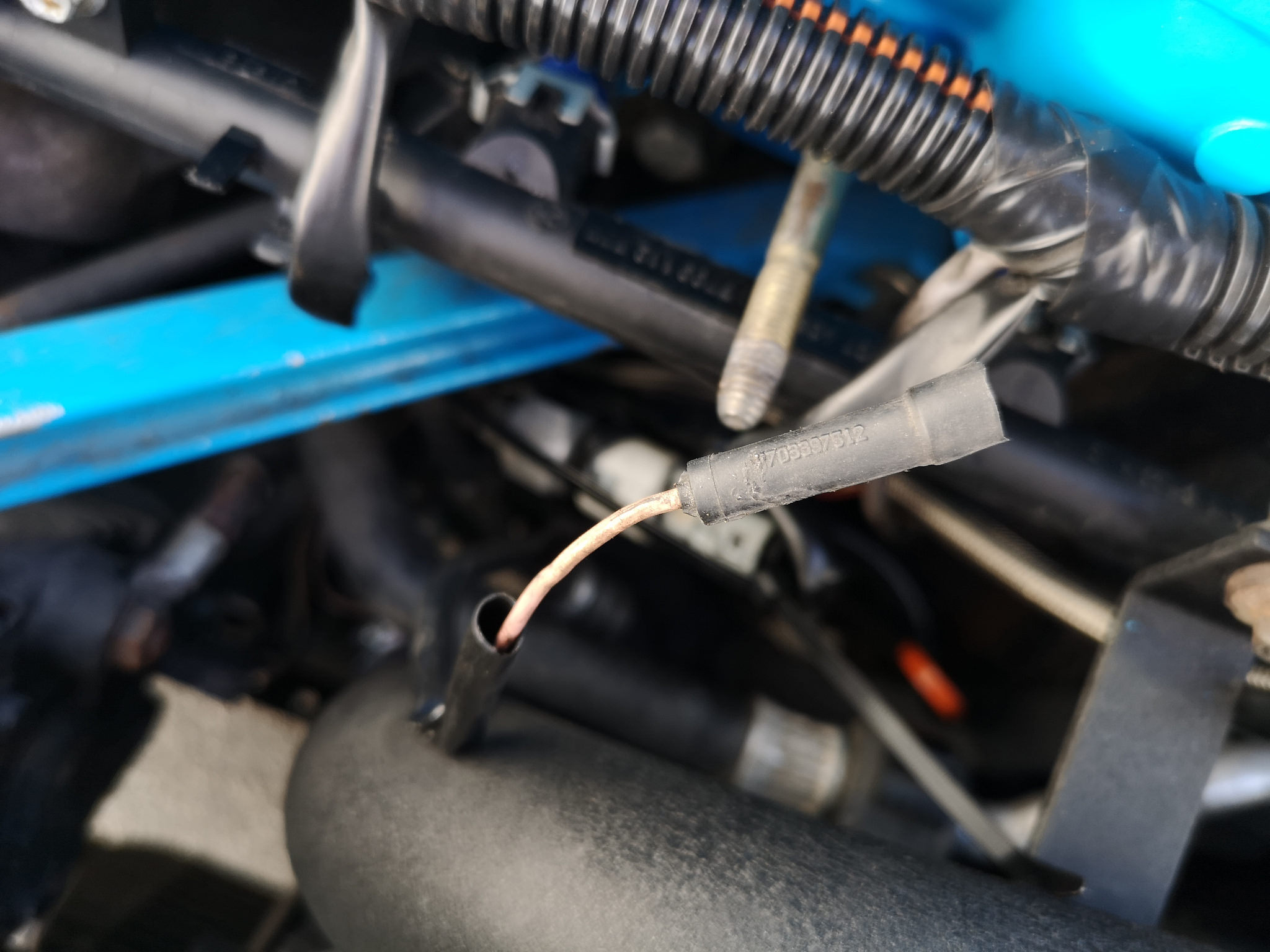

Also, GSF sent me an air temperature sensor. Gently pulling the old one out revealed a slightly damaged clip on one side, maybe damaged by me, but I managed to just get the broken plastic piece out before it got sucked in by the engine:

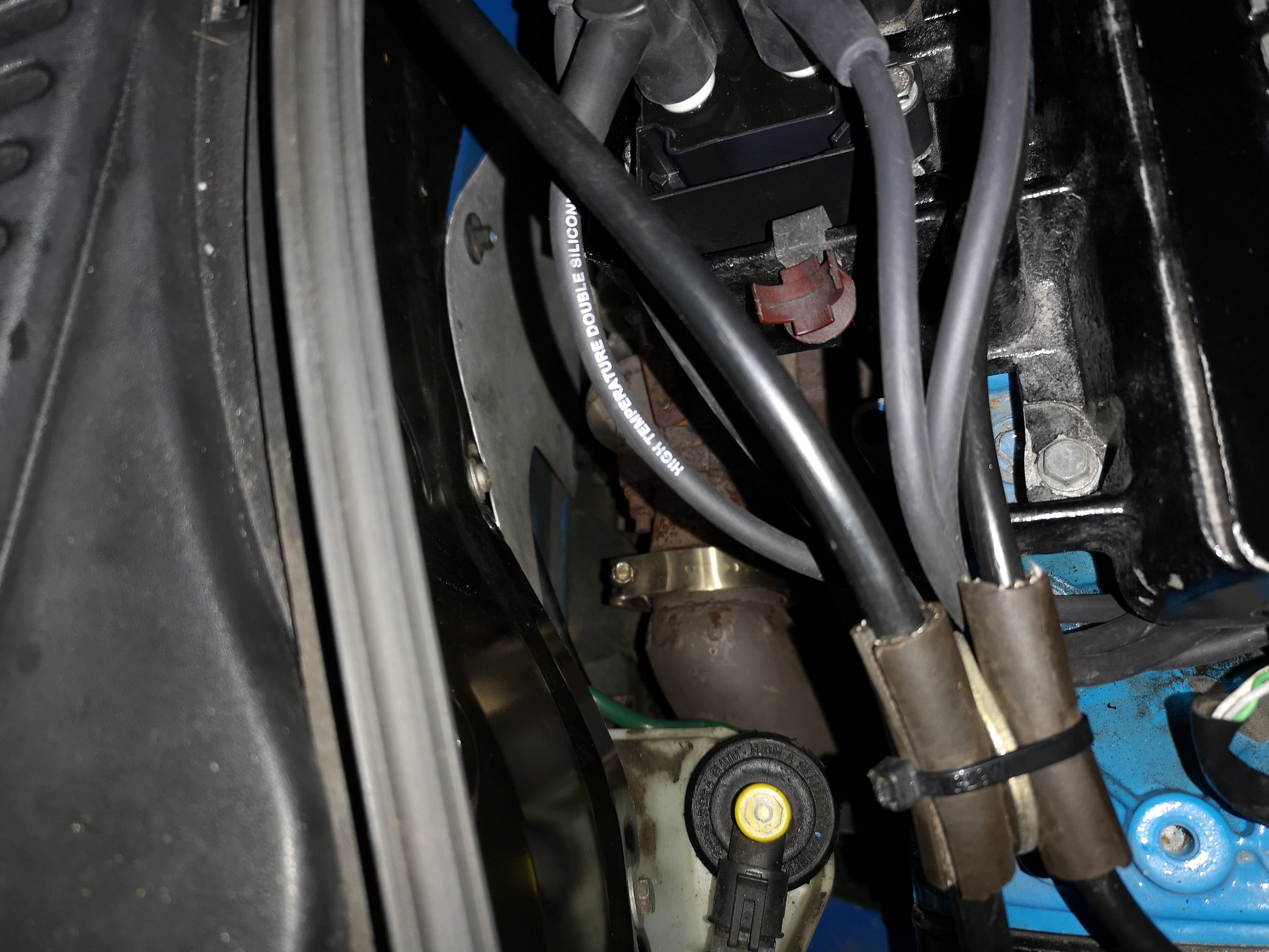

I also started to trace the wiring from the MAP sensor back to the ECU, which meant lots of pissing about with wires:
All I did was get my multimeter out and pop the plug on the MAP sensor, cracked open the end of the harness to the ECU and pulled back the pin shield thing:
From here, it's an easy test to check the wiring continuity, and see if there is any appreciable resistance between the three plug socket pins and the pins at the end which directly feed the ECU with data, feed voltage and earth the sensor. Really easy. I was expecting an obvious failure as the MAP sensor had been changed twice since the original one was removed, and I assumed there was something wrong with the feedback to the ECU regarding the air pressure inside the inlet manifold. Either that, or all the sensors have been faulty. I put the OEM sensor back in, which I had changed ages ago before even doing the injector and the lambda, just to see what happened.
The old sensor still caused a low idle, but normal driving was very good, and tonight's drive home from my pals place was epic, very responsive and far more like I would expect for a car like this. Handles damn well too :D No complaints there!
So, I messed up the wiring loom a bit and I will tidy it all up with new shiny stuff soon.

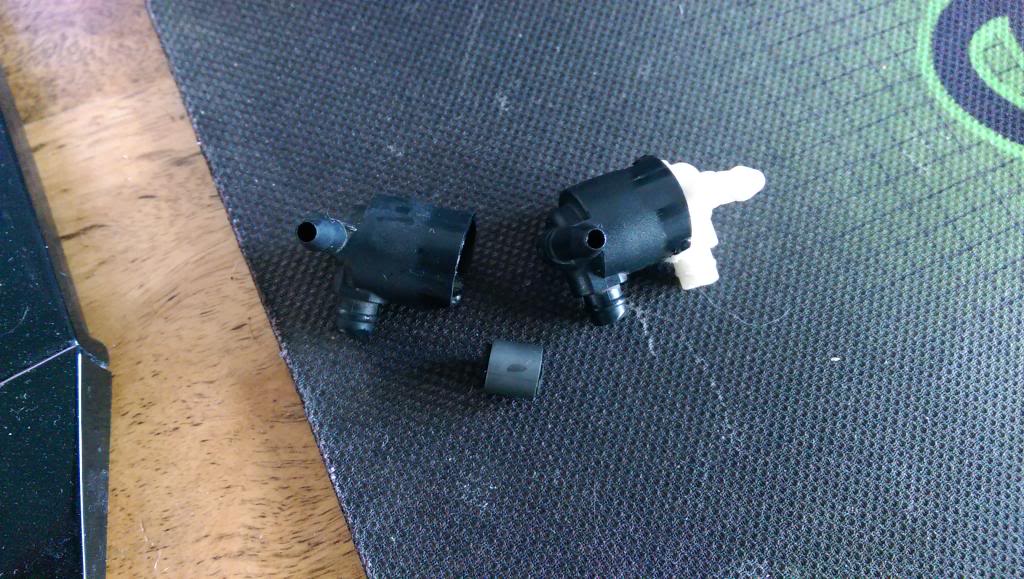

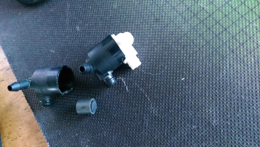

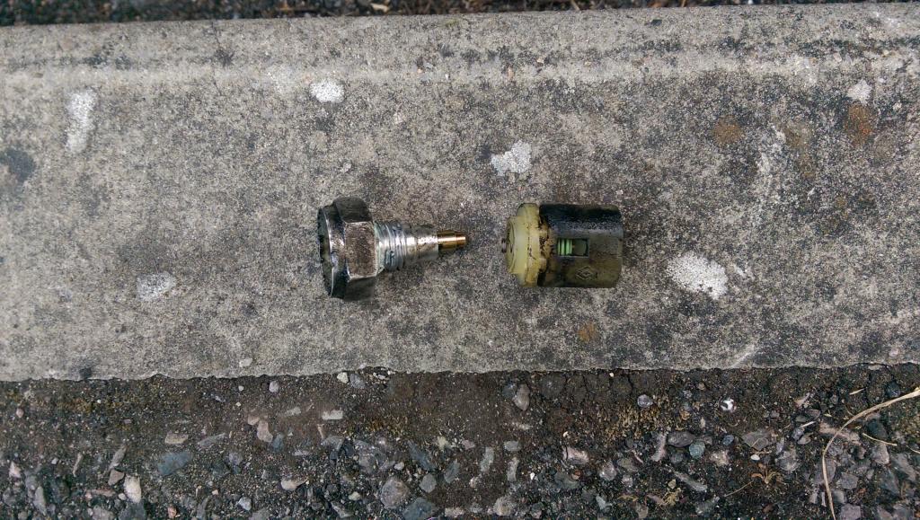

Another problem that had blighted the car not long after picking it up was the apparent failure of the washer jets. I already knew the jets were blocked nearer the pump end, but I could hear the pumps trying to work so suspected it was not them at fault. I did some research online and after some simple tests worked out it was the one way valves in the sections that are connected to the pumps:
See the little piece in the middle there? There is a rubber section inside and what happens is it expands in the water, over many years, and eventually they block the valve. I simply cut the expanded rubber off and refitted, and tested the jets.
Voila. Front and rear jests now working as intended, which is nice as I think without this it's an MOT fail? Not sure, but MOT is soon and this is one less thing to do :)

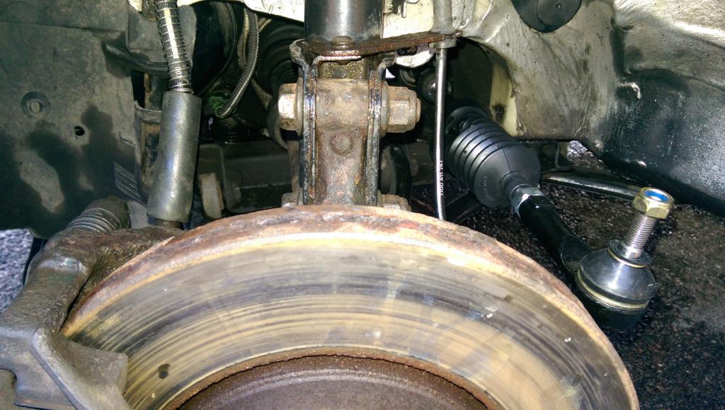

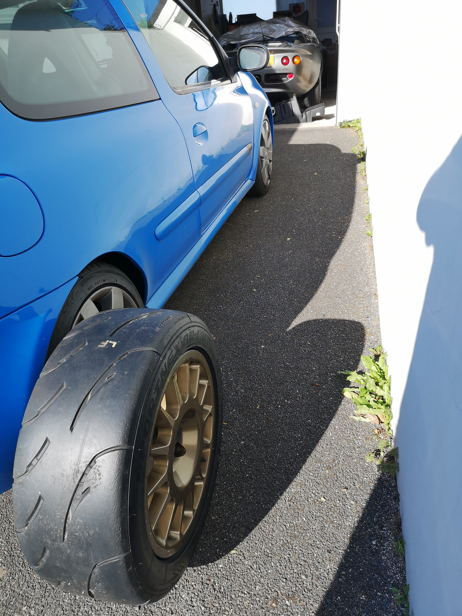

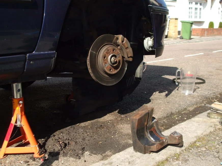

Various pieces arrived in the post for the Clio 182 since my last post. I had to get the car MOT'd as well. Sadly the car failed on a very bad blowing exhaust, a broken front spring and the pins that hold the rear pads in not fitted.

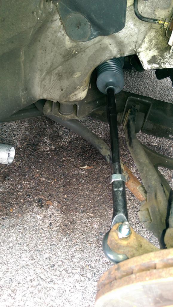

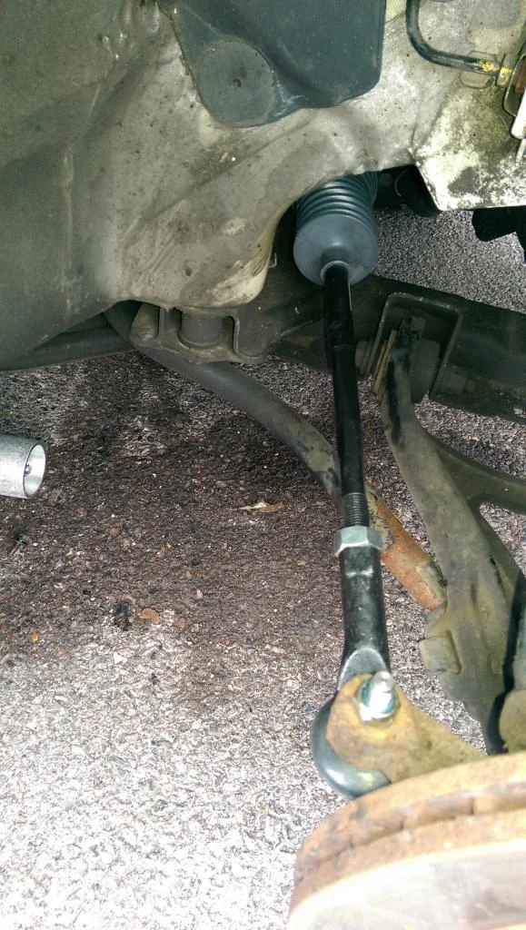

There was also an advisory on the inner track rods, which can be a b**ch to remove if you don't have the right tools. Luckily, I do!
I felt there could also be a bit of rear bearing noise and the rear brakes were shot to bits, so I ordered some discs with bearings and pads. Off came the old discs and gubbins:
I gave the sensor inside the hub a gentle clean as it was caked in crap. I wound the pistons back and forth to check it was moving freely too. All good. As you can see in the following pic, the rear pads were totally shot, down to the bare metal:
Meanwhile, kitty had managed to sneak inside once again and found her new bestest evar snoozing pad:
Nice and warm, safe from other kitties, and the parcel shelf is apparently an awesome scratching pad...

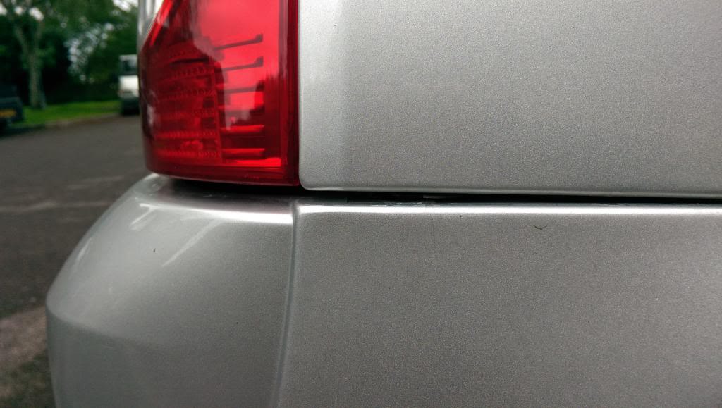

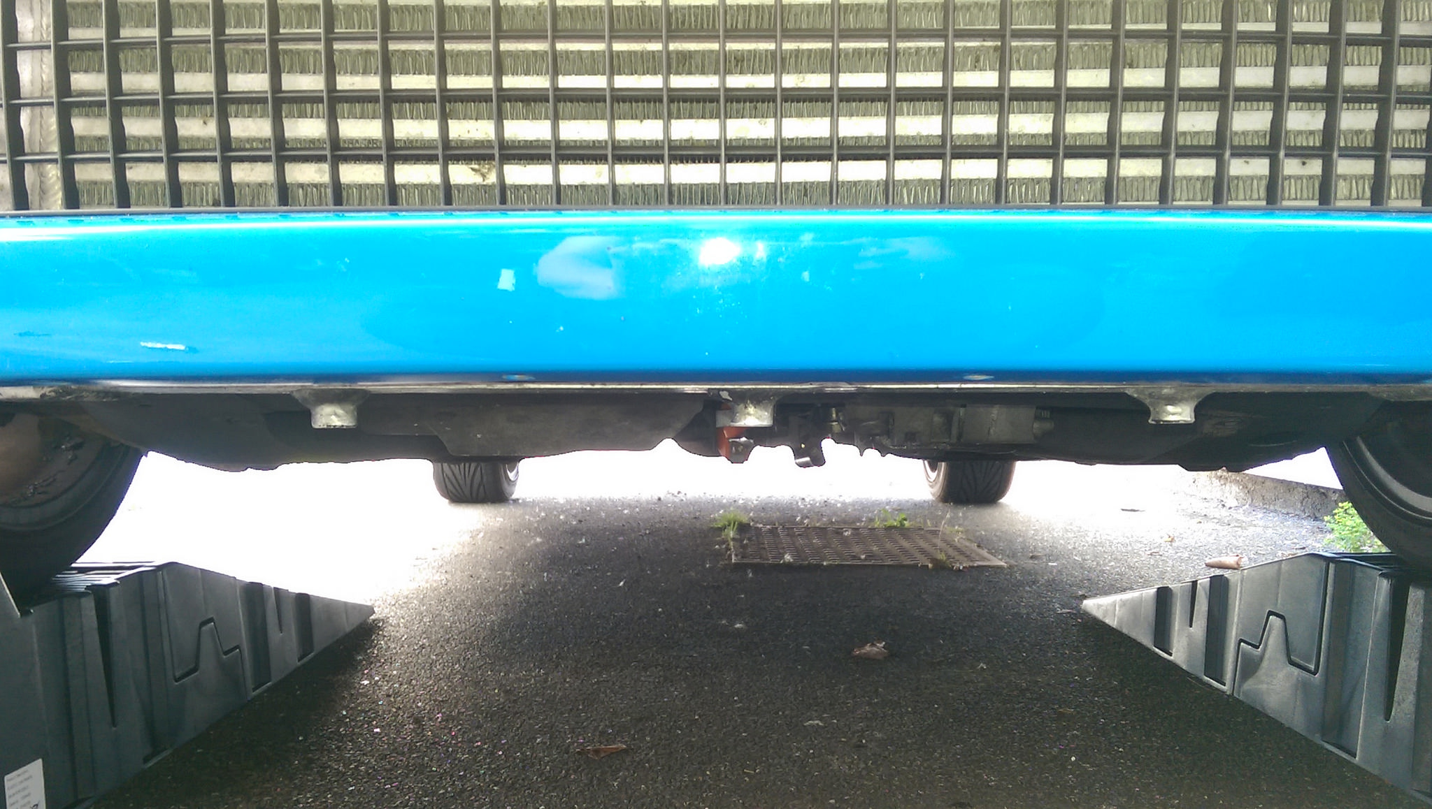

I spotted this gap in the rear bumper too, which annoys me so I will be fixing this in due course.
So, new discs and bearings and pads fitted, with new thingy pins too for Mr MOT man. No pics, but they are shiny. Onto the front springs. Piece of piss to get off, the top mounts gave me no trouble. Popped the spring compressors on and took the spring out of the drivers side front shock:

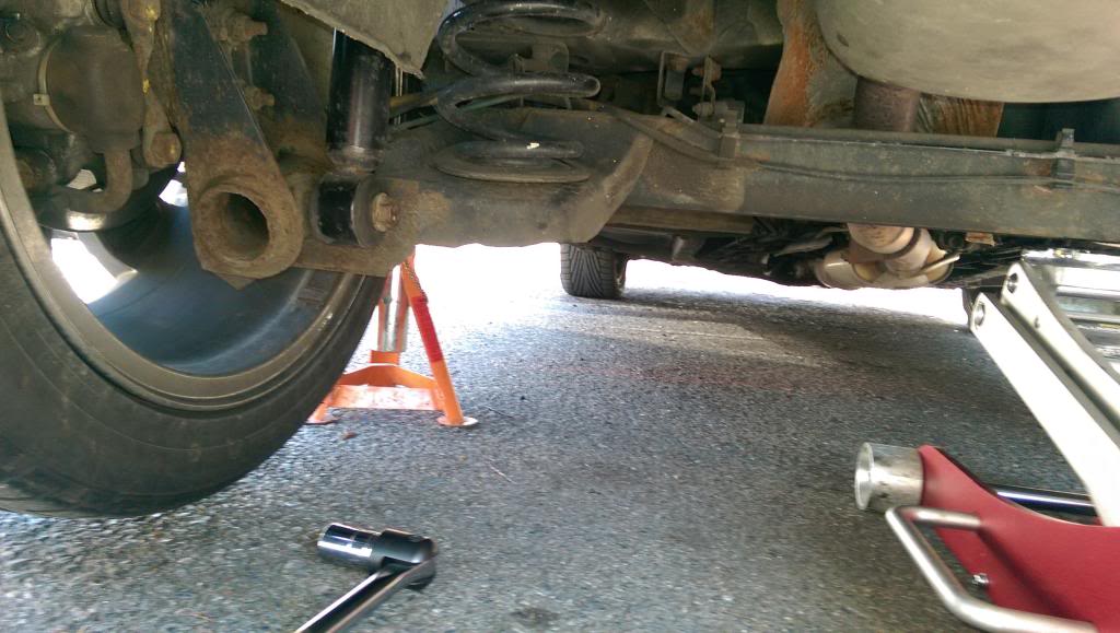

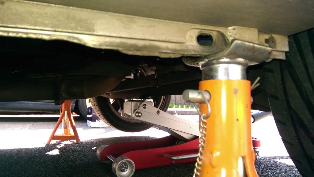

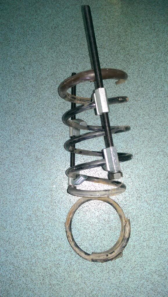

Yep, it's broken alright. One of the goodies I had ordered, as a temporary solution until I fit coilies, were some simple lowering springs as the car sits far too high for my liking! Popped them on and rebuilt the front struts. I didn't get pics at this stage as I forgot. Oh well. I then moved to the rear, which I did take pics of. I have seen a fair few requests for pics of how to jack and support the rear of the 182, so here they are:

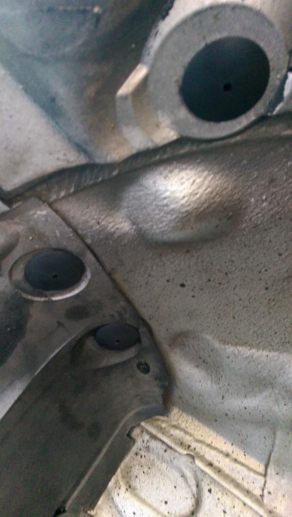

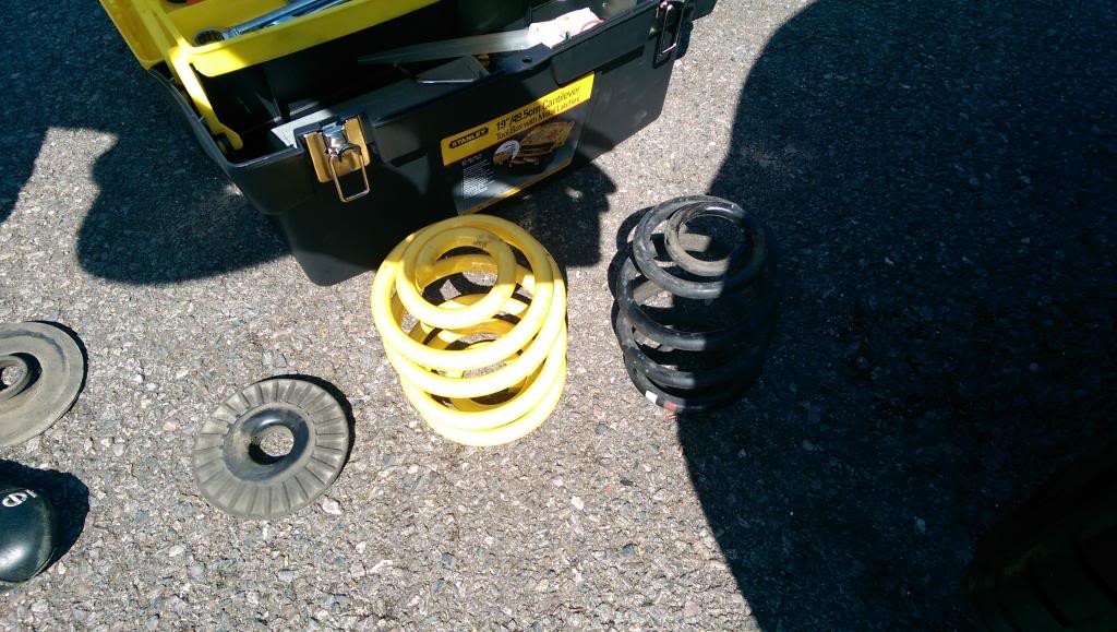

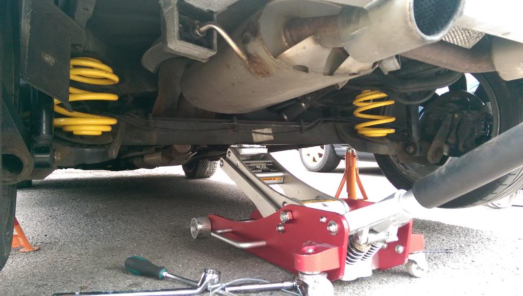

Jacked on the middle of the rear beam, I also put the car into gear to stop it rolling. I then placed the jacks stands and very carefully lowered the car onto them:
Tada!
To get the old rear springs out I just used a breaker bar and a 18mm socket on the lower bolts on both rear shocks. This allows the beam to drop even lower and you can yoink the springs out:
Guess which ones are the old ones? :)
In they go:
Easy.
One thing I have noticed however is there is a bit of knocking on the rear. I suspect the springs are not high poundage so allow the beam to bounce about too much, or the springs are moving a bit. I'm sure I could solve it but I've had my hands full lately!

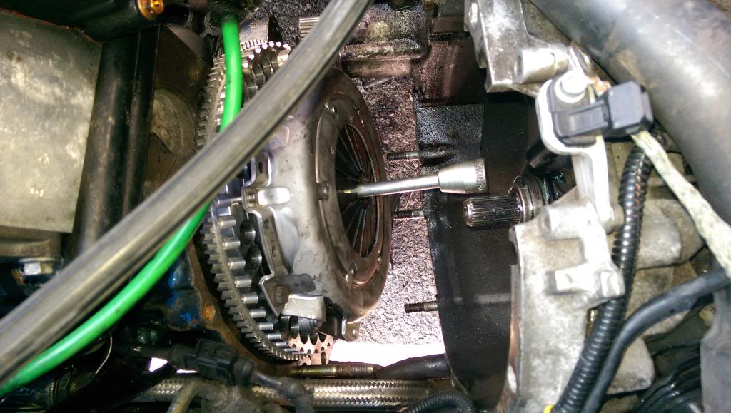

At the same time as sorting the 182 for the MOT, I had to get the Williams right up to tip top working order for a trackday at Bedford on the 19th May. The previous week I had felt the Willies clutch slipping, and I wanted to fit my new lightweight flywheel, specially made for a Williams but with a 60-2 trigger pattern, which is what my Emerald ECU uses. Because the flywheel is not a Megane one any longer (Mk1 Meg uses a 60-2 trigger pattern as normal, Willy does not), I had to go back to Willy size clutch. Doing a clutch with the engine in the car can be a pain in the backside, especially when Williams decided to break the bolt retaining cages on the rear subframe bolts...and then when I was moving the car into the place to do the work a fuel line sprang a leak too! Just to make things even worse, as the gearbox came off I caught a brake vacuum hose and pulled it out of its special clamp thing. Argh!
Anyway, here are some pics of me having no fun doing the clutch and flywheel. Took quite a while as some of the bolts were not budging:
New Flywheel
New clutch and cover:
See the bolts holding the cover on? They turned out to be too small. The people that made the flywheel had used a bolt one size bigger! I kept thinking the bolts were mis-threading and started to panic I'd damaged the flywheel threads. I finally tried a bolt I had in a set from Halfords. Thank God I had them as they fit perfectly! Hooray! I was one short so I had to veeerry carefully hacksaw another one which was a bit longer, but exactly the same otherwise. I did not want to imbalance the flywheel.

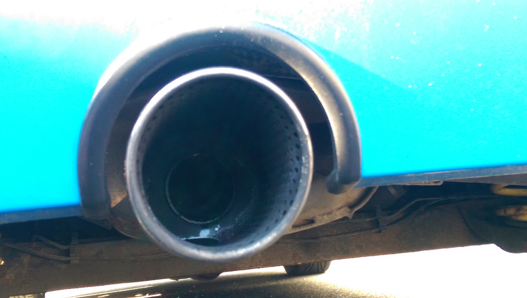

Decat makes a huge difference. I'm sure you'll run with it all the time bar that 1 day a year!

Yes, the decat has really helped. I guess I will have to put the CAT on again soon for MOT :(

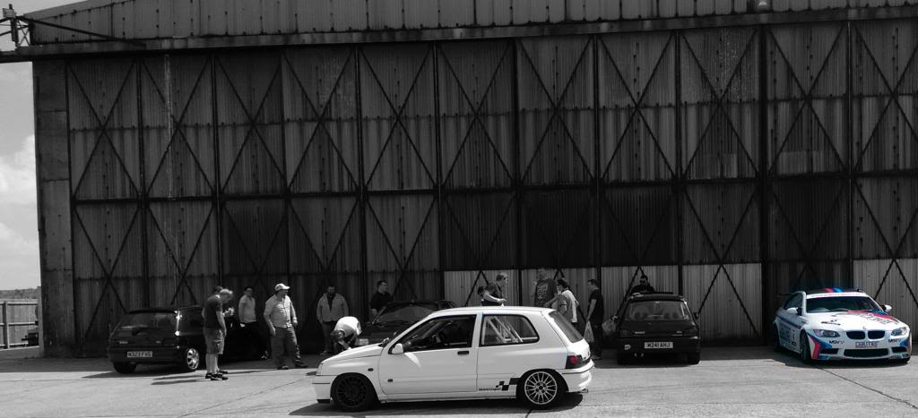

The Williams came with me to FCS today, where it sat looking good, come rain or shine, next to my mates V6:
Fun fun :)

I have a spare JC5 which was rebuilt a few years ago. It might actually be a JB3 but tbh I am not bothered as I am what some might call mechanically sympathetic with my gear changing unlike some of my fellow track day pals...so anyway, I used the Mk1 sensor and although it appeared to be longer it works absolutely fine. Another issue fixed for nothing...garages would charge some silly amount to have found and fixed it.
Whilst I was down there, another advisory was play from the inner track rods. To be honest, it was not noticeable when driving. I checked the car a few weeks ago and there was no play in the driver side but a tiny bit on the passenger side. The MOT guy at Halfords is known to be veery strict, but as he is a performance car nut himself I don't mind for things like this. These cars need to be tip-top as they get driven hard. I had ordered some inner and outer rods ages ago and decided now was a great time to do them. Some of you may know, inner rods are a pain in the butt to do. So hard to get off! However, having done them before I had a special tool which turns hours of work and swearing into a few moments of work:
Don't know what it is? Learn.
Offside done:
Nearside done:

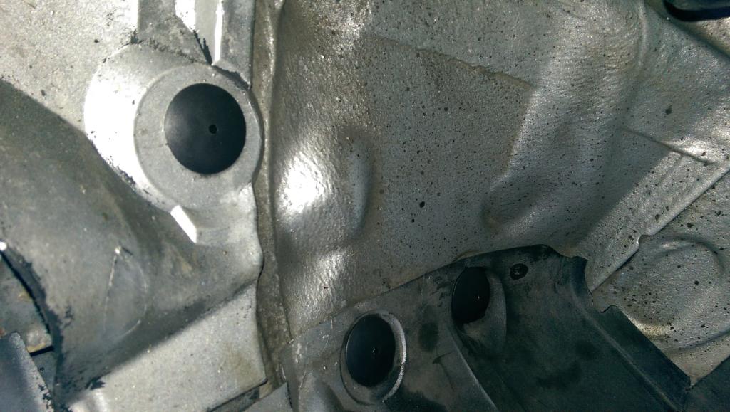

I had noted a load of old oil coated to the sump and bottom of the gearbox. This was from an old oil leak, fixed before I got the car. I later jetwashed the oil catch bottom engine cover and all the crappy oil off the parts below. Nice and shiny now!
As I had fitted the decat, I removed it and re-fitted the CAT. At the same time I ran the car with me under it to ascertain if there were exhaust blows. There was a a bad one from the CAT to mid section, but with a clamp I had spare and some adjustment I got rid of it entirely! Yay!

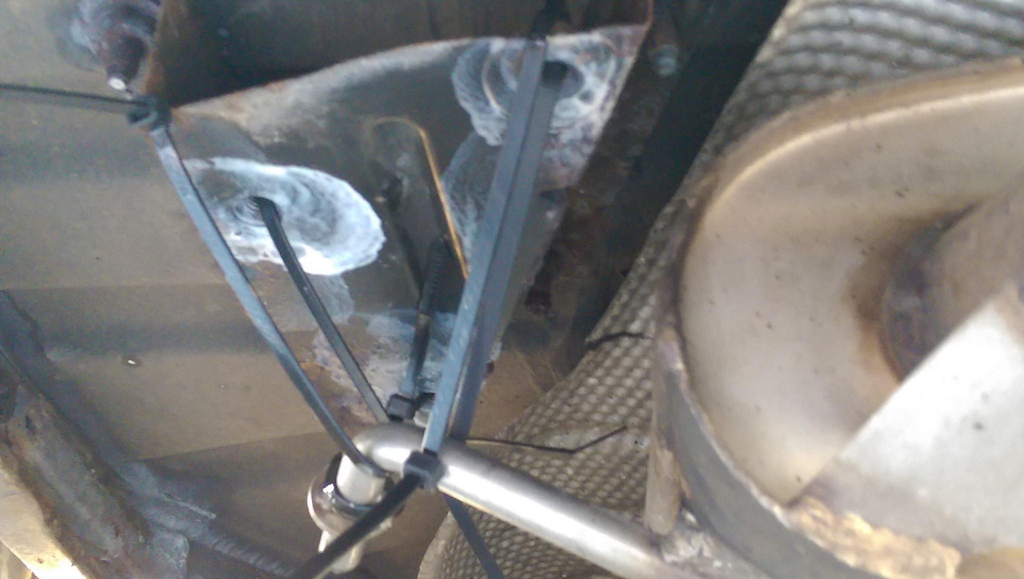

Unfortunately, when fixing the damn blowing mid section I inadvertently messed u pthe alignment of the rear tailpipes so I had to readjust these. Took AGES! The rear exhaust mounts are a known shitty weak point, so I have had to use cable ties. No big deal, and they will hold and pass MOT.

After the MOT I popped the front bumper off and fitted the Skoda Fabia splitter. I also pulled out the leaking Xenon washers and put the carbon washer covers on...pics to follow ;)

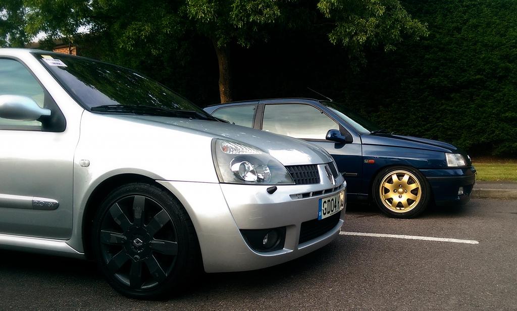

  Clio 200 RS EDC
Didn't even notice you had this Wobsta!
Looks pretty good next to TAC - although I know which I prefer ;) about time a decent willy came up for sale - all the ones I see these days are s**t boxes.
Hehe! Yep. I own a 182. It's a great car and I am impressed with the MPG too. I think I will give it a really good clean tomorrow and get some snaps whilst we have such great weather.
Of course the Williams is more of an event to drive, but if I had spent as much time and money with the 182 as with the Williams it would be a monster of a car.

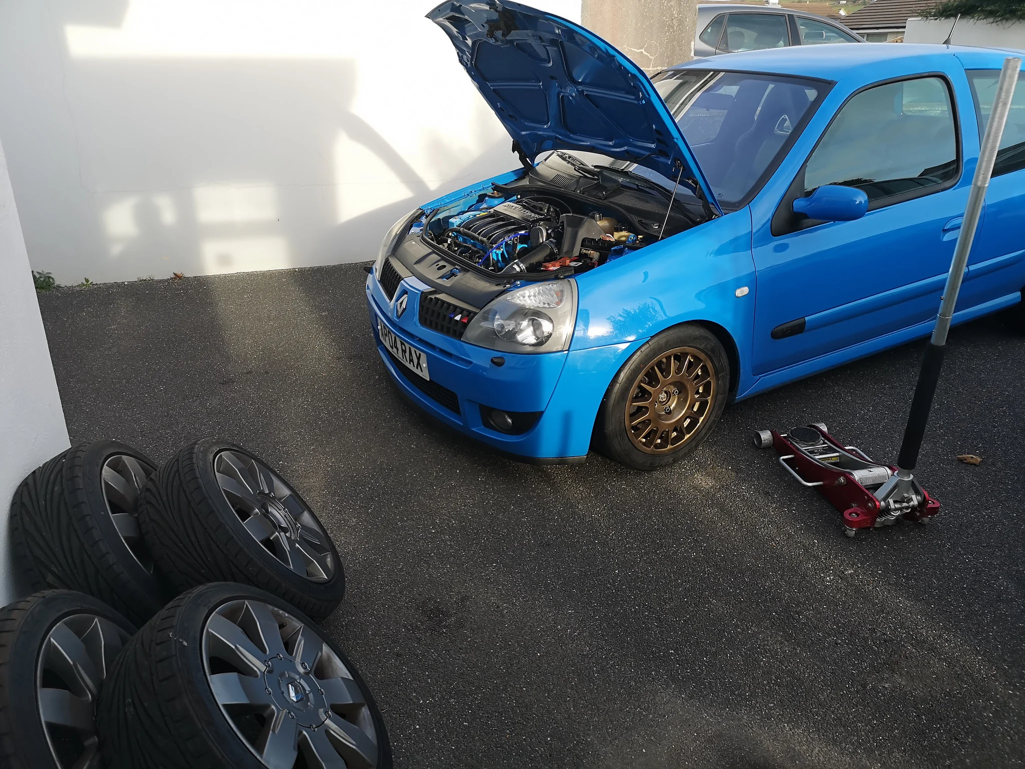

Track day rubber on 2118's.
IMG_20181020_124755

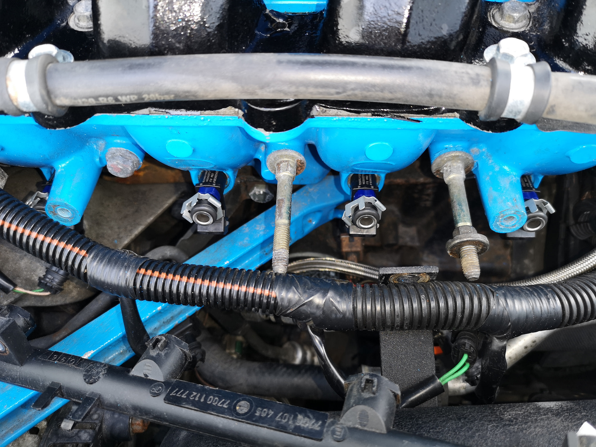

New 225 Meg injectors. I'll send the old ones off for cleaning.
IMG_20181018_135928

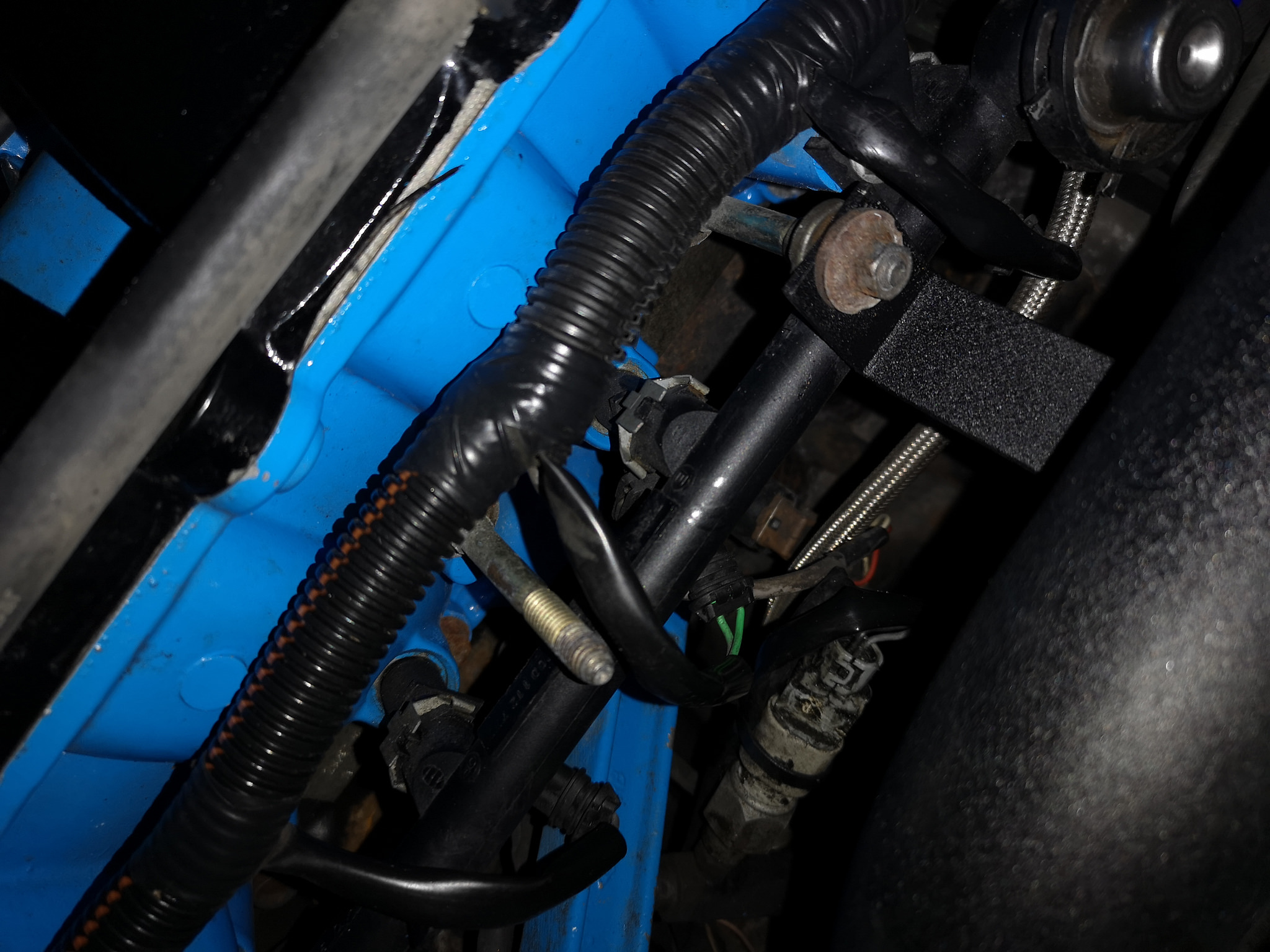

Power steering pressure sensor has an intermittent issue. Sometimes stalls when at low rpm and hard on the steering. New one on the way.

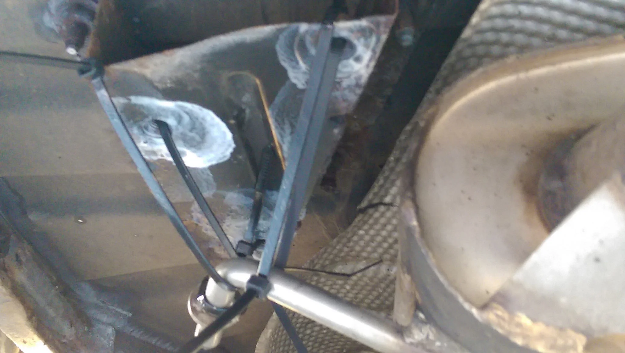

Sufficient, home made downpipe. Might replace it as it knocks, but it is beefy so may just try and adjust it off the turbo where the mikalor clamp thing is:
IMG_20181016_190049
Got new rear motorsport lightweight exhaust mount fitted after cracking the old one trying to fit Powerflex Black ones...
IMAG0077
IMAG0078 by Dan Mumford, on Flickr
For when Wobbamobile needs a top-up. Only the best for my cars:
IMAG0073
The mount I took off was almost brand new, but as there is extra turbo piping banging about on stuff I adjust how the engine sits a tiiiny bit and fitted a new main mount from K-tec.

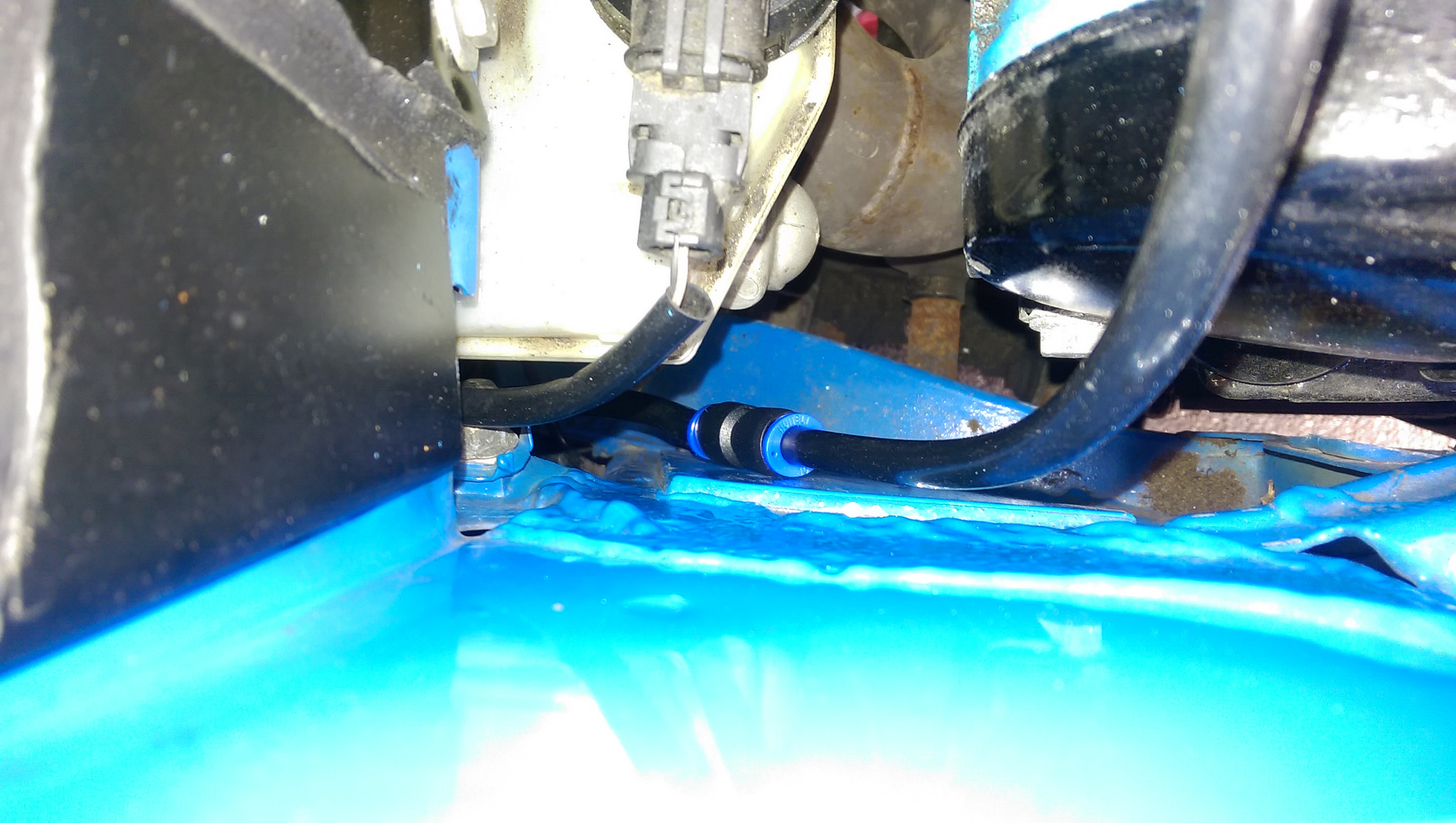

Found a minor air leak in the brake vacuum line. Used a new pneumatic push fit item to sort that :) Perffeccct fit.
IMAG0059

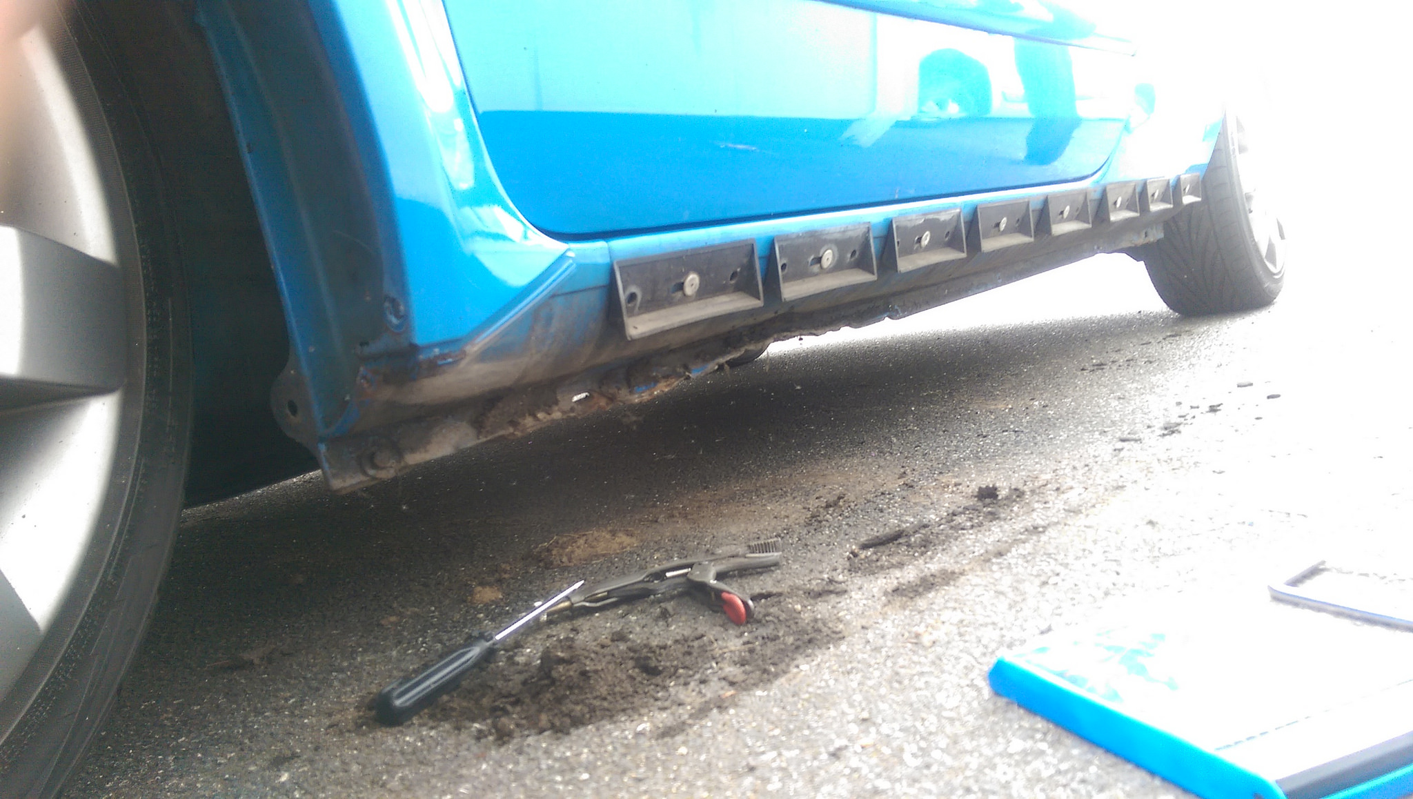

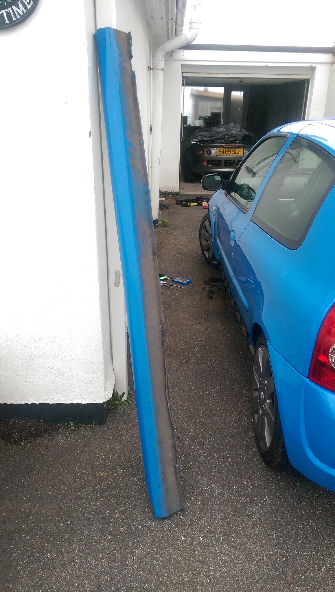

Skirts have been pushed out a bit due to grounding out on the sills...tut tut. Not to bad to sort though and the sills themselves are nothing like as bad as a Mk1 Clio would get :D
IMAG0051
Always the same with Clio's and many other cars...so much muck in the sills...weight saving pikey style :D
IMAG0053

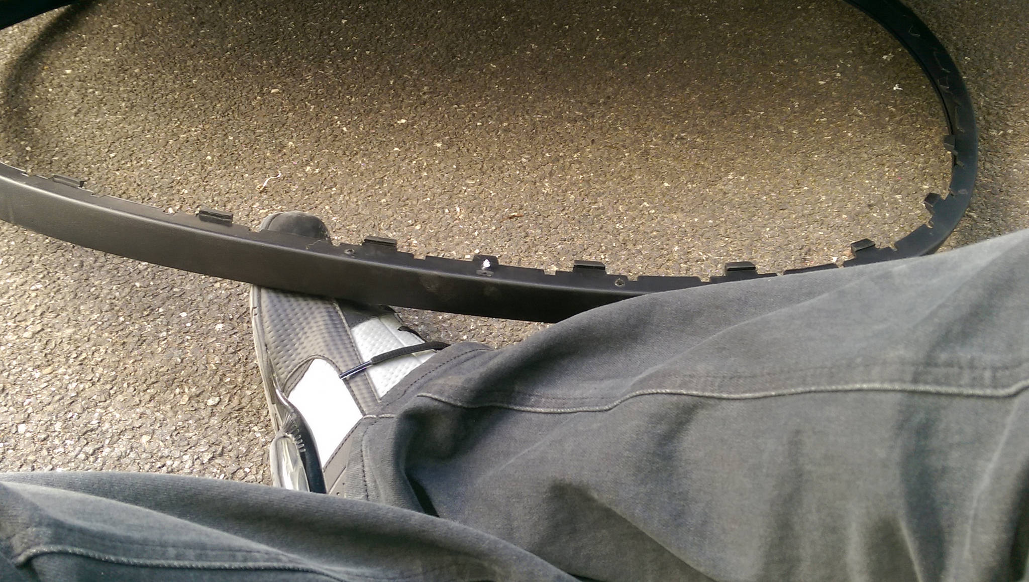

Hmmm...so, no front splitter :( I think one used to be fitted as there are holes there still from an OEM fitment. Can just see the Polybush dogbone I fitted the previous week in the background:
IMAG0062
I phoned the Skoda Gods, and they answered my prayers:

Handy tip. See down the square recess, that bolt? It holds the counterweight, solid lump of metal that makes the car heavier for suspension geometry reasons. there is an even bigger one on the Mk1 valver and Williams. You don't need it. It's heavy. Undo bolt, hold the weight before it falls anywhere and draw it out...then sell to the local pikeys at metal recycle place.
IMAG0056
Perfect...errr... :D

Ok...a better pic...little lotus needs love too soon. Got these Rhino mounts off some Russian dude, thought I would get scammed or be radioactive, but they arrived and are great :)
IMAG0070 by

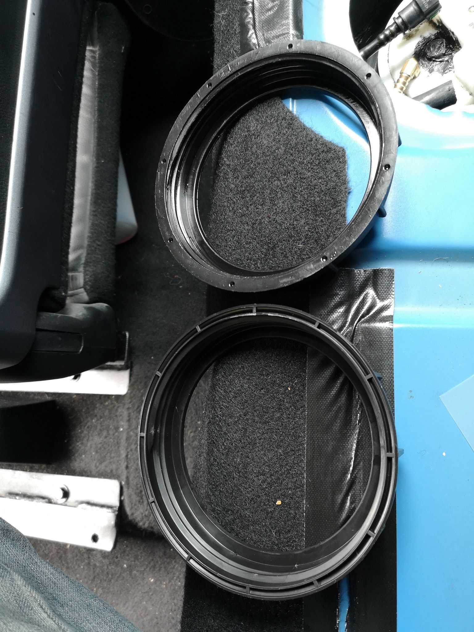

So, since owning the car there has been an issue with it stalling. The seller of the car mentioned it to me and had had a garage try and figure it out, to no avail.
I noticed it generally got worse when hot and on bends, and with heavy standstill use of the power steering.
I assumed at first they were all caused by the same thing, but instead it turned out to be more than one issue making it hard to diagnose what was wrong.
So, the power loss on fast right bends. I tested the car with stability on and off and with low fuel and max fuel. It didn't happen with max fuel in the tank so it was obvious this was fuel starvation/surge. This is a lot more common on modified cars with uprated fuel pumps and where they have their fueling route messed with, like mine. The increased amount of fuel sucked by the pump depletes the swirl and/or fuel sender thing much quicker, and often if there is a fuel return installed it is just spraying back to the main tank and not the pickup for the fuel pump.
I bought another sender unit and modified the top so I could re route the poor job of the previous fuel return. It came with a OE fuel pump and I had my suspicions the 'uprated' pump was not working properly as well. I think the OE pump can handle the fueling for this low boost setup (just) so I fitted that with my modified sender unit, which has a return pipe inside which feeds the pickup for the pump. Much better :)
I made a bit of a booboo with the fuel sender, which will show itself later, but after redoing the modified pump setup I decided to fit my new track day wheels. These are wider tyres than stock, and the offset of the wheels means the arches are much better filled:
IMG_20181023_164354https://www.flickr.com/photos/27957459@N04/
I also fitted three new Bosch mini relays just in case part of my issue was ignition...and because having spare relays is always good. The pink one is also a working replacement.
I asked some of my mates from the Mk1 gang what some of the plugs were that seemed to be unplugged....seems they are just aircon and bonnet sensor. This car has no air con anymore:
IMG_20181020_132248https://www.flickr.com/photos/27957459@N04/

As I said before, I did make a booboo...I've changed pumps and stuff before but never had an issue with the fuel sender sealing nut. I think when I changed the senders over I left the fuel exposed too long with the cap off and it has deformed the tank a bit. I had a new clamp nut to go on but it took ages to twist down and on my way home from the awesome B-Road blast i smelt petrol. I checked the rail and other stuff, but they were fine...then the top of the fuel pump...loads of petrol :( I tried very hard to get the top on again...but no way was it going on. I had to leave the Clio at my Uncles and drive his spare Audi home to get another sender clamp nut thing, and that didn't fit either...
IMG_20181027_142133https://www.flickr.com/photos/27957459@N04/
Badass ;)
IMG_20181027_143730https://www.flickr.com/photos/27957459@N04/
Went back and soaked up the excess fuel and tried with a genuine OEM ring, still no joy. So I got the bugger as tight as I could even though it was mis-threaded and got it home. Drive very well even like this and no more stalling :D
So, I'll either try heating the sender clamp thing nut and fitting it that way (bowl of boiling water or something) or drop the tank and replace the whole bloody thing. I might even just put a full on motorsport fuel tank in with swirlpot.

I managed to get the sealing nut on the fuel tank after heating it up, BUUUT...today I filled it to the brim again as I made the long journey in terrible weather conditions to a Clio day at Surrey Rolling Road. There is still a slight issue with sealing the fuel tank as it leaked a bit again, no way as bad as before though. I now have a spare fuel tank so next week I will remove the old one, which must have warped a bit.

On another note, last week I went on an adventure to pick up another car:
IMG_20181103_120447https://www.flickr.com/photos/27957459@N04/
Can you guess what it is yet?
If not, here is another clue:
IMG_20181105_102214https://www.flickr.com/photos/27957459@N04/
Correct! It is a Clio 182 Trophy!
I picked the car up and drove it back, it goes really well and feels more solid than the RB in terms of interior. The trendline recaro's are yummy :)
But, as with almost all Clio's I've owned, they don't come without drama and I had a tyre blowout on the way back home. It took RAC 20 hours to get me back, but I made it.
I had a good look over the Trophy and started to do some tests and give it some TLC. There are various areas which need addressing like the usual faded red plastics so common on red cars, and the wheels need repairing/refurbishing. As you can see, I have some new remote dampers to go on as well. I needs a good service, and I will probably do the HG and belts and a full service. It also needs a new ABS sensor and a really good tarting up, so a trip to the bodyshop is in order.
IMG_20181103_120532https://www.flickr.com/photos/27957459@N04/
So, lots to be getting on with. If I sort the Turbo out, I may sell it to get the Williams out of storage and onto the roads again and fund the Trophy project too.
