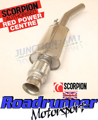

Are the revised centre silencer boxes with flexi pipe still being manufactured?
Might be cheaper to buy direct from scorpion.
