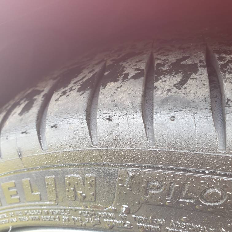

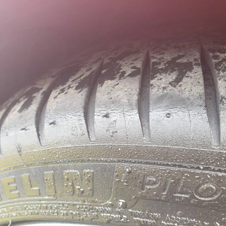

Giving the wheels a clean yesterday and noticed these small cracks on the shoulder.
Date on them is 5117 so not even 2 years old. Do they need changing or are the fine. Pressures are checked every week so that isnt the problem

yeah nowt to worry about imo, if they have pronounced cracking between the tread (so not caused by contact) then worry
I wouldn't worry if it's ON the tread blocks, but between them, or on the sidewalls and I'd be getting rid. Michelin's are awful for it sadly.
Matt e
Yeah looked on google and Michelin were telling people its cause they are left in the sun to long which is crazy lol

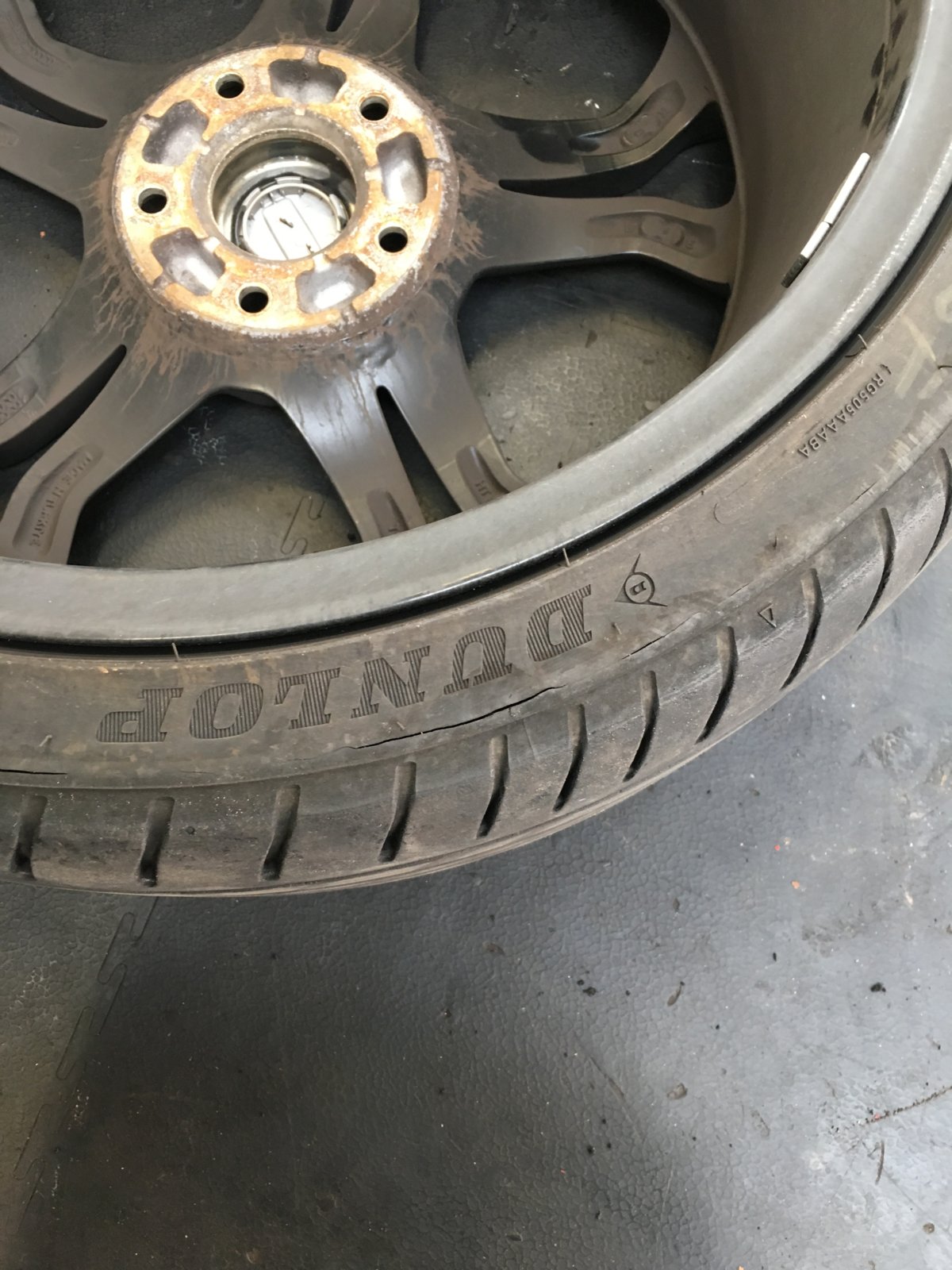

Wow shocking is that !!
Learners + potholes??
Or just s**t tyres?
Have you spoken to dunlop? did you buy tyres new?
I did indeed send them back to Dunlop who, after about 6 months partially refunded me. No admission of guilt or apology though.
Reckon that's the last dunlop you will be buying then? What you got on it now?
