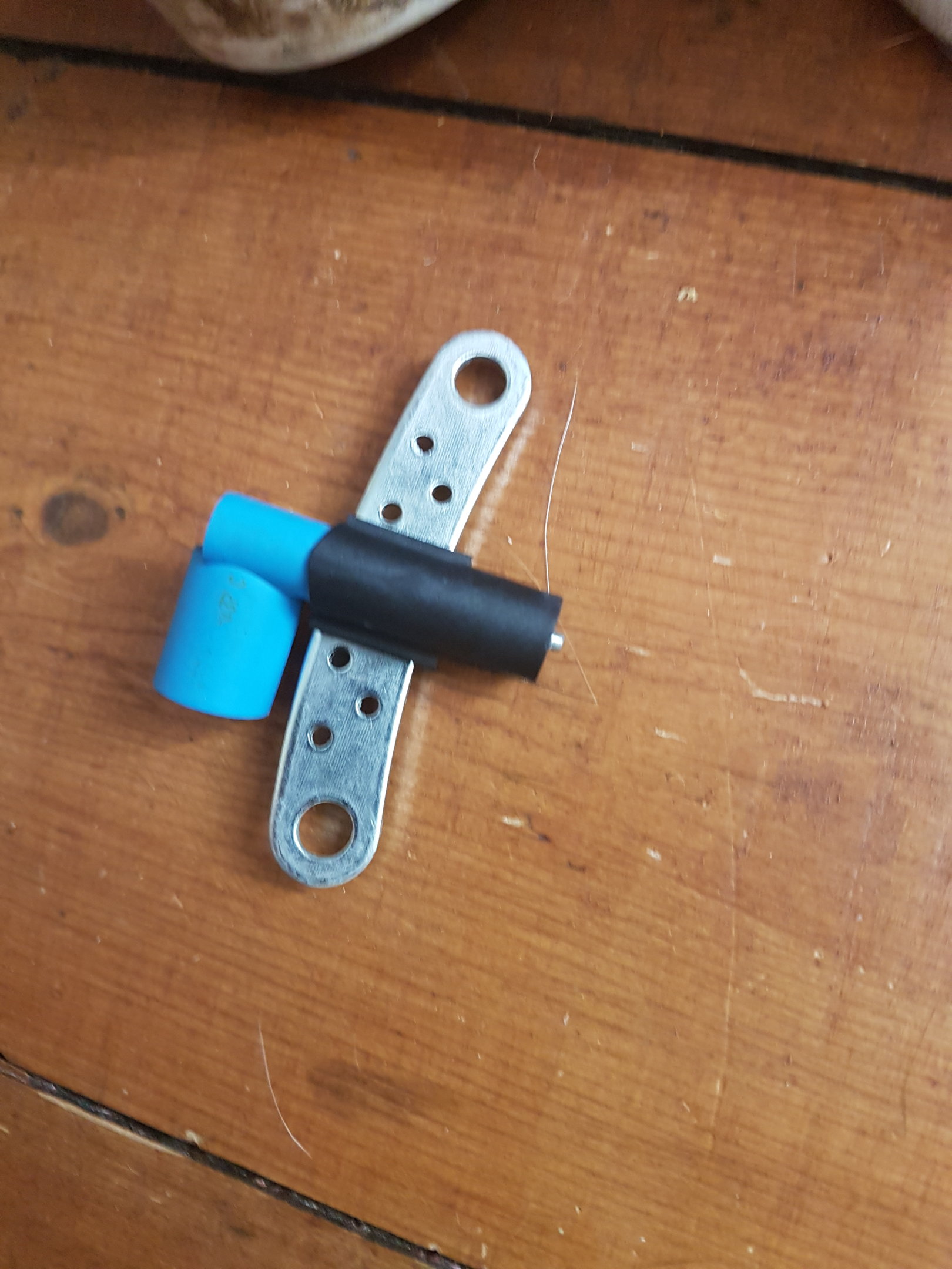

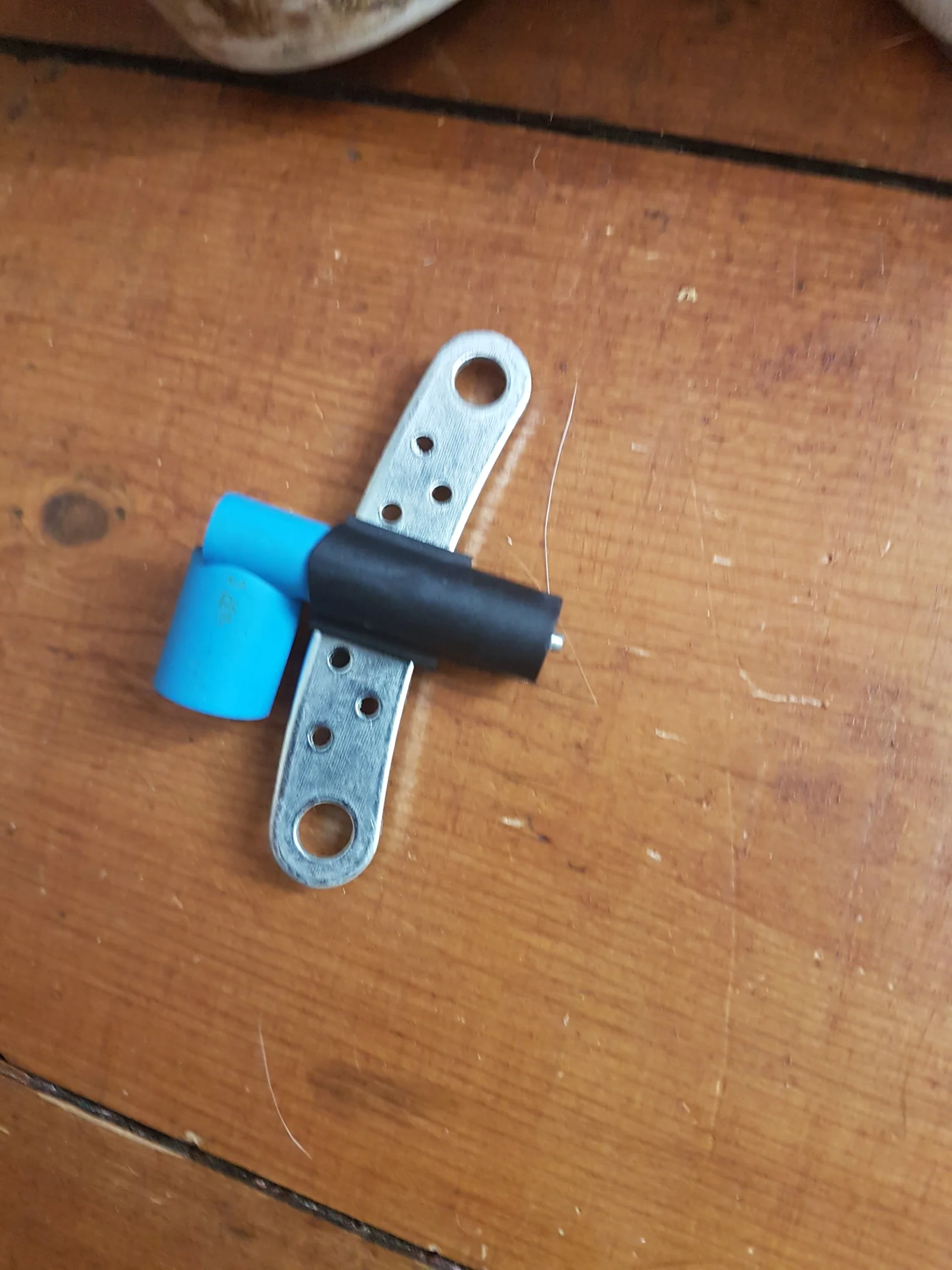

I have already replaced original crankshaft sensor with a new blue type, are you thinking this may be duff too?
