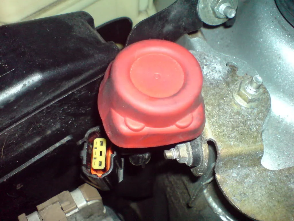

There should be a red button in the engine bay this I beleive if the fuel cut off.
Pic from another thread on here:
  '08 1.2 TCE 5dr
SF & Knuckles, there isn't one on mk3's, hence I can't find one anywhere in the bay.

The red button is common under the bonnet on peugeots citroens and older renaults, it's just a connection that breaks when a sudden impact occurs in order to cut the engine out, and pressing it back down remakes the contact, but on the latter ones it is all computerised and that's where it goes belly up for most people as it means an average bodywork/mechanic can't sort the issue. :(
