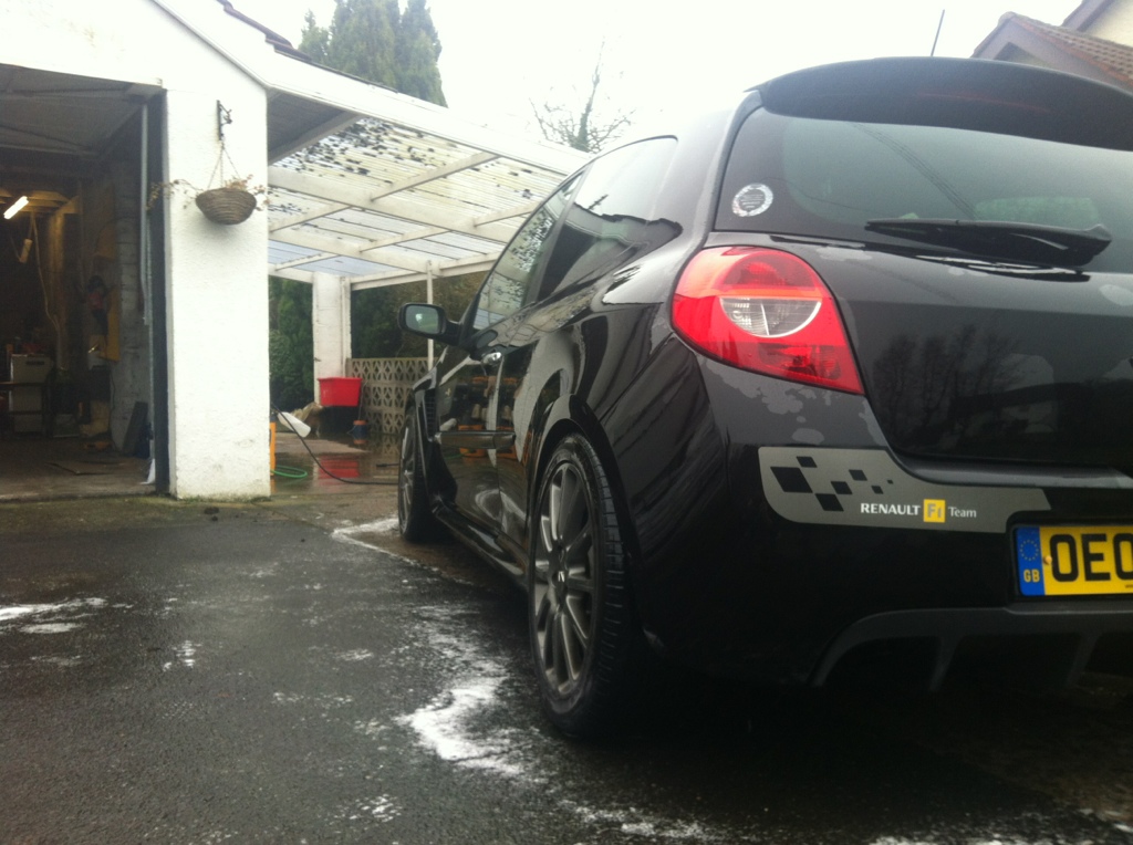

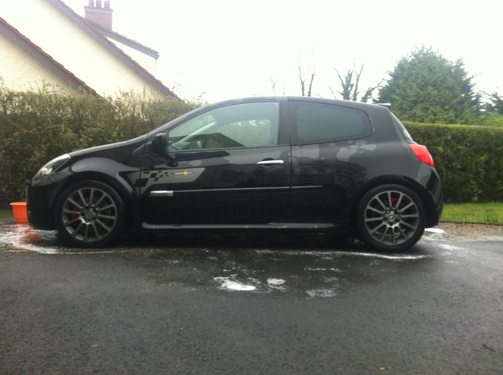

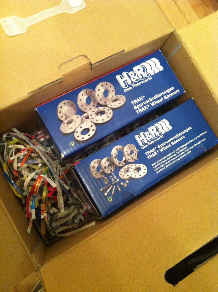

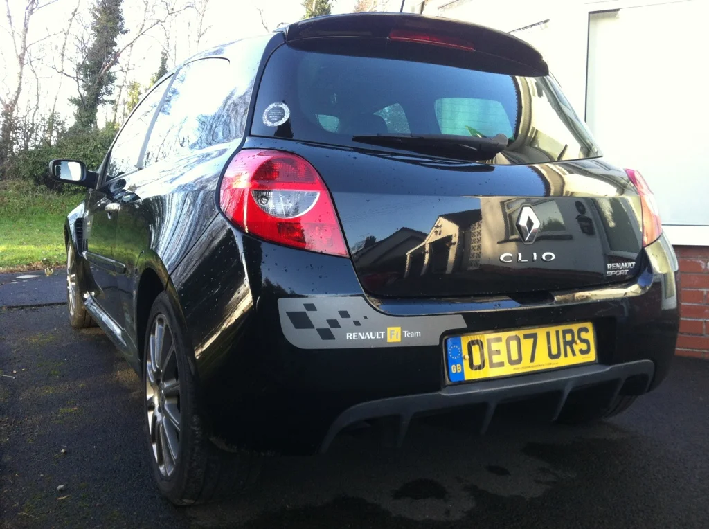

Stuck the spacers and kw's in a couple of weekends ago but the weather has been shocking so no photos until now
Rear is as low as it goes, needs custom springs if I want to go any lower. It's settled ok, handles brilliantly so ill see how it goes for now. Bigger things to be spending money on for it anyway
25mm all round, could probably have squeezed in a 30 in the rear but keeps it balanced all round and a bit of space for new wheels if needs be

Re: Cro's r27 f1
Cheers guys, no doesn't catch at all. I can hear it hit the arch liner when I've a few in the car and hit a bump in the road but not badly

This makes me want to bring my 182 down! Needs top mounts though I think before that happens though. Hopefully within the next two weeks it'll be coming down. How practical was your 182 at the height it was at?

It never caught or scraped on anything and it was pretty low. Handled like a go cart too Steven, get it down on some decent coilovers and top mounts. Gaz golds and ast mounts is what I had

25mm in the spacers looks nice, i thought it would be to much but thanks to your photos i have a glimpse in how it stays. I'm curious regarding the rear spoiler, honestly i prefer something that goes with the design instead something too radical.
The rear bumper/alloy wheels are 5*, but the exhaust needs something. Perhaps a Tip ?

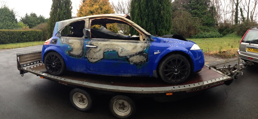

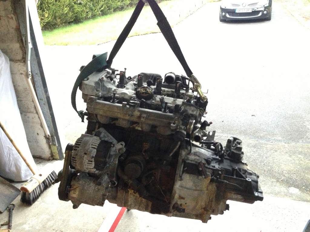

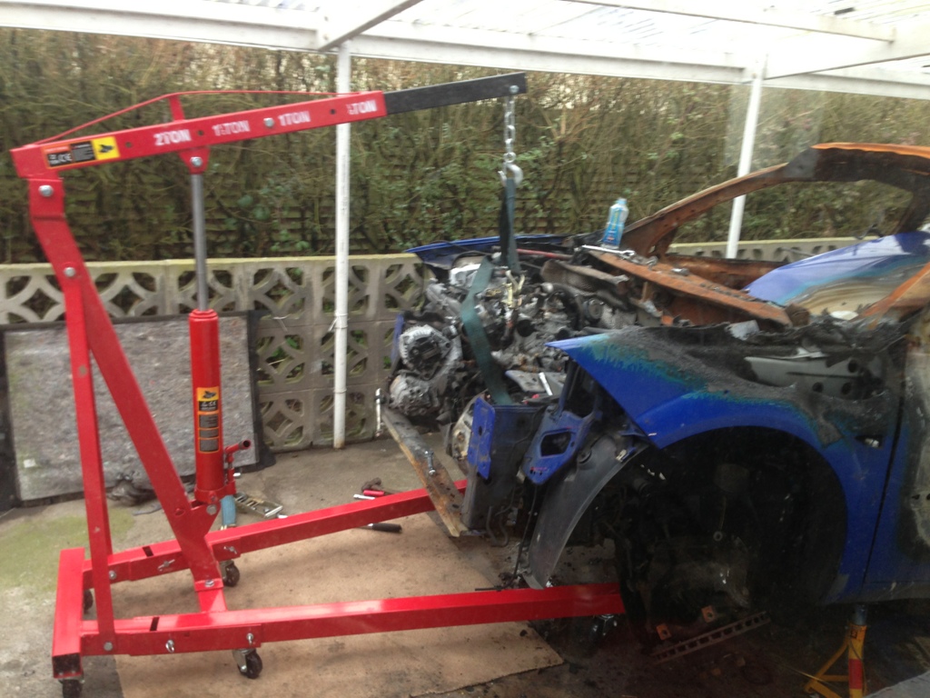

You're trusting the engine out of that, jesus I hope it was cheap thats had some serious heat. That's a rebuild candidate not a drop straight in one.
Cro
  Meg'd r27
Re: Cro's r27 f1
Yeah it was cheap dude, the fire didnt spread too far into the bay so i'm confident that the engine will be grand but i'll be cracking it open anyway don't worry. If the pencil coils were melted or anything looked like it had been on fire around it i'd have walked away but the worst of it seems to be the likes of the oil cap.
Injectors were fine etc but i'll be changing all the sensors and loom anyway, that n/s wing makes things look much worse I guess

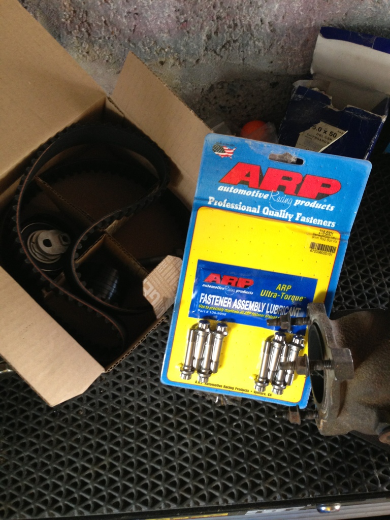

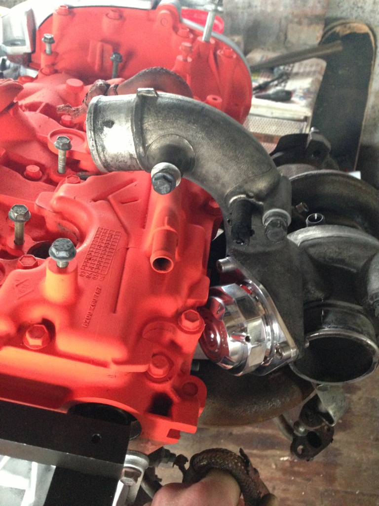

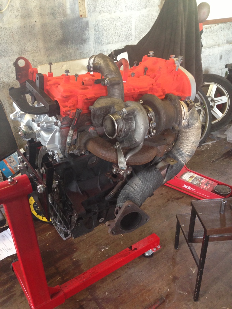

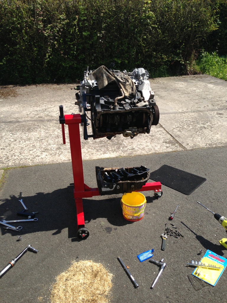

​Well bank holidays are where the magic happens, megane engine stripped and rebuilt with some arp rod bolts to be on the safe side of things, new gaskets and all timed up fresh as a daisy
Can't beat working in the sun, though now im sporting some sort of tan you'd usually see outside the local nightclub
Quick lick of paint, on with the miltek decat heat wrapped and just waiting on some more parts to arrive. Need some pipework and links and I can get started in fabricating the intercooler stuff and then on to the exhaust. It has arrived but I just need to get everything in place and then work up a link pipe and we aren't far off ready to roll. Still searching for an engine loom and ecu from a megane, absolute pain in the hole to find

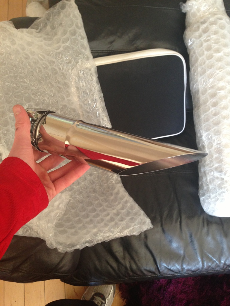

These are the tailpipes of the system I went for, it's going to be snap, crackle and poptacular once i'm done with it

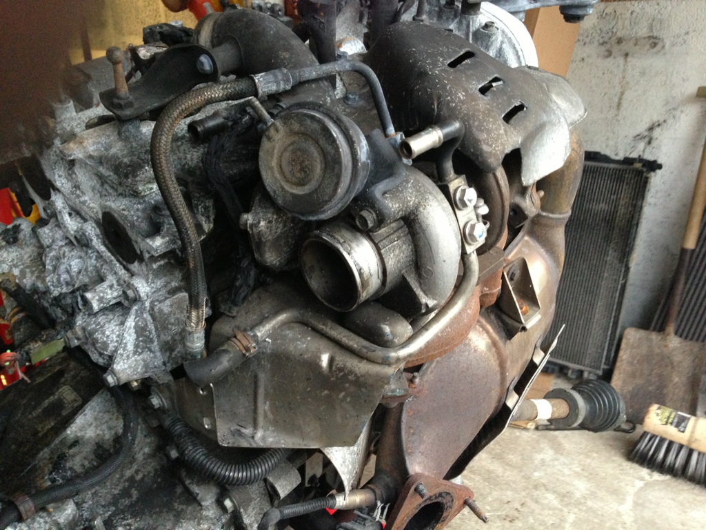

I need to work out what I can do with the turbo oil feed pipe you can see has been cut off, either replace with renault (expensive I imagine) or just used a universal braided hose and get ends to fit block and turbo. Any thoughts?

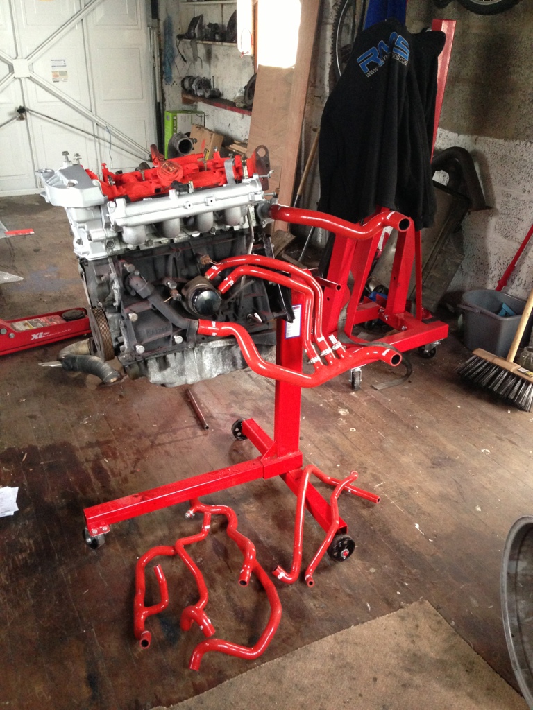

Another delivery, started to work my way through Renault's spaghetti junction of a coolant system. Not a great jigsaw when the originals to work off were a melted puddle of rubber lol
And a nice shiny recirc valve where it was previously blanked off for a dump valve, don't think I want a super loud TTTTSSSSSSSHHHHHH so this'll do the job nicely, i'll look like i'm sponsored by forge by the end of this build
