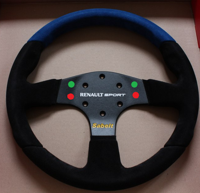

Anyone came up with a good way of doing this yet? Rather than just sticking the standard buttons on?

How easy would it be to just add 4 buttons to an after market wheel and wire it up that way?
Example (Epic Paint Skills)
In my head it seems simple :o

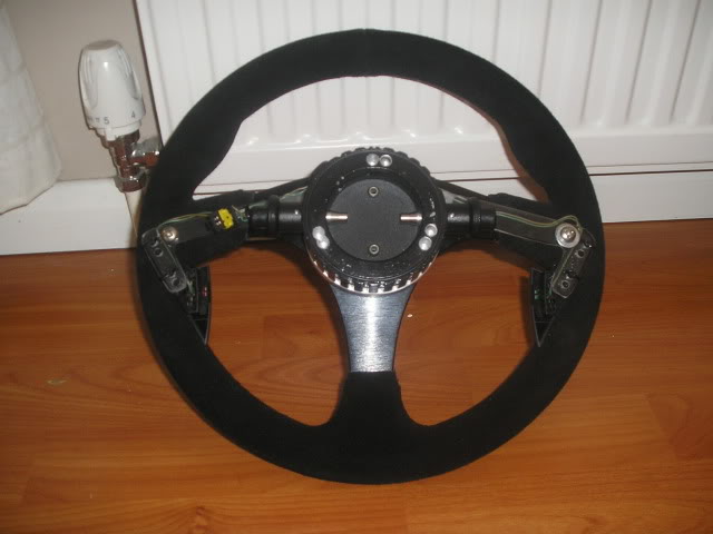

Or there is that.. you just taped/fastened the wires to the back of the wheel? Did you need to lengthen the wires at all?
Yes had to extend the wires.
here's a photo of the back of the wheel:

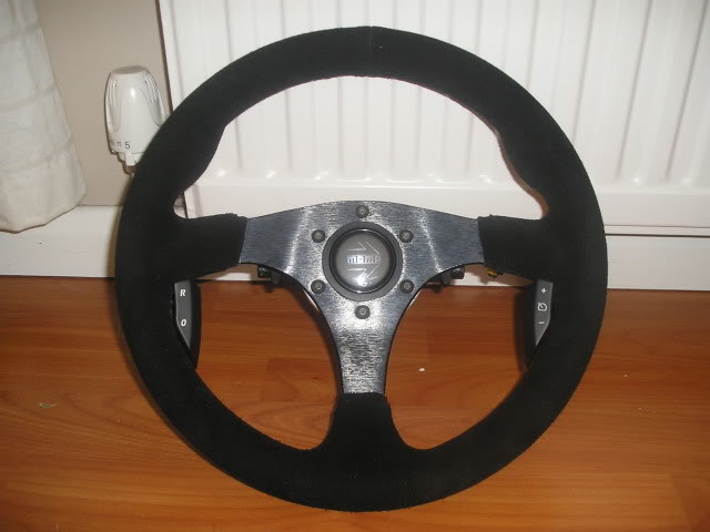

Have a search theres a few threads on it. I used a mount from demon tweaks and wired in my own resistors.
Cut a template from a sheet of CF, positioned buttons, drilled and fitted, then wired in with the correct resistors. Works well.
Good diagram ^^^
resistors are easily picked up in maplins. Steady hand and patience of a saint required to wire it all in.
274R - Left toggle button (+)
100R - Left toggle button (-)
910R - Right toggle button (R & O)
