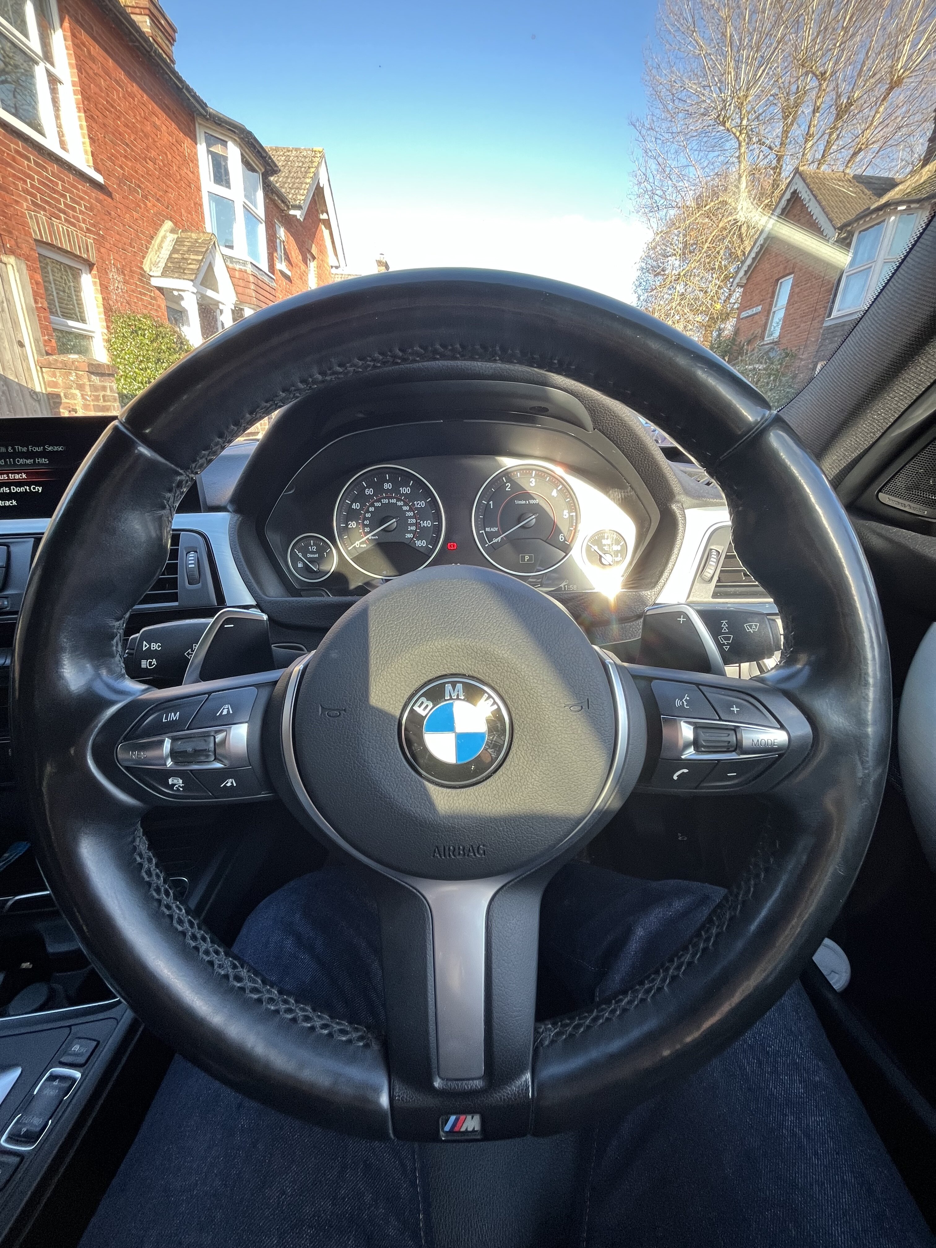

All replaced, the cars reversed out and I can’t wait to get away. Steering is a little heavier and doesn’t quite self centre. Great. Hopefully it’ll settle, but the main issue now? The f**king steering wheel isn’t straight when the car is! It’s about 35° off centre?
Can I just remove the airbag and steering wheel and centre it? Or does the steering rack part need removing again and the wheel moving whilst that’s not connected?
I know the moral of the story - use a specialist, they’re worth the extra.
I’ve tried Bimmerlink, checked steering wheel angle, it doesn’t seem to give exact data only changing between -1024 & -3072 °LW at the point that the wheels are centered, steering wheel is off.
Does bimmer link allow you to restart the steering calibration?
The official bmw way is to remove the power supply plug and the signal wire plug. You’re also measuring the play in the rack bush in microns - there’s a special tool for doing it that we use at work when we replace them.
For the steering wheel to have been straight, then be off on the wonk after it’s been ‘adjusted’ doesn’t sound especially promising.
Not that I’ve found, will have another look. It’s a lot more basic than ISTA.
Do you know if the process of re-centring the inputs of the steering wheel to the steering rack is a big job?
Im guessing it must have occurred when the steering rack thrust bush cover was loose and the wheel moved to unstick the actual bush, so it’s slipped a little out of alignment as the teeth weren’t fully engaged?
Ah ok.
I just do the eps start up procedure using Ista mate, so the test module just does the bizzo for you.
My real concern here is if the rack has jumped on the drive somehow when the rack was moved to unstick the bush. There is absolutely no reason to do that, as you can pull the bush out with long nose pliers.
Whereabouts are you based?
Ah ok.
He was struggling with the pliers, could see it wasn’t going his way, then started wiggling the wheel and then getting back under to check, so I offered to sit in the car whilst he checks so he wasn’t going between. It definitely felt like the steering wheel was close to slipping, hard to explain but you can tell from the feedback. I told the guy and then the other tech took over from me. So I’d imagine it did at some point.
Im in Sussex. It’s really annoying as this was just a whilst you’re there job, and has turned into a right headache. Car drove back fine but it’s just parked up now as don’t want to cause more issues.
Yeah that’s not ideal then mate. You could be into a new steering rack at this rate ☹️
Fixed (hopefully) & MOT’d!
Took it to the local specialist, they seemed happy the slipped & misaligned rack was a result of lack of pressure from the thrust piece whilst unbolted rather than wear or damage. Fingers crossed. Steering wheel is now straight and front end aligned after all new upper/lower control arms and it feels absolutely great
