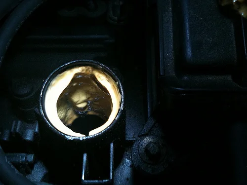

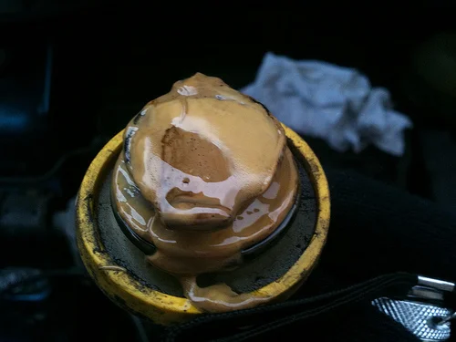

The oil filler cap also looks like this:
What do we reckon CS?

id put £100 on the head gasket being fine. these engines always have mayo like that under the oil filler cap unless they are driven long runs regularly, its not an issue dont worry about it, clean it off and give it a good motorway run and i bet it doesnt come back until its doing short journeys again.
the leaking coolant will be the waterpump, the waterpump should ALWAYS without fail be changed on these engines at cambelt renewal as they are always going through them, mine was emptying its header tank in less than 10 minutes at the end lol
oil will likely be either burning or leaking somewhere else.
+1 HGF , that is way way too much for general condensation for short runs. Does it smoke alot? 1/8 in 1 hour is excessive, you should be able to see a slow drip somewhere if its WP.
