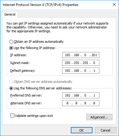

If its not a driver related issue, with Windows potentially being the main culprit - you could always try setting a static network address onto your PC adapter?
Check what you have first by pressing the Windows Key + R and typing cmd and the enter. In there, type ipconfig /all and enter. In there will be a list of numbers that should provide most of the details you'll need. One to check while you're there too is the Lease Obtained and Lease Expired values - see if they are indeed set to something stupidly short like ten minutes.
In all likelihood, it's address will be being given out by your router through DHCP. Usually, these follow a number between the ranges of 192.168.0.1 through to 192.168.0.254 or 192.168.1.1 through to 192.168.1.254.
Typically, the router is either the first device in the range or the very last (***.***.***.1 or .254) and typing that into a web browser will normally get you to the router's web page for configuration.
Within there, you can assign a range of addresses that the router will not hand out through DHCP to phones, tablets, PCs, etc. If you set up a scope that had a small range in itself - e.g. 192.168.0.200 to 192.168.0.210 and then manually assigned your PC's adapter to 192.168.0.201 - you're placing in that 'protected' scope that at the very least, should assure you that no other device is given the same network address. There are a few caveats with that - but you should be fine.
On your adapter and assuming your router was on 192.168.0.1, your network config page should look similar to the below:-
The quad 8's aren't required, but I sometimes add them of the router is having DNS related issues.
Whilst you're there - there's a possibility that the your older wireless adapter is having issues with IPv6. As IPv4 is still by far and away the most popular protocol version at the minute - I'd disable IPv6 on your router for now.
