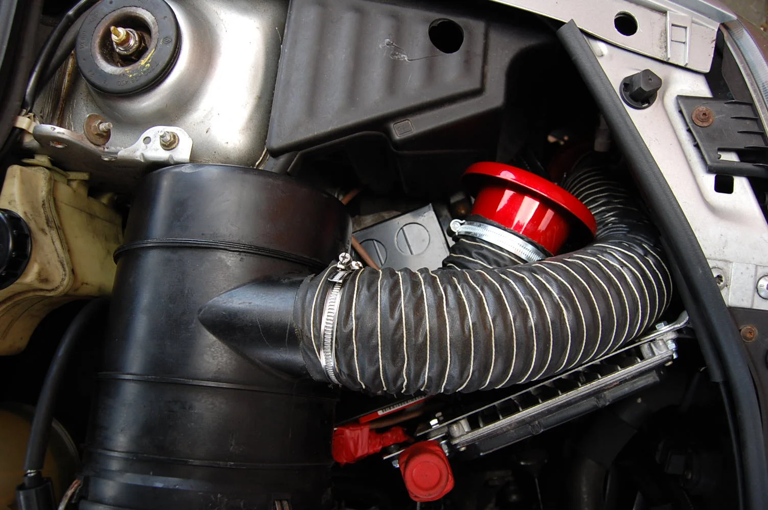

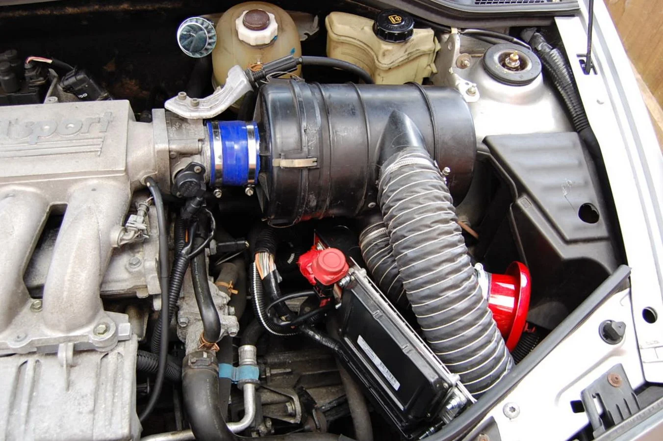

Managed to squeeze the battery,ecu and airbox under the bonnet.
Saves moving the battery to the interior!

Whoops, I used an odyssey pc680 battery ( from burp) you can just see it under the black bracket.

this is optimal use of very litle space :D nice new ecu bracket too.
is the battery a smaller one though ? ****aha**** you beat me to it

This is Exactly same setup as mine! nice, but i have the V6 airbox with the single larger port sitting just behind the headlamp. I actually ran a test using rstuner with this setup and behind that headlamp was one of the coldest places without actually taking it outside the engine bay. It dropped right down to 18 degrees on a motorway run.

p.s. I like the way you have fastened your ECU. I installed a Odyssey in the boot and lay my ECU down flat where the battery originally was. How did you go about fastening your ECU in this way?? Have you built a special bracket?

It's just a rectangular piece of stainless steel just a bit longer than the ecu and bolted it to where the air intake pipes sit on later cars.
