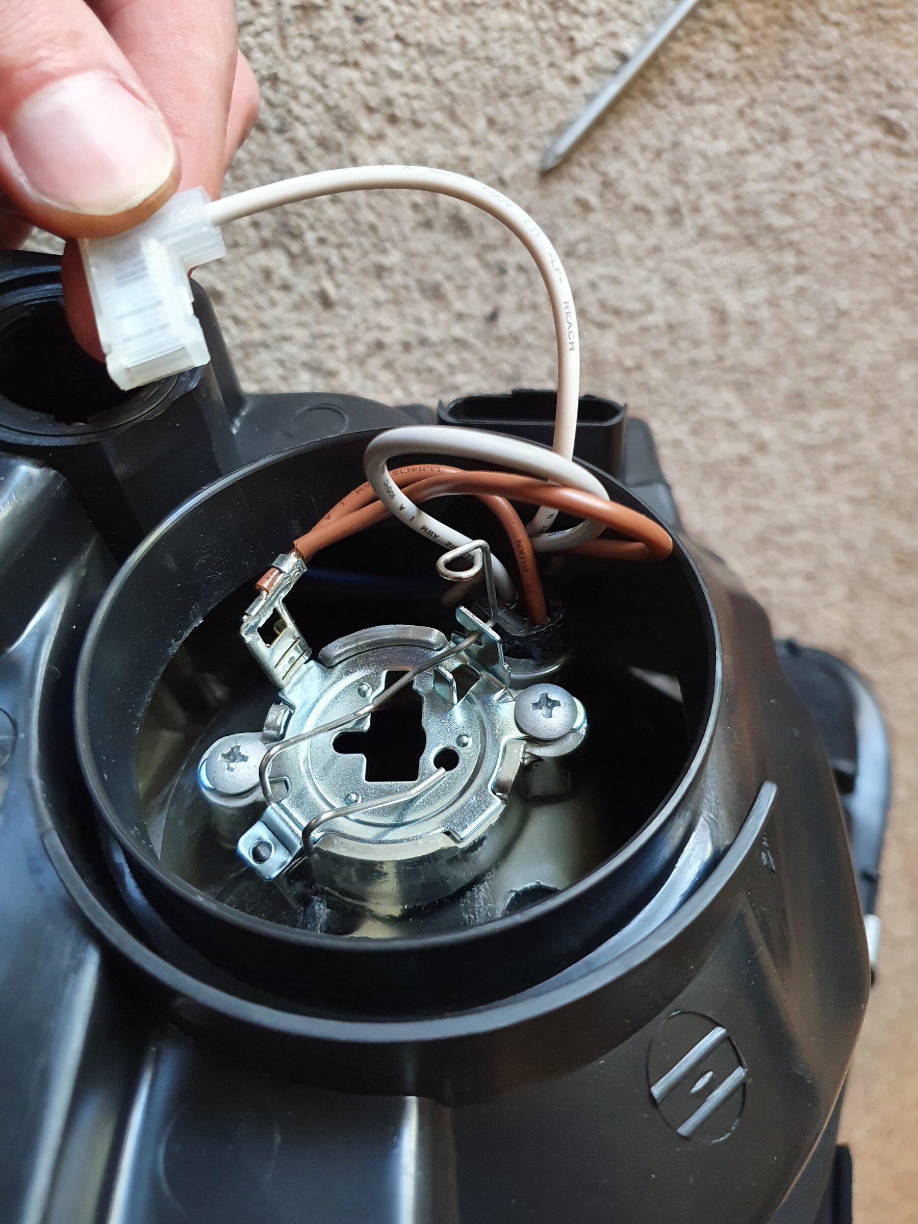

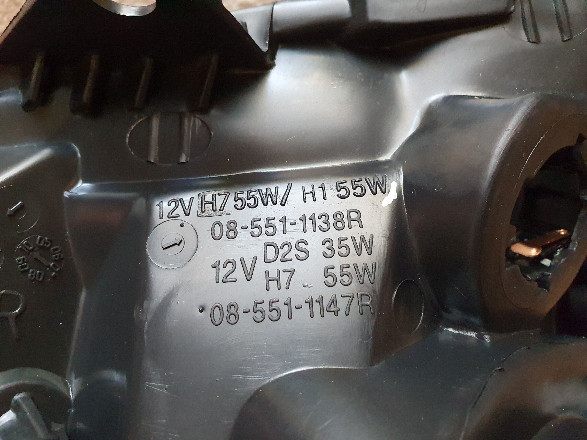

I'm replacing my 182's xenons with halogen units and I thought both bulbs were H7 but there is a metal plate stopping the full beam H7 from going in. There is also only one connecting cable. Can anyone confirm if this is an H1 bulb? The dipped side is an H7.

Undo that spring clip and the metal bit should come away
