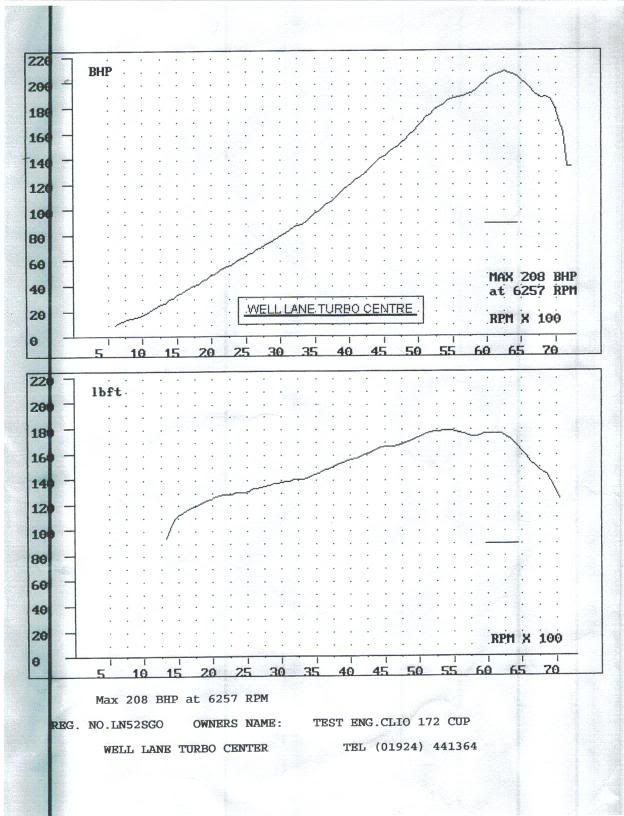

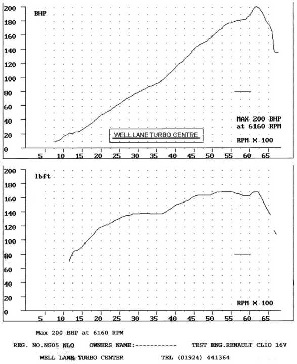

here's the results graph, have to say i bet your pleased blunty :)
before
after
  RenaultSport clio 182 CUP
The Re-map was done by PMurrary back to back from standard and also using a diffrent RR to the one he normaly uses :D

I'd say the 200hp is a tad too high but we got exactly the same gains on a Dyno Dynamics dyno with another car. Well 15hp & 15lbft so close enough. The thing to remember is the test was to see the gains NOT the actual HP. I'd love to run this on the DD dyno too to see the actual HP but we have acheived what we set out to do so all are happy. I hope:D
So yes 14HP from a remap.

Also the car was run 4 times (at least) for both std and tuned. The results were within 2hp each and every time.

If you want to look at the actual figure then so be it. As i said in an earlier post IGNORE THE 200HP (Well Lanes Rolling Road is renowned for over reading) Plus i'm not advertising or nor is anyone saying "clio 182 remap to 200hp". The test was done to find out the gains and not the figure. This is the second time i have now attempted to prove my 182 Map with back to back figures yet still people like you jump all over the results. If you don't want a remap don't buy it!
I'm sure BLUNTY will be happy to run his car again at FCS so let's wait and see.
Paul
Like paul said its not about the BHP result it was about the diffrence between standard and then remapped car
I would like to say its not BHP that counts its the Torque and that what i wanted out of this :D :D :D
