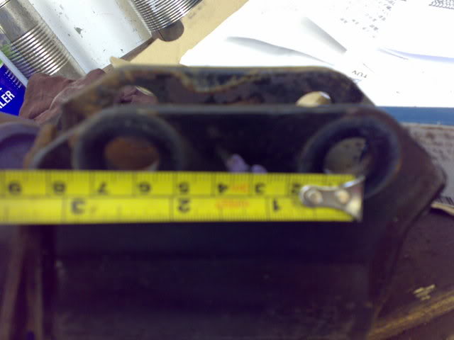

To check if it has cup suspension, take off the wheel and measure the bolts that hold the shock to the hub assembly. Should be 60mm to the middle of the bolts. If it has silver alloys, sounds if your car only have the spoiler pack, not the suspension.

182 Cup/cup packed are 60mm. I measured them when i took mine off. You can just about make it out in me blurry pic ;)

I woulnd't go off the original build spec.
didnt know they came in 60mm, usually always sold as 58mm iirc! max you can buy anyways i think
58mm are none sports sport models are 54mm ie 172 and none cuped 182 or 60 for the cuped 182's
